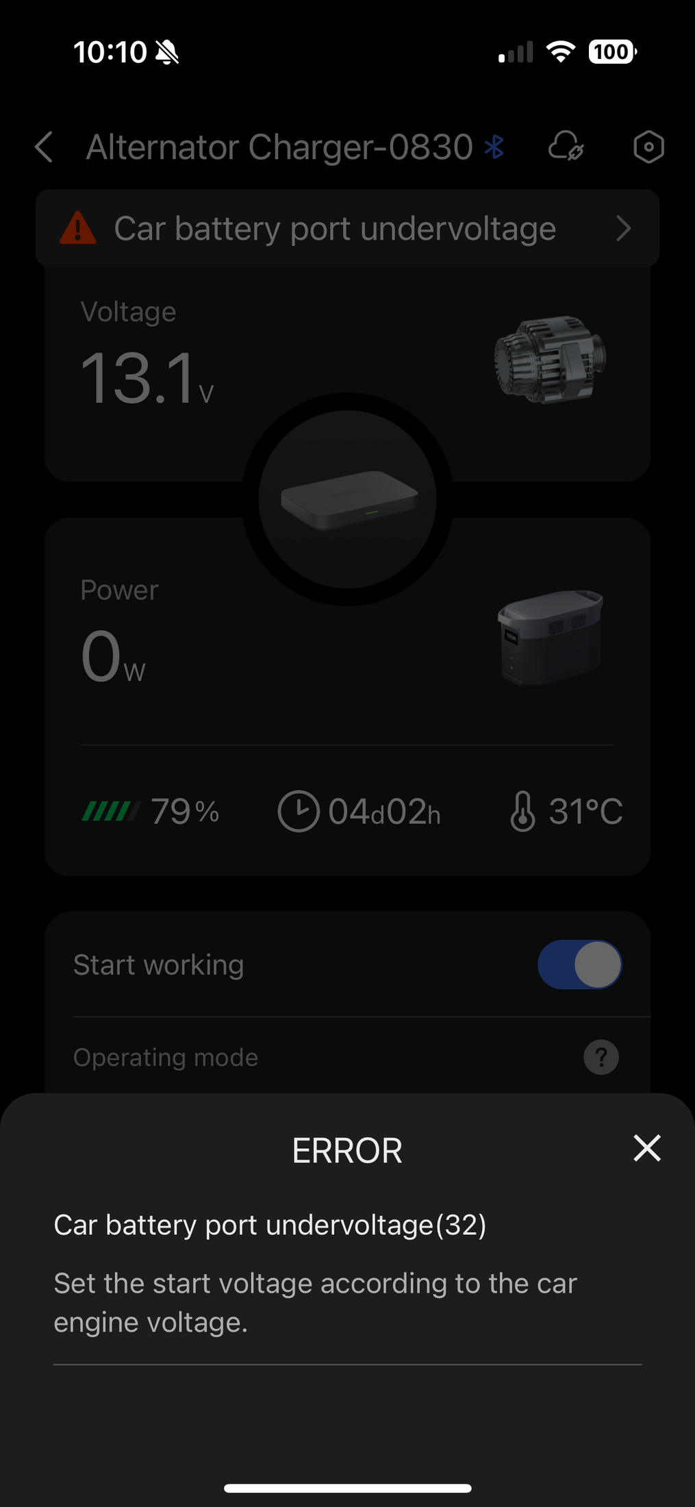

Another thing I’m wondering about. I think I can leave the alternator charger on when parked with the engine off and it will stop drawing power when the starter battery hits the voltage I set as the start voltage. I’ve set it at 13v. That seems to work but it gives me an error:
Seems weird to get an error when it is doing what I want and it should. Maybe the intent of the error is if I had set it at say 15v, then it would never charge. I just don’t want it to drain my starter battery over night.
As a follow up, I left the fridge and Ecoflow and alt charger running over night. All fine this morning. Still showed undervoltage error but I think its just doing what it is supposed to.

Watched a few videos on this and it does appear that's just the state it sits in when the vehicle voltage is below your "Start Voltage" setting. Seems like that could be cleaner, could instead be a message that says "Vehicle not running" or something. But seems to be just cosmetic.
