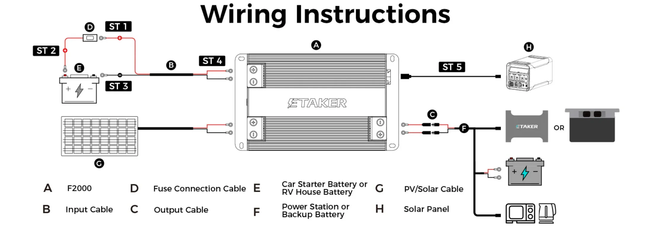

As noted above for the EcoFlow it has specific ports for each. The Etaker has a single port so their DC-DC has the second port for the solar.
However, it is possible with any of these. That is one is simply combining DC inputs. Whether it be solar/AC->DC or solar/alternator. That is if building a system from the base components solar/alternator/AC->DC all get combined on a single bus that then feeds the battery as well as the DC loads.
