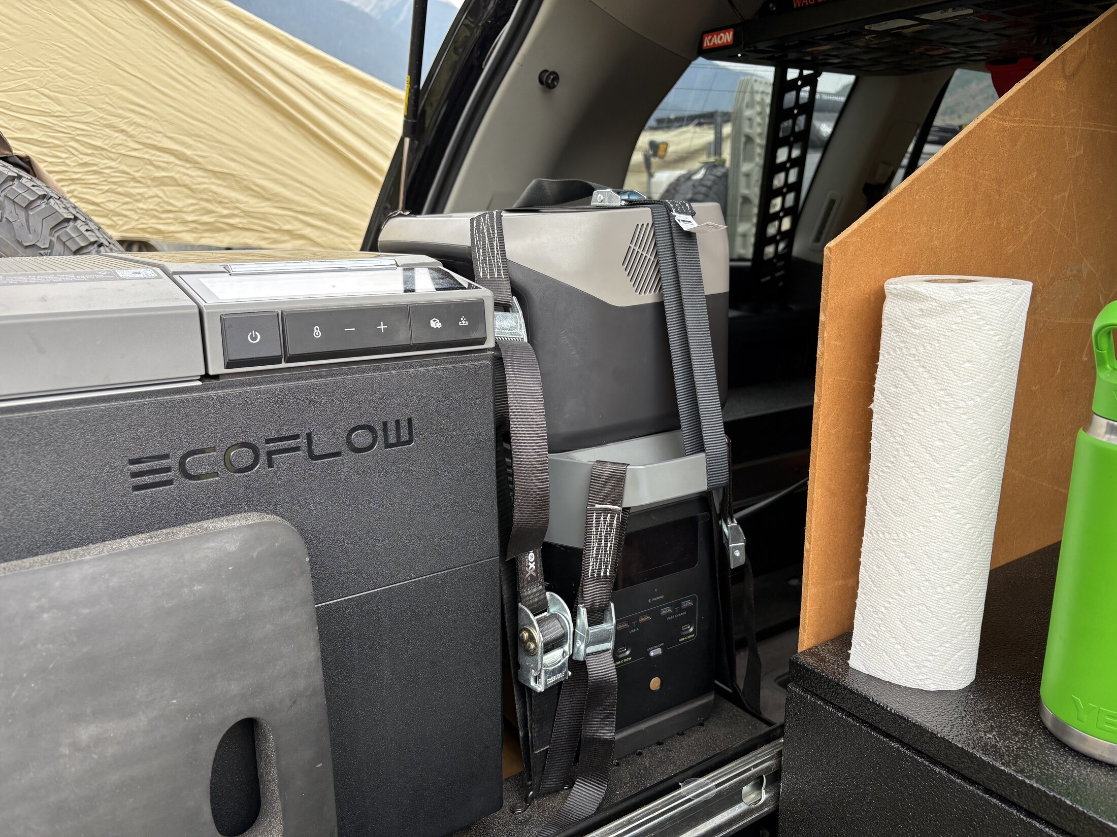

Getting ready for COTR. Driving the 200 as a daily this week until we leave have the EcoFlow flow all set up and just running it to see how goes. Well today didn’t go very well. It’s 90+ degrees here in Kansas City and today I let the fridge go with the Delta 2 hooked to it while the truck was parked in a parking lot at work all day. Black truck, hot sun on black asphalt. I probably should’ve realized this wasn’t gonna be a recipe for success essentially the delta 2 shuts itself down if it gets too hot and you can’t charge it or do anything with it until it cools down, which is hard to do when it’s 90°. The good news is the fridge kept running and is still running on its own battery, but if I was camping somewhere without access to Power, I’d be in trouble right now. The fridge is about done and my Delta 2 is at 7% with the temp light blinking. If I were camping, I’d have to hook the fridge to the cigarette lighter of the truck and just turn the truck on to keep the fridge going.
It’s 84° now with a low of like 73 tonight I’m trying to decide if I just let the battery sit in the closed up truck and see how it is in the morning as an experiment or if I should bring the thing inside and cool it down.
Edit: decided to take it into the house to cool it down. Took a while, but eventually the high temp and battery failure lights went out and it’s charging now. I’m very relieved. I was worried I fried it three days before I leave for Colorado.
Am I try to see if I can either borrow or buy 100 W solar panel or something just as a back up. I think the other thing I need to keep in mind is that in my normal Overlanding scenario I would be driving most of the day and I would have the AC running in the truck in which case I wouldn’t probably have overheated the battery. Letting it sit all day in the sun in a parking lot was not a great idea.

Added a 300 wh EcoFlow River to my setup to run loads in the tent while camping. It ran my tent mate’s c-pap machine. It would run down to zero over night and we just charged the next day while driving.
The system worked great for COTR. We left Thursday the 10th and are in Ouray now. I keep the alt charger set at 300 watts and as long as we drive 3 hours or so, we can hit camp with everything charged.
I think the system is pretty good for Colorado camping with moderate temps and trying to park in shaded areas with windows cracked when stopping in towns to explore or eat. For hot weather it may not be enough capacity but don’t like camping in heat anyway.
The Glacier fridge plus the Delta 2 is a total 1324 wh which seems to be enough if driving every day. The River is another 300 wh which is just margin if I don’t have load like a c-pap running overnight. I typically was at 36% on the Delta 2 and still 100% on the Glacier battery when we’d get up in the morning. I could run my induction burned for eggs then hit the road. The only issue we had was sometime the fridges cigarette plug would shake loose and stop charging the fridge.
I need to add some solar to be able to be off parked and off grid for multiple days. Seems like ~250 -300 wh of solar would work out.
