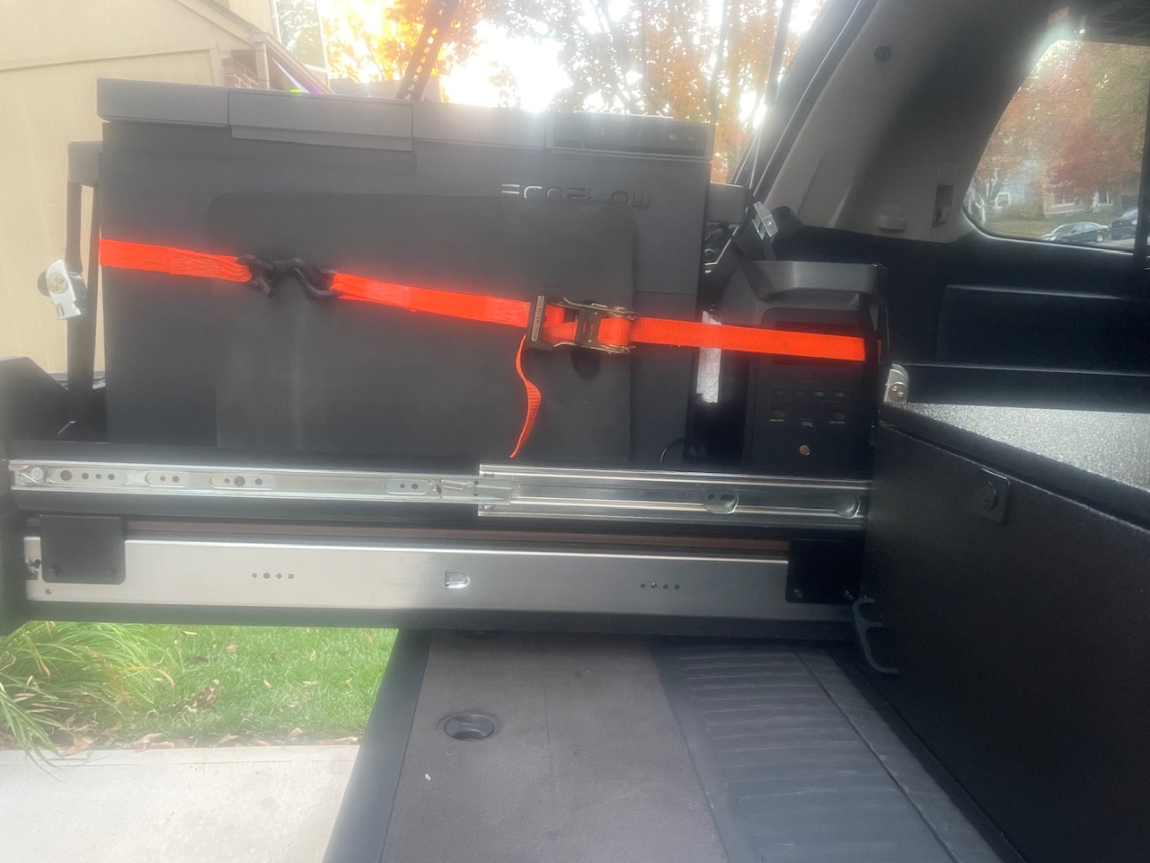

EcoFlow update: Got my TrexBoxx drawers installed and am now trying to figure out how best to pack all my stuff. The Glacier fridge and Delta 2 battery both fit on the fridge slide out. I need to work out a final strap the components down but will roll this way this weekend on my first coolerless camping trip.
For the final mounting, I need a couple different straps and some more footman loops. I may make an aluminum bracket for the Delta 2.
