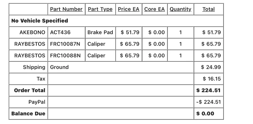

From my notes, Advics 0436 are well regarded (front brakes)
Just looked them up; surprisingly affordable! I'm used to pads costing twice that much, per corner.

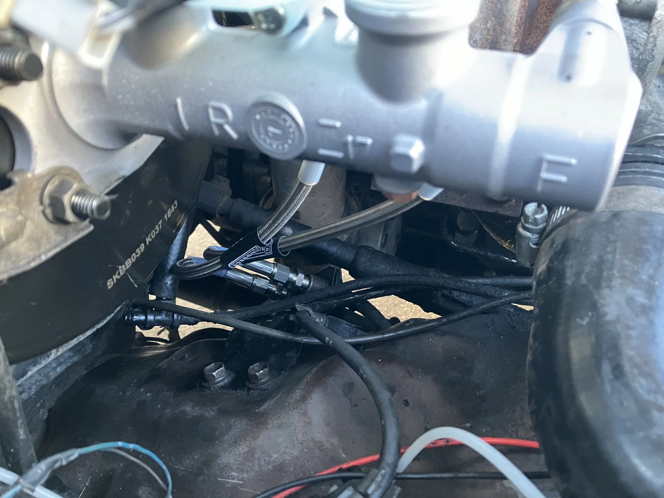

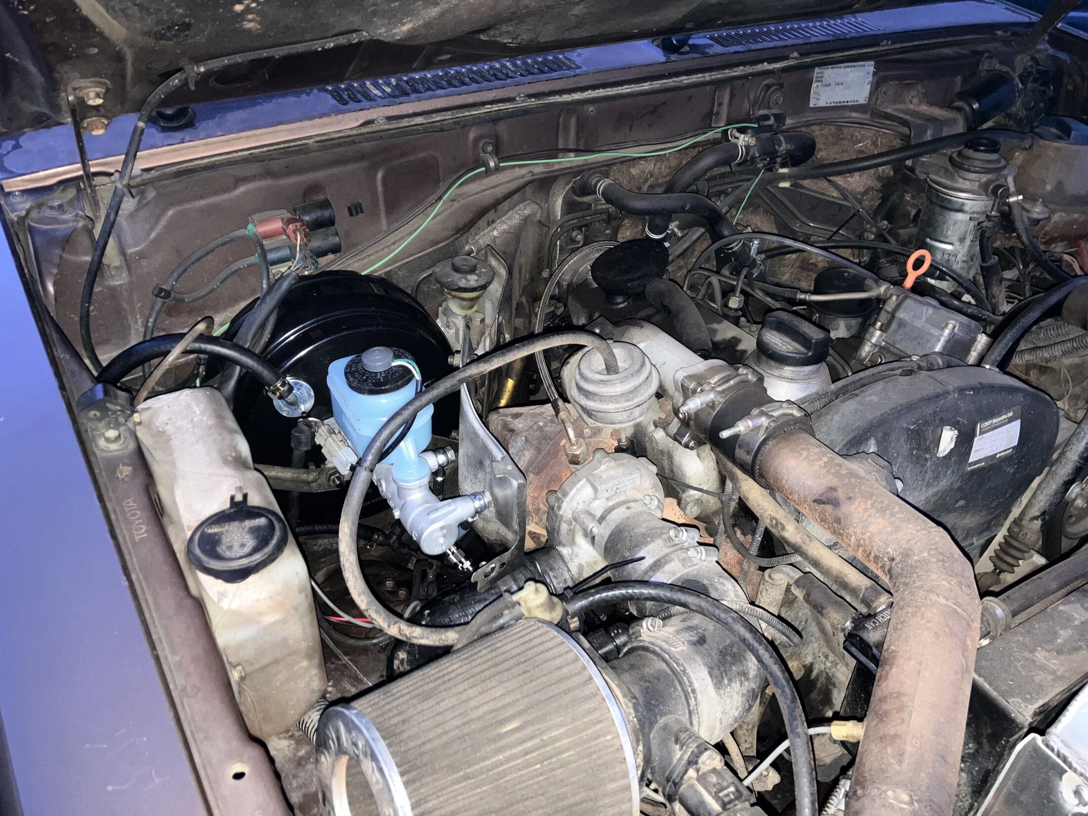

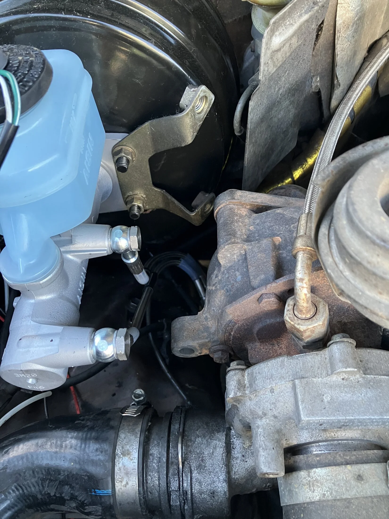

The 80-series master cylinder and booster isn’t quite a direct bolt in upgrade, but it isn’t far off. Depending on how your original brake lines run you’ll most likely need to reroute the lines to the MC, and I’ve heard that the pushrod on the pedal side can be too short (mine was just right in my LJ78).
Looks like you used a new pair of flex lines to the master; is that correct?
Yep, -3AN stainless lines, 10mm banjo fitting on one end and a -3AN to 10mm inverted flare adapter on the factory lines.
Sweet, thank you! That's exactly what I needed to know. 👍👍

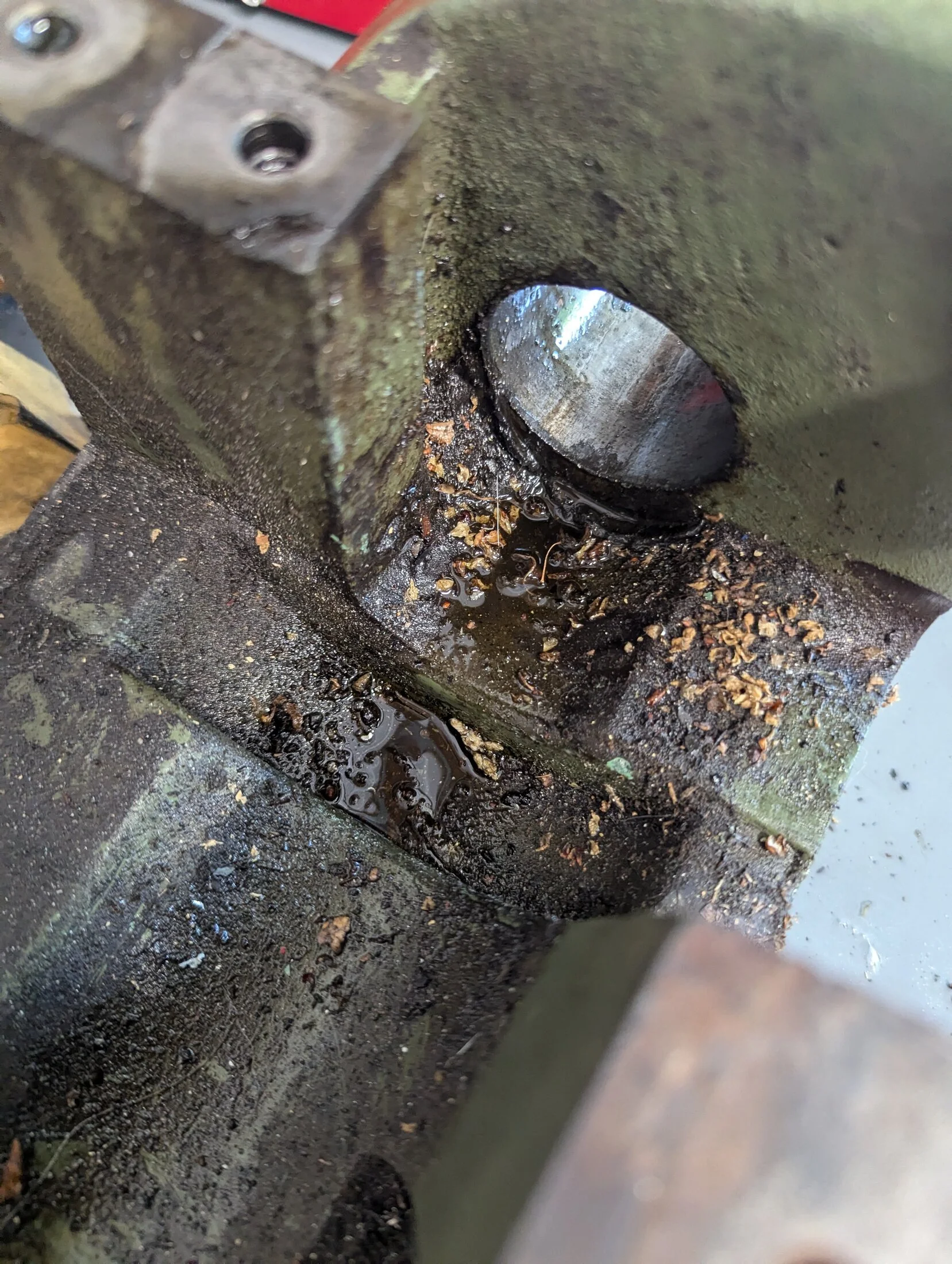

So, while I'm waiting for jack parts to come in, and while I'm trying to figure out if there are a set of Longfields available for my front axle, I decided to tackle another project: cleaning up my sheetmetal brake. I have a few light-gauge projects in mind, so I thought I'd just take an hour to remove the dried grease and muck that's been on there since long before I bought it.
And that's why I'm now on my way to buy dowel pins, a screw, a repair tap and a spring, and it's also why I wonder how people let their tools get this bad.
Pictured: Johnny Chimpo strikes again.
I've seen oil pits that look like that, but a sheet brake? I don't even know what to say.

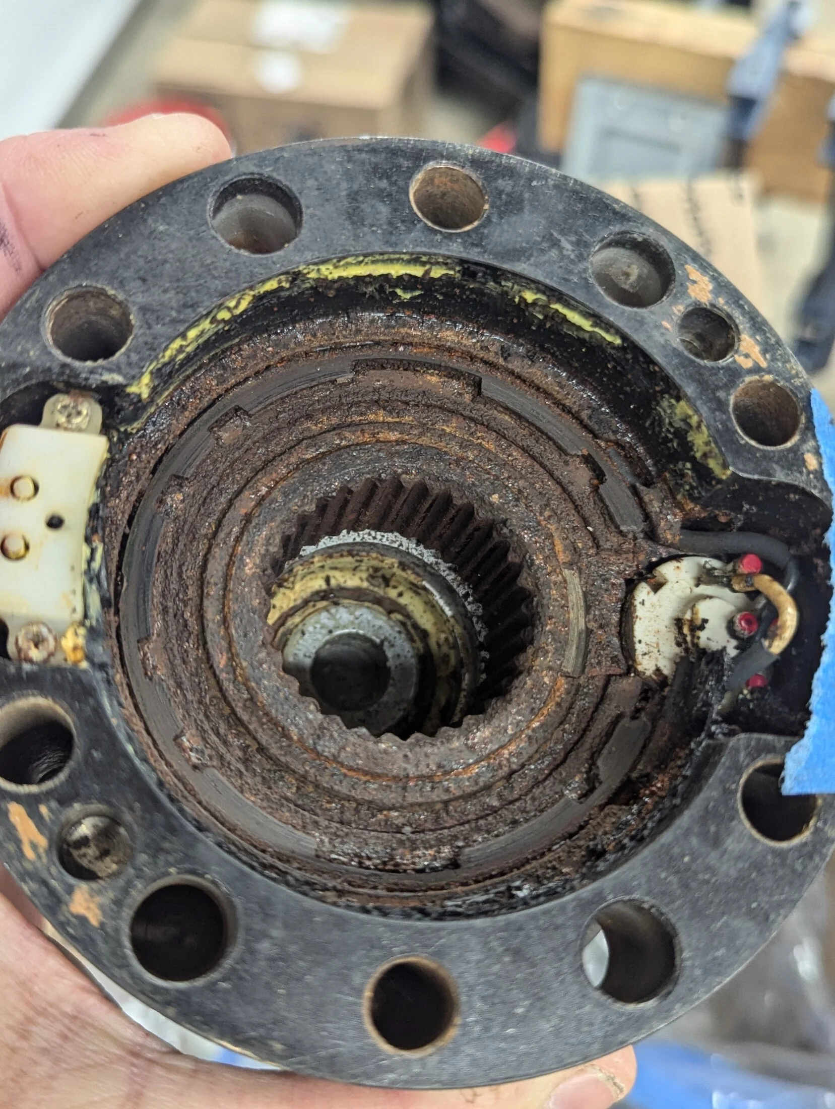

Also, I picked up a spare set of hubs today from @87BJ74... and since I've spent the last three days reorganizing my garage, I might have a place to put them, now.
I just love to savor that new-spare-parts flavor...
Pictured: It has the aroma of...iron oxide.
I know it looks crustaceous right now, but I think it's gonna clean up just fine in the end...and if it doesn't, I'll just vivisect it and keep the good bits.
Obviously, this is one of the spares that I just picked up from @87BJ74 - thanks for the lighting-fast shipping, by the way - so it'll probably end up being my trail spare, as long as it's working; I can probably rig up a test circuit with my power supply to check functionality. And as a bonus, I got a free hub and t-case switch out of the deal!

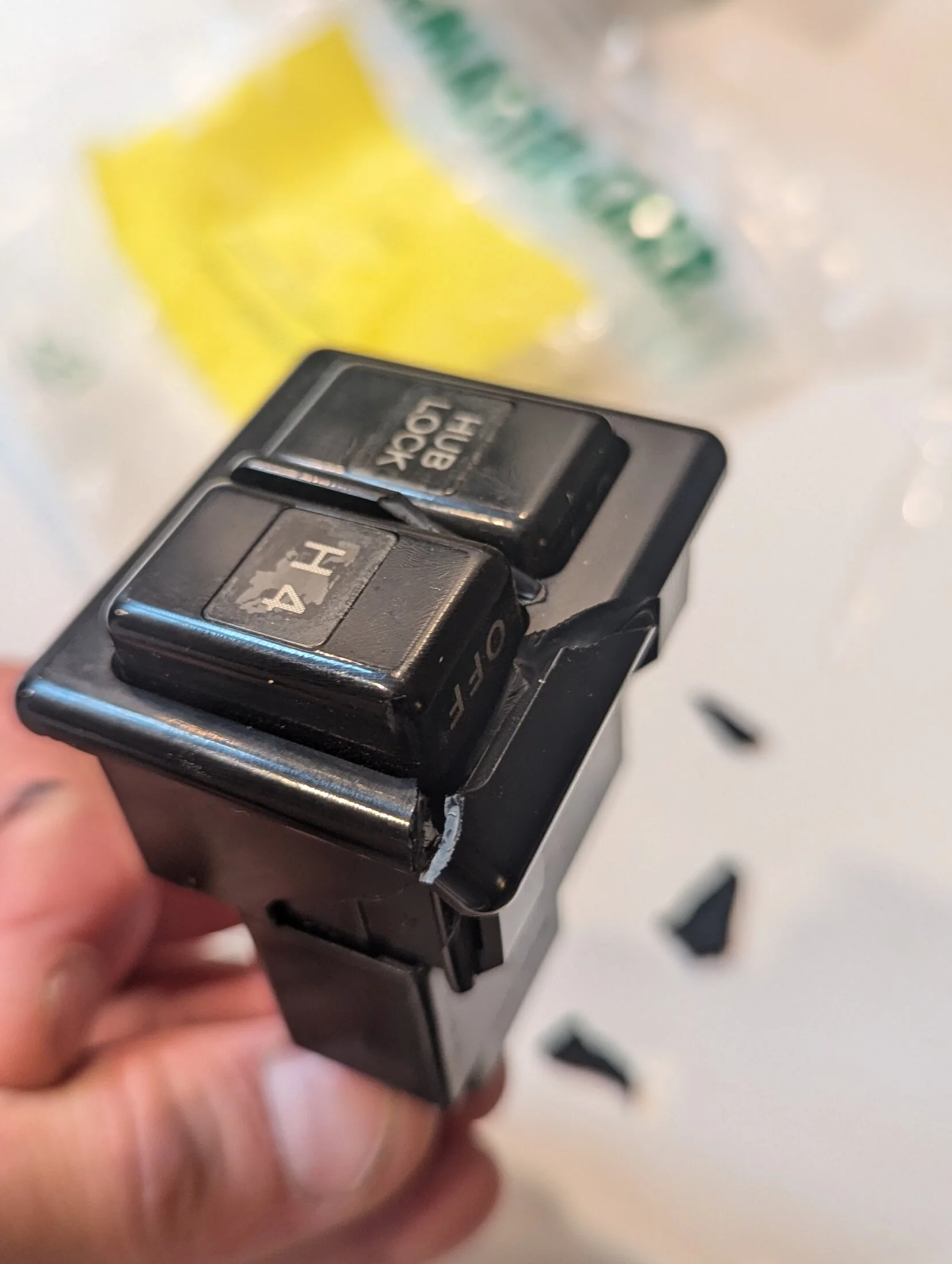

Pictured: Too bad it got Uncle Sam-handled on the way.
We just can't have nice things, it seems...
So, the front of the housing/bezel is toast, but I think the switches themselves are okay...and I might be able to replace that bezel, nonetheless. Toyota probably used it elsewhere, so it's just a matter of finding it.

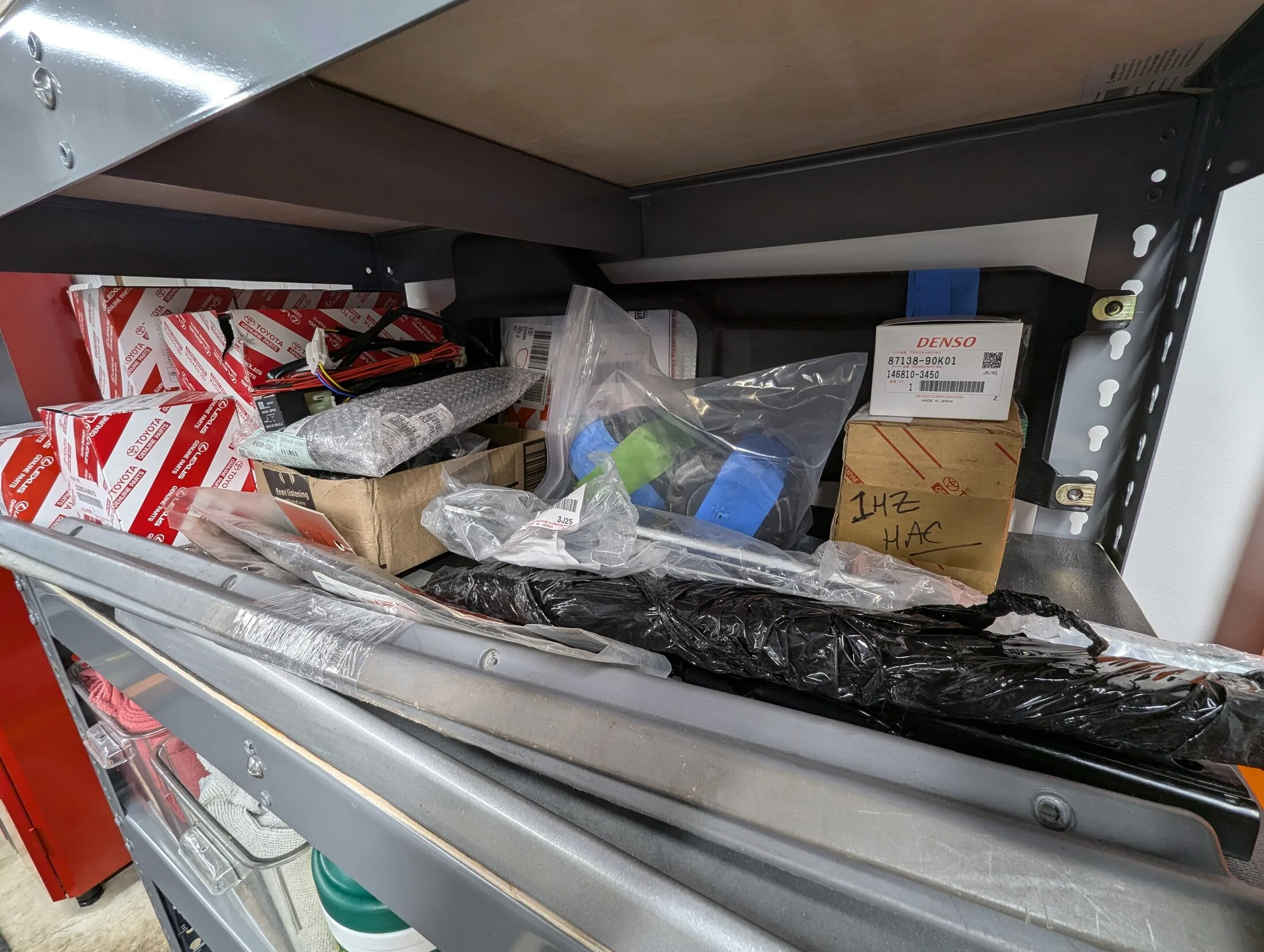

Pictured: Told you I had room for them!
...of course, I'd have more room if I wasn't keeping eight oil filters, a spare air filter, the rear quarter compartment, a few wiring harness bits, a window regulator, the HAC and every interior trim part I've replaced on the shelf, as well. Thankfully, I didn't make that mistake with my small-parts shelf; I used bins, and that means I can only f*** myself over so much.

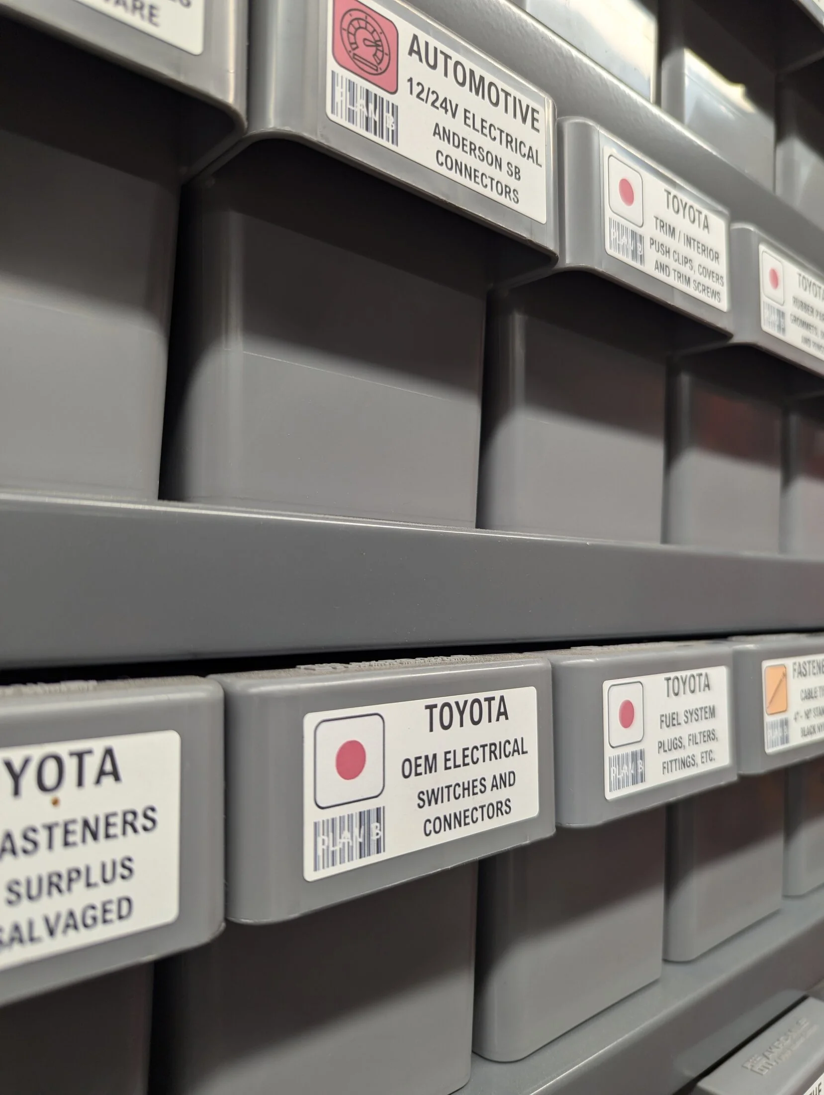

Pictured: We will have ORDER!
Of course, that system only works if you keep it organized properly; no comment on whether or not I've actually done that.

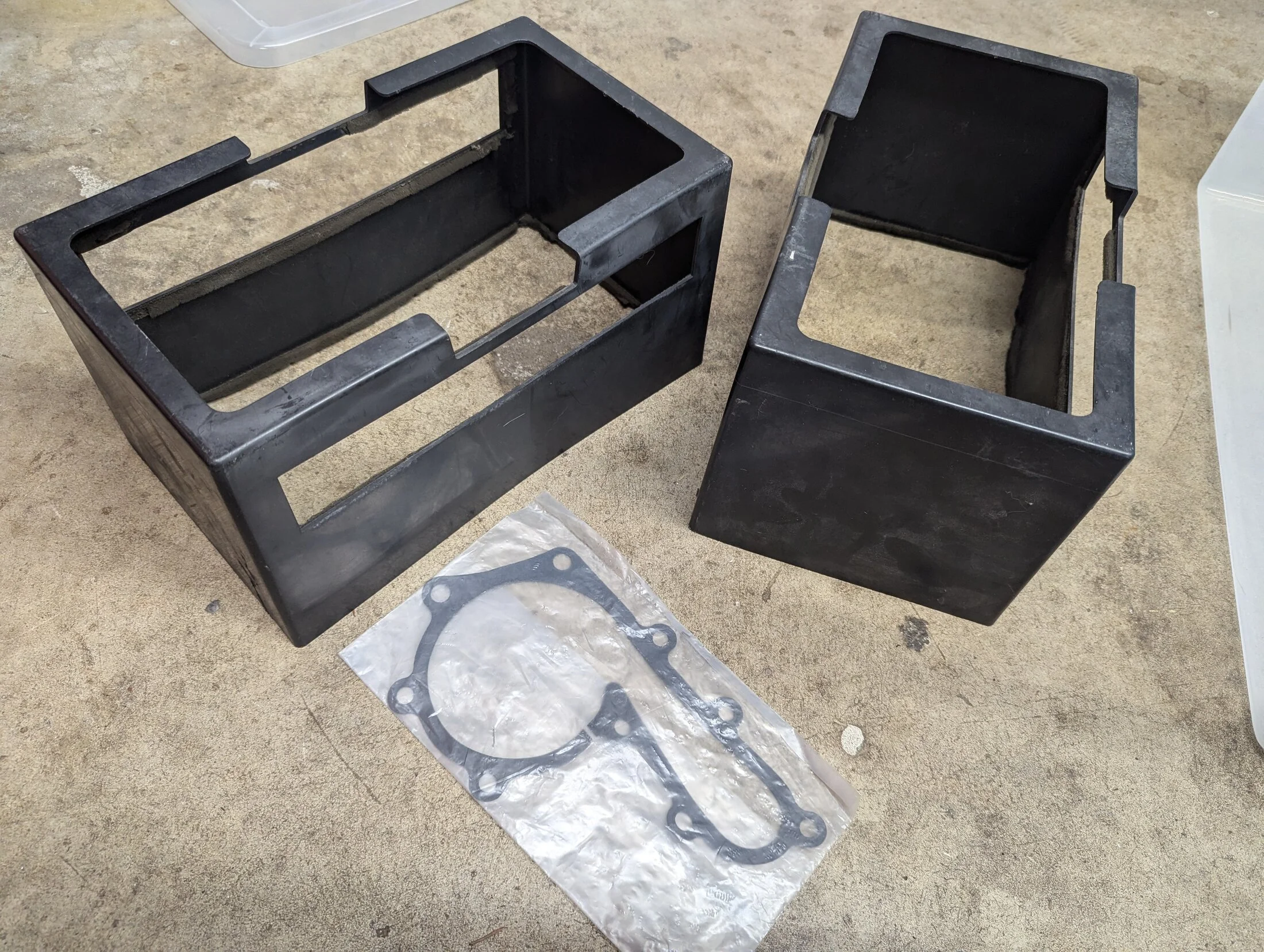

And then I started going through my box of random parts from the previous owner...

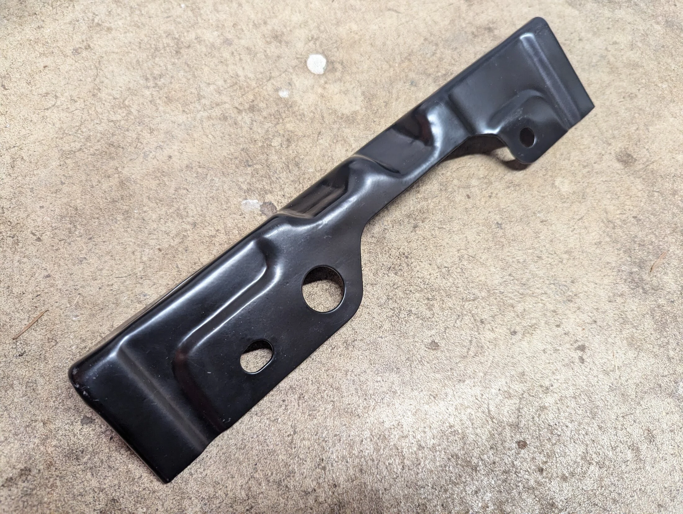

Pictured: Seriously, what the f*** is this...?
The contours and finish match the interior sheetmetal...but I don't know where it would go. Nothing seems to be missing, but that's probably meaningless because the batteries don't look like they're missing any parts, either, but it turns out that this pair of uninstalled battery covers was missing from under the hood, so what the hell do I know?
Pictured: Thank Buddha for cast-in-place part numbers.
Also, that's a broken water pump gasket...and I know that because it matches up to a brand-new, not-broken water pump; that later object was stuffed inside one of those covers along with a timing belt, and the whole shebang was tied up inside a plastic grocery bag. And right next to them, in the same box, were the pristine factory front floor mats...but all of that was overshadowed by the *other* object in that box.
