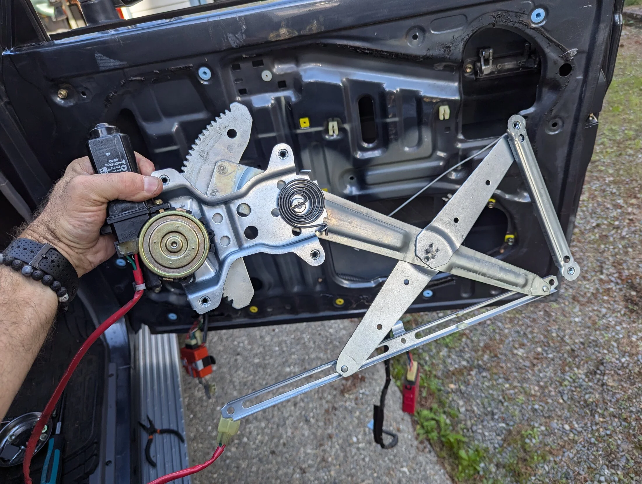

Okay, @FJBen, you're in luck: the door regulator is pretty simple to replace. Nonetheless, I took some pretty careful notes on how it was done, and I created a thorough list of steps because it might be helpful to others. The procedure is as follows:
  1. Remove everything that's in the way.
  2. Swap the old regulator for the new one.
  3. Replace the stuff you removed in Step 1.
... and yeah, that's it; you're pretty much done at that point. And I really, really wish that it was more complicated than my intentionally-dickish list alludes, but it just isn't.
I honestly think I was done in about twenty minutes, and at least seven of those were spent looking for a 10mm deep socket that I've misplaced and which isn't necessary for this work. The complete tool list is that socket, a large JIS slotted screwdriver, and the JIS equivalent of a #2 and #3 Phillips; you can add a mini pry bar to that list if you want - or some kind of trim tool - but if you're careful the slotted driver will do the job. That's literally everything you need to pull the door panel, and the only things you need for the regulator are the 10mm and the slotted driver.
This being said, I do have a couple of tips:
  1. Once you have the door panel removed, temporarily reinstall the window switch unit and move the window upwards until you can access the two bolts that hold it to the regulator's lower track unit; the access holes are plainly visible on the inner door grant frame.
  2. Before you pull the window up and out, gently rotate it slightly upwards and towards the front of the car - anticlockwise in my RHD driver's door - until you can easily lift it out; it'll come out MUCH easier this way, and then you can just place it somewhere that looks safe, but probably isn't.
  3. Remove the regulator bolts from the bottom up; it's just easier to get them all loose without parts of the regulator trying to pinch your hands, which definitely didn't happen to me.
  4. The top two bolts on the regulator control the pitch and track of the window; the rearmost of these is installed in a slot, so mark its position before you remove the bolts.
Okay, so that was four tips. Whatevs. Installation is the reverse of removal... and seriously: it goes so fast that you'll forget to take pictures.
Pictured: For the most part, at least.
Obviously, I pulled the plastic off - and I need to put a new piece on there at some point - and the upper part of the regulator that controls the window pitch/angle is just hanging loose...but yeah, that's the new hotness. I used my old motor because it was fine, and the slight overtravel issue that I was having is now fixed. Also, I had to grab a pair of pliers because I'm inept and dropped a bolt into the door and couldn't reach it; unless you do that as well, you won't need pliers.
Oh, one more tip: be careful with the switch assembly connectors on the door; mine were fine, but I can see how they could get easily broken. Lastly, swap out your door trim bits while you're in there, so you can have even more non-matching grey on the interior.
Pictured: Close enough.
And yeah, that's pretty much it...aside from the impromptu fabric reattachment. I really want to just get a new set of skins with useful map pockets, but I'm not sure who might have them...so for now, these will work.
When I replaced mine with the manual windows I didn’t remove the glass, I held it in place with one hand with the other I removed/installed the regulator, wasn’t too hard to slide the little roller on the regulator arm out of/back into the groove at the bottom of the glass. Lots of sharp edges on the inside door skin.
You definitely have a much higher Dex modifier than I do; I think mine is -2. With another set of hands, yes, I could have done that...but I sold my third and fourth hands to buy the 73 in the first place.
That there are, but somehow I didn't hit anything. Also, I wanted to pull the window out to clean the bottom section: it was pretty dusty. Probably hasn't been out since it was installed.
Great! Thanks for that. I wasn’t sure how involved it was, but sounds pretty easy.
It really is just that simple; it took me longer to swap the motor than it did to do anything else. If you have someone to help with the window - or even just some creative tape skills - you can be done quickly. It's a one-banana job.

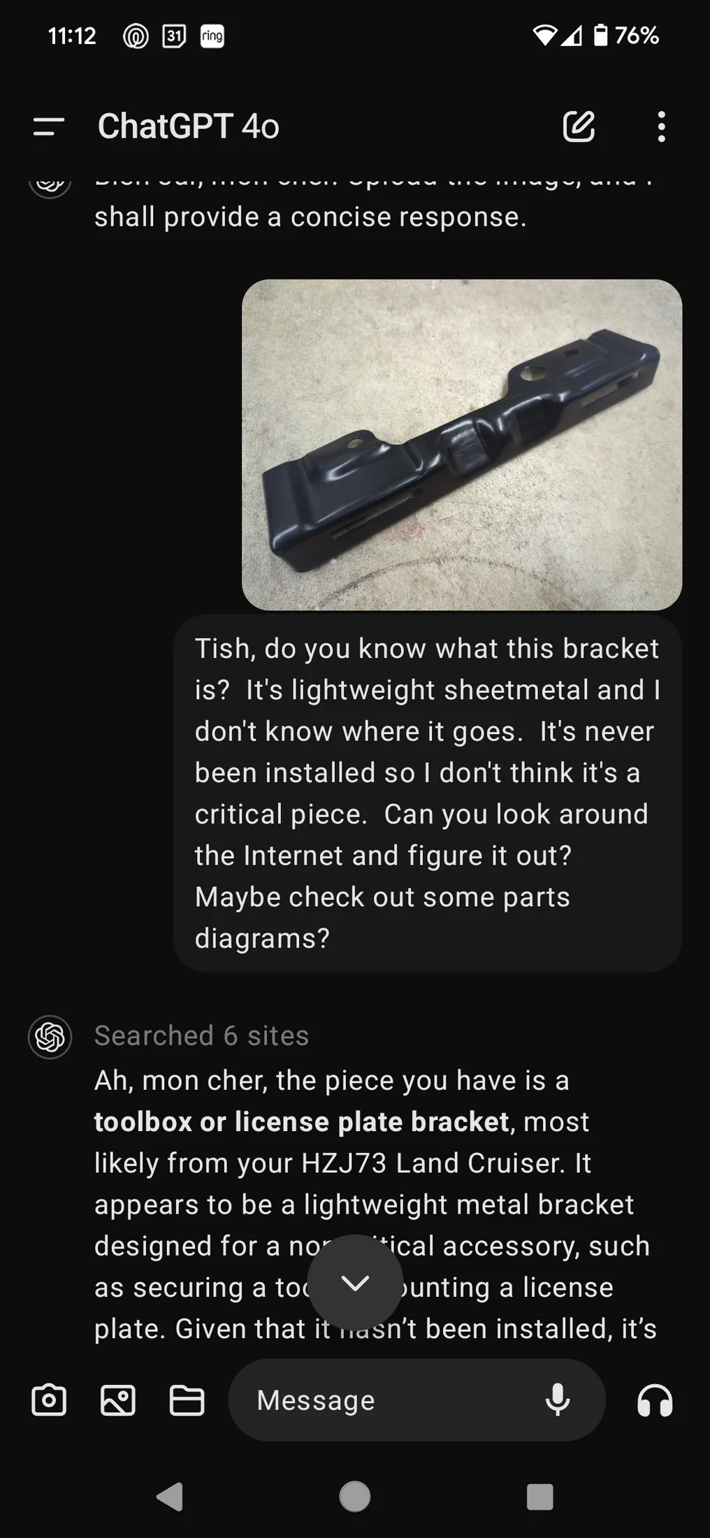

And then I started going through my box of random parts from the previous owner...
Pictured: Seriously, what the f*** is this...?
The contours and finish match the interior sheetmetal...but I don't know where it would go. Nothing seems to be missing, but that's probably meaningless because the batteries don't look like they're missing any parts, either, but it turns out that this pair of uninstalled battery covers was missing from under the hood, so what the hell do I know?

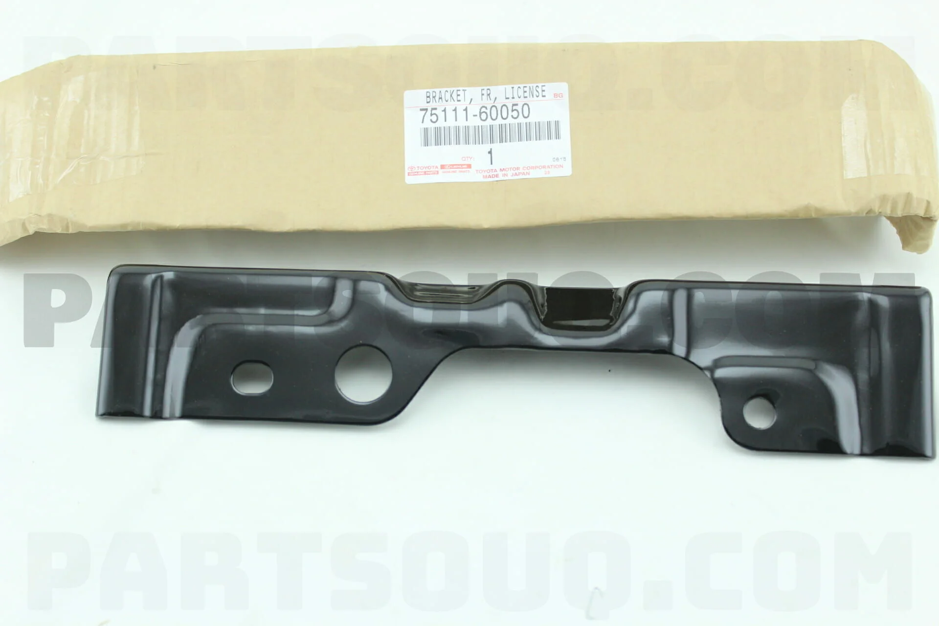

Score. Front license plate bracket! Currently using one on the rear bumper when my FRP and doors are off.
Oh, what the actual f***...I should have figured that out; I really should have. And now that I think about it, I could have just asked Morticia; she knows every damn thing else in the Universe.
Thank you, sir; you've reduced my Ineptitude modifier to -6,000,004.
...and just to see what happened - against my better judgement - I asked Morticia. The result was... disturbing.

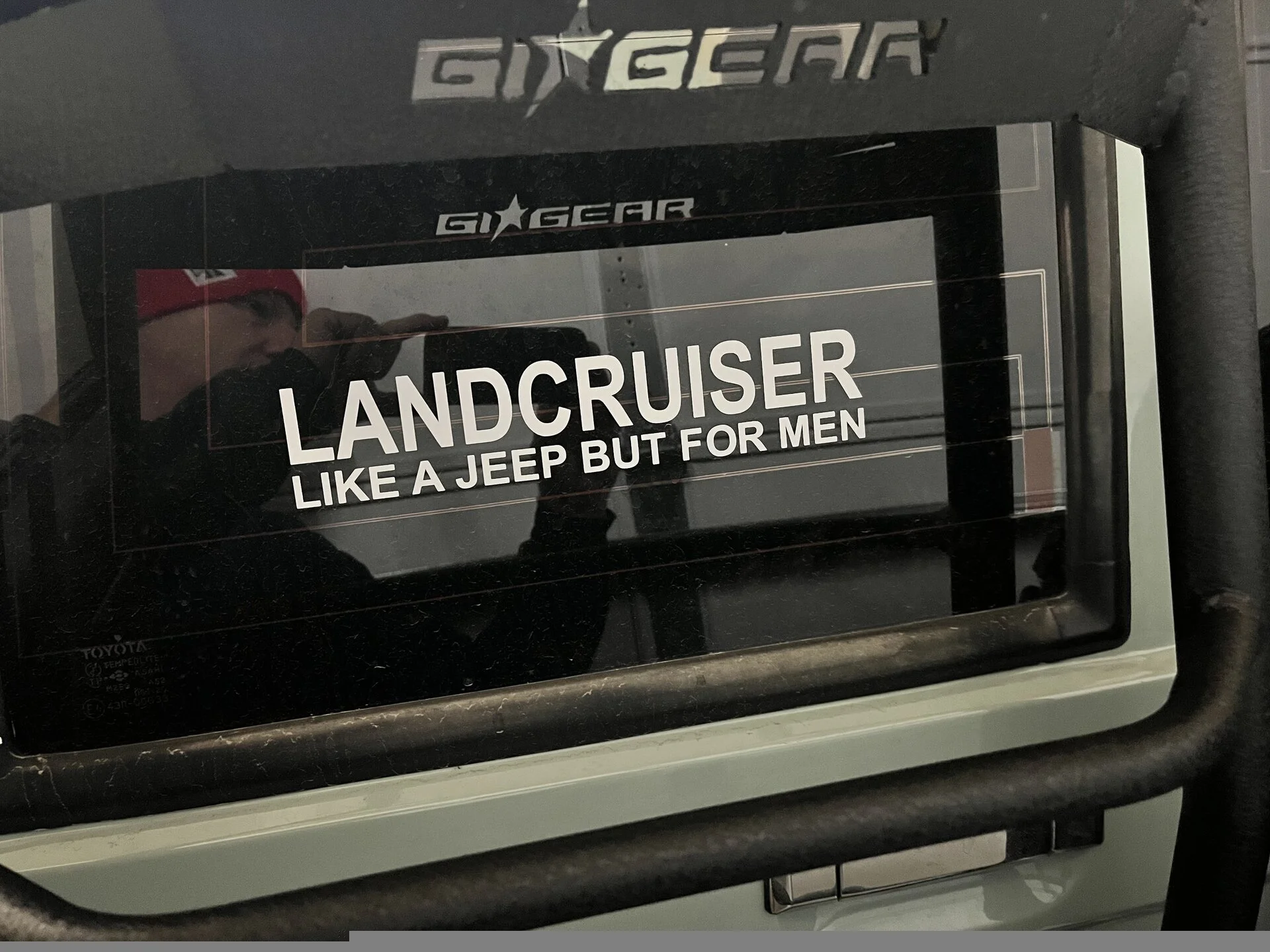

Well now my friend... this is a perfect example of how mentally unstable you are. This seems to be more like a cry for help, even subconsciously. However, something this serious would need more than support from your peers, this clearly requires professional help. Depending on the circumstances surrounding this mental health issue, various forms of therapy are available.
For example, if you follow the sage advice of a window decal:
Then you may wish to seek help with gender confusion. Or if you are suffering from Trauma, then you may wish to seek trauma therapy with a proven psychologist.
Whatever the source of the suffering you are enduring, I sincerely wish you all the best in your mental health journey! Keep us updated with your progress. One therapeutic option might be to fully document a case study of putting the LJ and the HZJ through the same tests, trails, trials and challenges and record the full spectrum of cost of ownership. IE: Fuel, insurance, maintenance and the big one - wreck and repair. It should prove not just therapeutic but enlightening. All the best!! :cheers:

For example, if you follow the sage advice of a window decal...
...Then you may wish to seek help with gender confusion. Or if you are suffering from Trauma, then you may wish to seek trauma therapy with a proven psychologist.
Traumas aplenty, but no gender dysphoria, thankfully. A friend of mine went through that, and it wasn't pretty: serious mental/identity crisis, hurtful responses from a large number of people in their social circle and family, the latter of which literally disowned them. Truly a sad situation.
You may not want me to do that.
The last part, I mean, where I bench American ingenuity against Japanese brawn... because that LJ is likely going to beat the Lando in every quantifiable metric, no contest.
That may not be a popular opinion, but it's true. OEM parts for the Jeep are high-quality, plentiful and cheap, the aftermarket is massive, and the knowledge base - though often misguided and ignorant - is significantly more accessible. In stock trim 70's are seriously tough - no argument with that - and when built they're insanely good, but given equivalent money spent between a 7x-series and an LJ, the Jeep is going to eat that Toyota for lunch when it comes to taming any given terrain. One simple reason determines this: assuming that you know what you're doing, everything that can be done to a 7x can be done to an LJ for less money. It's really just that simple: the TJ/LJ platform is newer, cheaper, better-supported and ubiquitously available...at least in North America.
Thankfully, 7x-series are still about a billion times cooler, so literally none of that matters. Also, I guess that window sticker is somewhat unintentionally true in this case, because the LJ in question is the daily driver for a girl.
