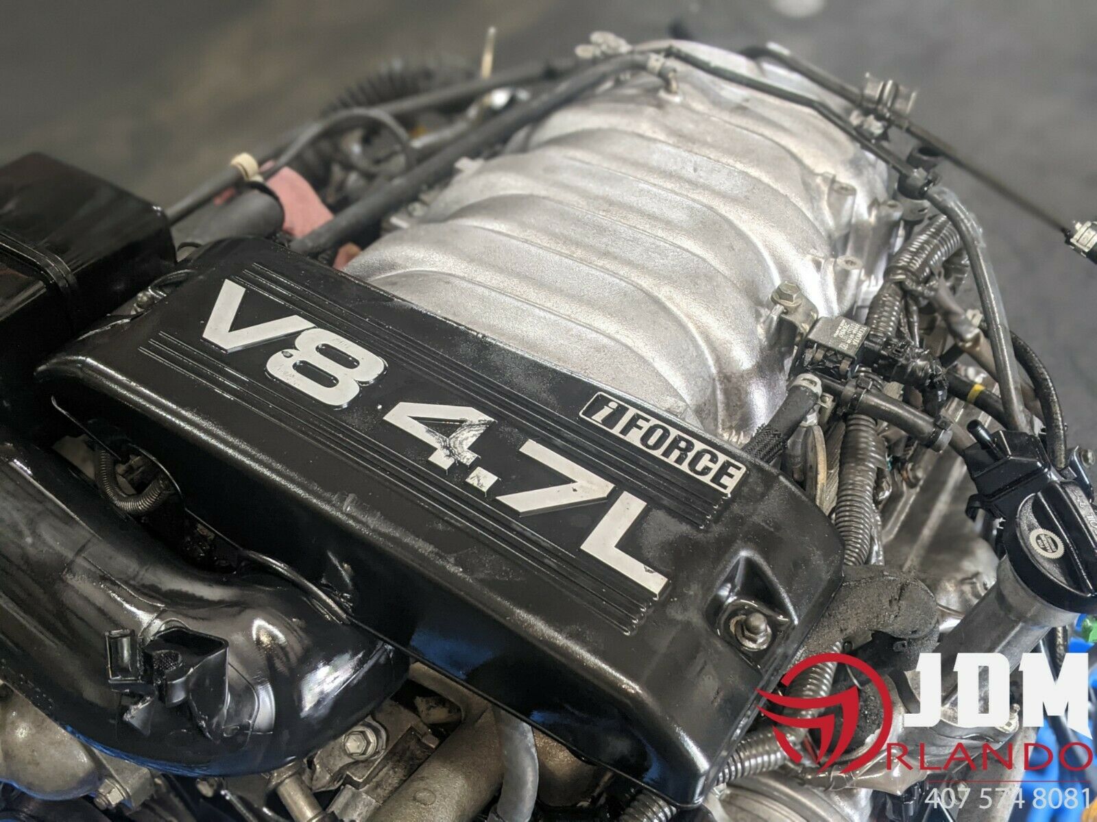

2) Or find a replacement engine. You will not find a JDM 4.7L 2UZ engine. Anyone claiming to have one for sale, is a rip off. Finding a good 4.7L 2UZ, takes a lot of homework/inspecting. It's not just grab and go with the best deal.

Clarification on the possible engine replacement, Shop #2 didn't specify the possible replacement engine would be JDM, I think I added that, I've gone down that road before with a Honda Element, so when I think Japanese car engine replacement, that just popped in my head. In thinking back to the conversation, I don't think he said JDM. All that said, it may not matter, because they can't find an engine anyway. My LC was an early production date for a 2005, it was built 08/04, and there was a split in 2005. Engines for after the cutoff date (I don't know the date, just that there is one) are available. Engines for LCs built BEFORE the cutoff date are not.
All that mean that if the diagnosis is correct, the only option may be replacement of that left side head. New is available, but expensive. Not sure about rebuilt availability or price for an early 2005 engine.

May 2005 was cut off date. After that they are the VVT (06-07) 4.7L 2UZ-fe VVT. Any (100 series best) 4.7L 2UZ-fe non VVT will work. If a 100 series 03-05, it's a drop in (less labor)

Just thinking ahead, if I still need to be considering a replacement engine, and no engines are available for a 08/04 manufacture date Land Cruiser, what has to be swapped over to make the right year Tundra 4.7L work? Manifolds, intake? I think the Tundra engines were US built and the LC engines were Japan built, but not sure what else is different about them.
