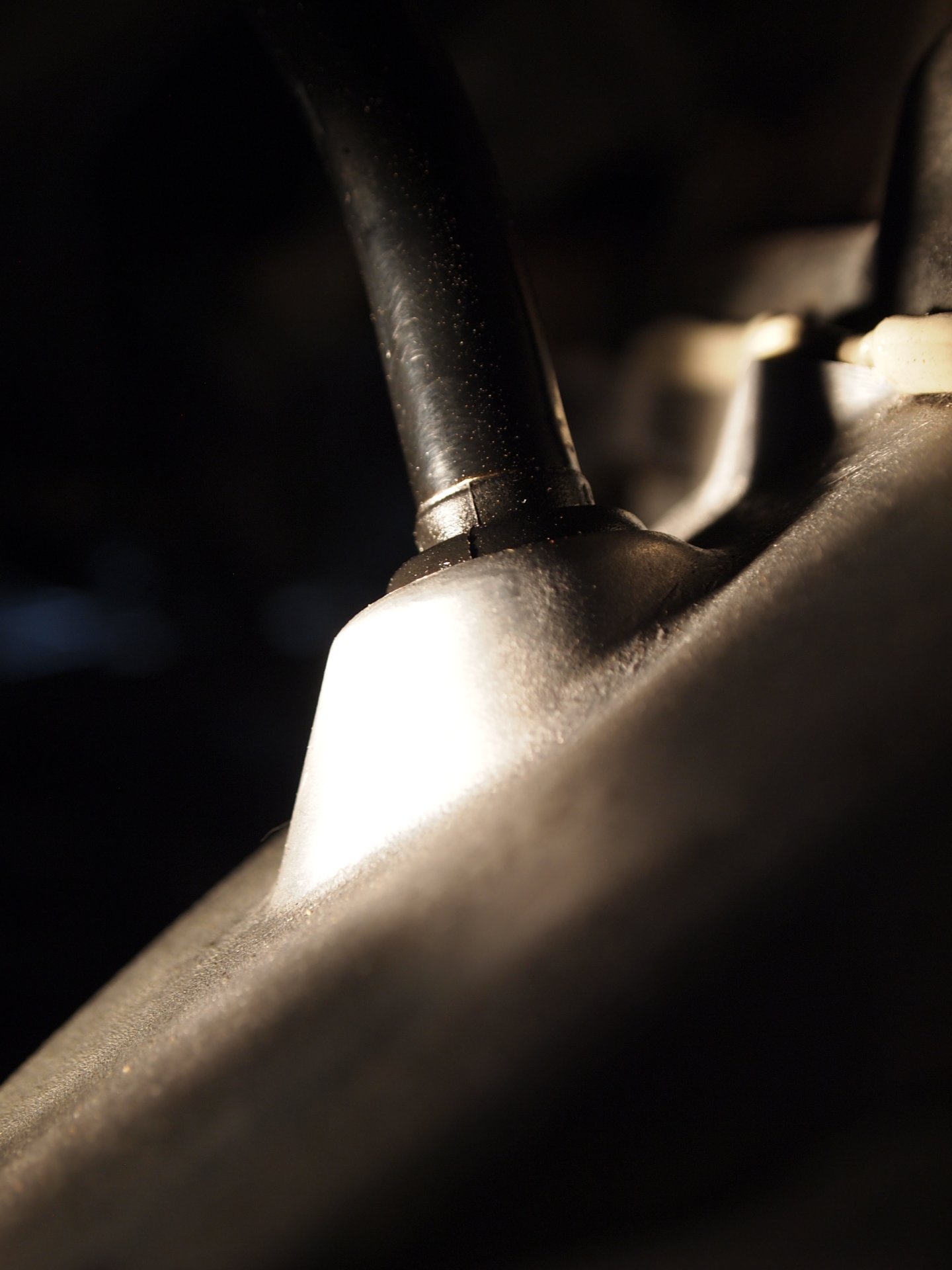

You don't want the sand drop into pan.

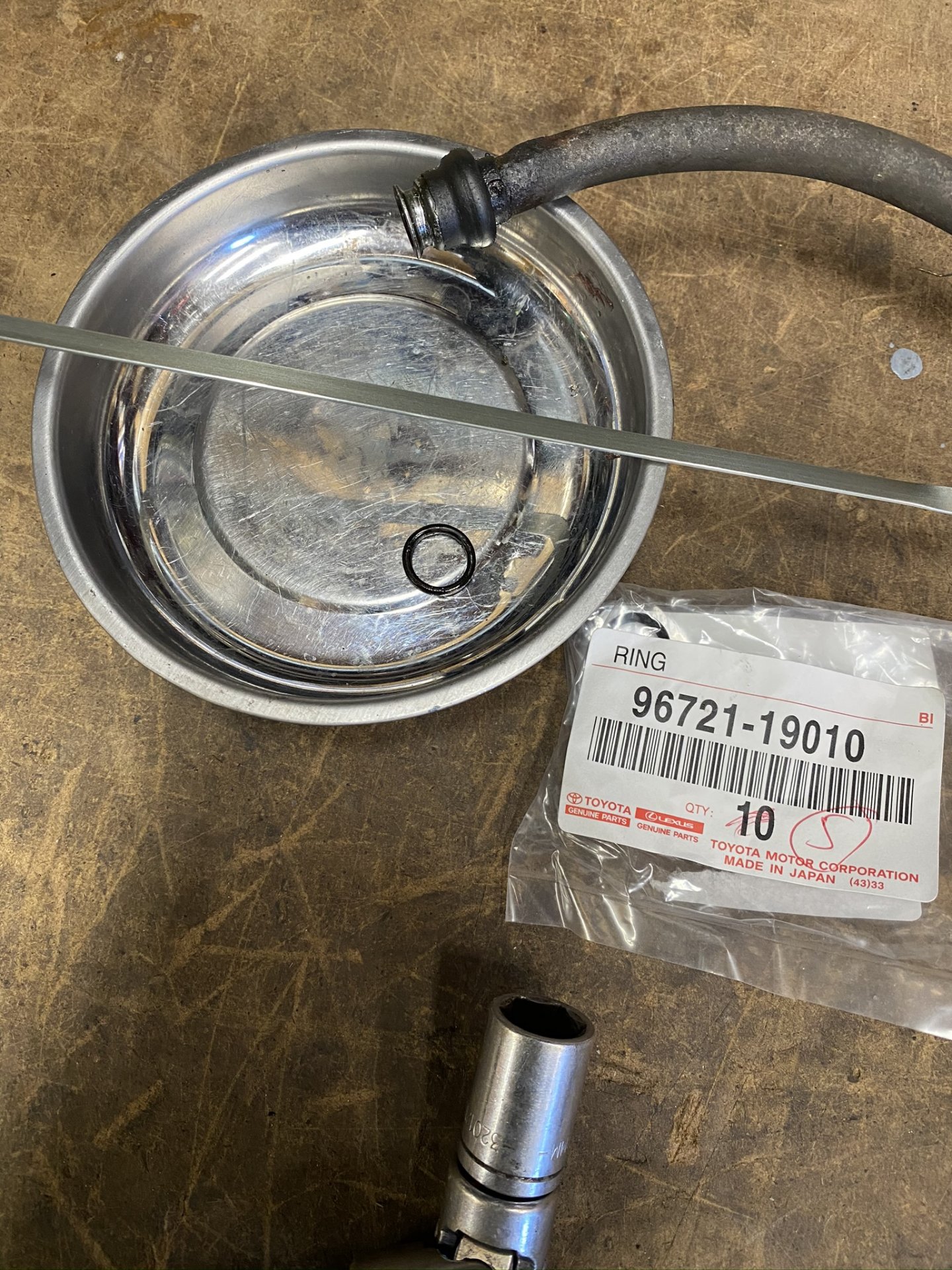

So if replacing the O-ring that seals tube to pan.
Clean area really well, before pulling tube from oil pan.

So if replacing the O-ring that seal tube to pan.

Good advice from @2001LC - replace the oring asap- I predict it will start leaking there soon otherwise.

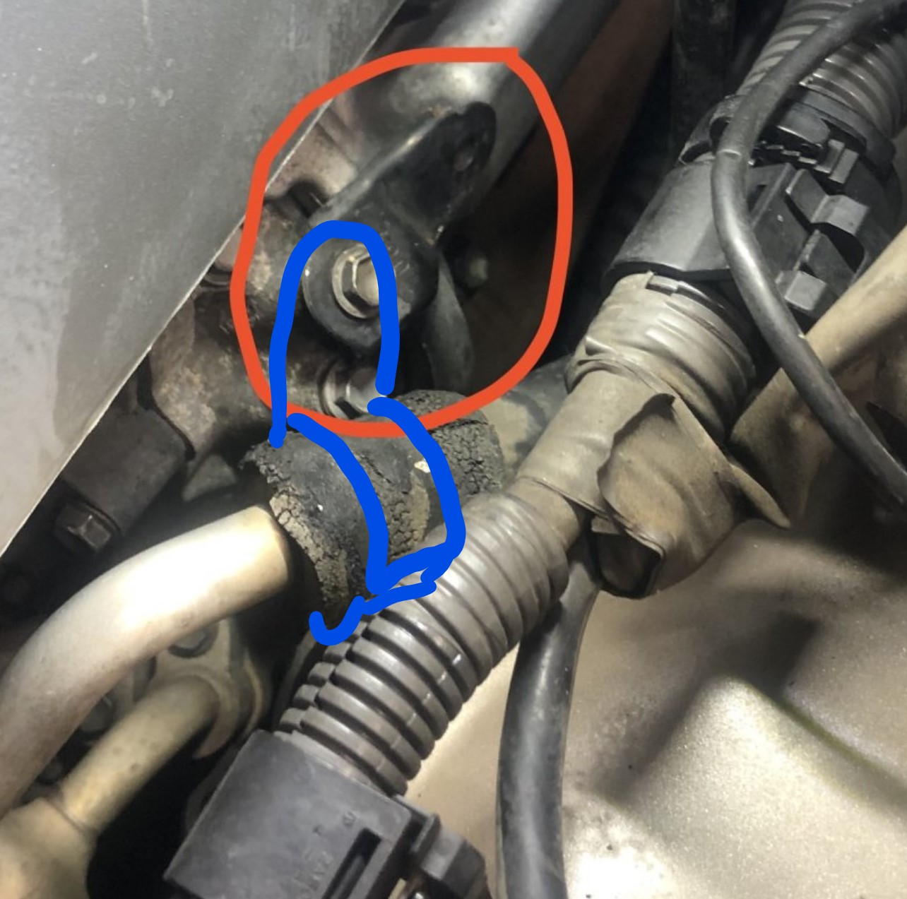

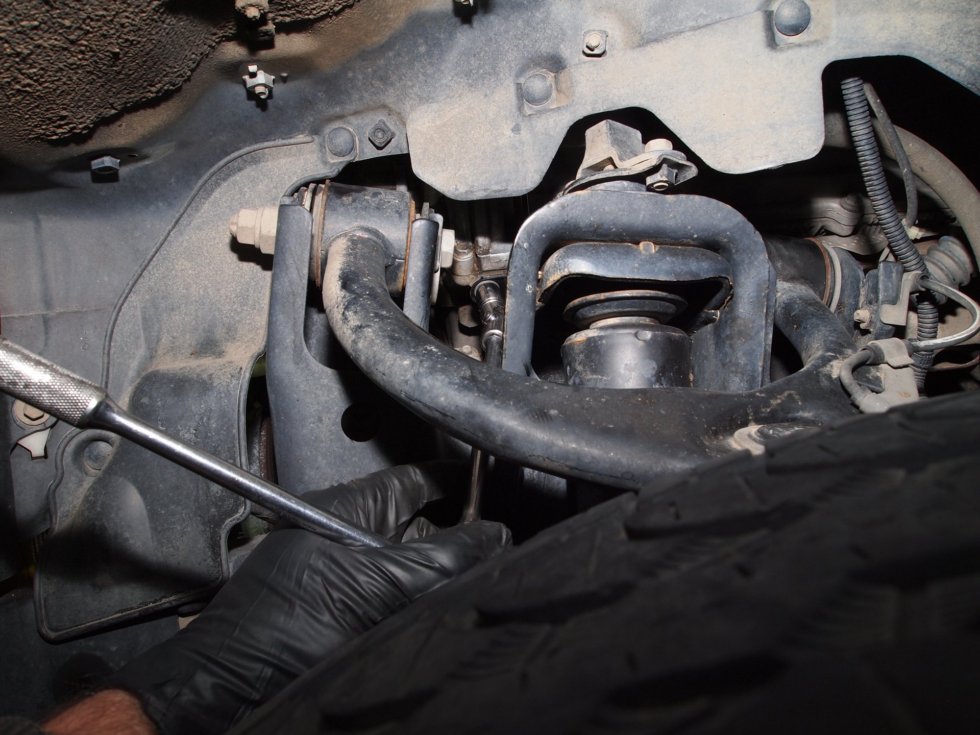

Okay, I've taken the smash shield off to reconsider this. Base on your pics, @2110LC, ir looks like the shop reattached a bracket in the wrong place. This the view from the top of the engine. Is that circled bracket/tab supposed to be there? There is no way for the dipstick tube tab to reach that bracket. Is that circled bracket supposed to be on one of the lower bolts visible through the wheel well?

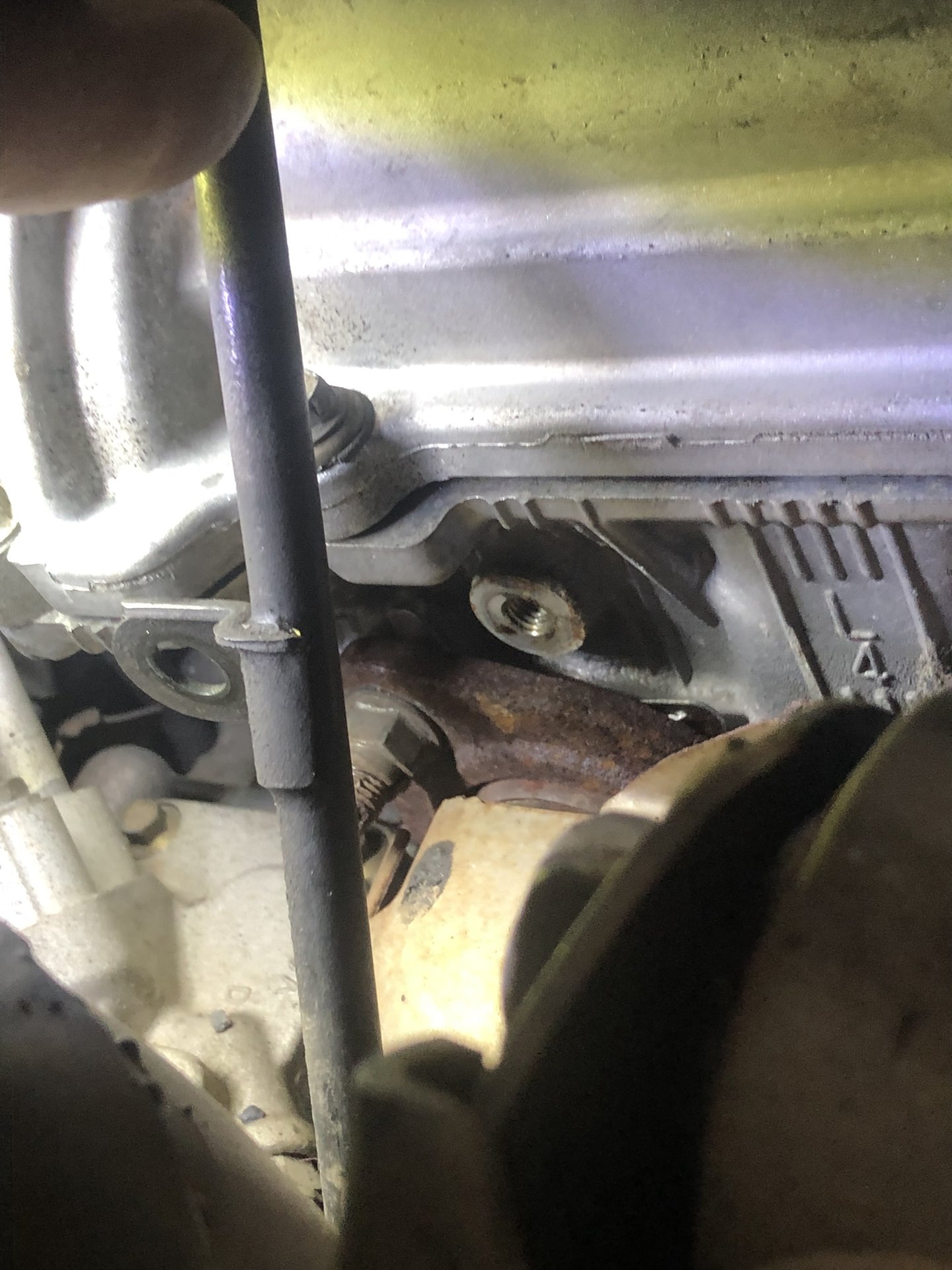

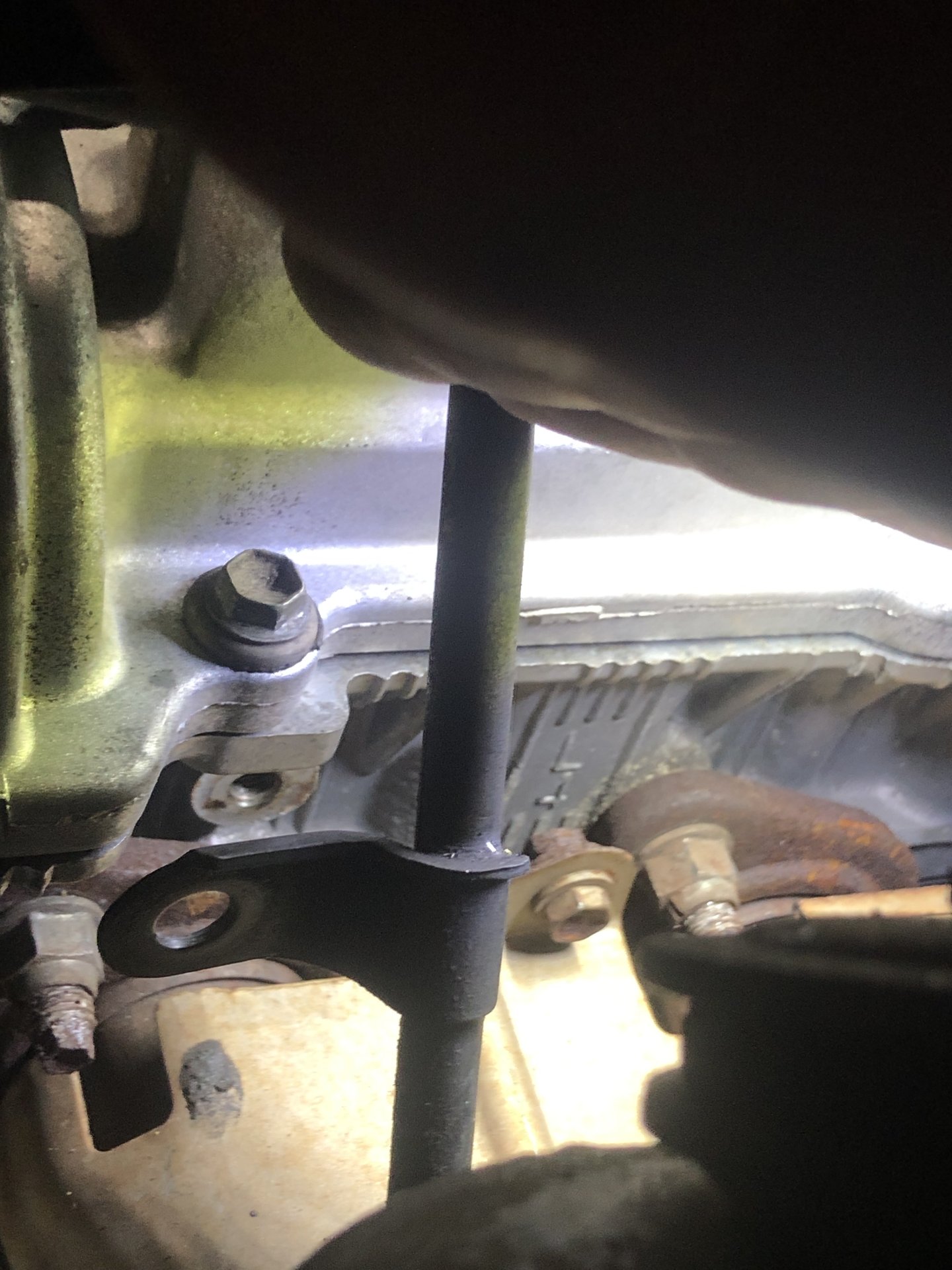

Here are the pics from the wheel well, you can see the tab on the dipstick tube.
The bracket you circled in red is suppose to be where the AC hose clamp connects to. See my sketch in blue. It looks like you might be missing the clamp.

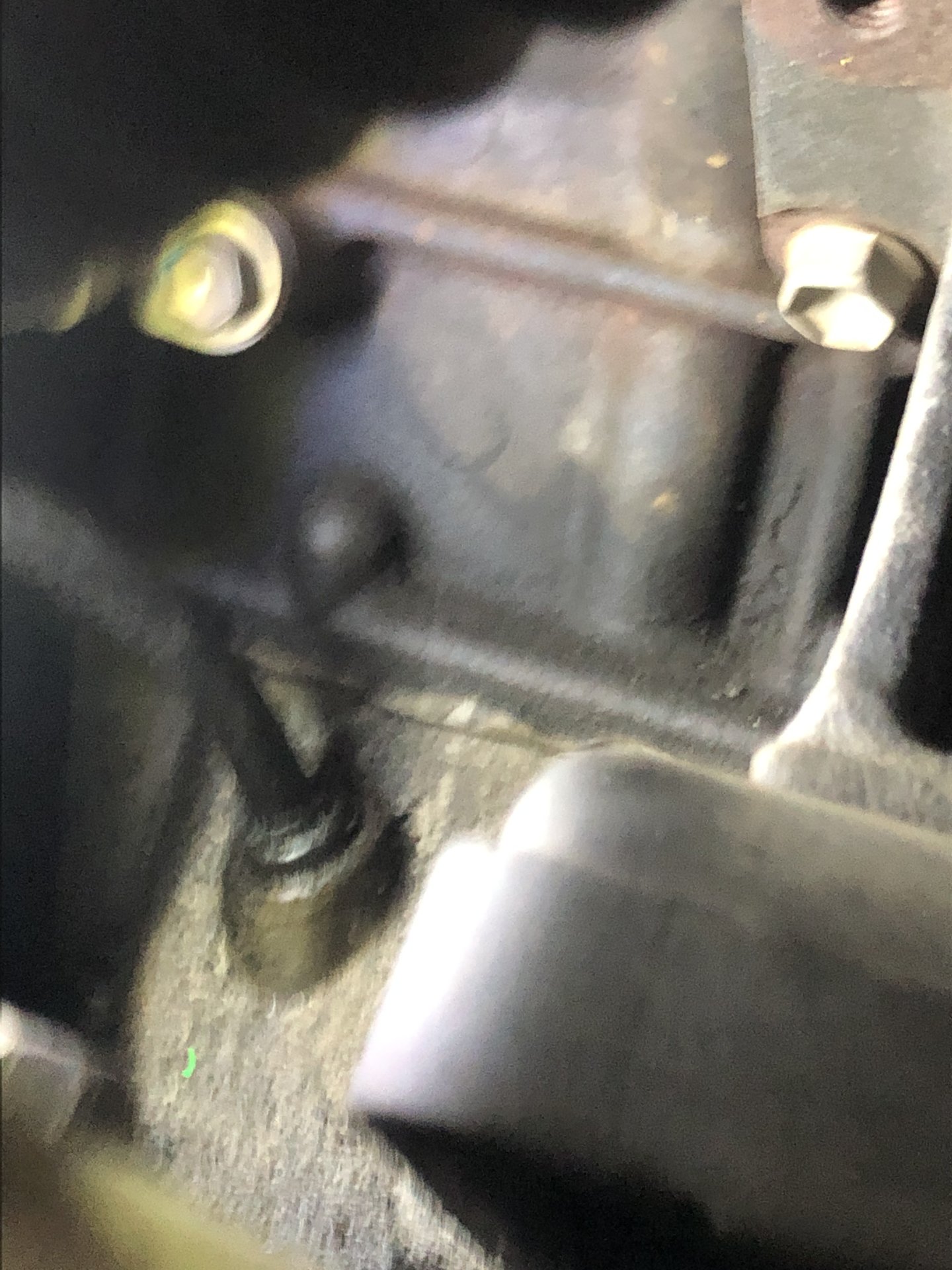

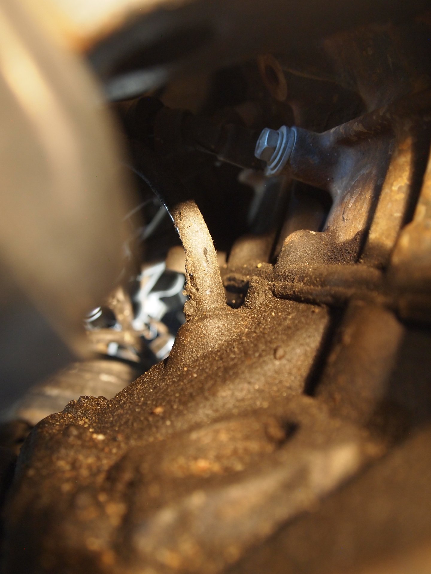

In the second picture, the bolt location you are looking for might be this one...
What is that bolt holding currently?
That bolt is the top most bolt on the exhaust header

the blue circled bolt is the topmost bolt for the exhaust header. Slightly to the rear of that bolt, and slightly above is a threaded hole in the cylinder head. Looks like something is supposed to be there. Problem is with the exhaust header in the way, no way the dipstick tube mates up directly to that.
