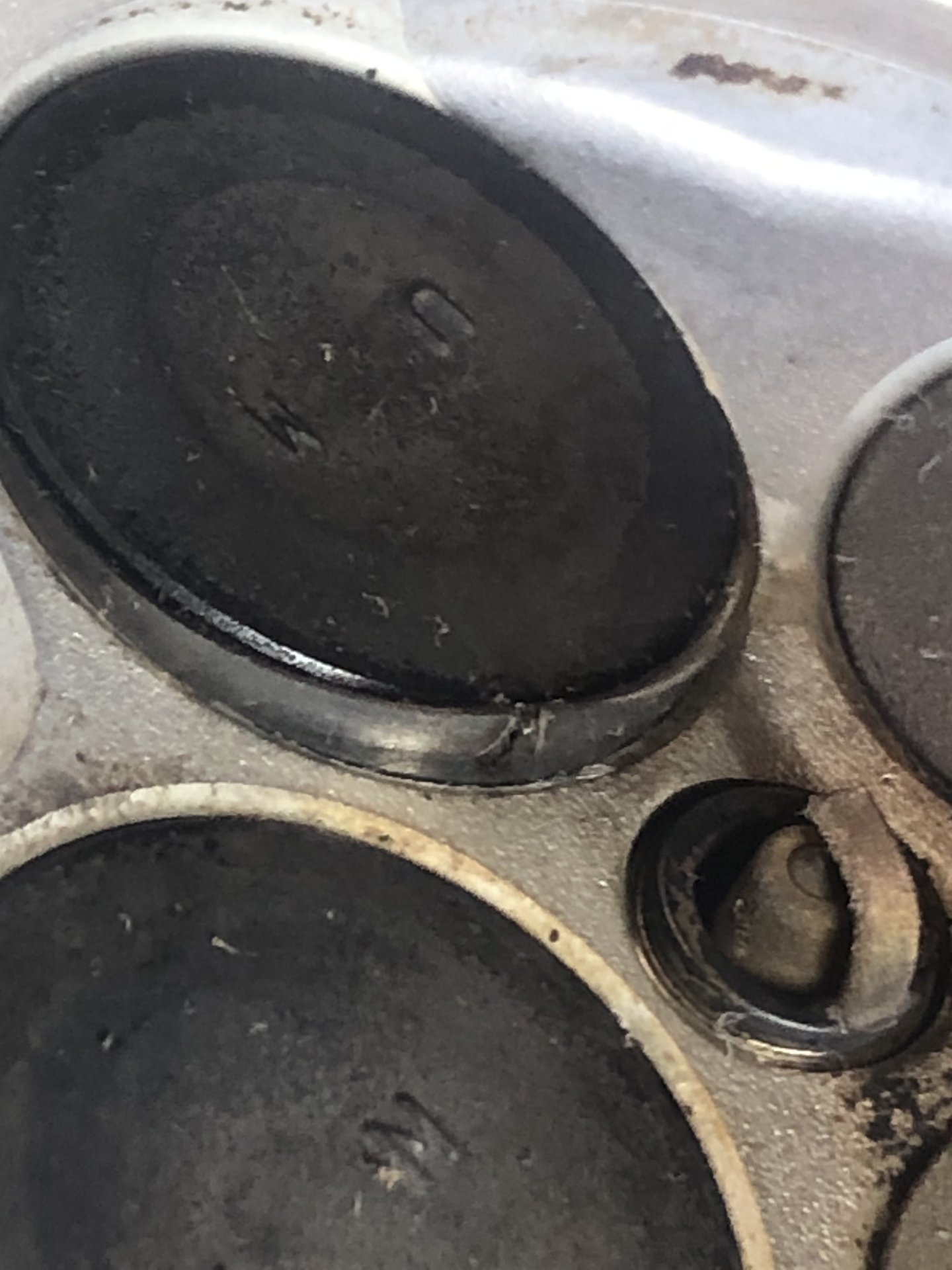

I may have used the wrong language a few times in this thread, as it has gone back and forth. My understanding is that the valve seat broke, but I have not seen pics showing exactly that. I’ll ask the shop for photos, and I’ll also ask to retain the broken parts after the repair.
and the old head as well-

Here are some photos of the dropped seat in cylinder #1
WOW! Looks like you got SERIOUSLY lucky with the way that seat dropped! Nice!
That's amazing.
How’s the piston look? Looks like the seat is damaged-prob contact with valve but some tiny shrapnel is present on the seat
