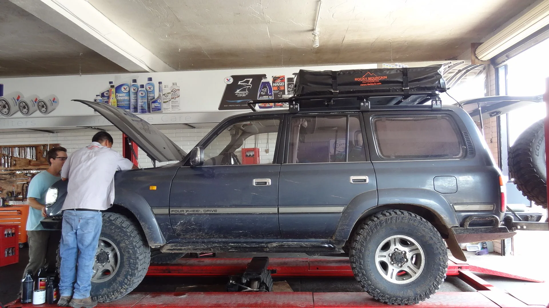

At the start of our road trip, we went to ebi cruiser in vancouver where John(former ATEB owner and diesel guru) did a bunch of work on the truck.
Power rod mod
Valve clearence
Changed all the turbo hoses
Brake bleed
Oil change
ACSD delete
Pump timing adjustment
Boost controller
Since that It is a completelly diffrent truck. I run 15 psi boost and now my egt are now muck lower. I used to have to be carefull going up big hills but now even in warm weather and 3500m elevation I never hit 1200f pre turbo. The extra power is great too. I can maintain 75mpg up big hills, at gvw with a rtt and 35"tires. I average 22mpg with crazy mexican roads.

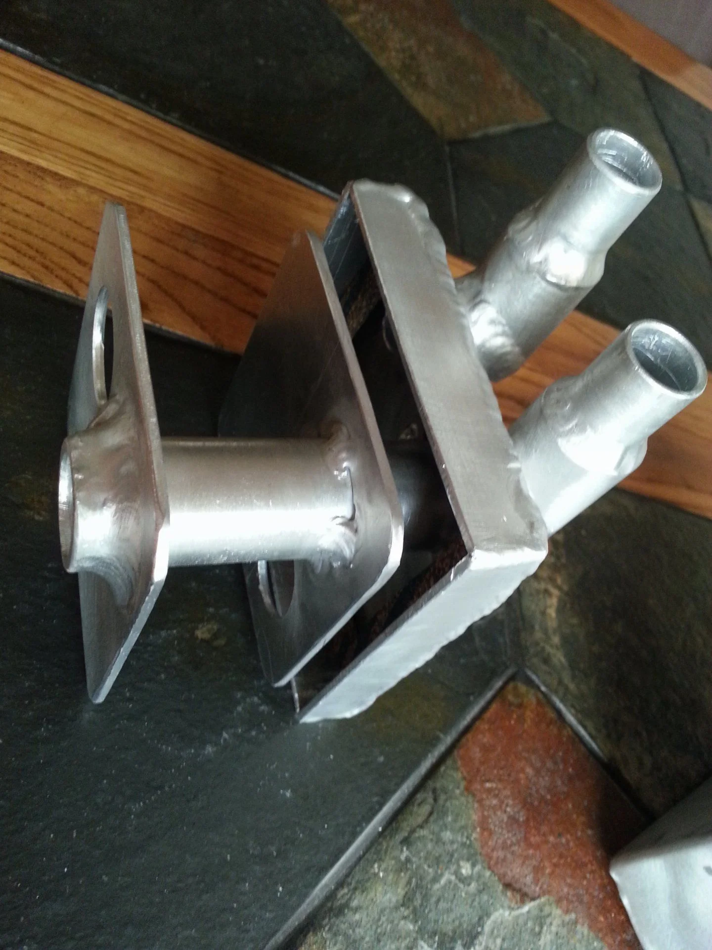

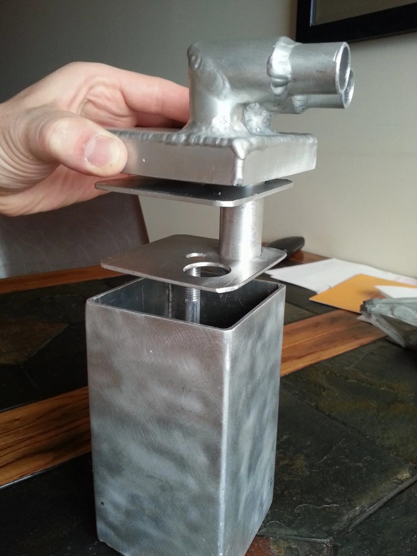

Got myself a new tow to help with the fabrication of several mods for the rig.

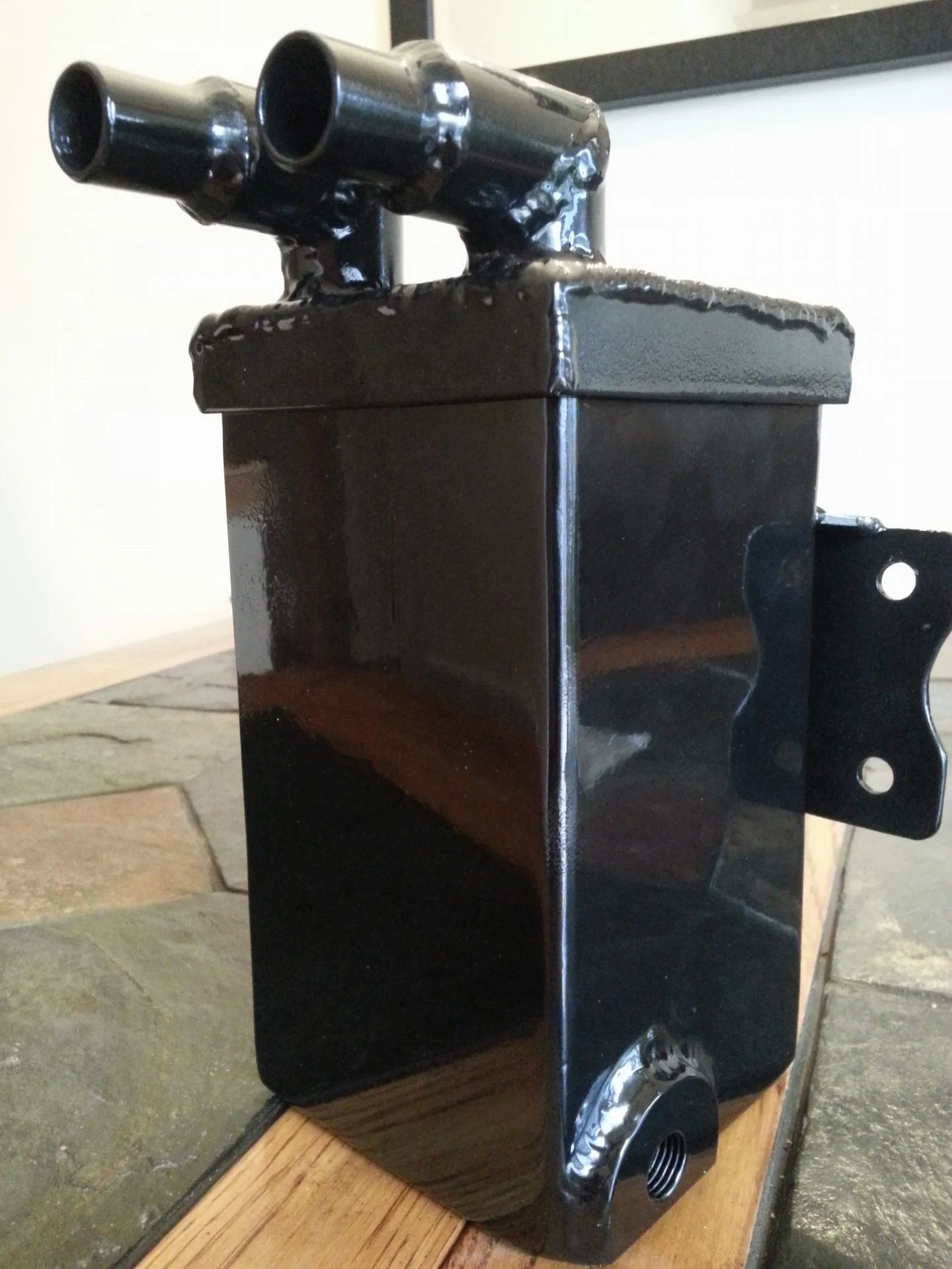

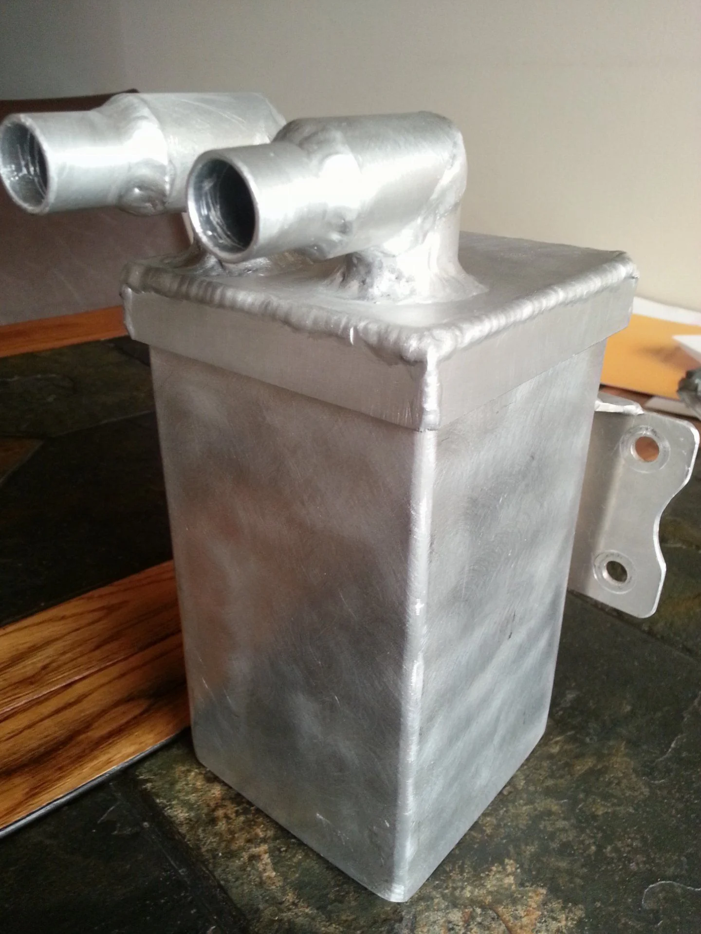

I first started with an oil catck can to reduce the amount of junk going in the intake. I could of bent a lot of the aluminum instead of welding it all but the goal was to practice before i take on the intercooler build. There will be ss scrub pad material between the baffles to help catch all the oils and contaminants.

Finished the catch can install. I added a drain valve at the bottom and used some silicone heater hose I had kicking around to connect it all up. If the silicone deteriorates ill just change to proper pcv hose.

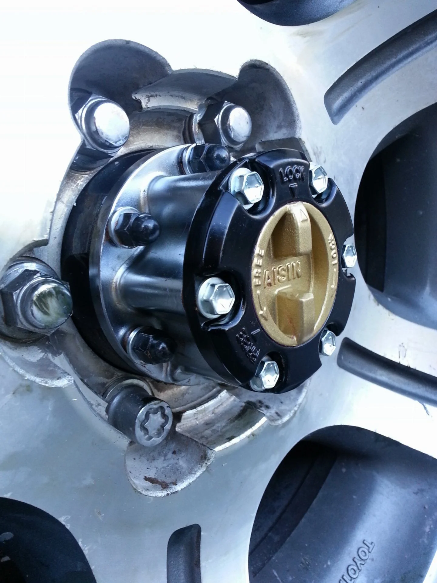

I also installed a part time spool in the transfer case to convert to part time 4wd. I opted for the Lokka brand. delivery took just about 2 weeks. Install was quite easy and took me evenings to complete. I also purchased and rebuilt a set of used 60 series Asin hubs. All included the hubs set me back roughly 200$. wile I was in there I changed all the hub studs and hardware.
First impression is good so far with noticeable lighter feel in the steering and better accelerations. But the greatest change is in the complete elimination of the light drive line clunk I had when quickly pressing the clutch after accelerating or accelerating from idle and compression.

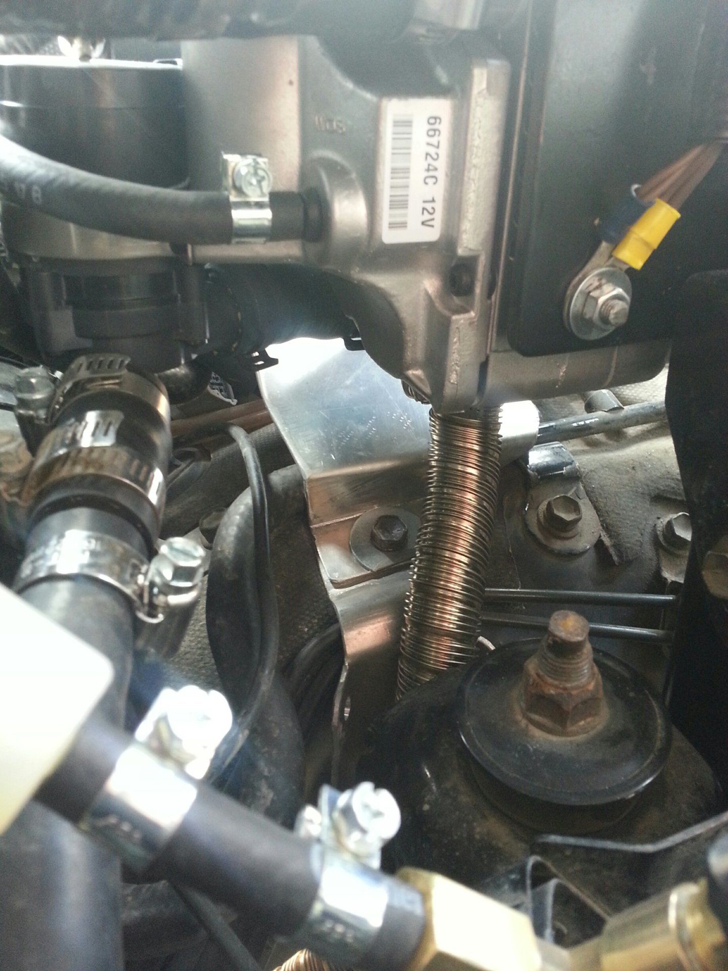

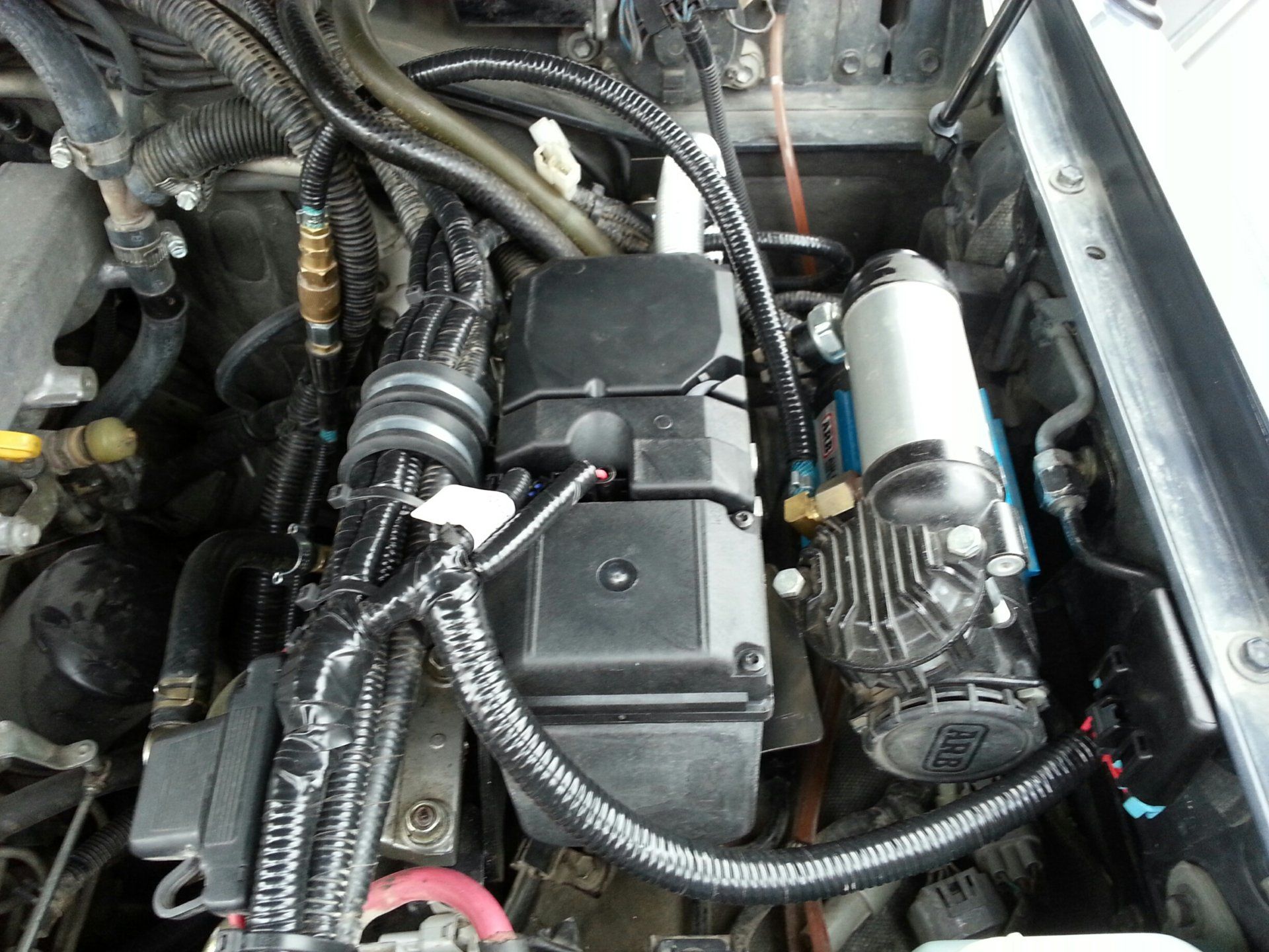

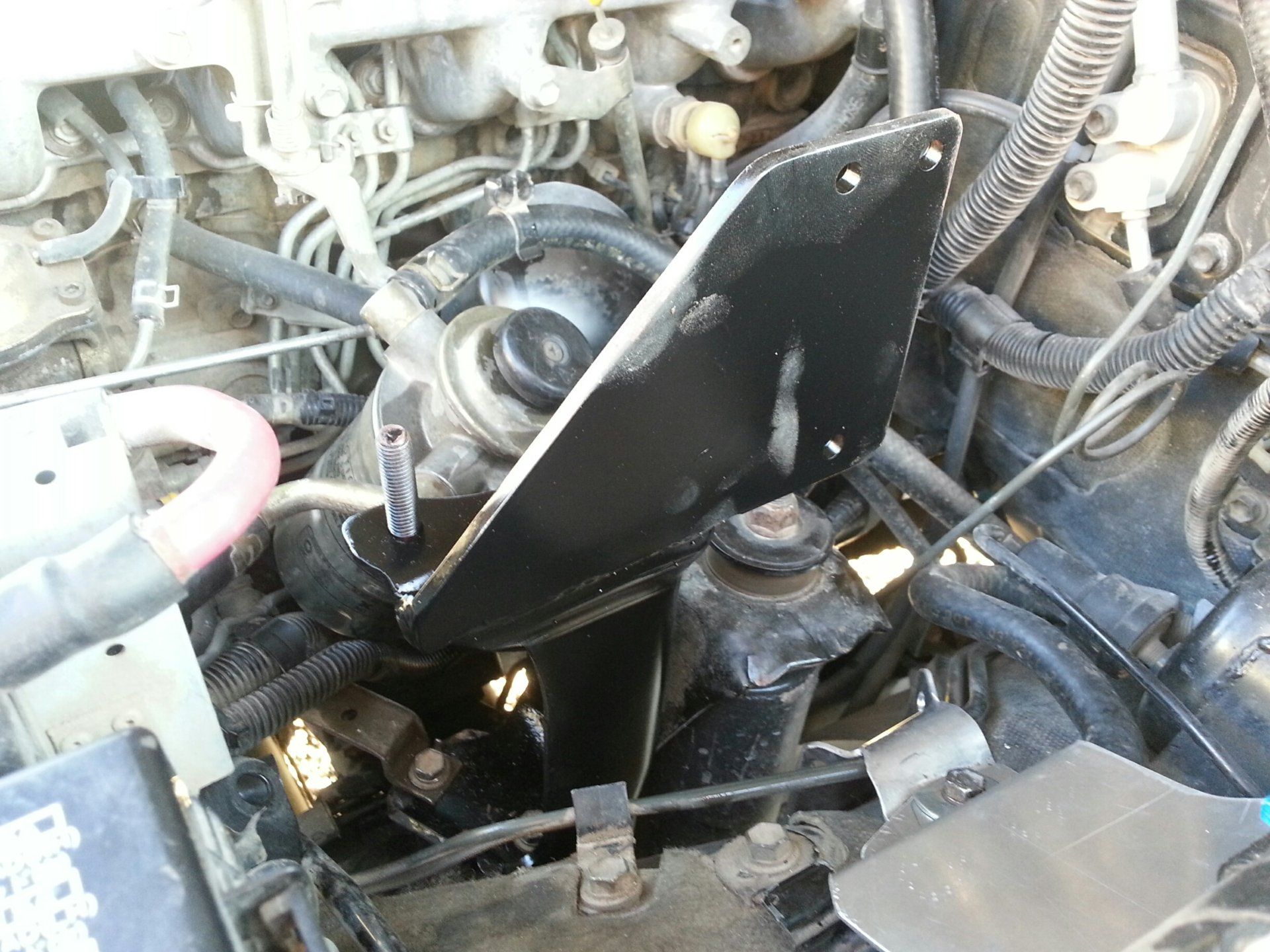

Got my hands on a brand new thermo top unit locally for 700$. The guy was nice enough to trow in a used Air Top 2000st with all the bits needed for free!!
The challenge for me was the previously installed ARB compressor in the location that everyone installs theirs. I was trying to avoid having to relocate it and all the plumbing and wiring that comes with it.
By slightly adjusting the angle of the compressor and the air outlet, I managed to squeeze the Webasto between the fuel filter and the compressor.
I welded a simple piece of 3/16 steel to the fuel filter bracket

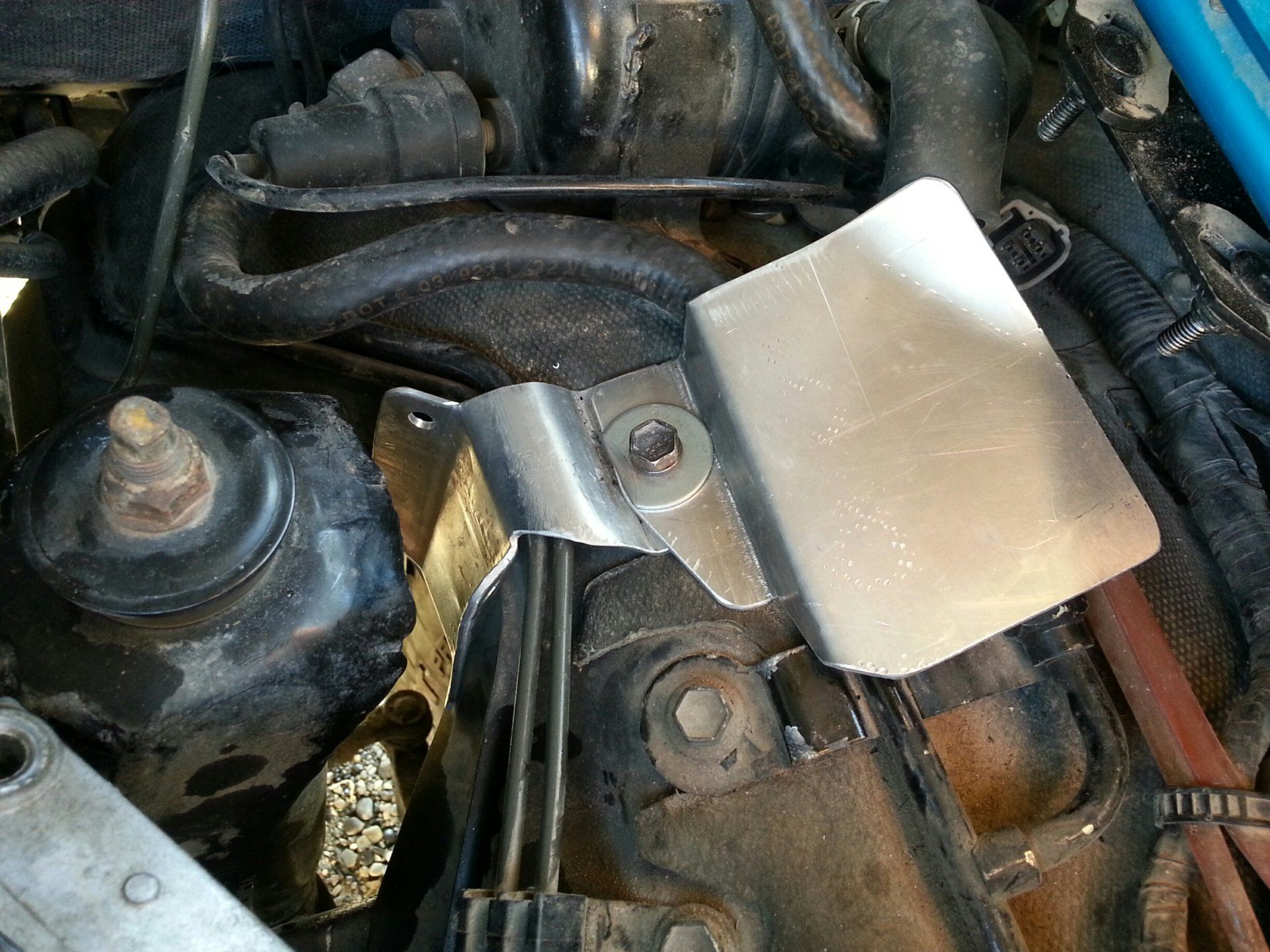

I also bent a couple chunks of 1/8 aluminum plate to create heat deflectors the protect vacuum and brake lines from exhaust heat. looks terrible, but it is invisible when the heater is in place.
