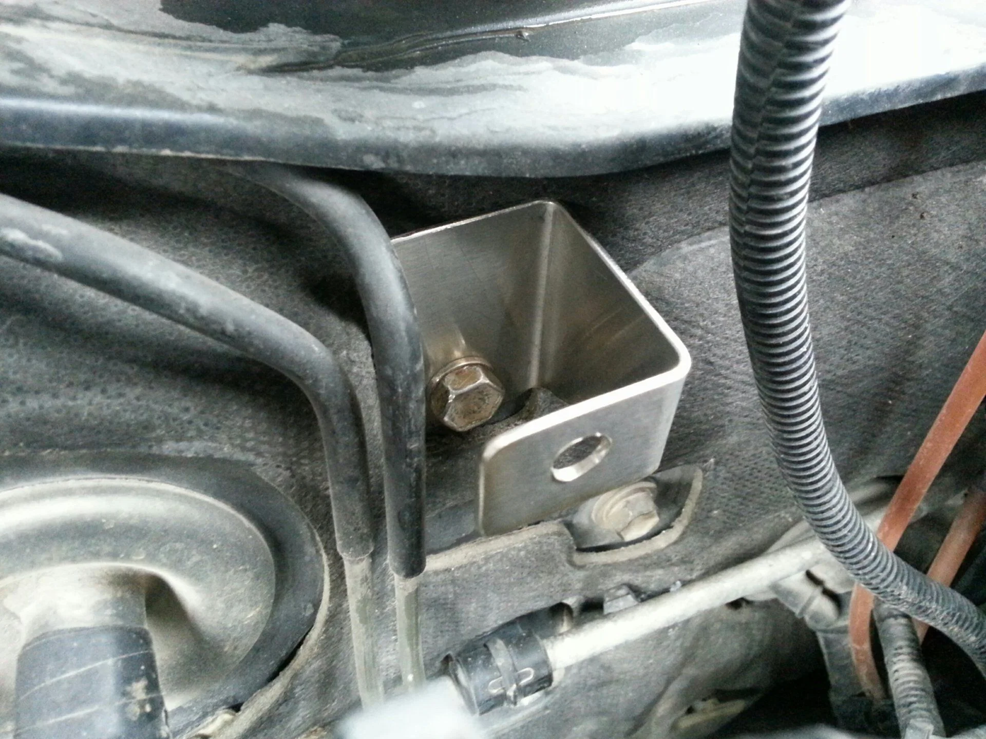

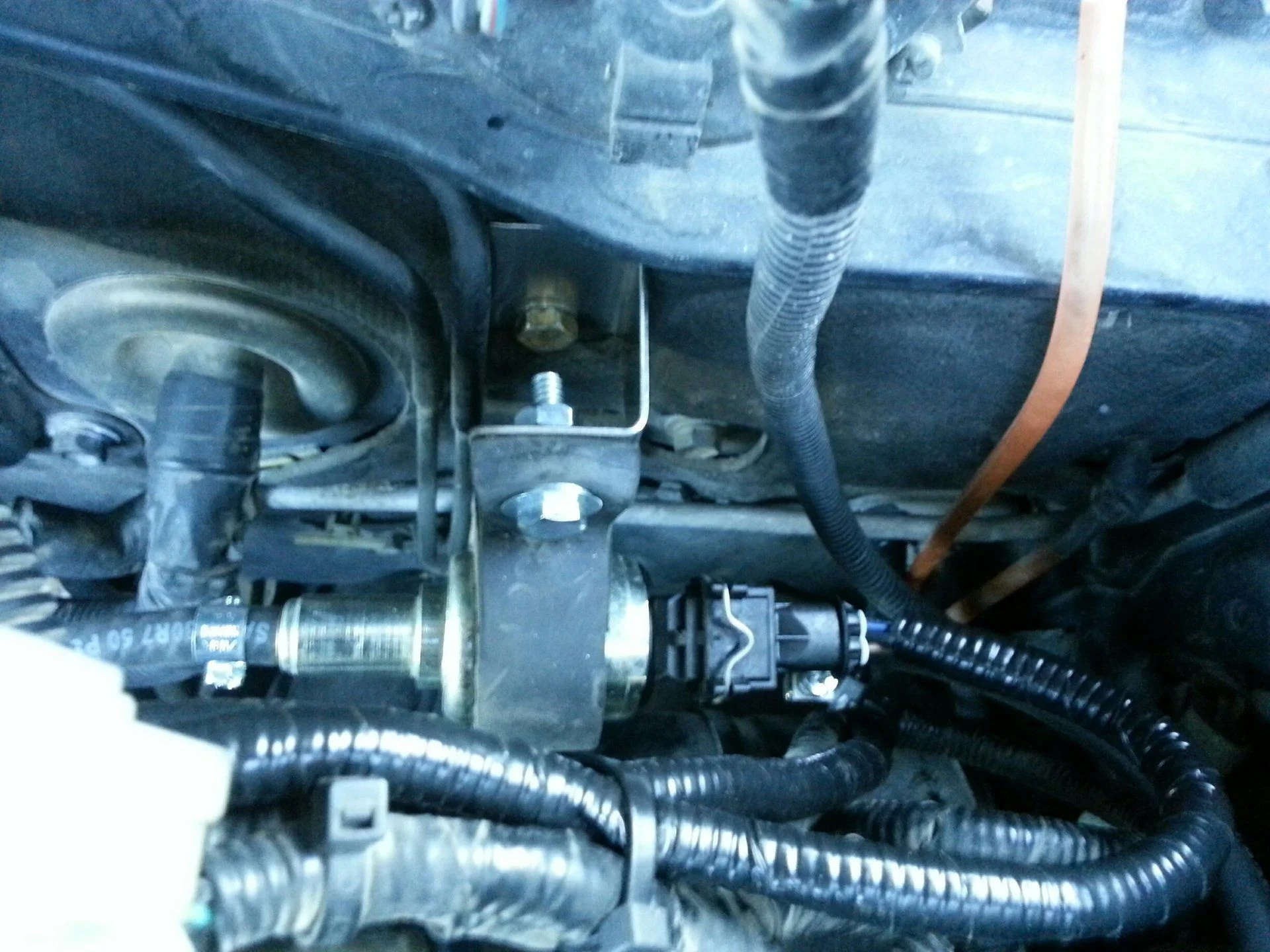

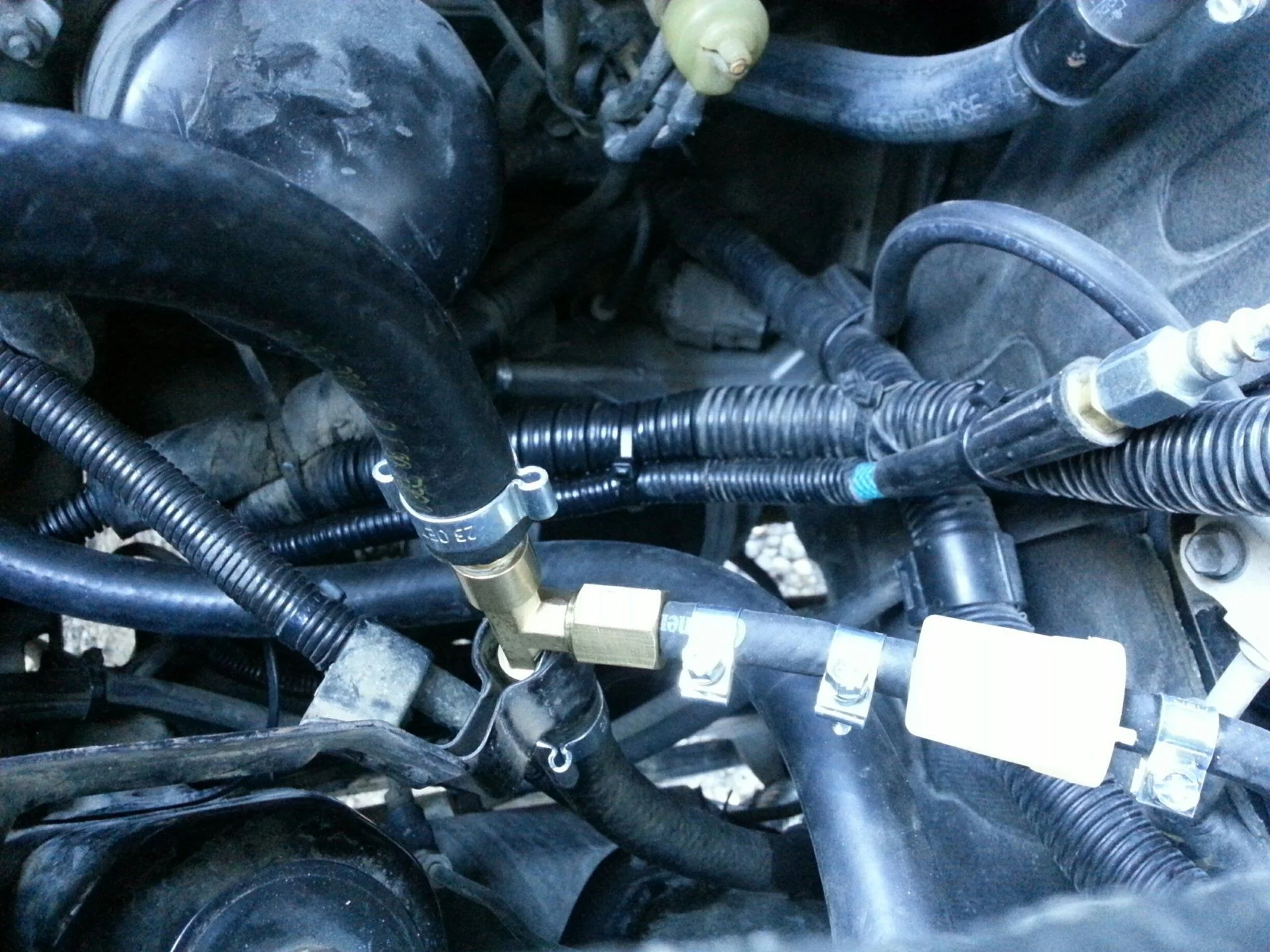

I Tee'd into the factory fuel line for ease of installation and so far it works flawlessly. Contrary to what is mentioned in a previous post, the barb fitting size for the factory fuel line is not 3/8" but 1/2" and the barb fitting for the Webasto fuel line is not 1/4" but 3//16".
Due to the lack of space beside the heater, I mounted the fuel pump on the fire wall, using existing threaded hole.
The exhaust is fastened via stainless zip tie thru holes in the heat shield and a S.S. bracket on the inside of the fender.

so thats a 'heater' unit (and not for shower) when camping standing still and draws from fuel line itself with its own 'burner'?
Currently the heater draws fuel from the main line with its own pump and burns it internally. The diesel combustion heats up coolant that is pulled from the engine block and returned to the heater core line via its own coolant pump. In its current configuration it only heats up the engine for cold starts. By adding a series of valves and a "coolant to water" heat exchanger to the hot side would allow me to have hot water on demand. But that is not going to happen in the near future!

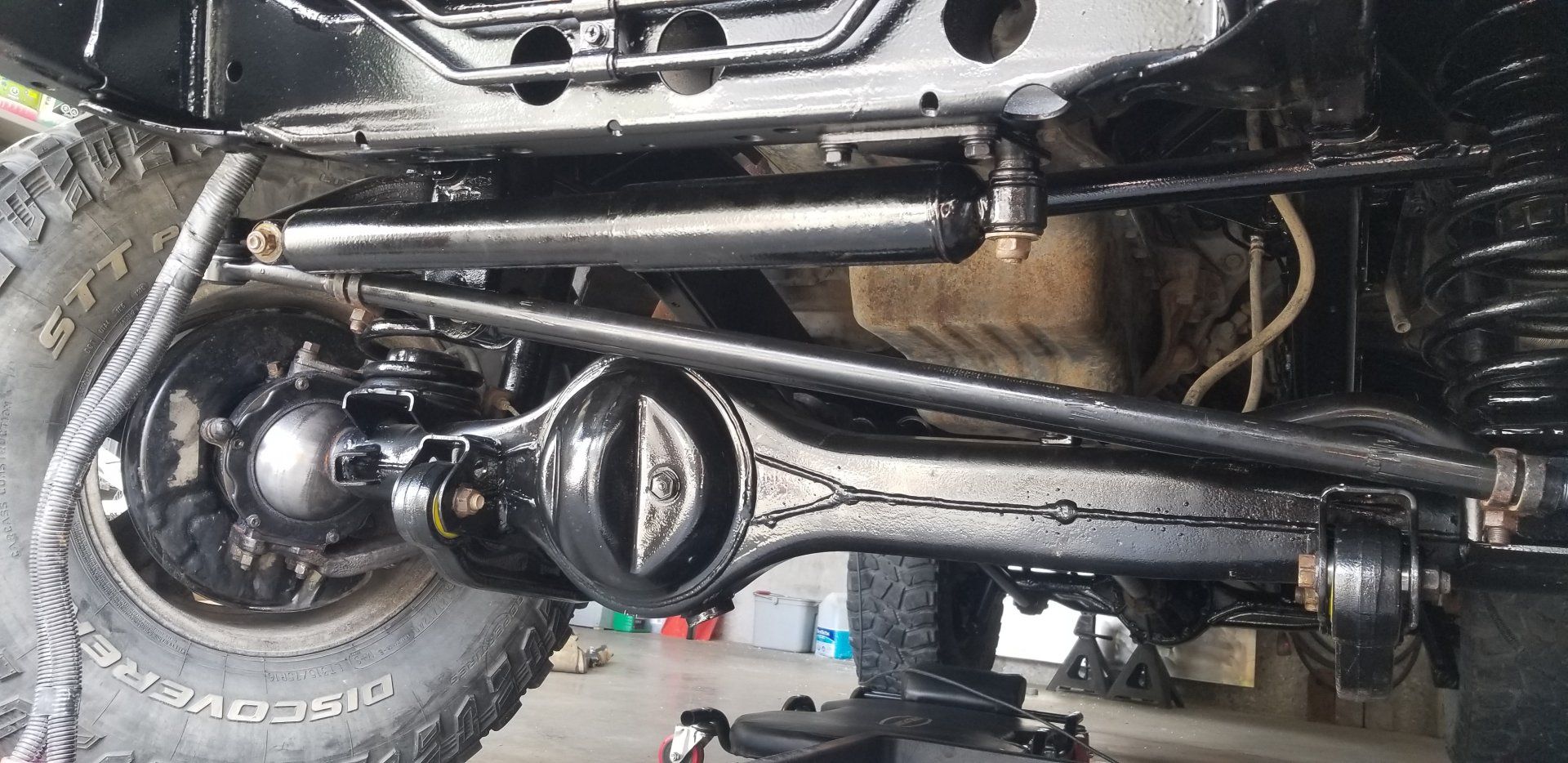

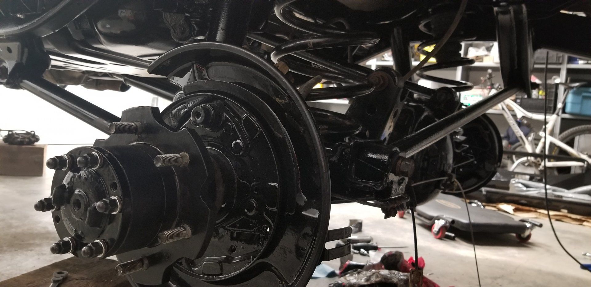

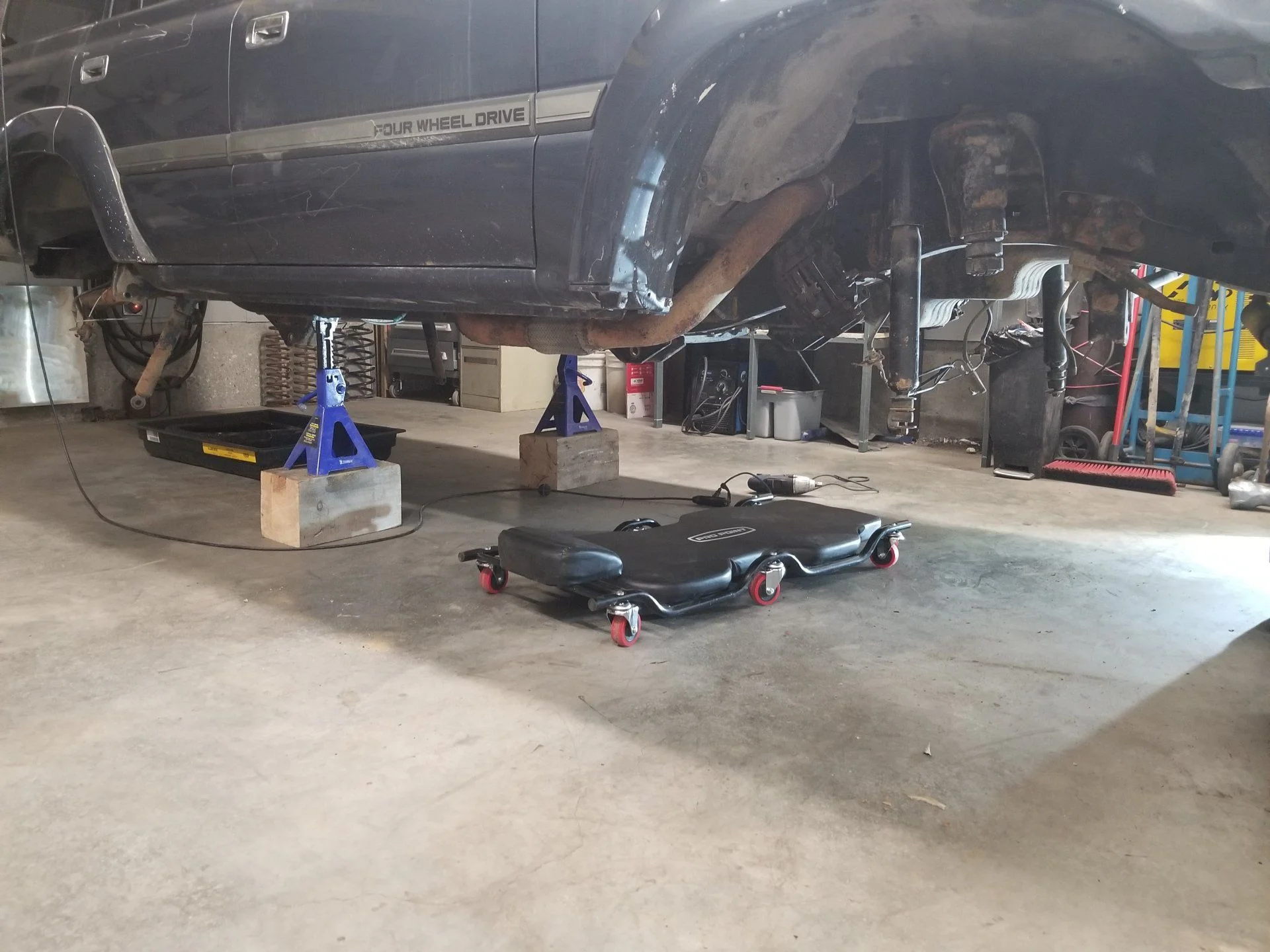

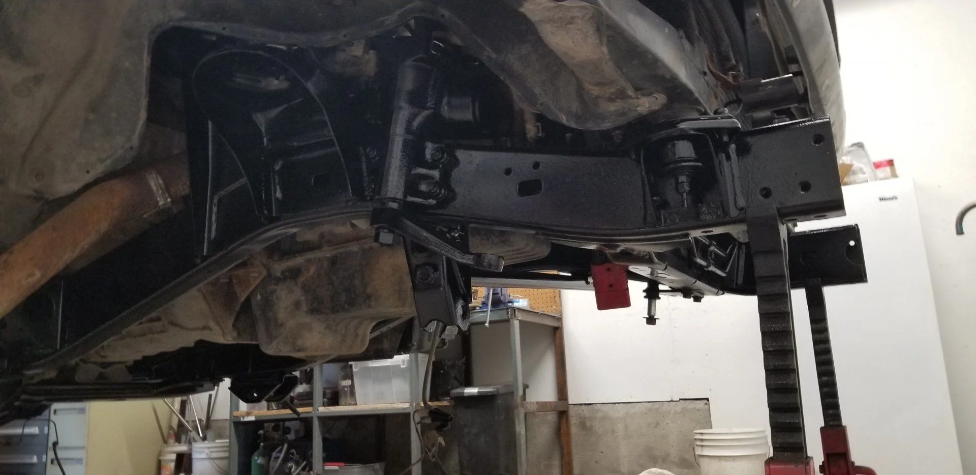

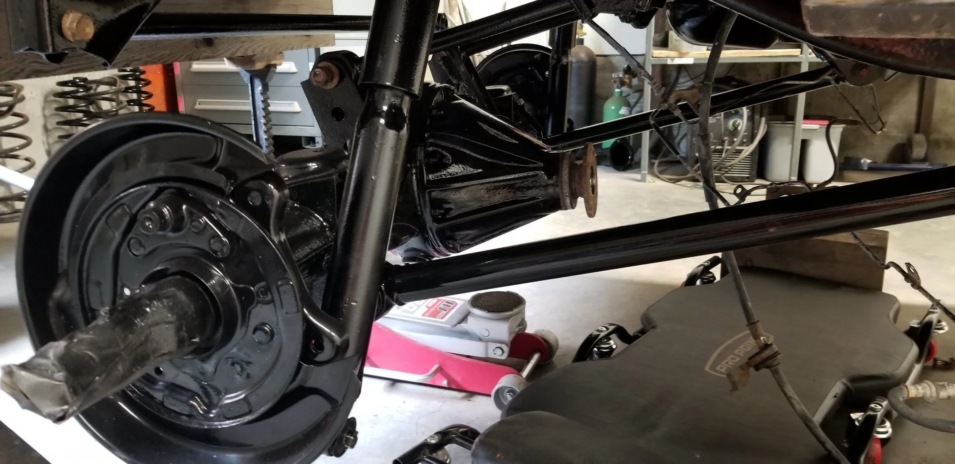

I decided to remove everything attached to the frame, sand blast and paint with endura industrial polyurethane. I also cleaned up all the mild surface rust from the frame and painted it with Endura Metaltech primer and endure ex2c topcoat. The metalteck is similar to chassis saver as it is designed to be a rust encapsulating 1 part paint, but it is a polyurethane designed for harsh industrial environments.
I ended up being a way bigger job than anticipated. In hindsight, i would have taken the frame off completly. It required a lot of bending and twisting under there to get all the grime and rust off and to get paint on everything. The result is great. The finishes i used should be more durable that original.
While i was taking everything off, I changed the wheel bearings all arround, replaced the TRE and drag link ends with 555's, changed a leaky front diff seal and rebuilt the front knuckles. I also got an alignment done.

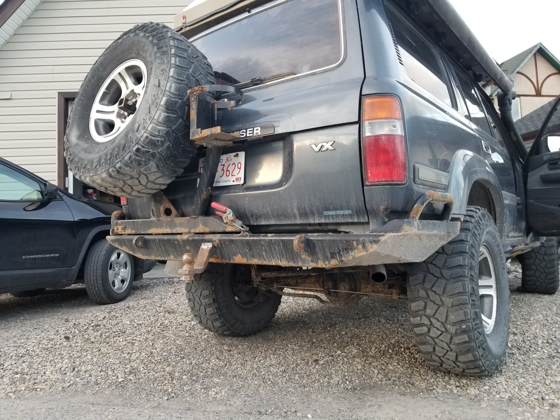

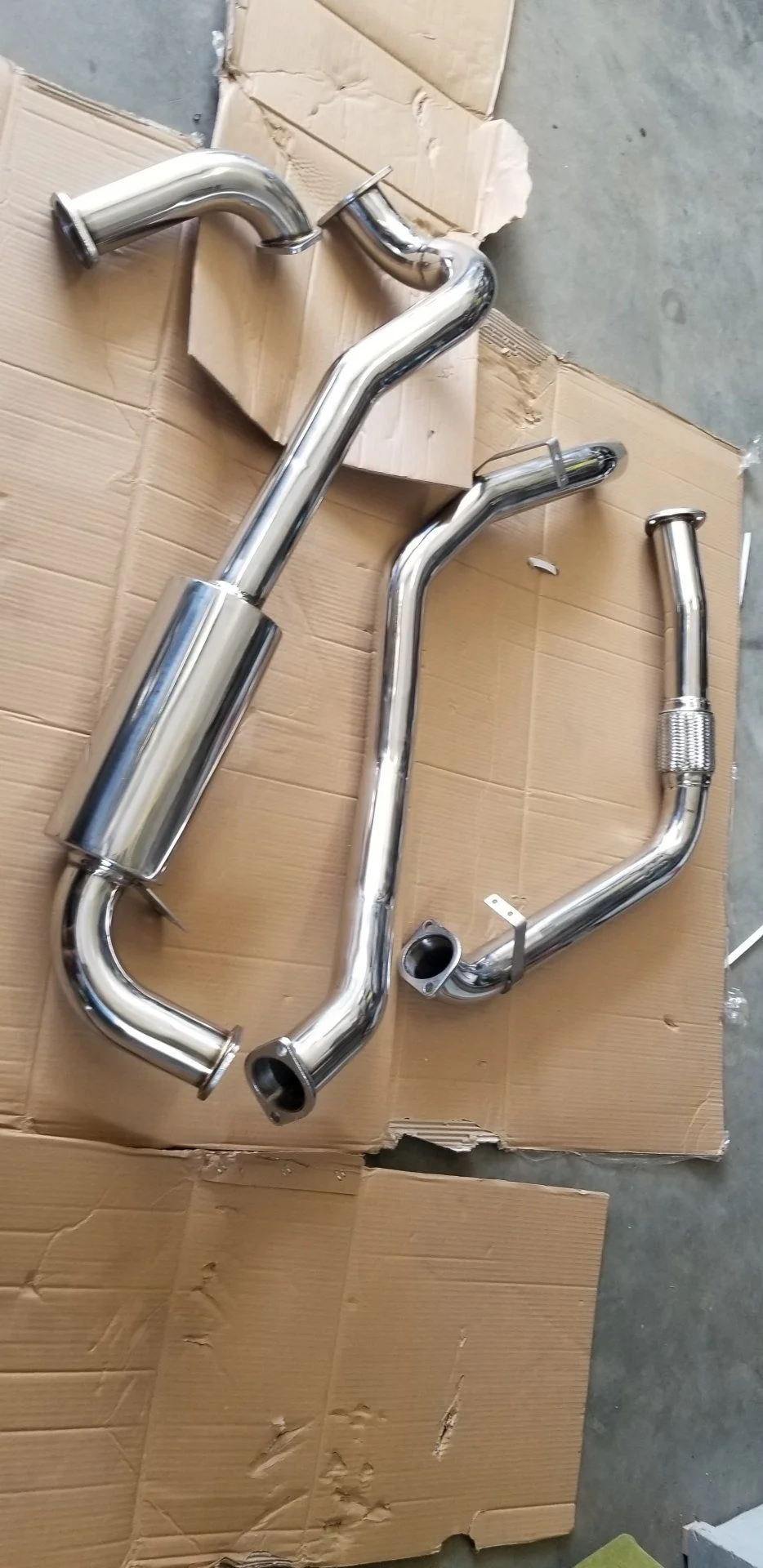

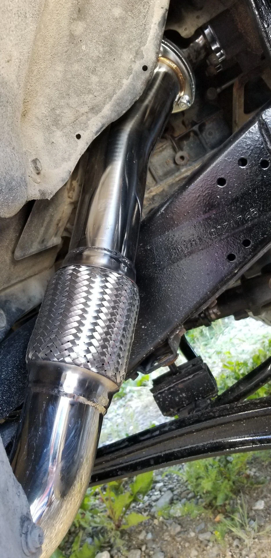

The tuck had a 3" aluminized steel exhaust on it when I bought it. Before we left on our first pan am trip, I had taken it off the truck, wire wheeled the rust off of it and painted it with high heat paint.
Turned out to be the biggest waste of time ever. 3 years later it was swiss cheese.
The PPD performance exhaust was 600$ plus an additional 550$ for shipping.
Build quality and fit is great and installation was a breeze. Ill post pictures later

The PPD exhaust includes a downpipe, or uses the stock one still?
bolt up ok? you happy to recommend them (considering the same system but including headers)

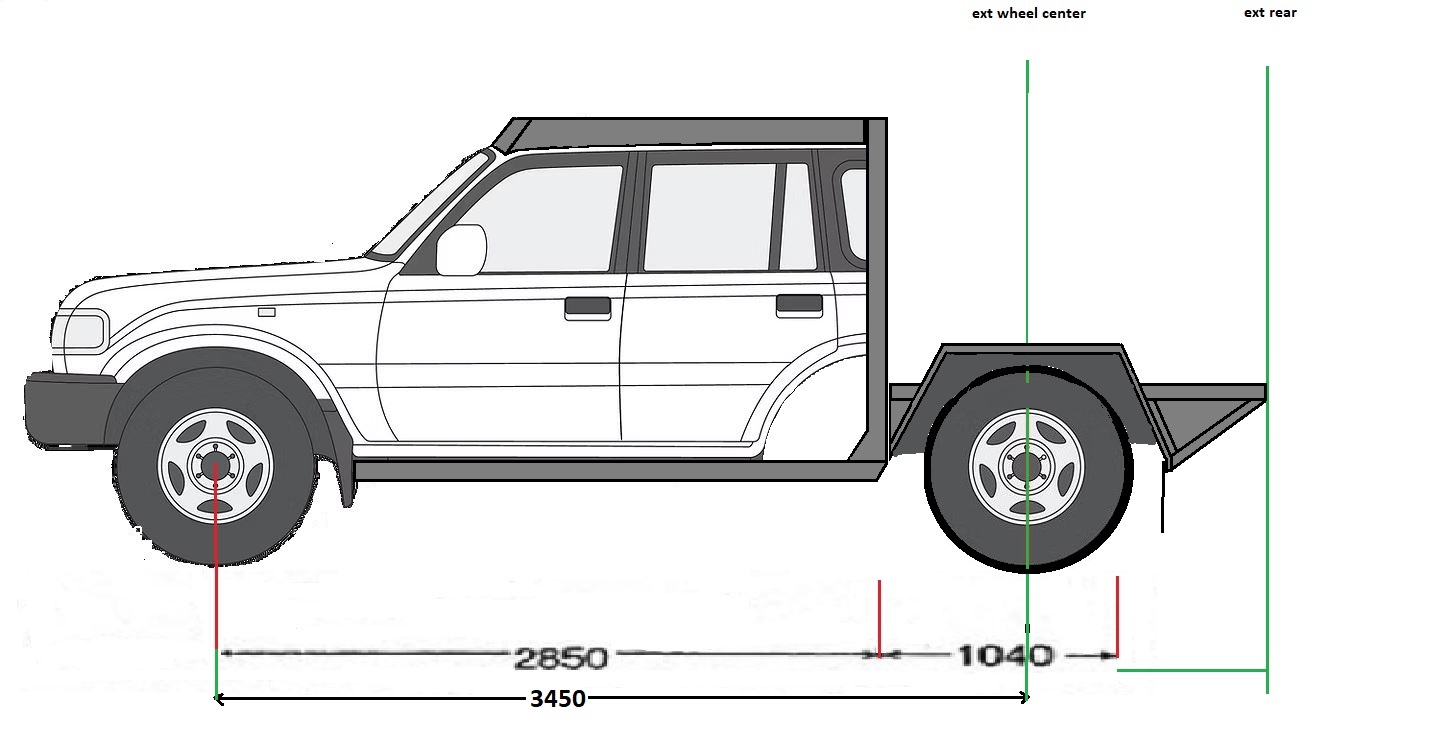

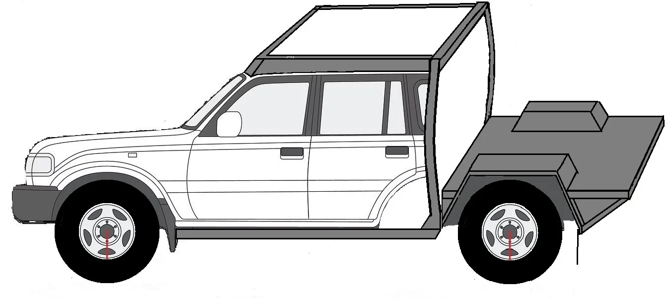

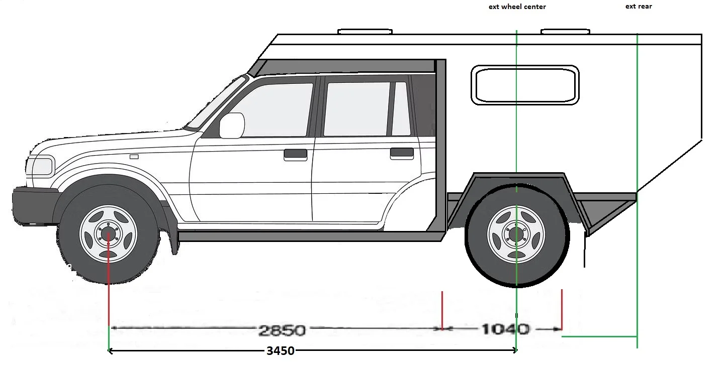

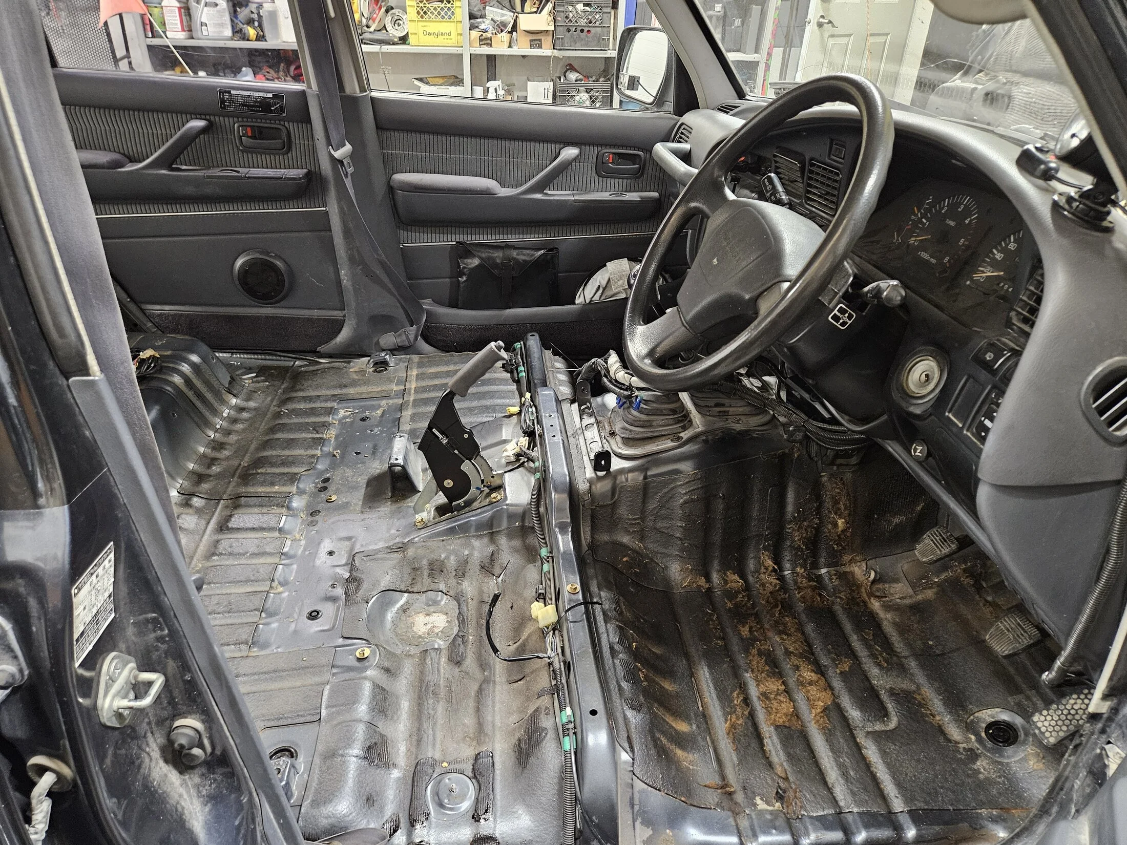

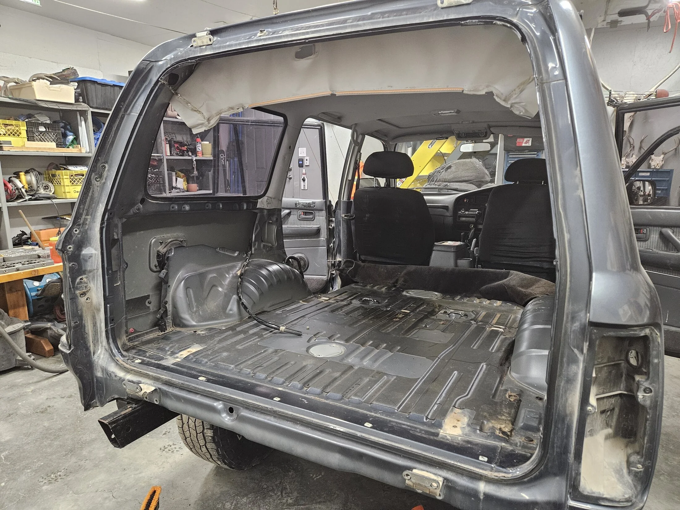

Its been a while since I did anything but regular maintenance on the old girl. I finally got the ok from the finance mister to chop the truck and turn it into my dream overland camper.
The tear out has started, my sliders rear bumper and drawer setup are now sold and there is no turning back! It is a bit overwelming as the to do list is extremely long but I am very exited to get going. I need to turn the cruiser into a UTE by the end of this winter and will then take my time to build the camper cell over the next year and a half.

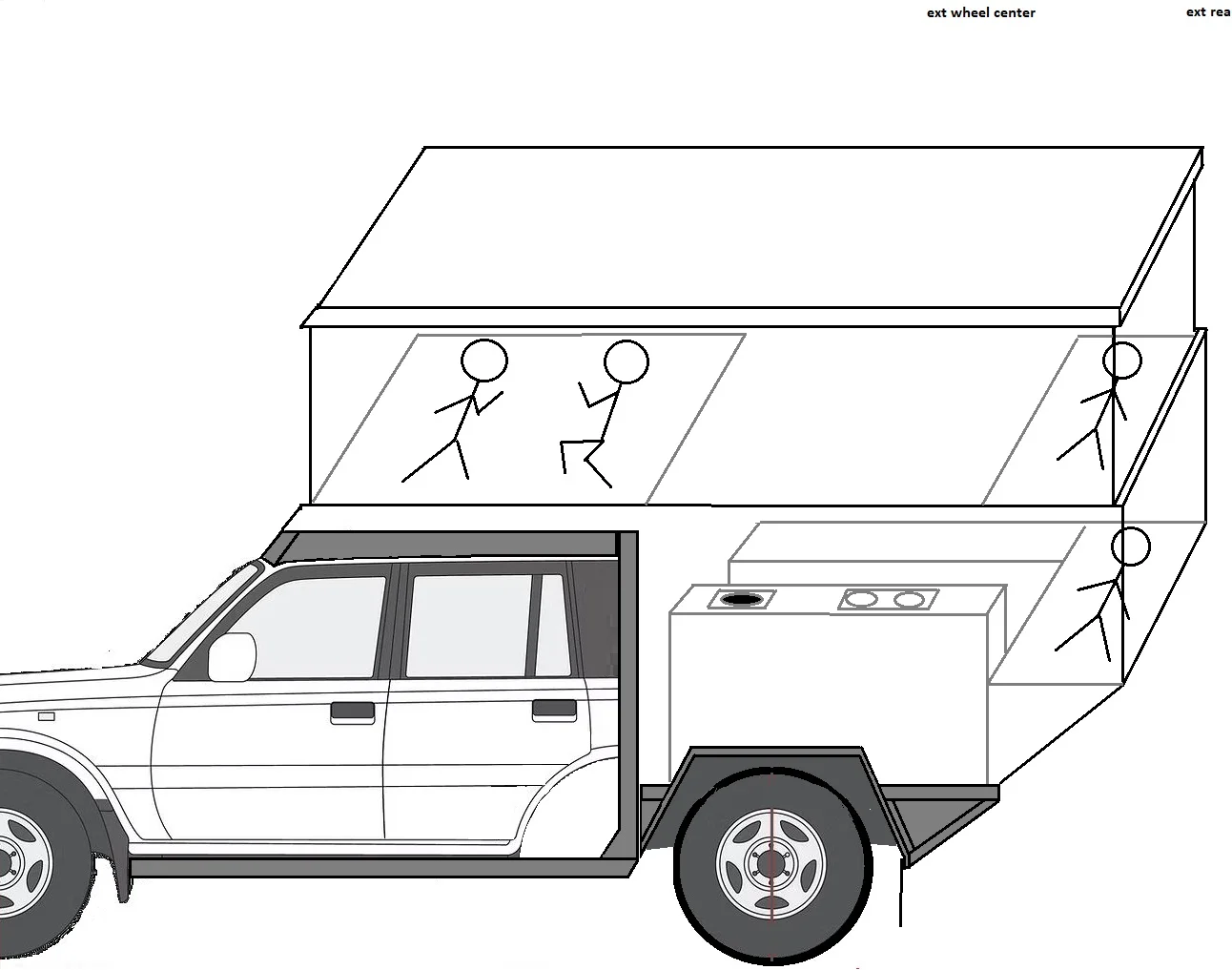

Here are the project main goal:
-Sit and sleeps 2kids and 4 adults
-ability to use the truck as "pickup" first while I build the camper cell
-stay at or under gmvw
-camper must be pass thru.
-The roof and back of the cab will be removable when the camper is on
-no doors on the camper for now, access will be done thru the rear doors
-24" frame extension
-maintain same departure angles
More details will be provided as I execute the various steps.
Here is a few super rough renderings of the project:
