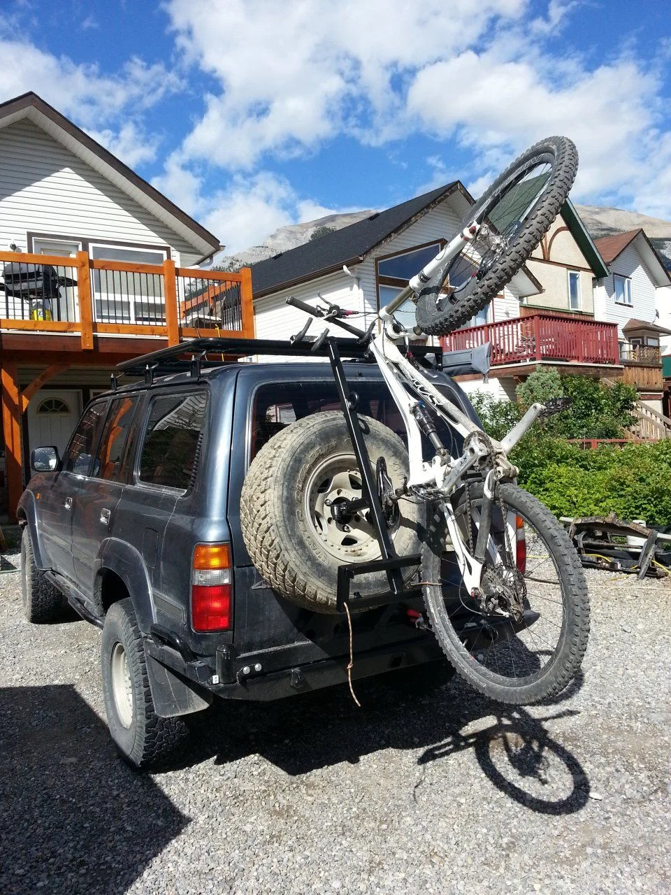

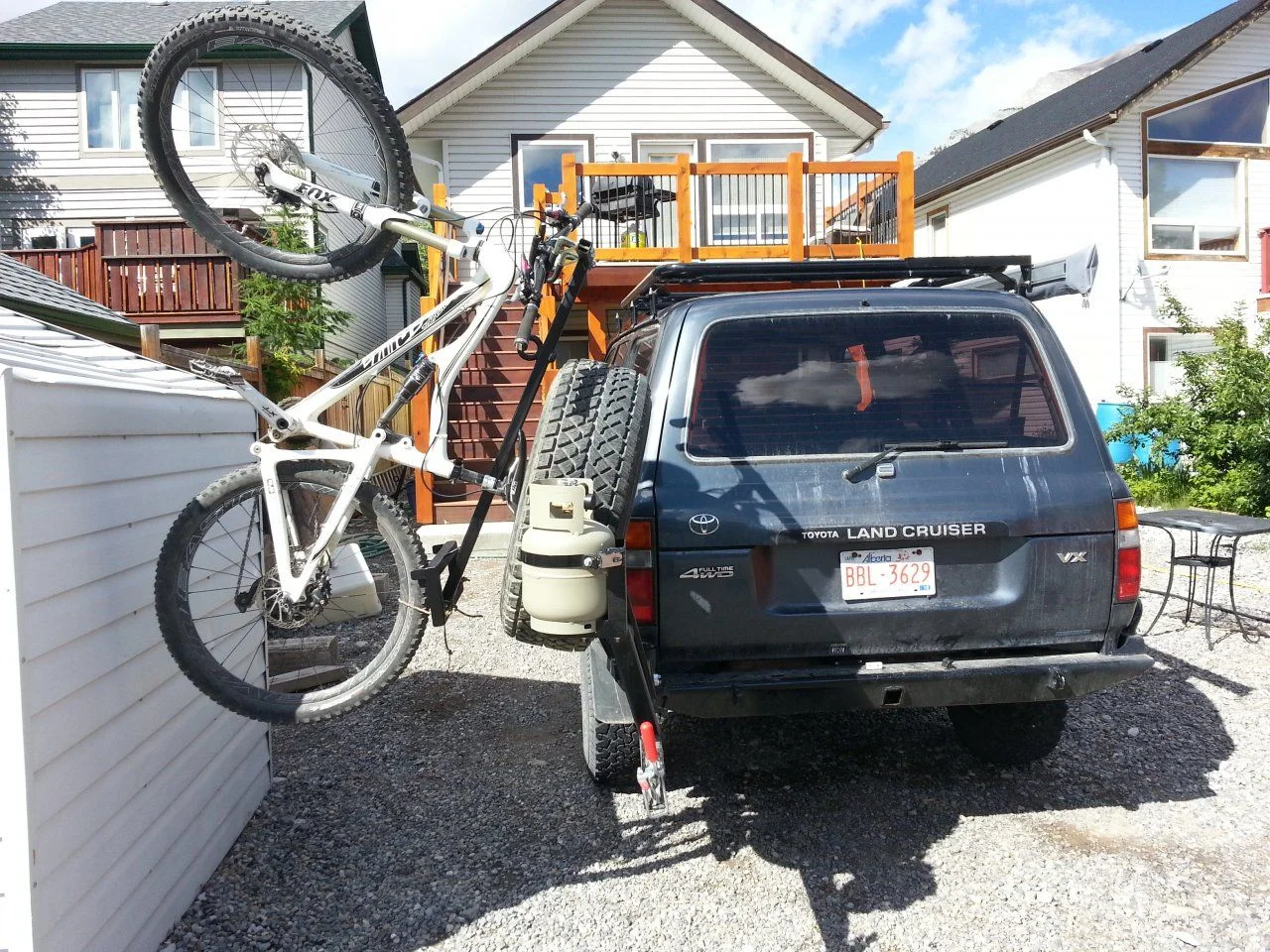

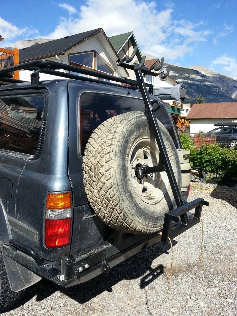

Built a bike rack real quick. Allows us to bring our bikes for the time we will be in the states and still have only one thing to open to get at the tailgate.
Interesting way to carry the bike but make sure it's ok for your fork and dropper post to be upside down like that for extended periods of time. Oil in them can get places it's not supposed to be and cause premature failure. For my dropper post they recommend not even picking the bike up when it is dropped at all as this can force oil past some of the seals and require a rebuild to make it work right again.

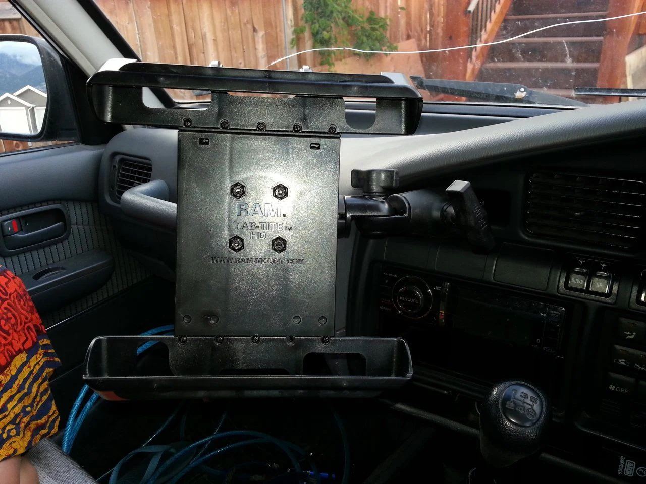

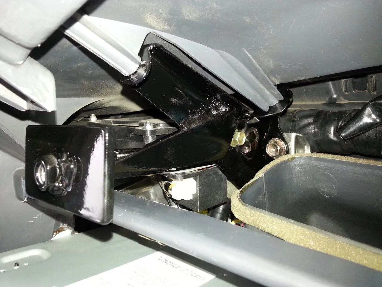

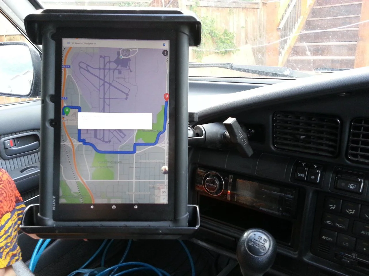

The tablet mount is now complete. I removed the dash and brought a bracket up thru the clock opening. I welded a 3/8 x 16 nut to the face plate of the bracket to mount a ram 1.5" ball. I do not recommend the swivel arm pictured bellow as it flexes way too much with my 10" tablet. I have a standard length arm coming my way. My options were limited by the size of the tablet and the shift stick but so far so good.

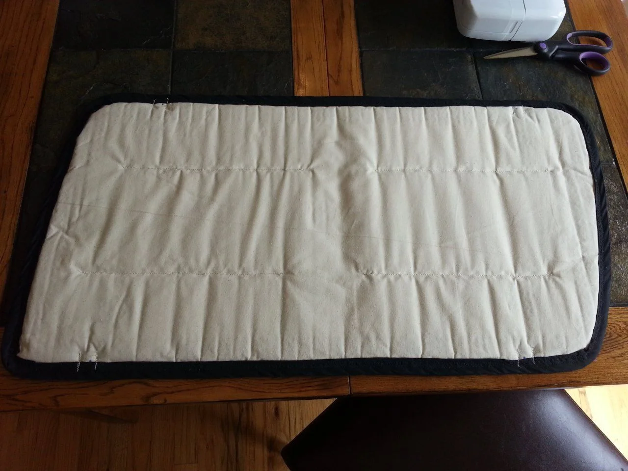

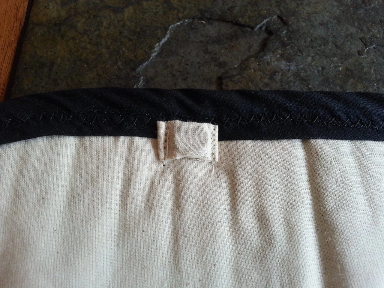

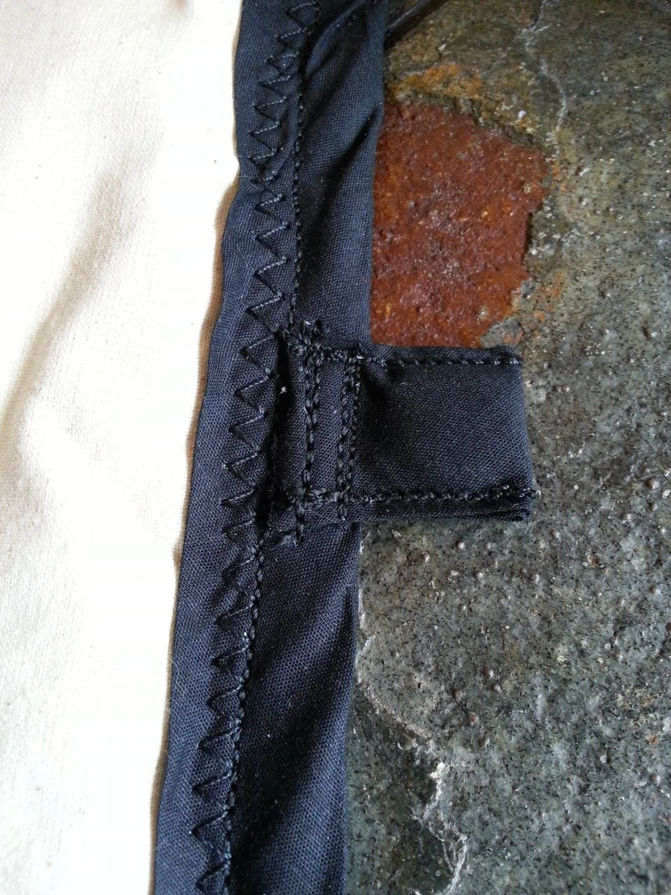

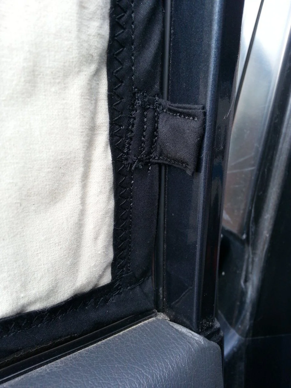

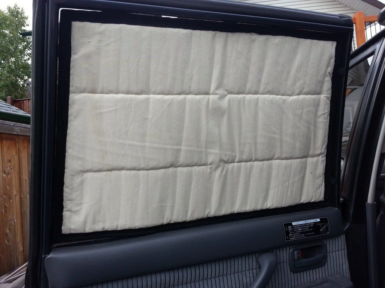

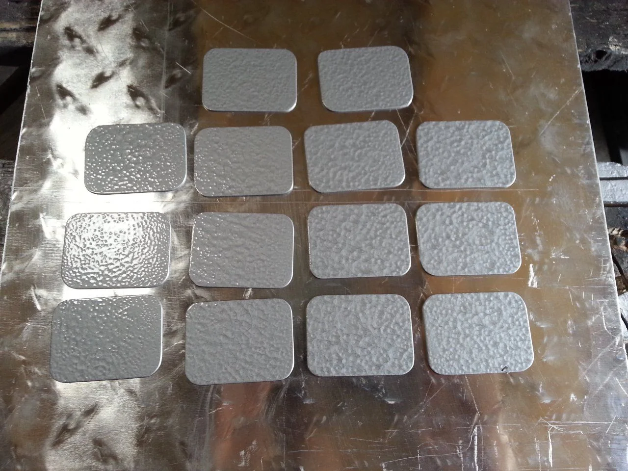

I completed the window covers for the rear of the truck. I made small 20gauge 1.5"x2" plates that I squeezed between the glass and the rubber seal. The rare earth 1/2" magnets sewn on the back side of each cover stick to the plates. for the rear doors the magnets stick to the door frame.
Magnet location on the fixed glass covers
Magnet location on the rear door glass covers

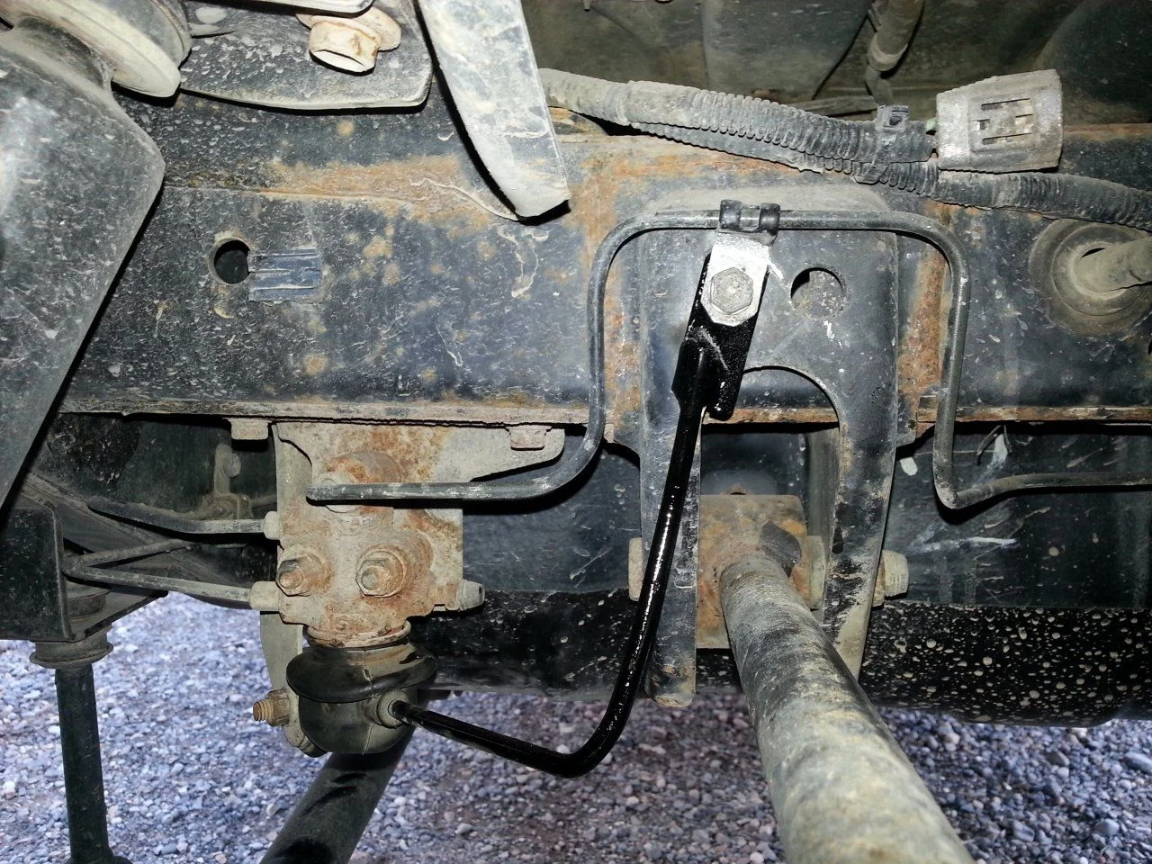

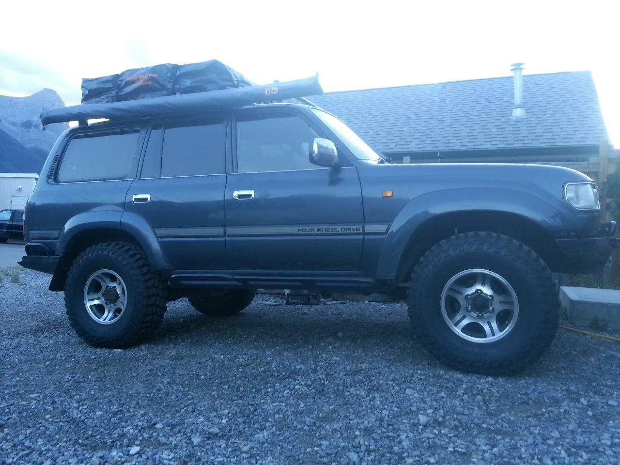

I modified the brake proportioning valve actuator to increase braking power. Now my rear locks up too fast. I need to service the brakes all around and see where I am at.

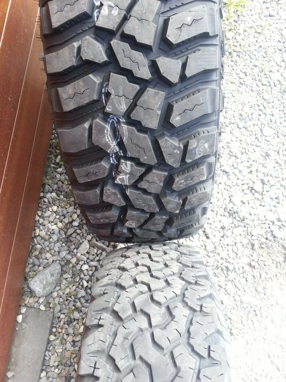

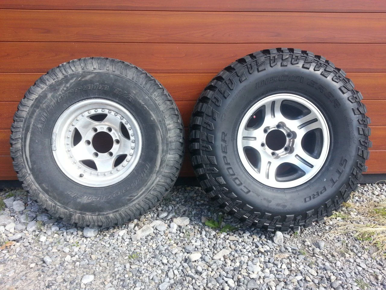

Got some new rubber and wheels. 315x75R16 Cooper STT PRO. So far so good except for some vibrations around 110kph. The shop balanced them with beads as it needed too much weight for sticky weight and I did not want weight on the outside of the rim. Is that common practice for tires like that?

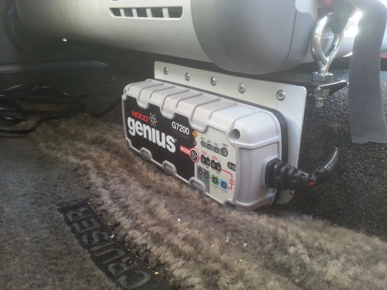

I also hard wired my fridge and battery charger.

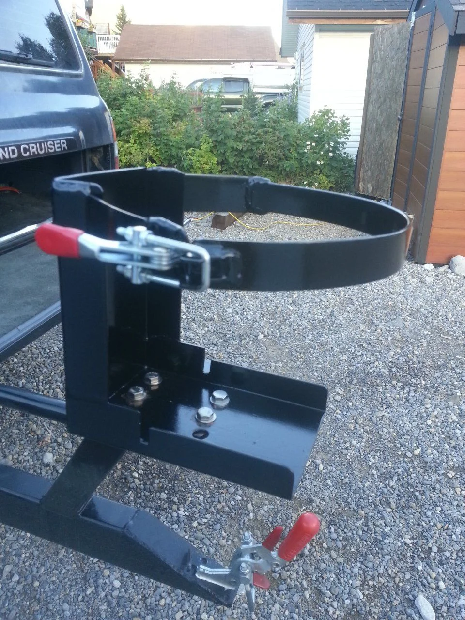

I had to modify my propane holder to make room for the bigger tire in the back. I decided to use a small destaco Latch instead of my original design to ease removal of the tank when setting up the kitchen away from the vehicle. Still need to find a way to lock it...
