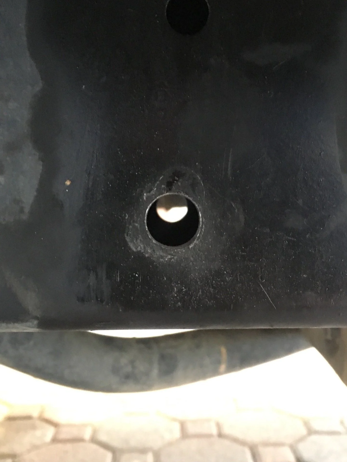

Finished painting my group buy sliders on Monday and bolted them up last night. Not trying to steal your thunder, but I had the same feeling on the rivnuts so:
1/2” through hole and a:
Big ol’ 6” 7/16-14 grade 8 bolt.
The bolt is the perfect length for the frame. As a heads up, the inner wall of the frame there is THICK, and I highly recommend stepping up the bit size on your way to 1/2”.

So I never got back with an update, but I did bypass the rivnuts altogether and it came out fine and I don't think took any longer. You do have to drill the frame 2 or 3 times which is hard work - make sure to get a quality metal drill bit before you even attempt it. But they are rock solid and the bonus is you can easily remove them in the future if needed/wanted.
