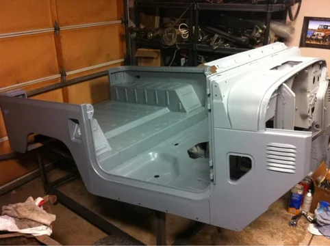

I got the tub back off the frame today and sandblasted the outside to remove some of the grease. Tomorrow I will blast the inside to get the welds all cleaned up then this thing will get a fresh new coat of self etching epoxy primer.

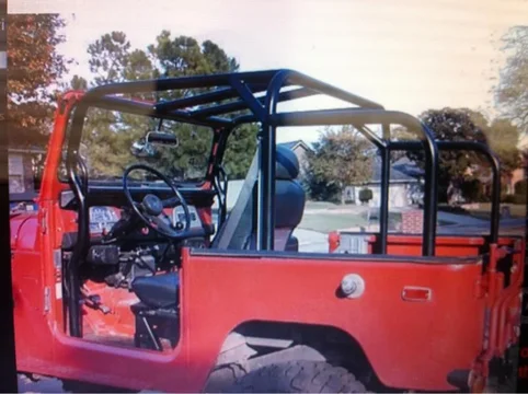

Ordered the Jackson prefabbed Metal Tech cage today along with the front and rear frame tie ins. I have the tub upside down right now finishing up the last of the metal work before I prime and undercoat it. I was thinking that I might have to remove the backing plates/captured nuts for the jumpseats to get the frame tie in plates to clear. Anyone do this? I just don't want to undercoat it and find out later the plate won't fit.

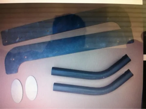

These j hook shaped plates attach to the underside of the wheel well and bolt up and mate to the same shaped plate attached to the cage as seen in the photo below. It looks like the plates may be in the way of the jumpseats mounting plates that have the captured nuts. The ones mounted under the wheel wells. Sorry I don't have a picture of those at the moment.
Well I decided to remove all the mounting brackets with captured nuts from the underside of the wheel wells. Man I cant believe I thought I could get away with not doing this! I should have done this when the quarter panels were off. It would have been a hell of a lot easier:bang: Never the less I am really happy I did. Pics say it all

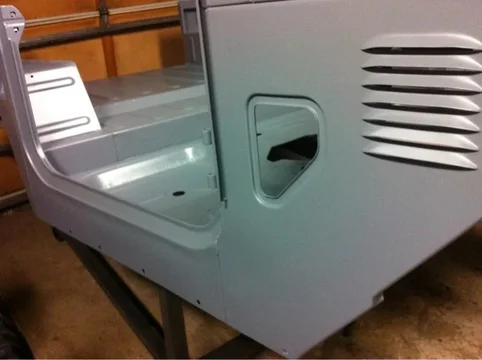

Back into epoxy primer since I sanded a lot of areas back to bare metal. I just wanted to be sure that it was good and sealed. The bad news was that after it dried I noticed a few spots where it needed to be reworked. :o
So I called my buddy over to take a look and help me decide to leave it or fix it:meh:
Well I fixed it. I just couldn't live with myself if I left it. There were just a few spots that needed it. so I took the wheel sander out and sanded the primer back off and roughed up the surface to rework it. Turned out pretty good.:)
