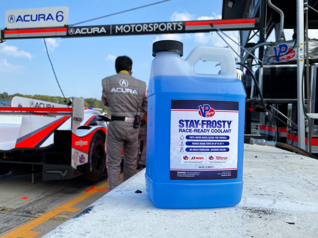

Maybe there is a really good many core aluminum radiator that will fit with a big electric fan. Isn't there like some special additive/stuff that has better heat exchange than water antifreeze. Enlarge the hood vents to let out more heat. Put an air scoop on the bottom to push more air out the hood vents.
Thanks for the advice, will look into a new radiator and better airflow for hood vents as well as that special additive. Do you by chance know what the additive is called?
