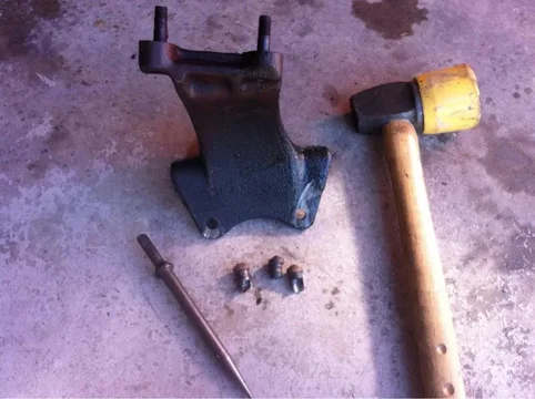

Engine refresh! ok not a real refresh, but a repaint. I have spent the last 3 days stripping this and cleaning it. I managed to get the block and the valve cover in color. I put a clear coat over the valve cover and it turned out great! Well except for a small run. I will just sand it a bit and touch it up. Over all really happy with how it turned out. Man this job took forever with an assortment of wire wheels and about 8 cans of brake clean. now I just need to clean and paint all the other parts .
