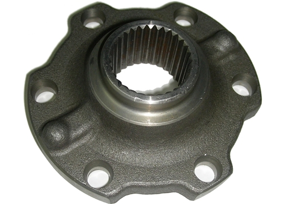

What are you calling "the hub cover"? Got pics?
I think this is what he's calling a hub cover
This is what i think he stripped the stud/bolt off in.
@Rifleman - we could guess all night. A stud is a stud and a bolt is a bolt, two different possible problems.
Ya, i hear what your saying, but since he's new to Land Cruiser's, he may not know that what he is calling a "bolt", is in fact a stud. Who knows, maybe he stripped one of the bolts holding the rotor to the hub itself, i guess we'll have to wait till he posts again to find out.
Sorry for the confusion folks...new to the game and terminology...Rifleman has the correct pic and it was the "stud" in the pic labeled "rear".
I think I might have been a bit too aggressive with the brass hammer (nut even with stud) when dislodging the cone washers and mucked up the threads...the nuts were a bit sticky during reassembly, which I thought was just rust, and even though I went slow and easy it stripped the stud.

Ricky, if the threads on the stud itself are damaged, don't worry about it, just unscrew the stud from the hub, go to your local Toyota dealer, and buy a new one, they are only a few bucks each. While your at Toyota, it might be a good idea to buy a replacement cone washer, and nut too.
