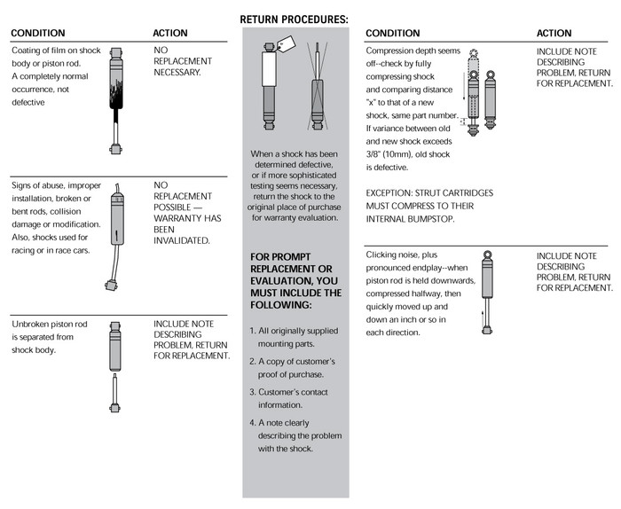

These shocks are bypass shocks. There is no other company that does a bypass shock for the 200 as far as I know. There are remote reservoir shocks with adjusters on the compression side at the reservoir, but not bypass shocks.
As for leaking, some leaking / misting is normal. Here is a good article on Gabiel shocks in terms of what is allowable leaking
http://gabriel.com/wp-content/uploads/2011/04/TECH-_01_09.pdf
Here is a chart from Bilstein
So just because there is some oil on the outside of the shock does not mean it is defective. It is pretty normal on all shocks to have some oil on the outside.
