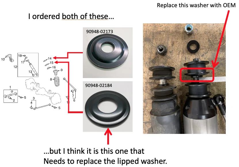

Upper or lower? Did your installer ignore the instructions and put the bushing washers in the original toyota configuration? If not that's the issue.
He followed the picture that you attached. It’s for the lower bushing. He said the upper is still good.
Ah, then that’s the first I recall hearing about a rear lower, other than when the mounting posts on the axle get bent.
I’ll have to let someone else chime in. Good luck with it
The rear squeaking I had with my BP-51s was resolved by adding an additional OEM washer on the upper shock mount.
Is this what you did?
I bought both washers listed in your attachment. When I got under there I found that I did not have a lipped washer like the one circled in the right picture…it was flat like the OEM shock in your attachment. So all I did was add another OEM washer above the upper bushing. Tightened the nut down and have not had any noise in over two years.
