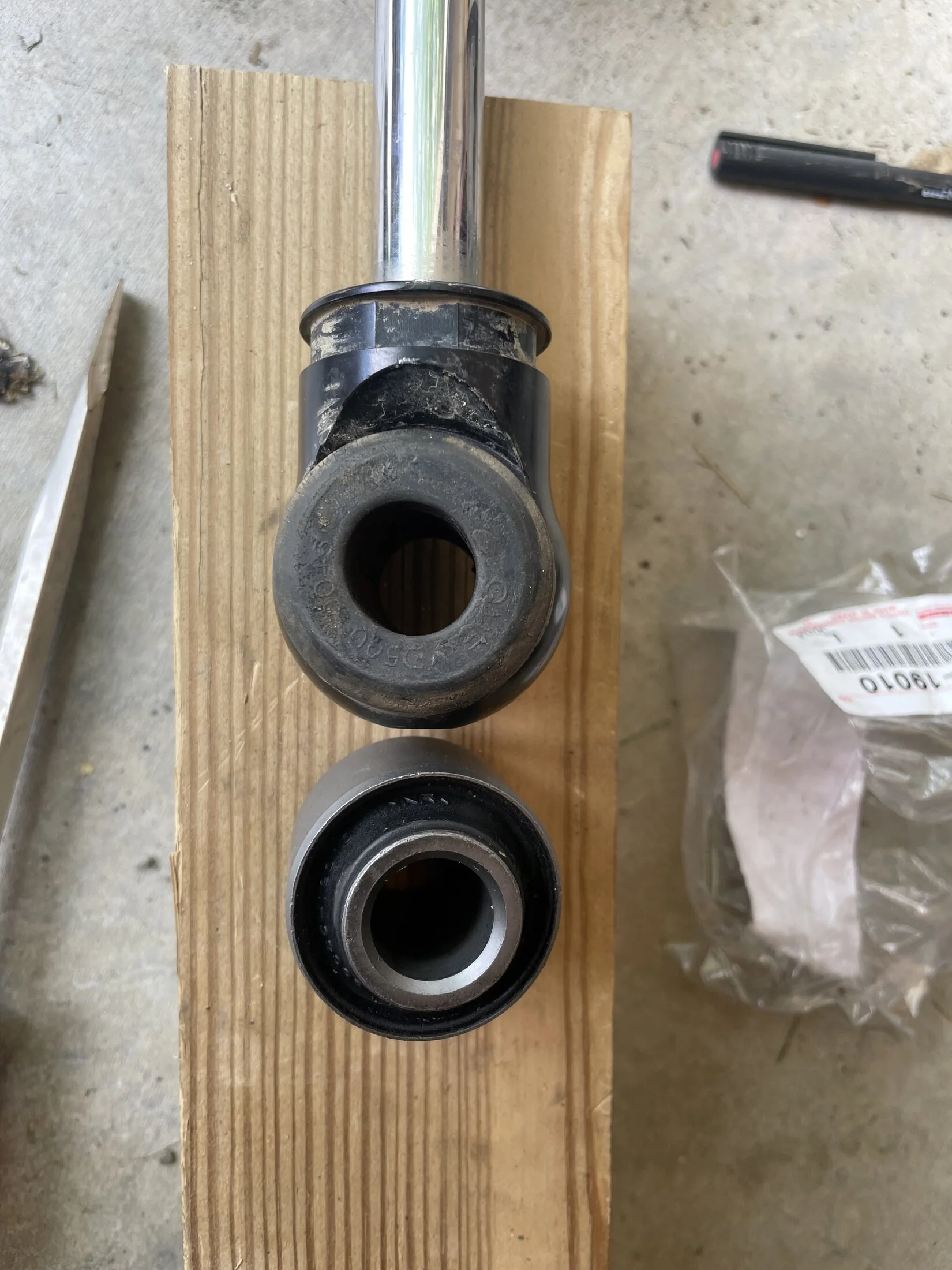

it's not too long, the issue is the lower bushing with no sleeve. Stock shocks and most aftermarket put a metal sleeve or a spherical joint with misalignment spacers on the post and that effectively increases the diameter, thereby increasing the strength. BP-51s just have a rubber bushing without that added support. People installing lower shock guards definitely seem to make it worse, but basically that post isn't strong enough by itself to deal with the damping forces.

Pic of BP51 bushing vs. OEM.
Can the factory bushing be swapped in for the rear? I know the front spherical “bushings” squeak when the teflon wears out. What’s your experience with the Dobinsons MRR’s? Looks like a similar rear bushing without the steel internal support.
I was going to do that but you would have to machine the shock and there isn’t much meat there.
