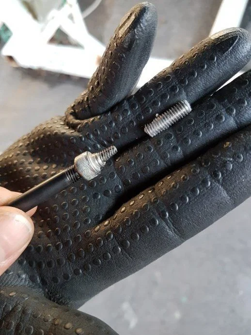

You need some this kind of tap:

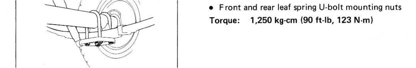

Anybody know the torque value for the U-bolts?
Factory spec on anything not called out by Old Man Emu. Go 90 ft-lbs, re-torque after ~500 miles
2024557
Thanks so much! I torqued to 90 ft-lbs this afternoon. I'll double check everything tomorrow, and then again at 500 miles.

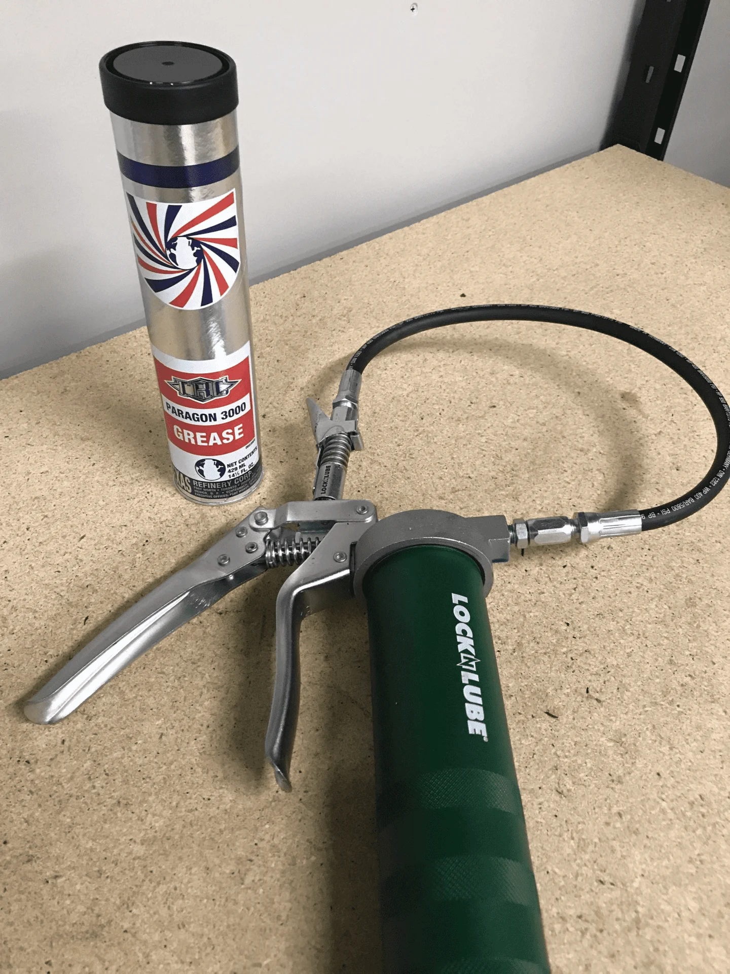

Also, what type of grease do you prefer to use? OME calls for lithium grease. Amsoil lithium?
Lock-N-Lube with a tube of TRC Paragon 3000 for the win!
2024603
The above is my choice, but seems there's endless varieties of grease in which you can use...... For some extra curricular reading on grease, -> Chewbacca's Birfield Grease Guide <- :hillbilly:
