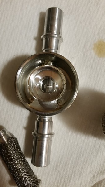

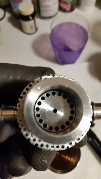

Here is a can I use that works well. I think it could be modified for the 100.

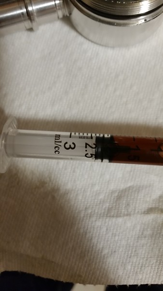

Internals above and below
Caught in one track session
