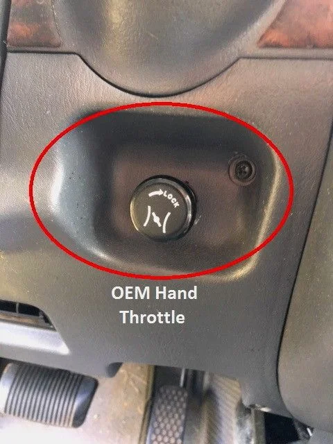

Also, get a hand throttle. They are absolutely invaluable.
Yup, that’s it. Priceless if you are stopped on a steep climb, just set a base amount of throttle and then unlock it once you are up the climb.
Mine isn’t staying locked consistently and I need to dig into that because I rely on it all the time.
