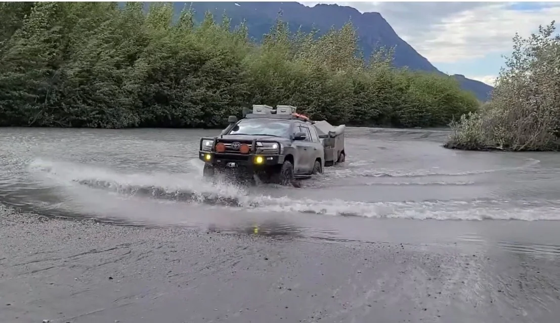

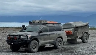

I tow a Patriot X1-H with my LC200. In my experience, if I can get the LC200 through the obstacle, the trailer just follows along. I love having the trailer and truly don't worry about it on the trail.
I did over 10k miles this summer in Canada and Alaska with about 4k of that offroad. One of the challenging trails was the drive into Knik Glacier in Alaska. Certainly got looks from people for having a trailer on some of the obstacles. :)
As for which trailer to go with, there are so many options out there. All have their pros and cons. I ultimately ended up with the Patriot and love it. So much storage space, fantastic galley, 40 gallon of water storage set low in the frame for great center of gravity, rock solid stability with no coil spring suspension kick since it has airbags. If I was a family of 5 or 6, then I would go with the X1 since the change room and kids room can be left attached to the tent.

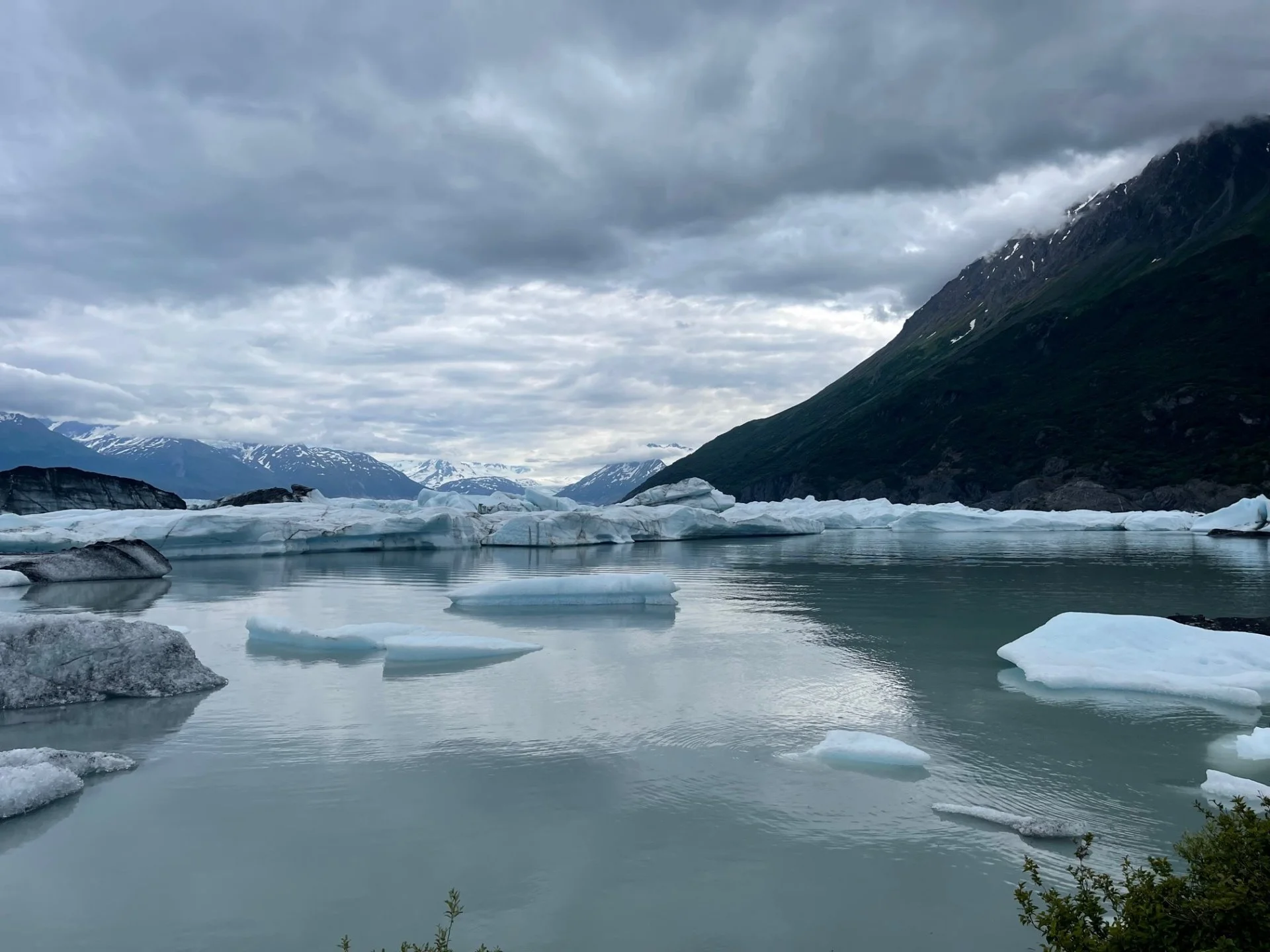

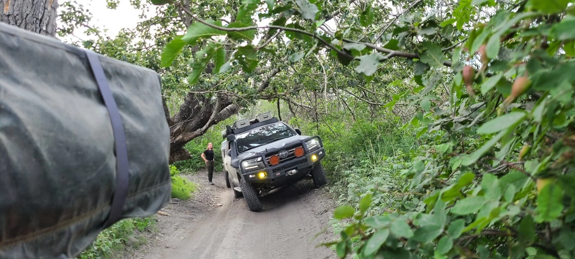

Yup, made it to the glacier. The picture I posted is at the glacier itself. The drive in is not for the faint of heart, it is very, very challenging. So many water crossings, mud, trees, ledges, dropoffs and probably a minimum of a 1000 different trail junctions. There is not a set trail to follow, so you are constantly trying different options, backing out and trying a new one, walking across a water crossings to validate depth(my kids and I lived in chest waders), etc. The water crossings change throughout the day as the glacier melts. So a crossing you did in the morning would not be the same in the afternoon. But, it was all worth it. Two days on the trail. For this trip we are on the road for two months. It was my two daughters(12 & 14) and I in my rig and my buddy and his 12yr old son in his Tacoma. I personally wouldn't do Knik without another vehicle, as you will be required to do multiple vehicle recoveries to have success.
As for bears and food, we didn't have any issues. We saw bears all the time. After cooking dinner we were always very diligent about trash. Each night I placed trash in Zarges box on top of the LC. And made sure all dishes, etc were clean and put away immediately after cooking. And of course keep bear spray available in the tent when sleeping.
