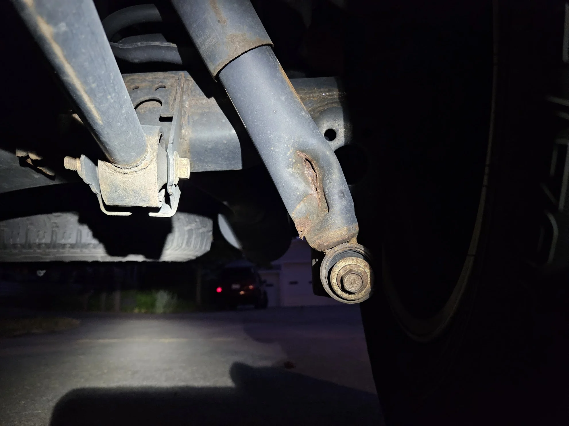

Highway commuter, somehow smashed a shock. Looking for stock ride, quality shocks, in case anyone has found especially good ones, or ones to avoid. Chicago roads are tough, need a tough truck!

I just replaced my rears with OEM. I’d recommend the same for you.

Yeah, my commute around Chicago is sometimes crazy, I've hit some big road debris. This must have happened years ago, I've had a weird corkscrew bounce to the truck for years. Kept thinking it was the bigger heavier tires, so glad to figure this out.
I feel dumb for not noticing this before, but moved three times got married and changed jobs since buying this truck, tools and space for DIY pretty limited. Dealers have been doing oil changes, brake changes, an alignment, and nobody noticed this for 100k miles.

Definitely take you up on rear shocks if you have them. My brother @IdahoDoug is thinking I should be able to find takeoffs from someone on Mud. My shocks have 103k on them, still young in Land Cruiser years.

If you can’t find take-offs the stock shocks are actually pretty affordable from Toyota. MSRP is about $65 per unit, regular discount sites near $45 even without special sales.

I ran over an 8' long piece of 3x3" or 4x4" steel angle a couple years ago, pretty sure that is what hit this shock. Car in front of me hit it, and shot it in front of me before limping to the shoulder with multiple flats. I blasted over it with a harsh whack, no time to slow. Those kind of things make me sacrifice ride for ruggedness. And I need excellent winter performance, which no other AT tire seems to come close to these Nokians in slush and snow at highway speeds.
