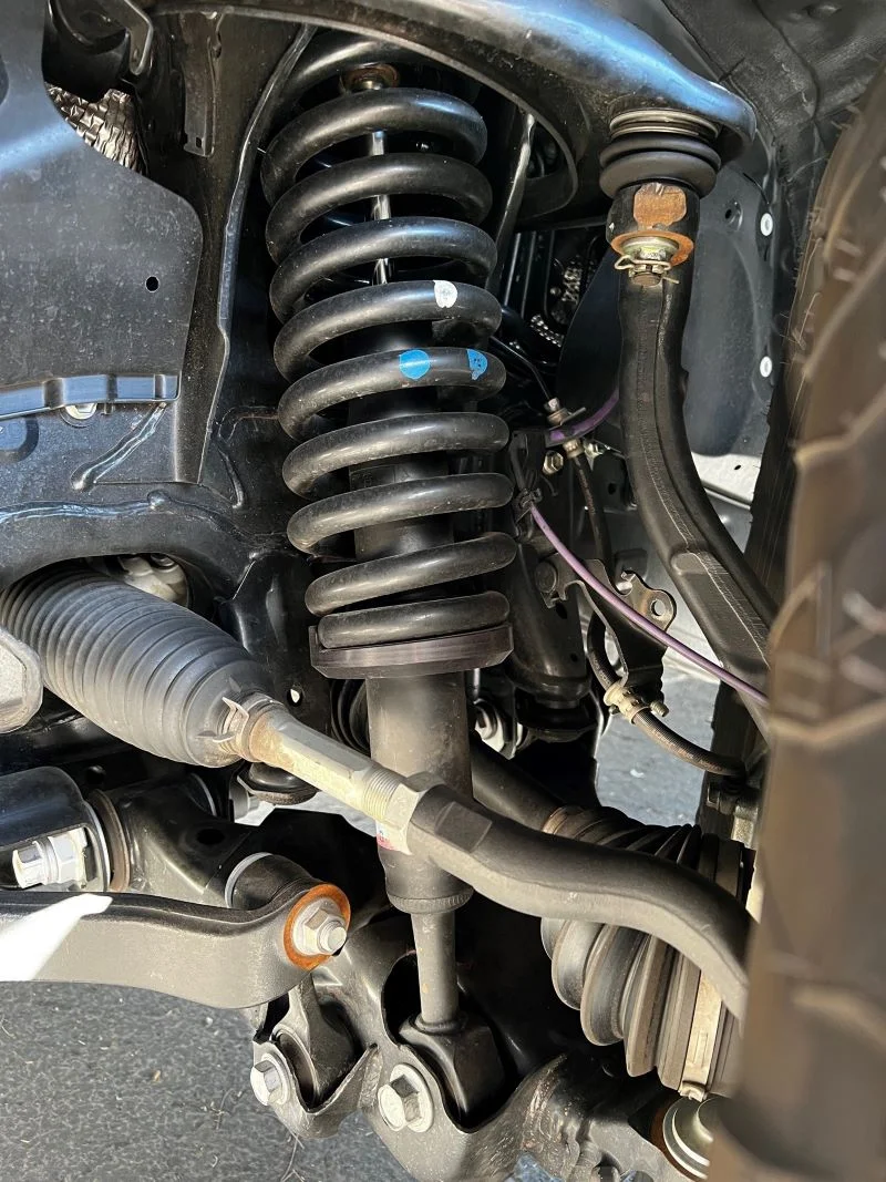

Westcott Designs has taken the OEM spacer concept a bit further and made a full Preload Collar lift kit. This is not a spacer lift, it actually sits inside the strut assembly and retains the factory suspension geometry. Good for those who want to keep the factory suspension and don't need more articulation as a traditional full suspension lift with UCA's would provide. Stock capability and ride with more ground clearance.
Claims 3.0” front lift and 1.25” rear lift. $425

Can anyone comment (to me, a relative novice) how adding a collar spacer at the bottom of the coil and another spacer at the top of the coil is superior to just one or the other?
Or perhaps what are the upsides to either vs or vs both?
From what I hear 1/2” or less spacer on top is the most you can go giving about 1” of lift. Westcott adds to that by doing a preload collar for the rest of the lift. They said it’s not quite 3” more like 2.75”.

I'm confused about this. Isn't the lower collar just raising the spring without actually compressing it and therefore not adding preload?
In my ISF I have aftermarket ohlins coilovers where you can actually add preload, but this is because they have independent preload and height adjustments. Raising the lower collar on the ohlins actually compresses the springs (adding preload) without raising the car.

The spacer on top of the coilover, what I call a coilover spacer, is preferred. Because it's not just increasing the neutral ride height, but it is expanding the suspension travel by that same amount. Almost no detractors for ride quality differences.
The coil spacer affects pre-load and the standing free length of the coil to gain ride height. Generally good and fine. But there's limits and too much here can have side effects. Too much lift can decrease droop travel to the degree that it effects ride quality. It can also create coil bind in compression travel, meaning the spring rate increases dramatically at the bottom of compression travel, in a way that's outside of its design parameters.
Did the coilover have tender springs?
Food for thought… the “internal” spacer such as bottom or top mount between the spring and strut or strut mount will increase coil preload. It’s just the nature of it. Therefore will affect ride quality. You are gaining height by preloading the spring more so than stock therefore increasing height. The strut does not physically get taller with an internal spacer, it’s the same height. The spring does not compress as much when the load is put on it (due to increased preload) therefore the height is taller.
If you don’t believe me put the strut in a strut compressor without the spacer, take it apart, install the spacer, and reassemble. You’ll have to compress the spring more to get it installed, in which it will get more difficult (and sketchy).
I always prefer the bolt on top of strut type spacer for “stock like ride”.
