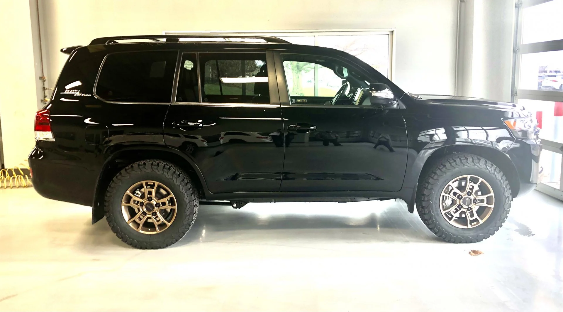

OEM Front Coil Spacers Installed (6 Viewers)
BTW, it took my shop 35 minutes to install these, they charged me $80 and my alignment at the alignment shop was $86 with tax. All in with the cost of the spacers was $236.
Done! This should keep me happy until momma allows the Dobinsons MRR kit to go on lol.
@Tex68w what size KO2s do you have installed? The stance in photo two is perfect, IMO.
