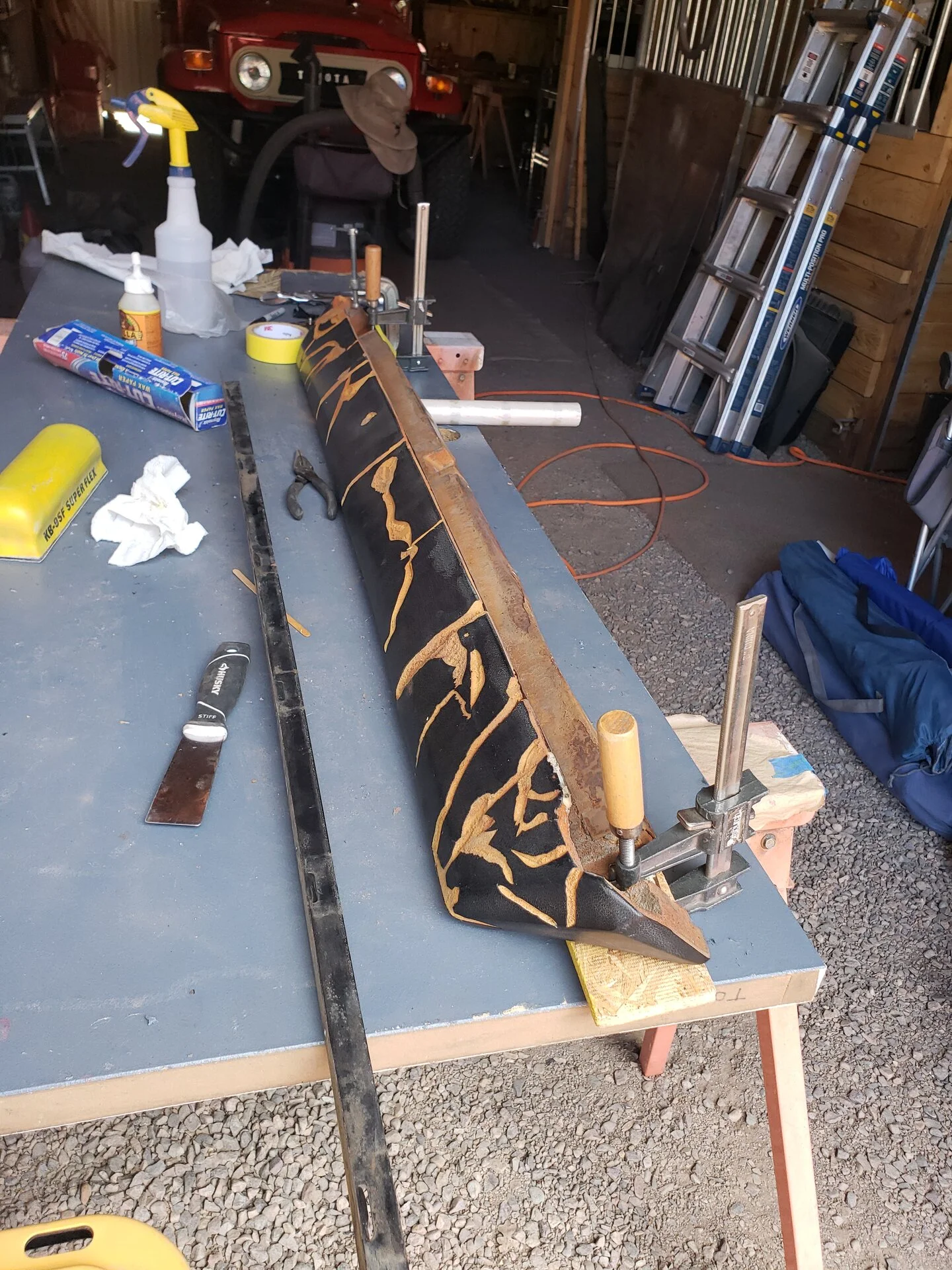

My lovely bride said, "Just buy a new one." Almost did that, but I wanted speakers mounted up there and I couldn't bring myself to hack up a new pad. I am also DIY to the extreme. So, I went to work.

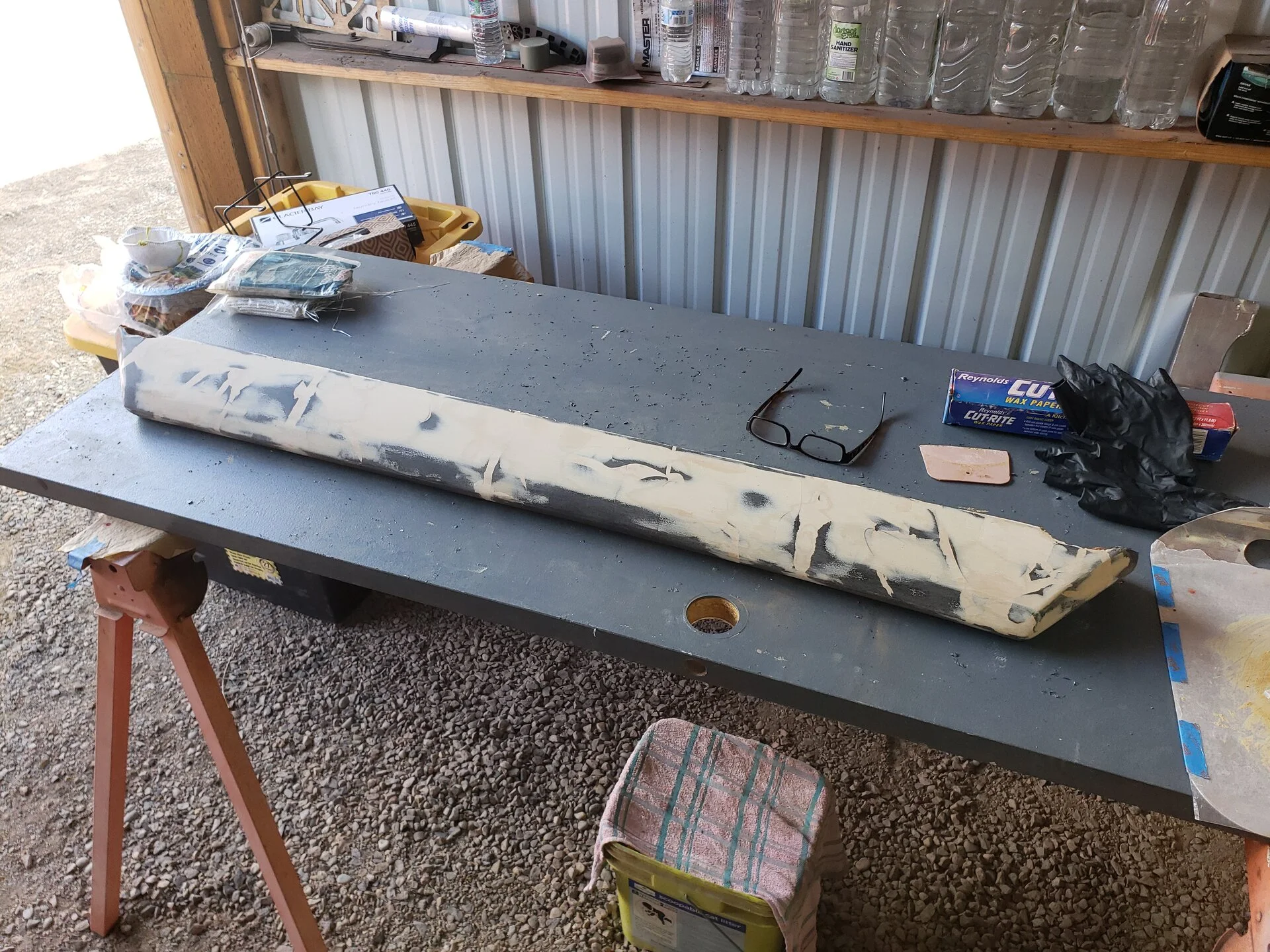

First you must cut out the cracks as they curl up above the original surface. A heat gun will soften the vinyl and a razor/Xacto will work fine. Once the surface is even again, fill the furrows you made with body filler. Rage Gold works great. 3M Premium is identical, as far as I can tell.

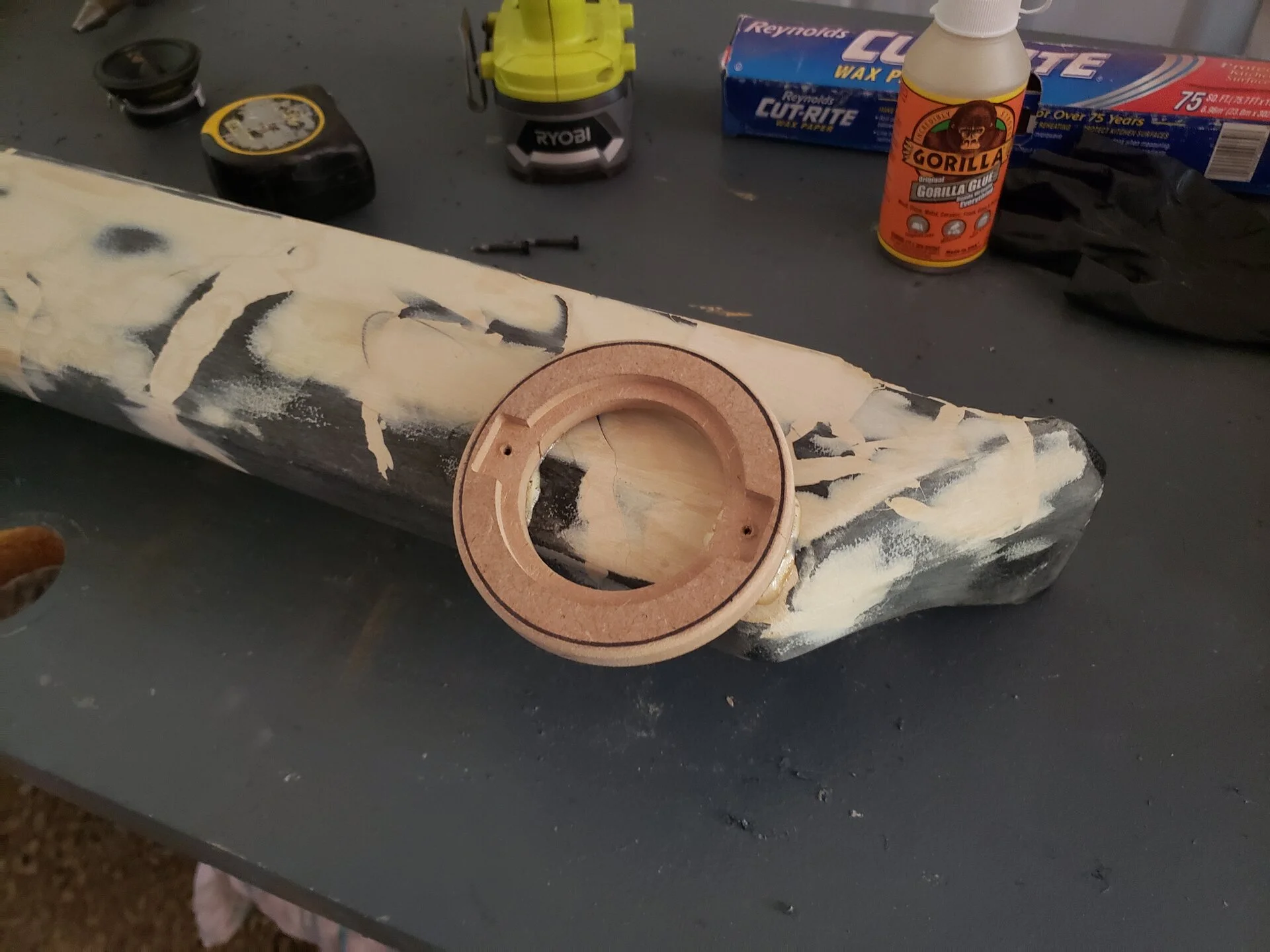

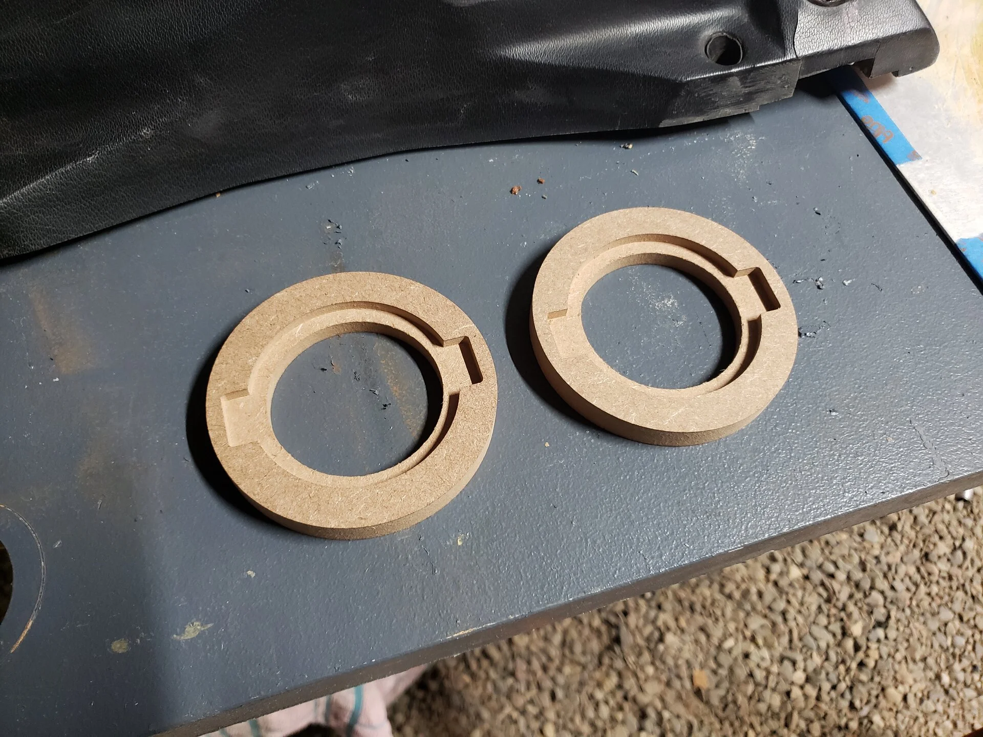

Next I made some mounting rings from 1/2 MDF. After several considerations, I settled on a location and glued them in place.

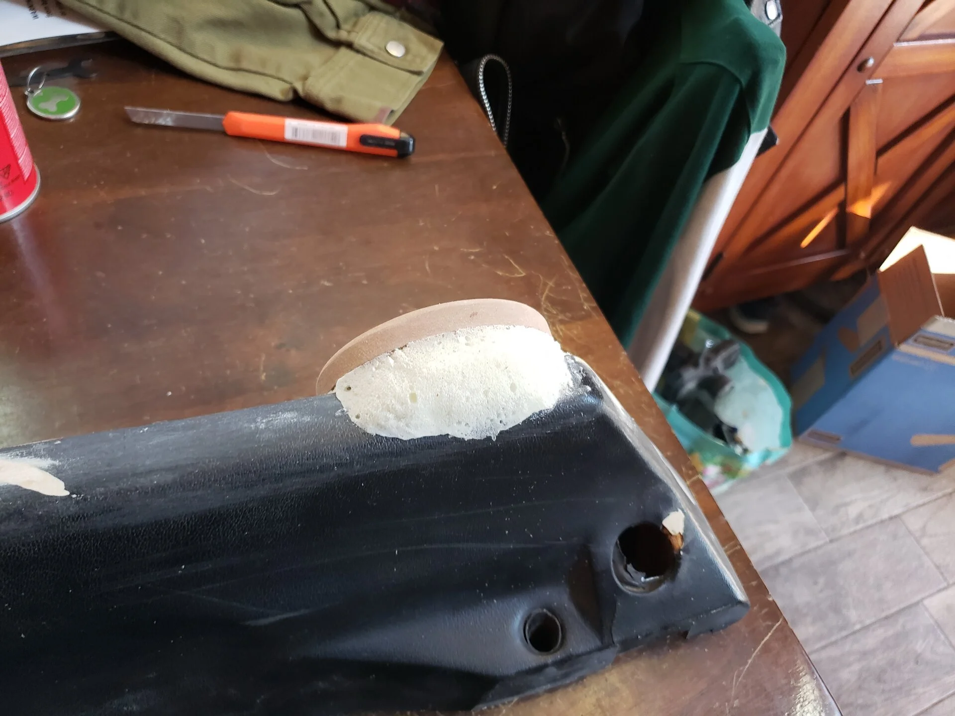

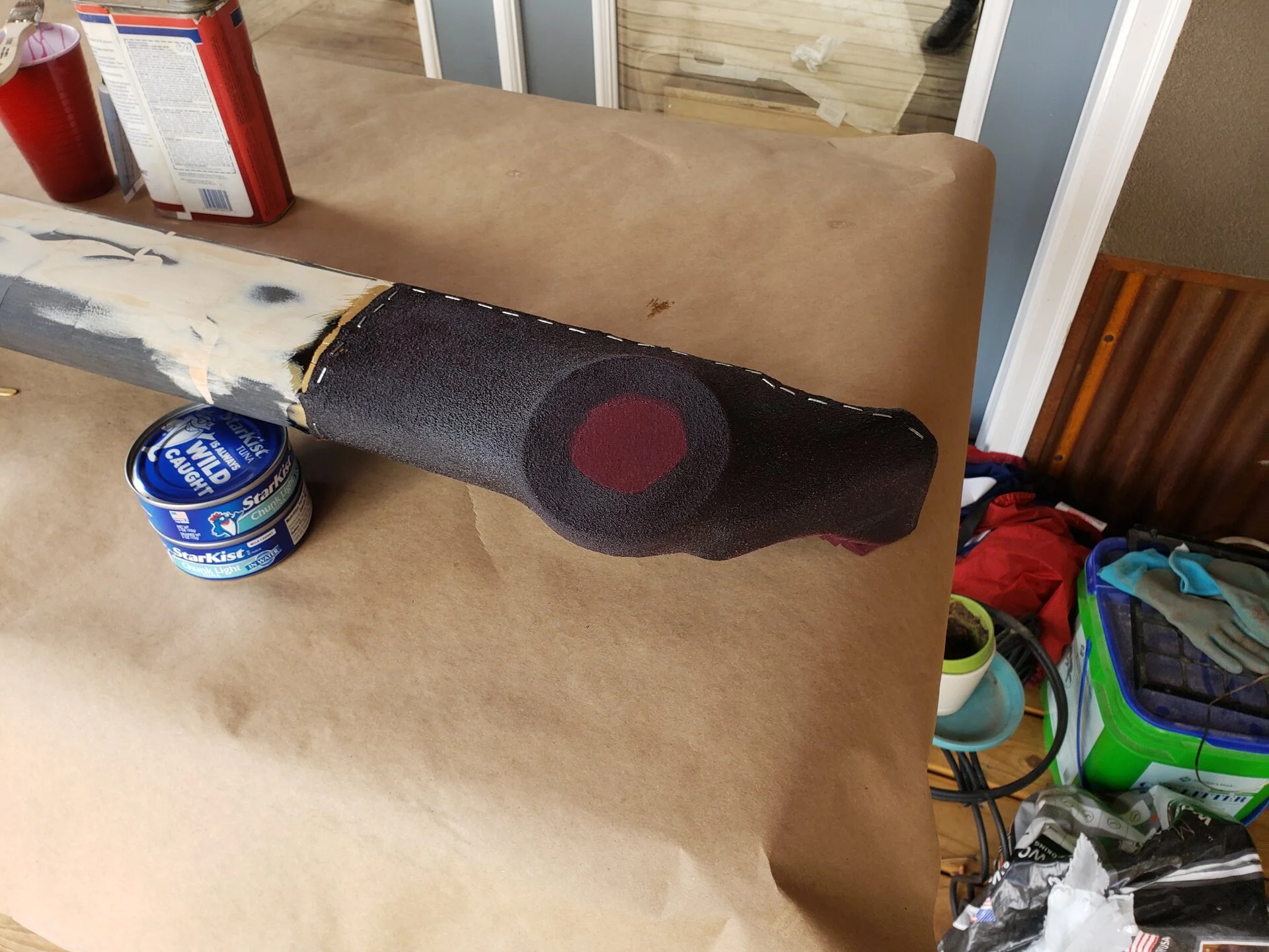

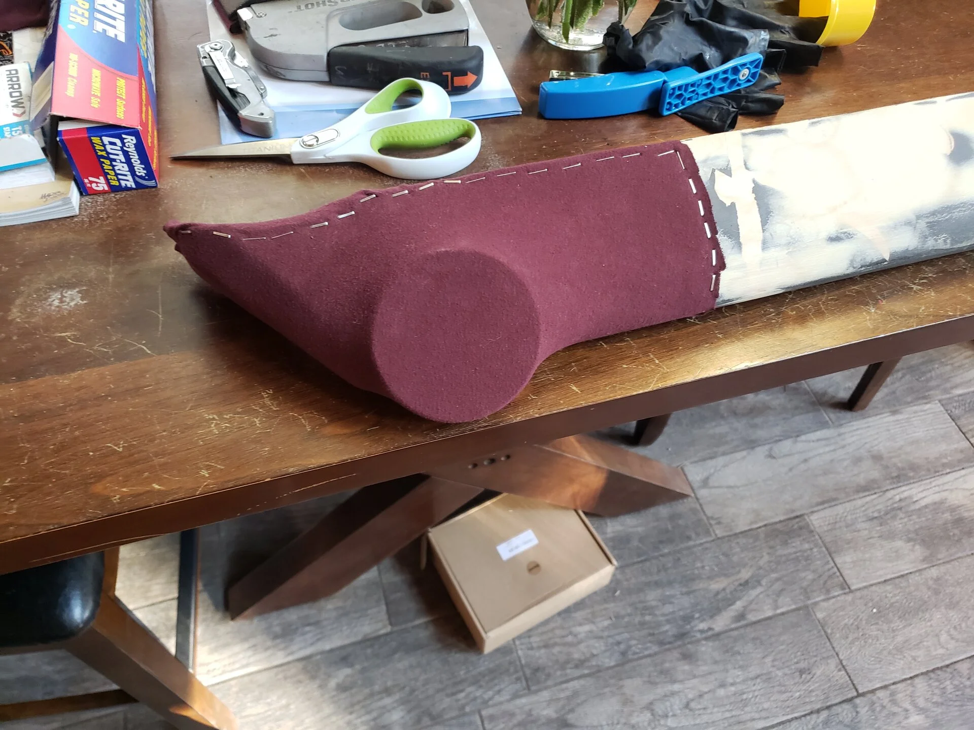

I built up a shape with expanded foam under the front of the rings. Then made a transition contour with t-shirt material.
I coated the material with polyester resin and stumbled upon my first fail. The resin melted the foam I added.

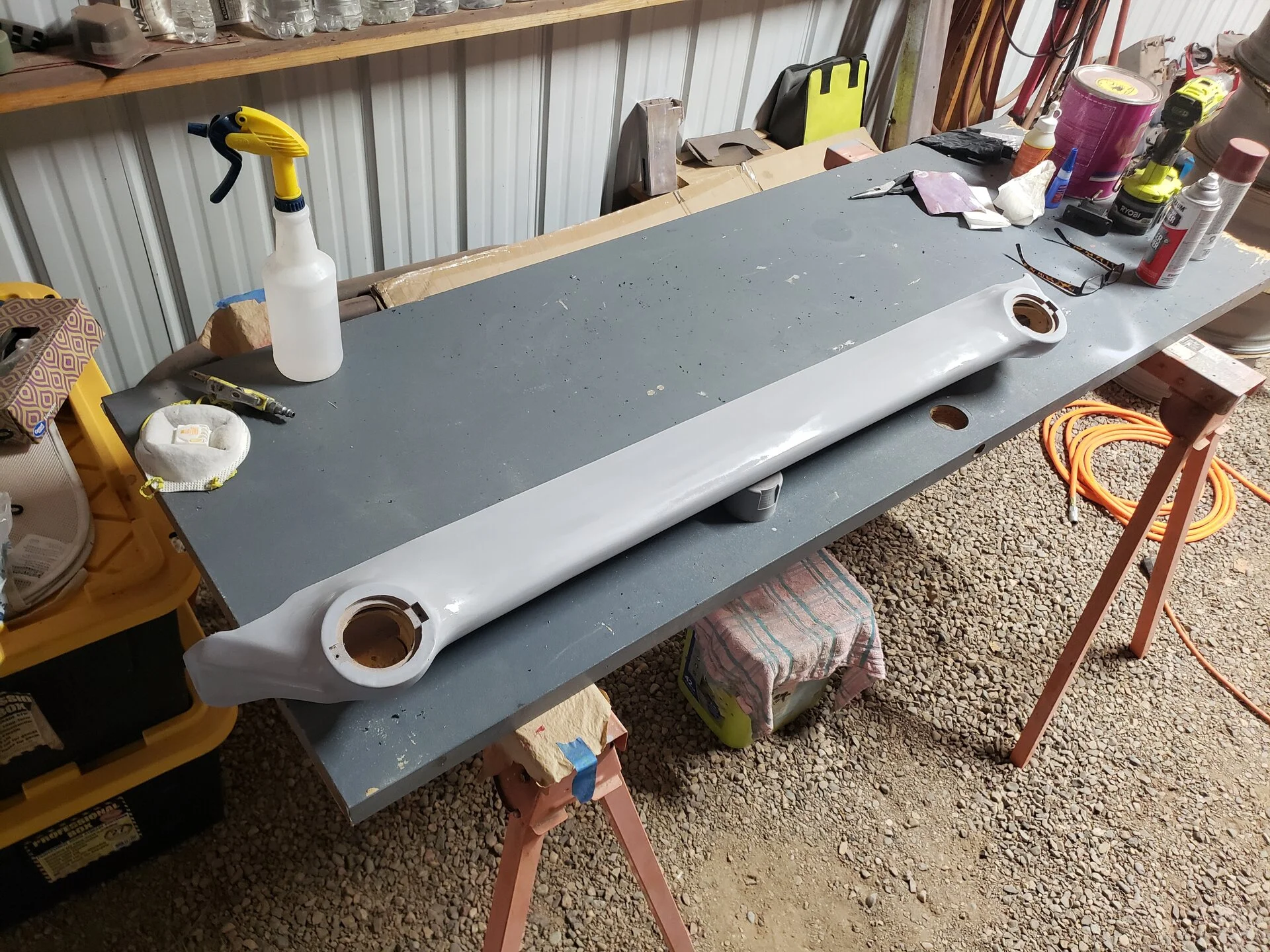

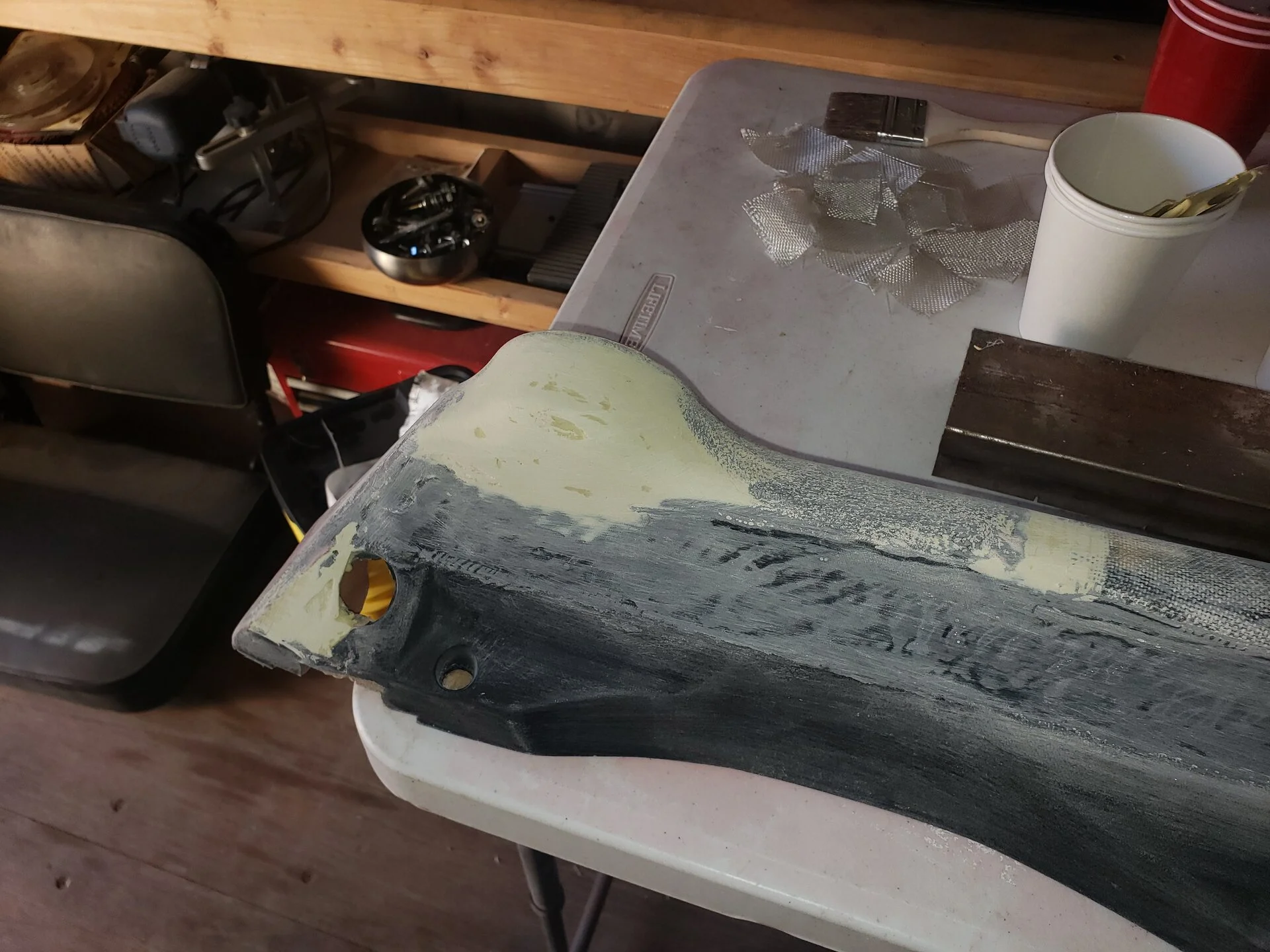

I reshaped the area below the rings with body filler. When I was satisfied with the shape, I glassed the entire dash pad.

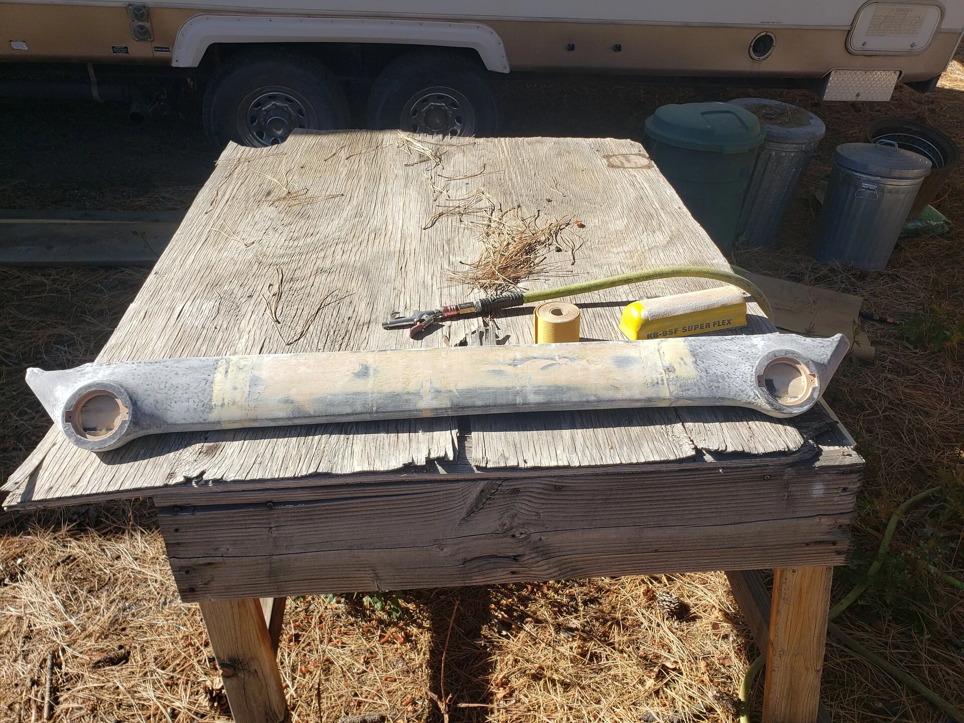

Then finish filled and shaped with filler and primered.

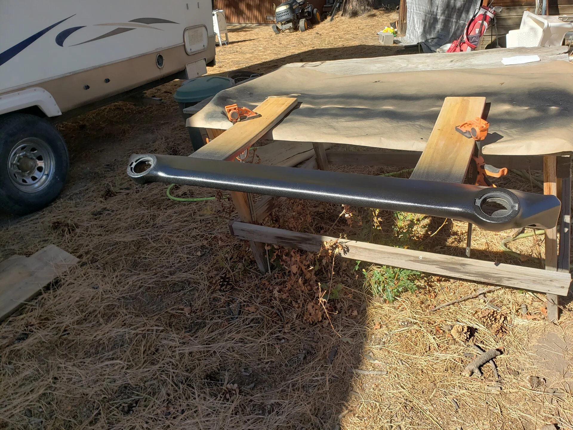

Textured black finish.

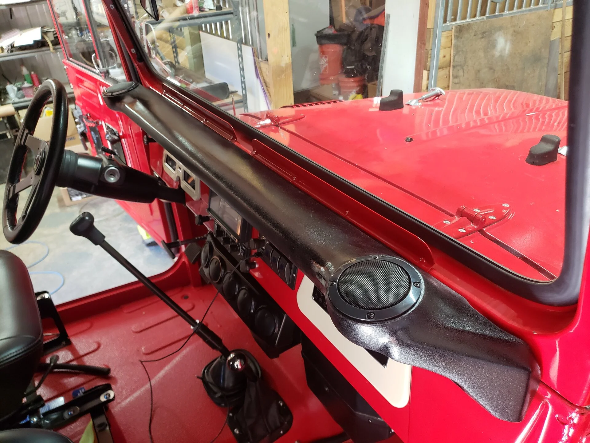

I should have the speakers loaded into the dash today.
Speakers and grills in.

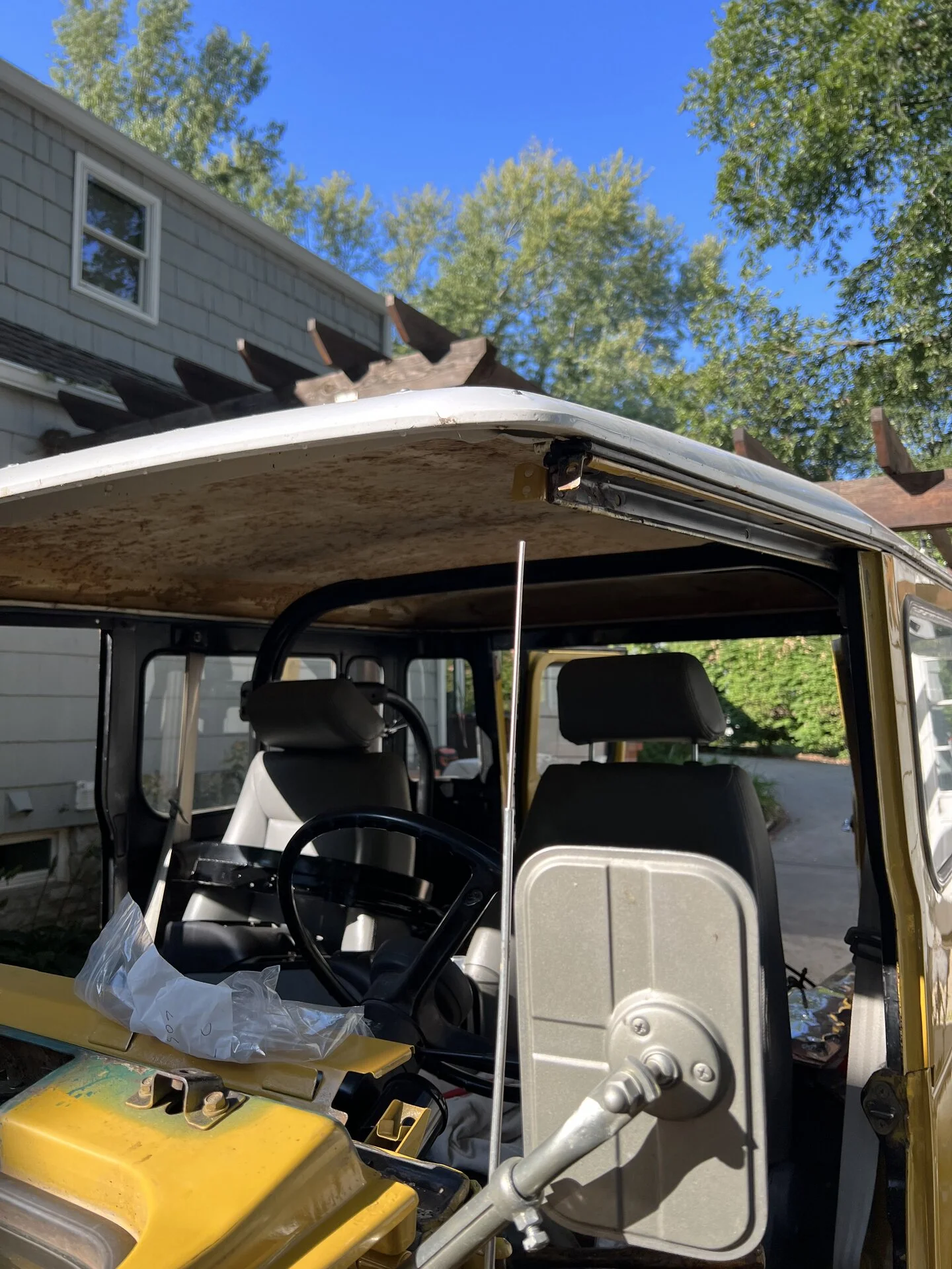

Thanks, can the windshield be folded without removing the hard top? I fear that any movement of the hardtop will lead to a snake pit of removing the top, which I am not prepared for at this time.
Love this build idea. Did you have to tip the window forward to remove/reinstall the dashpad? Can you provide info on the "installation" attachment process?
I didn’t know how it comes off either, found a thread on the topic – still didn’t fully understand the removal after reading. I started at passenger side, lifted up and out along all six brackets/tabs toward the driver’s side. Rite of passage, I guess.
I removed my roof to fold window down. Windshield down was able to see where and how the tabs lock in the dash pad. Technically you don't need to but what I know now a) way easier and b) found some rust underneath that I was able to address and keep from spreading.
When I recently did my hinge pins on the doors - (the windshield needs to fold down for the top pin to come out) - I unscrewed most of the bolds from the front to the back (don't forget the 2 at the top of the windshield) of holding the roof on then me and a friend lifted up the front of the roof enough to fold the windshield down.
