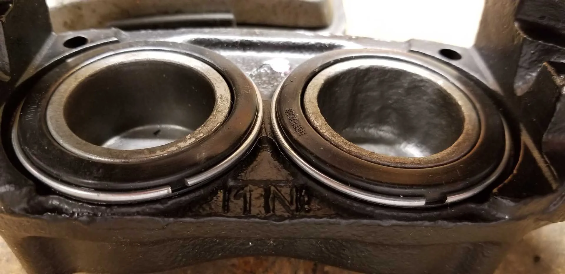

From what I've seen on other threads, the Remans do come fully loaded with pistons and seals (less pads and hardware of course). Can anyone validate 100%?
I can't determine if the new ones come fully loaded and do the new ones require a core?
Thanks in advance for the help!
The reman front calipers come with new pistons, seals, and bleeder.
They DO NOT include slide pins, locking spring clip, anti squeal plates, pads, banjo bolts, copper washers.
The missing parts are very inexpensive to purchase new.

The rear remans only include the piston housing, piston and seal. They do not include the mounting bracket, slide pins, seals, etc.

I have a set of new OEM rear calipers still in the box waiting to be installed, they're perfect. As mentioned above, they come bare with just the piston and seal installed, and the shield/protector bolted to the back, but no bracket, brake pads, pins, or springs.
I have a set of new OEM rear calipers still in the box waiting for the rebuild, they're perfect. As mentioned above, they come bare with just the piston and seal installed, and the shield/protector bolted to the back, but no bracket, brake pads, pins, or springs.
Awesome, so new calipers DO come with the piston and seals. That's worth it. Given the 4x pistons alone for the front easily cover the price of just one caliper.
New calipers are definitely a better deal than buying replacement OEM pistons separately.
