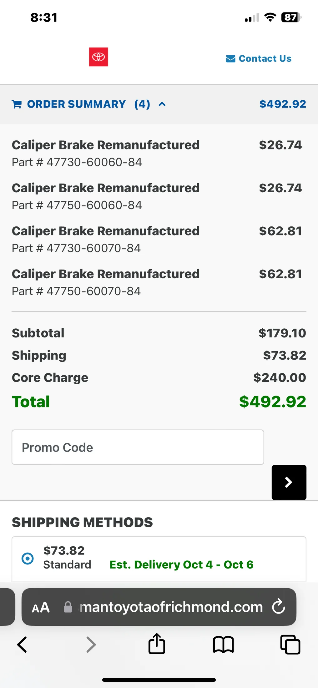

Ourisman Toyota is selling OEM reman front calipers for $27.
47730-60060-84
47750-60060-84
OEM reman Rear calipers for $63.
47730-60070-84
47750-60070-84
At these prices, I'd pick up 2 sets and keep one on the shelf.
Don’t forget they charge core charges so kinda pricey if you want to keep your old ones. I need to price new ones if they have a discount on those to see the difference.

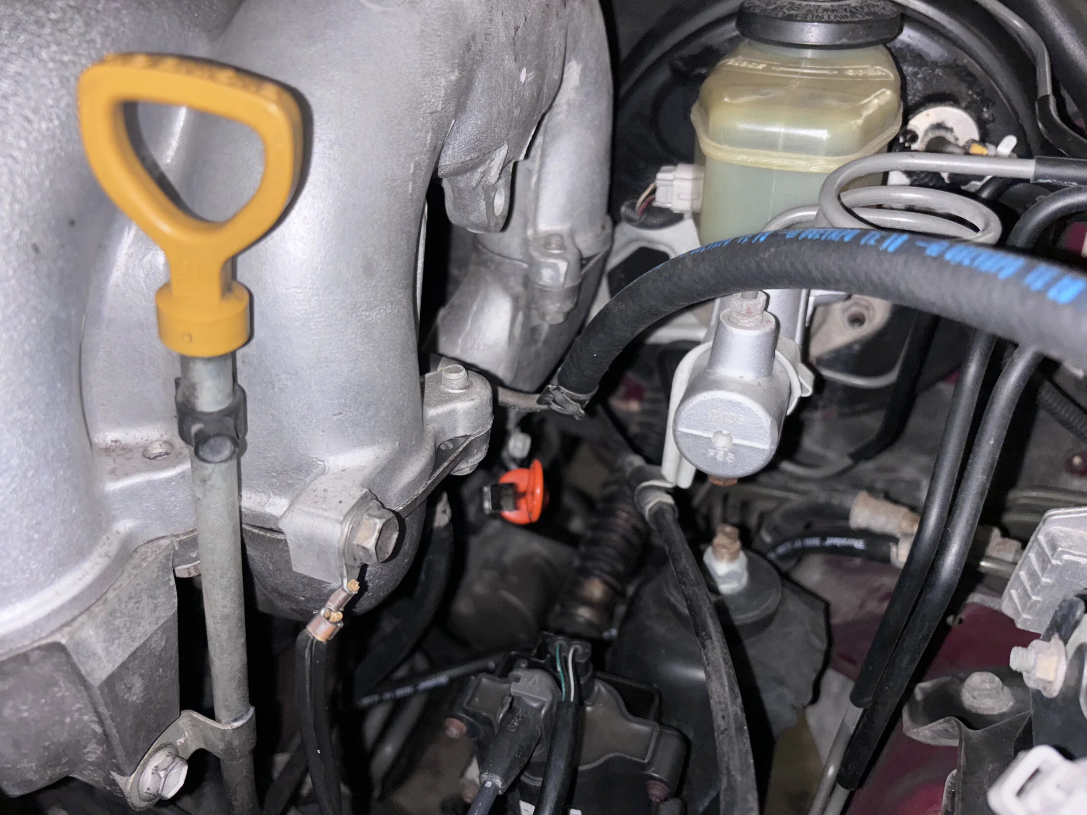

Would it be obvious to any of you if this is a replacement Master Cylinder? The pedal feel driving was not bad and if I can reduce my project load a bit I would be happy. I know the service post-2017 and I have the prior records, so I will check this evening. The upper intake was removed and cleaned in July so I would call the lower intake more indicative of how the cast metal has aged. There is no sign of any active leak on the booster surface.

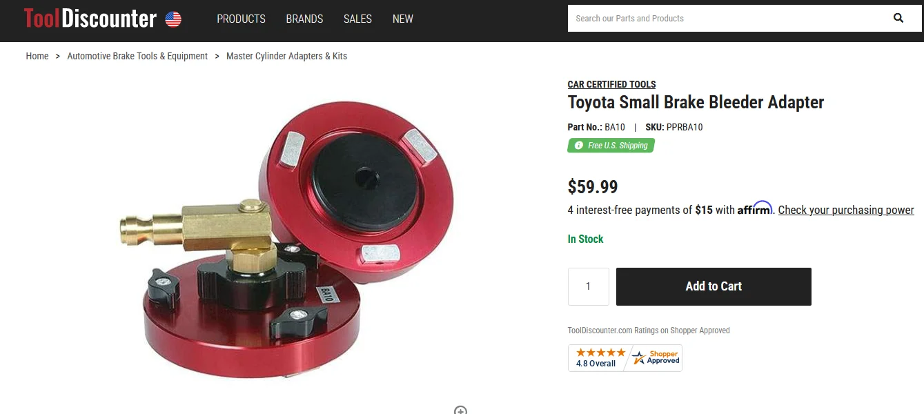

The provided Motive cap is crap. You need one of these:
the link has options for buying.

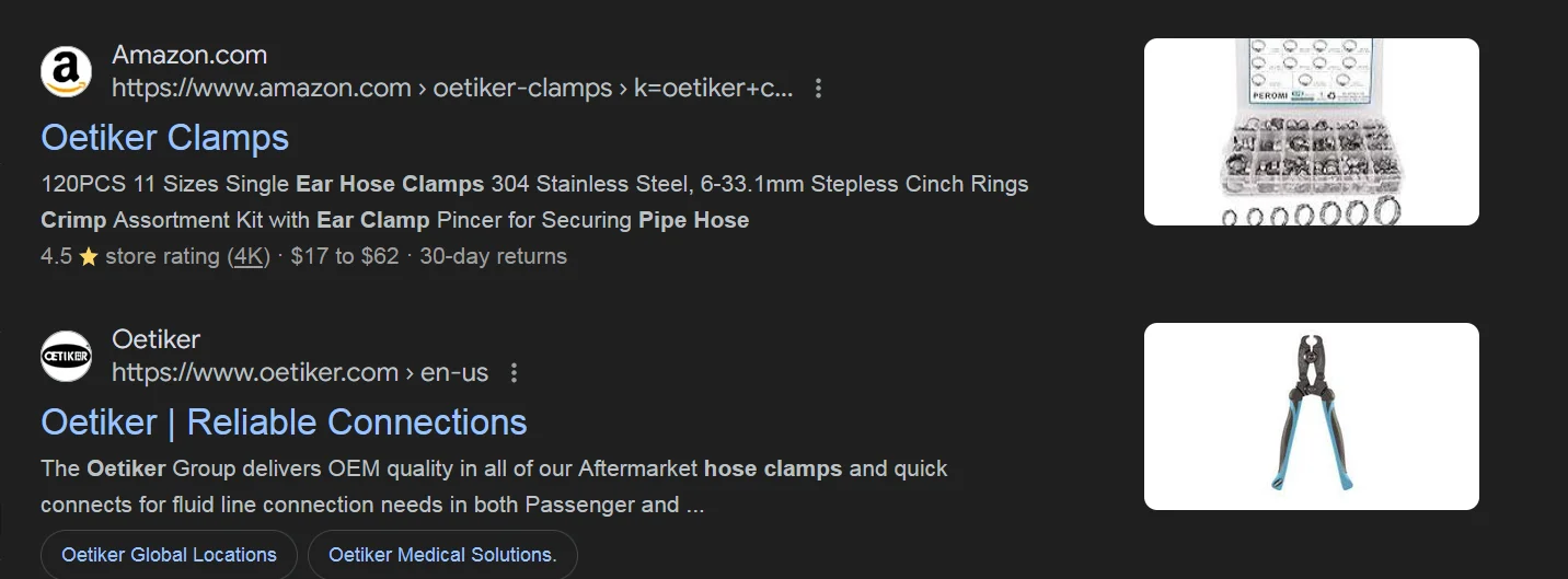

I cut off the old business end and crimped the hose on this one. Far better. Motive should not send their units out with the crap cap they include.

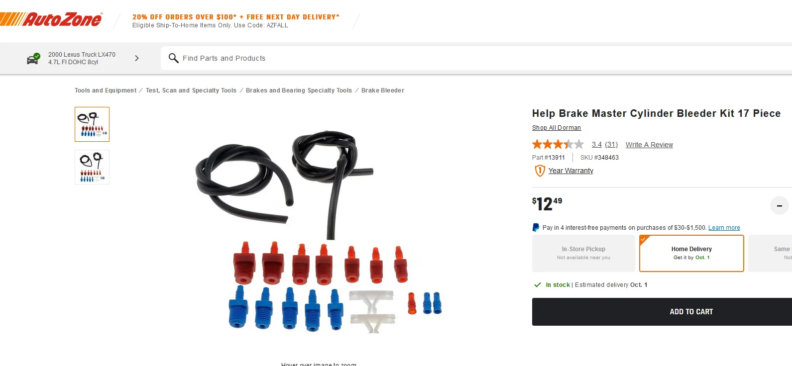

The SST you need, which is the only one I've noticed isn't in the Toyota service manual, is a master cylinder bench bleed kit:
Every parts store has a version. I bought Napa's for no other reason than they are the closest store. Unfortunately, you need two Napa kits, because there aren't enough fittings for the job in one kit.
You screw them into the outlets in the master cylinder and run the hoses into the reservoir (not into a rag, in your hand, as instructed in the service manual).
The blue ones are metric. This allows you to "bench bleed" the master cylinder in place, and not a bench, which would be messy, in any case.

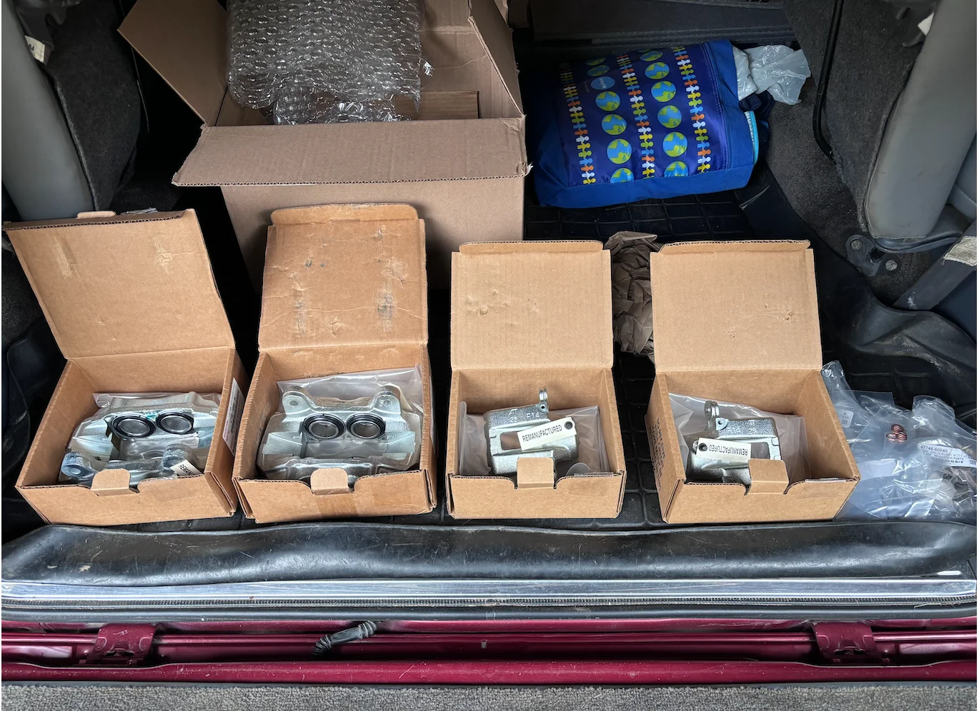

Things arrived today, Ourisman is pretty quick. Order went in noon on Monday, parts here by 11:30 am Wednesday. That adapter for the Motive Power Bleeder looks great. The standard is hopeless. They are all on, bleed the system the old-fashioned way. There must still be a bit of air in the new front calipers as the pedal feel deteriorated after they went in. I did my work back to front and used the old-fashioned pedal bleed method.
I am guessing the LPSV has not been bleed in a long time -or ever. Brown the black, but it did not take long to clear. The system was bled four months ago when the lines were replaced by a local mechanic. A lot of debris came out of the calipers when I drained them prior to packing.
I used a bit over a quart of fluid.

Brakes feel good, no noise and I have a functional Parking brake as a bonus.

That seems to be what the car has been serviced with in the past. That said I am tempted to put Toyota's in the rear. The system passes the Brake Booster test with flying colors. I still feel as if there must be some residual air in the system.
That seems to be what the car has been serviced with in the past. That said I am tempted to put Toyota's in the rear. The system passes the Brake Booster test with flying colors, engine I still feel as if there must be some residual air in the system.
try doing some high speed stops in loose conditions to activate your ABS then re-bleed, When I bled my system it took almost 2 compete bottles of brake fluid the large bottles, Load sensor lines had lots of air and nasty old fluid.
I did as you said and was shocked at the amount of air that came out of the RR & LPSV. I ran a total of 3 quarts through over the two bleeding sessions. I would like to think the system is free of air.
