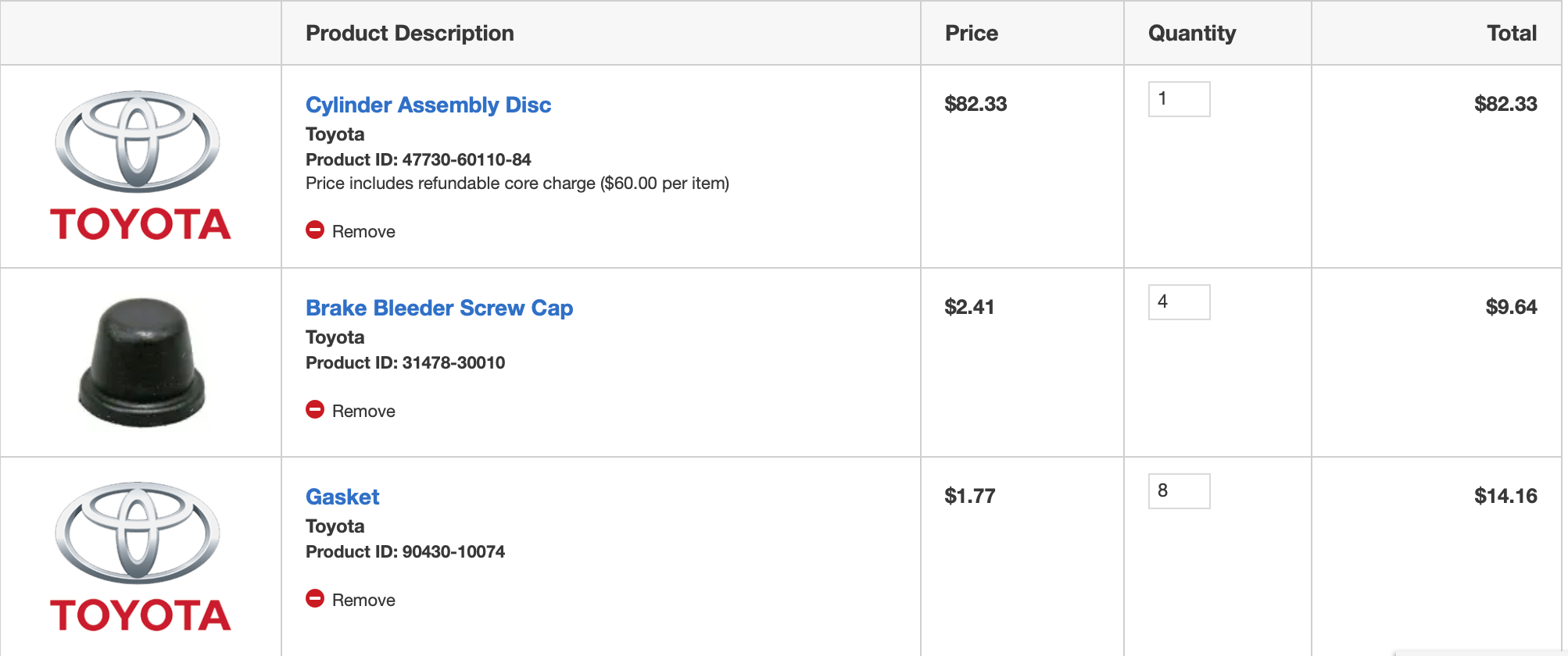

Toyota soft lines were "first" project. Rotors are all Toyota, rear are new front have 10k miles on them. I have wheel bearing kit ready to go......So, my only point of departure is the Akebono pads.
What hardware comes with the remans? Do I need to order slide pins, clips, bleeders, rubber bits?
I have a "cart" going on their parts site, I know I need the copper crush washers, the banjo bolts are 2 months old so I plan on reusing.

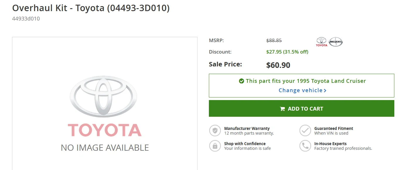

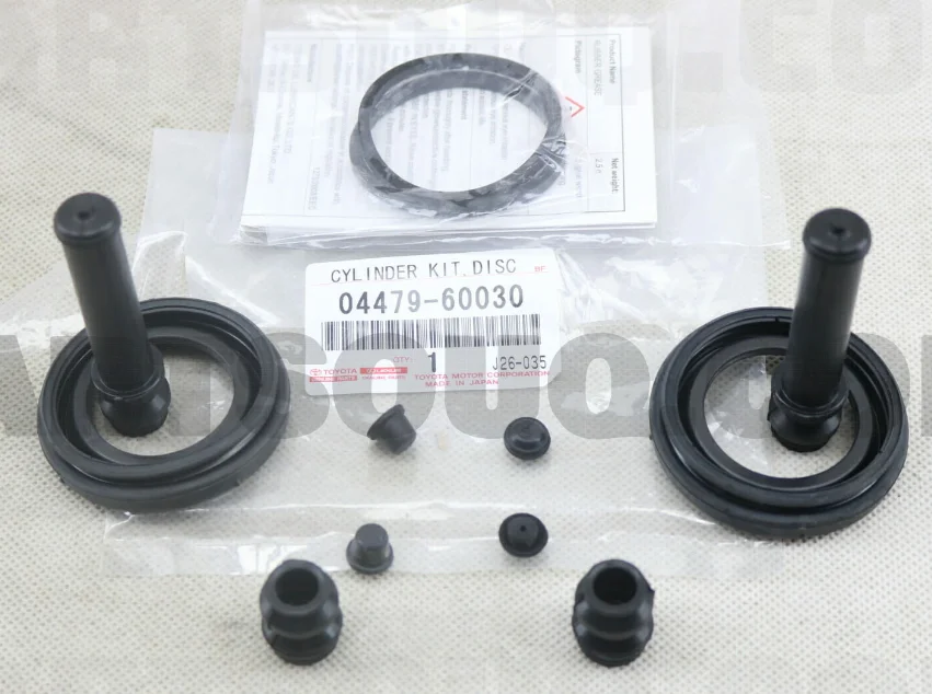

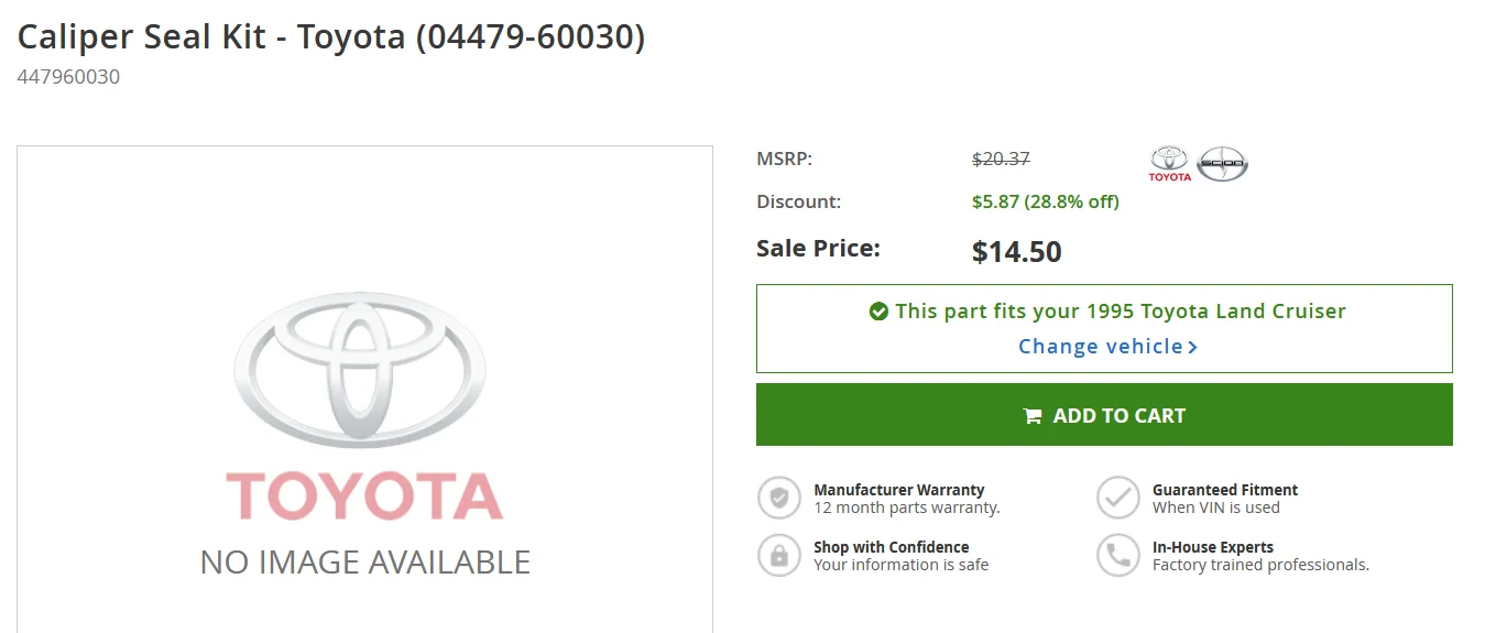

I assume you mean the piston in the caliper and not the master cylinder piston (on the firewall)? You shouldn't need to replace the caliper piston, unless it's been sitting for awhile. Even with a torn boot, they resist rust pretty well. If it is rusted at all, replace it. You won't know that until you tear it down of rebuild, but swapping new calipers is way easier, although it's stupidly expensive now. Ourisman's online price is
...and I assume that is rebuilt. The rebuild kit is
I know which I would pick.
BTW, these come with a smidge of grease. I throw that away. I have this:

So mentally, I am thinking of the remanufactured calipers all around. The rear R&R kit is within my comfort zone, fronts would be a challenge. The remans are around $83-87 per corner with a $60 core refund. I can swing the rear pads and hardware. If there is a quality concern about the remans, I will concentrate on an R&R of the rear. The rust I see on the piston is on the pad contact surface and the hollow inside area. I assume this is okay and it is really the outside cylinder surface that is the issue.

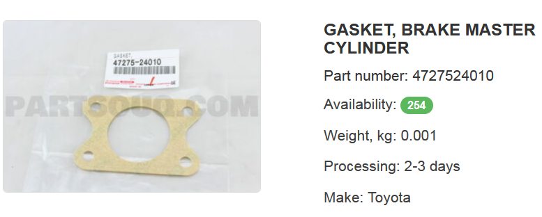

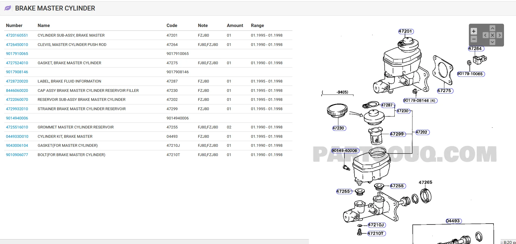

You can rebuild the master, there's a kit:
...and you need the rear gasket:

Yes it is 47265 in the diagram....can't find a full part number. Just checked to see if it appears on the Booster diagram - no luck.
Sounds like I need to introduce my self to Mr. Stedman.
It's somewhere else. Maybe Onur will chime in and help out.
