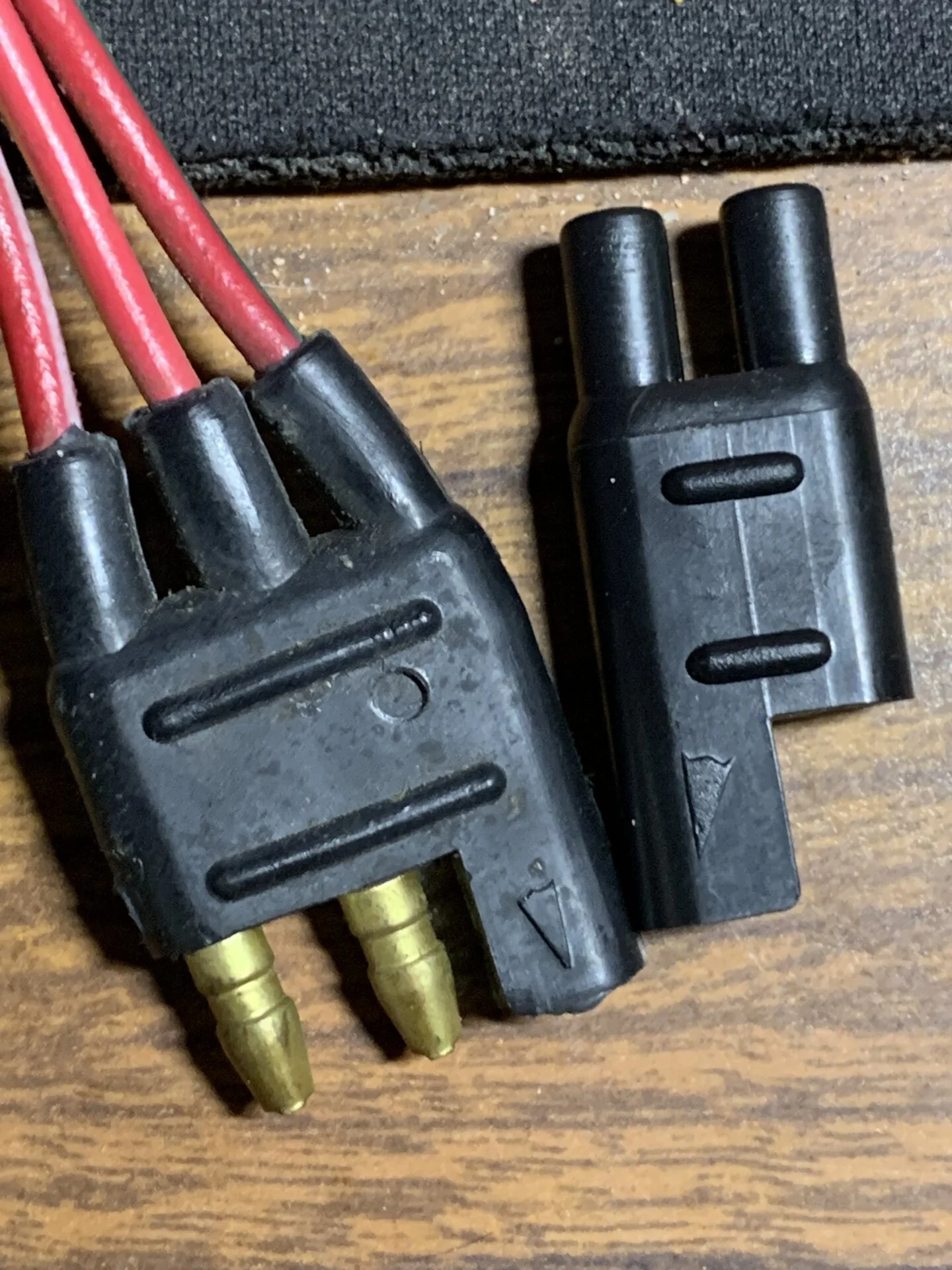

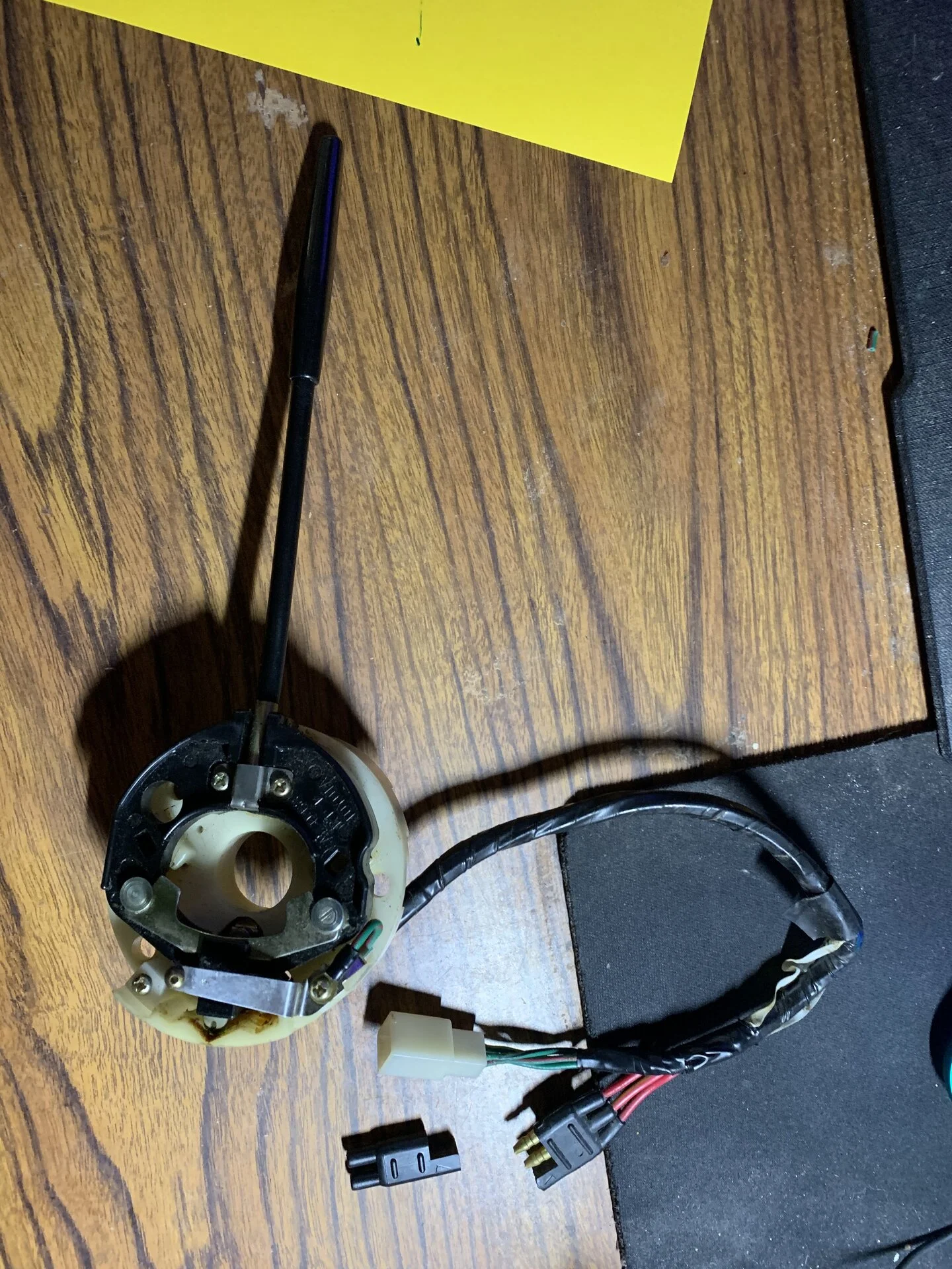

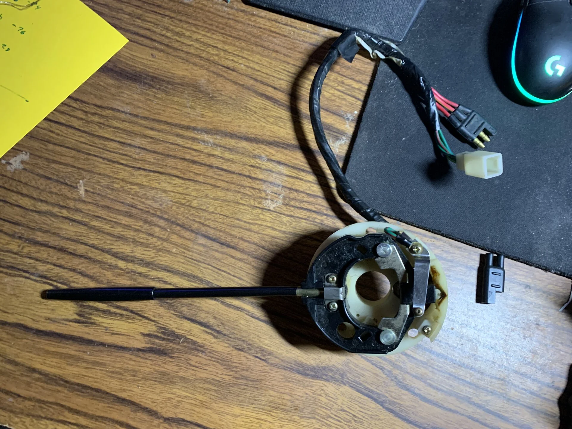

Looking for anything that from system that uses this plug. From signal setup on column that uses this type of relay

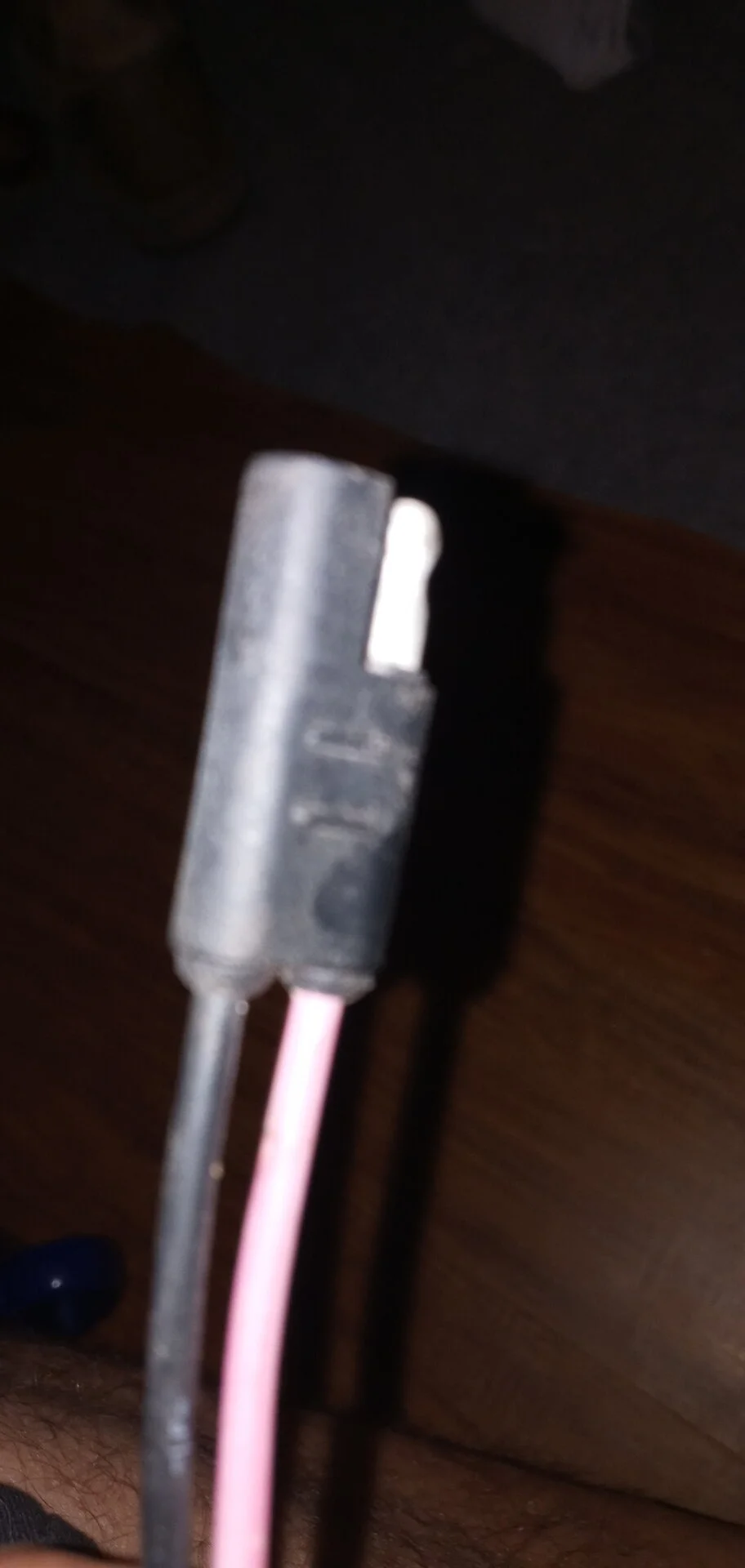

I would go to an RV store. Probably find one there. Black and white wires serious doubt that is stock wiring. Cruisers over 40 years old most with multiple owners have usually got PO custom wiring.
Agreed.

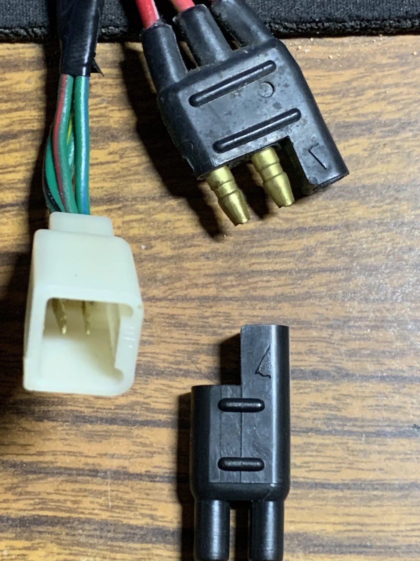

That one was just visual that i cut off something else but what i have in dash is exactly the same and its stock ive talked to someone else has one and specter had them at one point but no longer
@wngrog

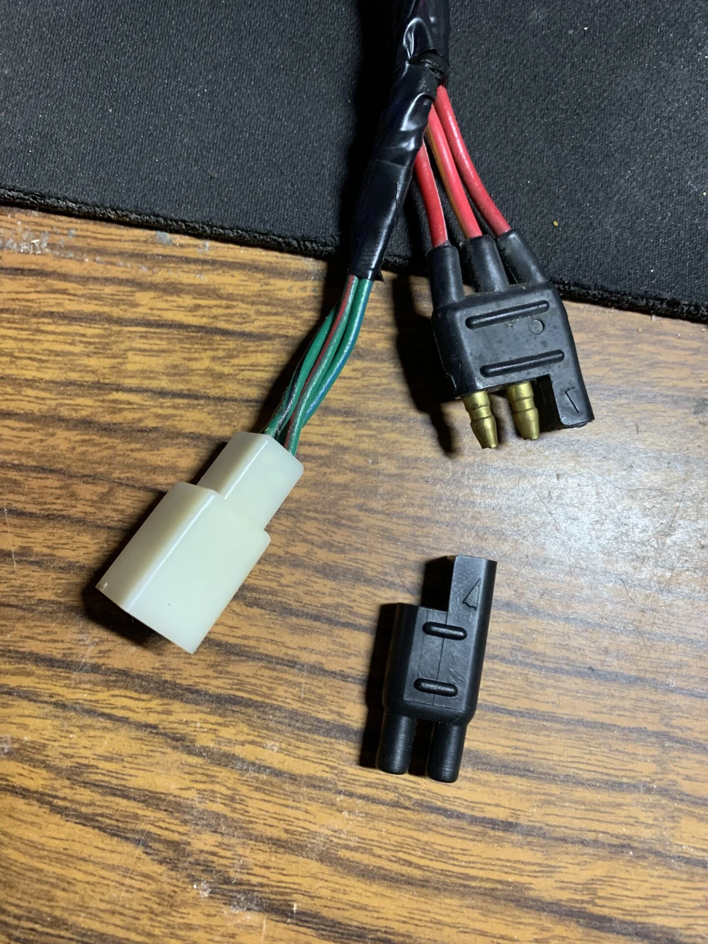

Looking for anything that from system that uses this plug. From signal setup on column that uses this type of relayView attachment 3403756
It's an SAE 2 pin connector.
oh lookie, , it's a 1968-9/72
FJ55 ONLY 84310-60040 / 60041
this should be the Earlier 1968-1969 ish 84310-60040 ?
