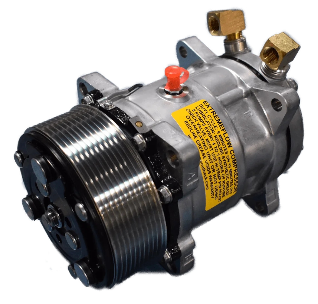

Aren't they just using a modified sanden/AC compressor? Seems like you could find one that would fit locally instead of spending $600+shipping on their compressor....?
Yeah, for $425 is probably worth the headache to get their mounting system. I've definitely spent some time holding an old AC compressor trying to figure how it would fit and it's not obvious. As an engineer this is the kind of thing worth 3D modeling and getting right the first time, but unfortunately you'd have to draw up all the models and that would likely take as long as trial & error bracket welding.
Currently working with a guy thinking hard about ordering the bracket and using my compressor.
I have the modded V belt compressor the same as the picture for ~$400 free shipping.
That brings the installed setup to $825 + shipping the mounting kit from AU.......that's probably break-even with the price of an ARB twin after you fuss with the wiring and fuses for it.
Wouldn't you need to swap pulleys on either the AC/balancer or that compressor so they could all run on the same loop together?
