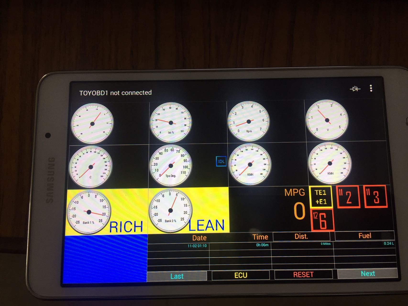

Since one of my O2 sensors is completely dead and i have bad idle I have a though decision to make
My mechanic dose not want to try to fix the idle before 2 new sensors will be installed
A week ago, Mr T approved me with the 1995 recall campaign that is a free replacement of the o2 sensors
Is there a problem (damage to the engine) to suck it up? And wait for Mr T parts they told me it will take 2 months?
Or mabey get only replacement for Bank 1 bad O2? (Is bank 1 LH or RH?) until I get the recall done? ( I know its better to replace the 2)

I was actually 25 and 55, but im going to adjust timing again after O2s are replaced and see if I still need a knock sensor.
Knock sensor code usually means the sensor is failing, not that your timing is advanced too far.
Yea, had code 55 and replaced the rear knock sensor and the code was gone right away. It was a pain to get to though
