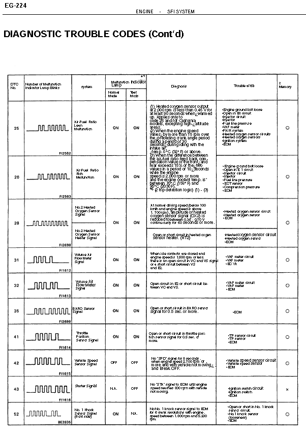

All OBD1 codes are a 2 digit number.
From the Toyota FSM:

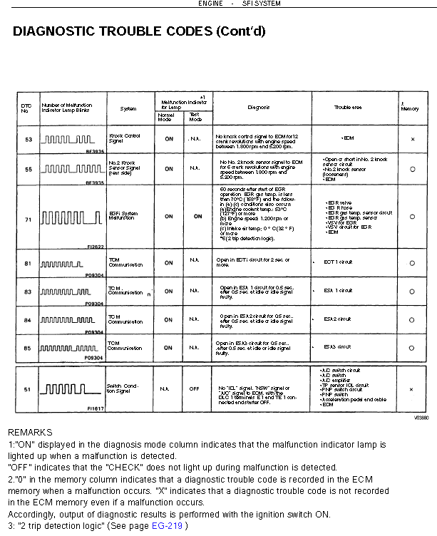

Hmm, then it must be code 55. I could have sworn my fsm didn't show a 55 but maybe I misread.
Story is still the same I replaced both sensors and their wiring when I did the engine out last year. Have to see if one has come loose or something.
Well, since code 55 is referring to the #2 knock sensor, I would start there as opposed to an O2 sensor. But that's just me.
