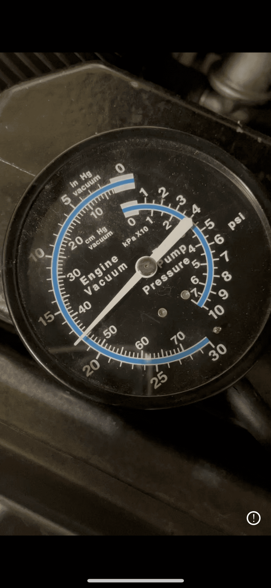

So I started walking back through the AI tests cause I had some time and when I got to the Deceleration Fuel Cut system, that failed. I pinched off the vacuum hose to the vacuum switch and ran it up to 2000 rpm, no air came out of the ABV. The engine didn't even misfire like it said it would. So I'm wondering if I need a new vacuum switch or VSV 2.
