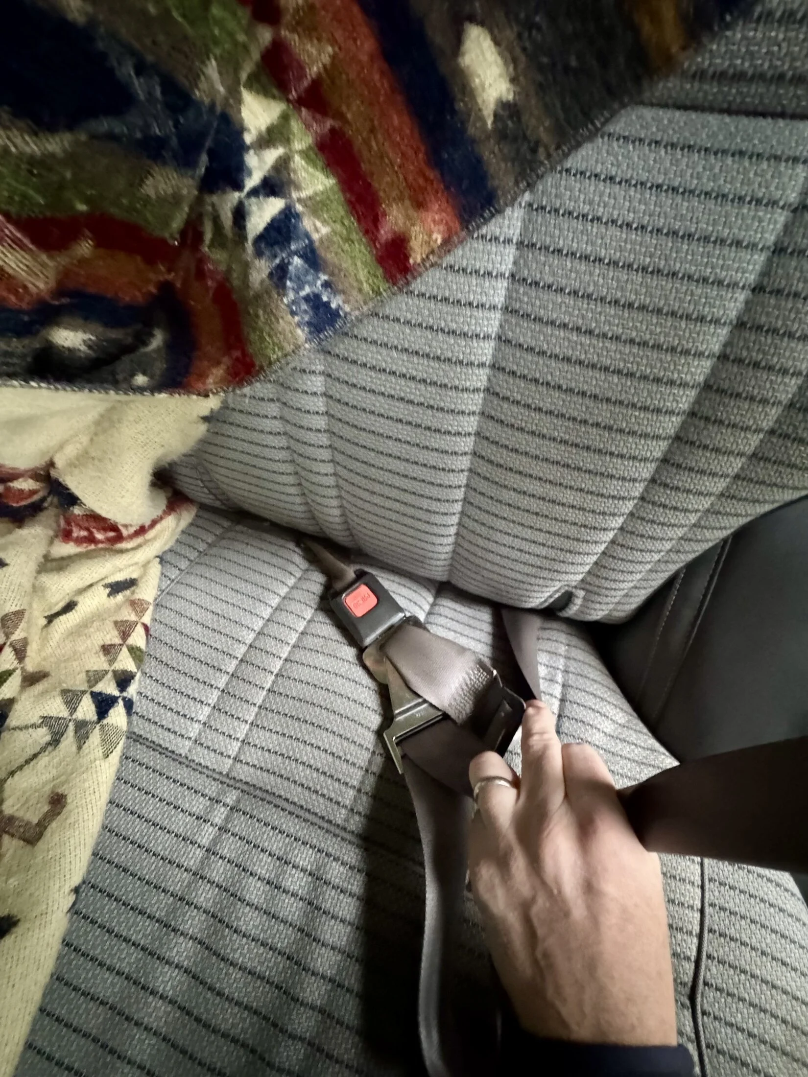

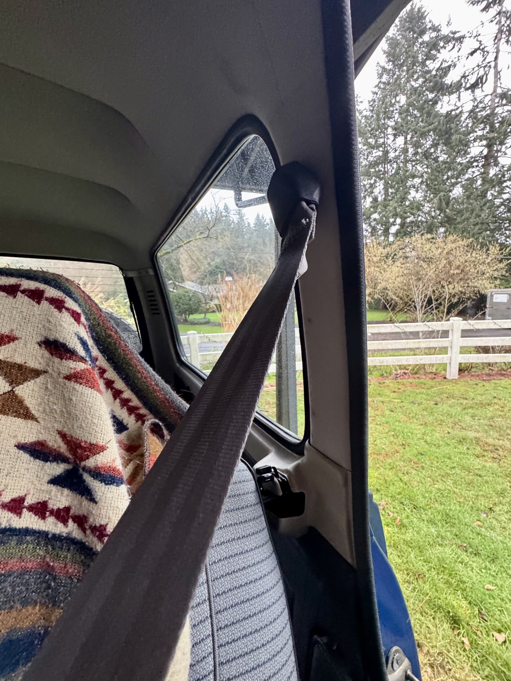

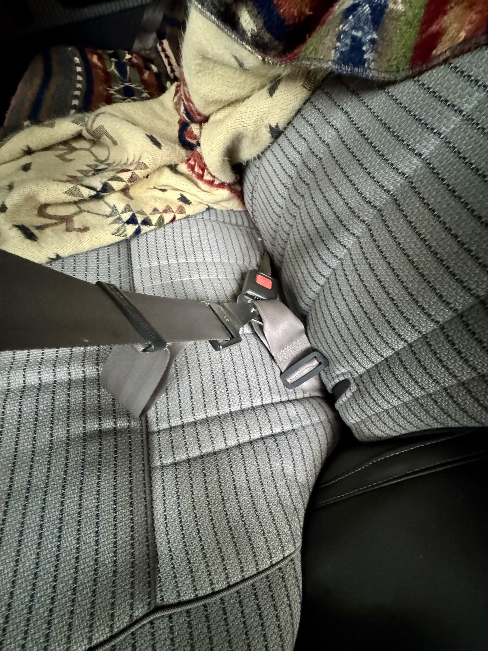

Here are my fixed rear seat belts 3 point. The shoulder belt is fixed and you adjust by lengthening it or shortening it. The lap belts retract. The entire thing is a pain and I already bought fully retractable shoulder belts to replace these with. I also found the unicorn trim piece to cover the retractable shoulder belt.

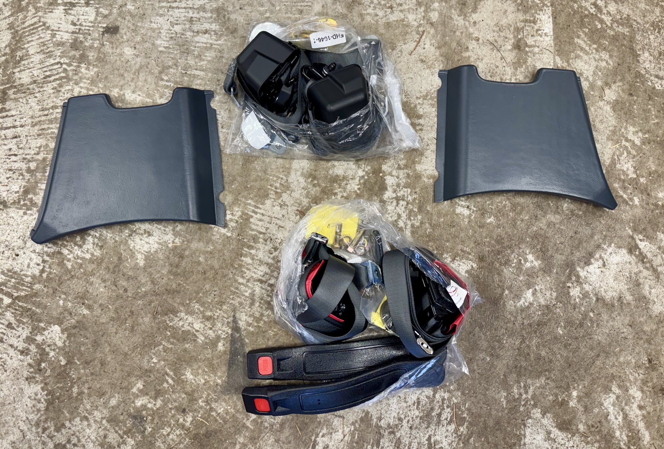

I am replacing those with new fully retractable front and rear belts. The trim piece covers it. The belts I got at seatbelt planet. The trim pieces I got from a fellow forum member from Australia (he has more, FJ40GURU).
The SKU I have for rear from seatbelt planet is; 50378-V02 ($333.95)
The SKU I have for the front is; 50351-V02 ($428.95). I went with Charcoal for color.

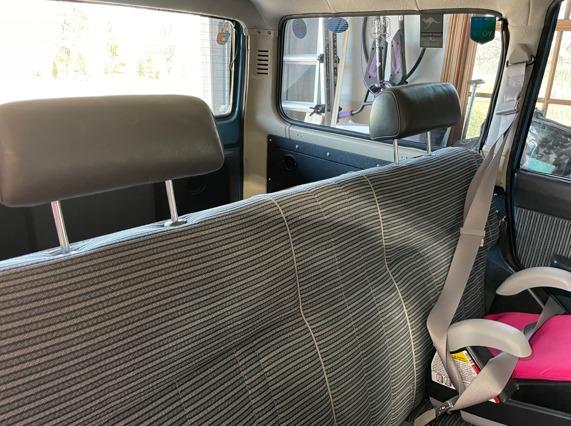

I have an 83 FJ 60, I got the nonretractable seatbelts from Seatbelt Planet and installed, nothing on mine retracts lap or shoulder so they kind just hang there when nobody in backseat. But was super easy install and made wife happier about having kids back there.

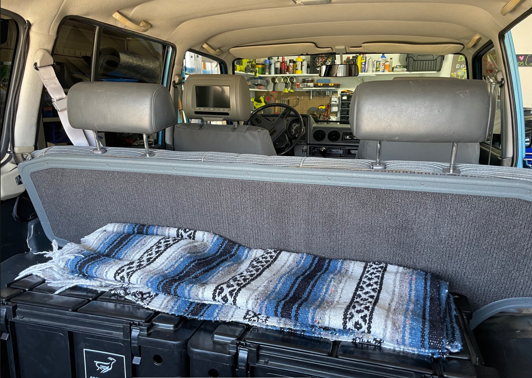

It took me a lot of time searching till I found a seat back from a 62 to swap in, I stripped the fabric off it cleaned it up and put my 60’s fabric on the new seat back, it bolted right in no fitting issues. My kids actually noticed the difference in seats because the old 60 seat back springs were very worn out and sunken in, the 62 seat back is molded foam and much stiffer and they said more comfortable. Moved the headrests from front to back seats and got some inexpensive movie player ones for front seats. Little entertainment for the kids while driving go a long ways some time.

Thanks for sharing. Do they bounce around?
I try to remember to buckle them when nobody back there, then tuck the lap portion into the seat. If I do that they are pretty stable and quiet.
