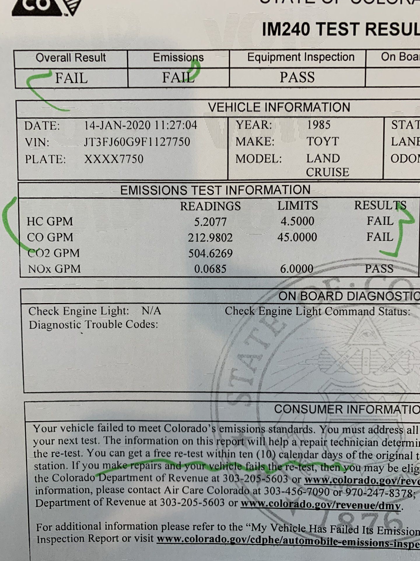

What are the O2 numbers?
here you go @Spike Strip. Can you tell by the O2 how much air the smog pump is moving?
