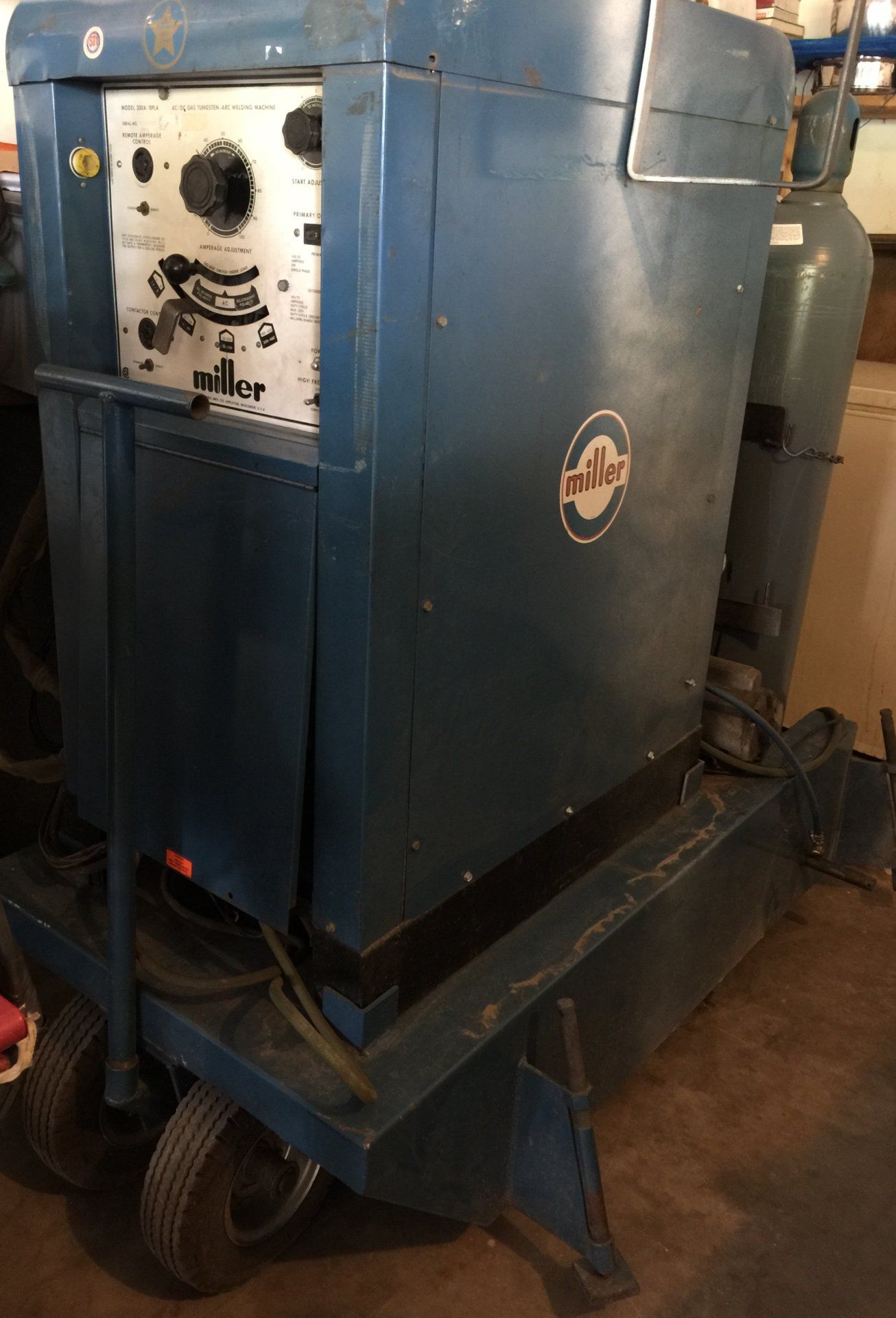

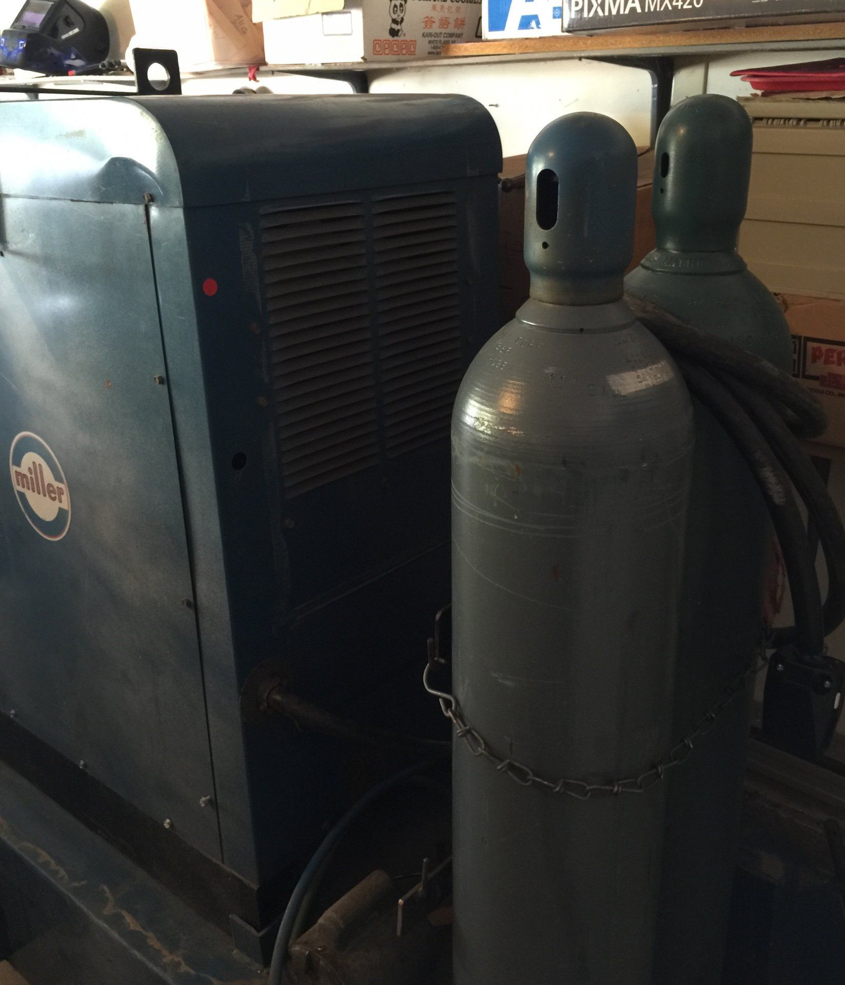

View attachment 2493466View attachment 2493467

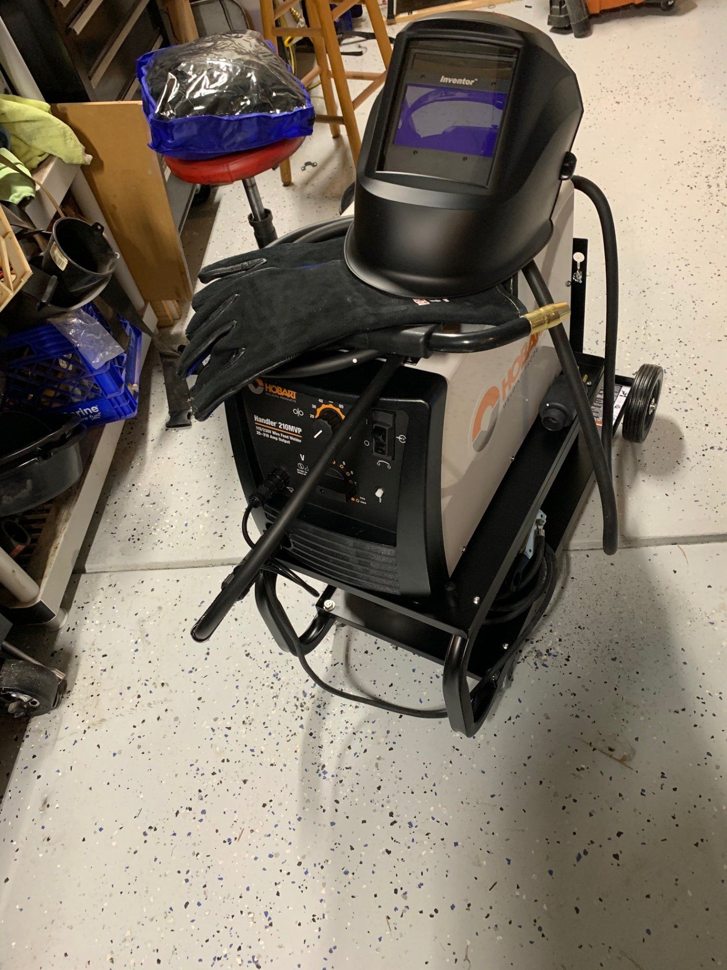

After some internal deliberation over a Cigar and glass of Crown, I came down to either the Miller 211 or Hobart 210. The Dual Voltage and additional power just seemed to me to be the sweet spot for this to be my first and last welder
I believe that the Miller 211 is likely the better machine, but that the Hobart would serve my needs and I wouldnt notice the difference other than weight. I dont think I would use the Auto set feature and the weight can be offset by a cart unless you are hauling it to other places

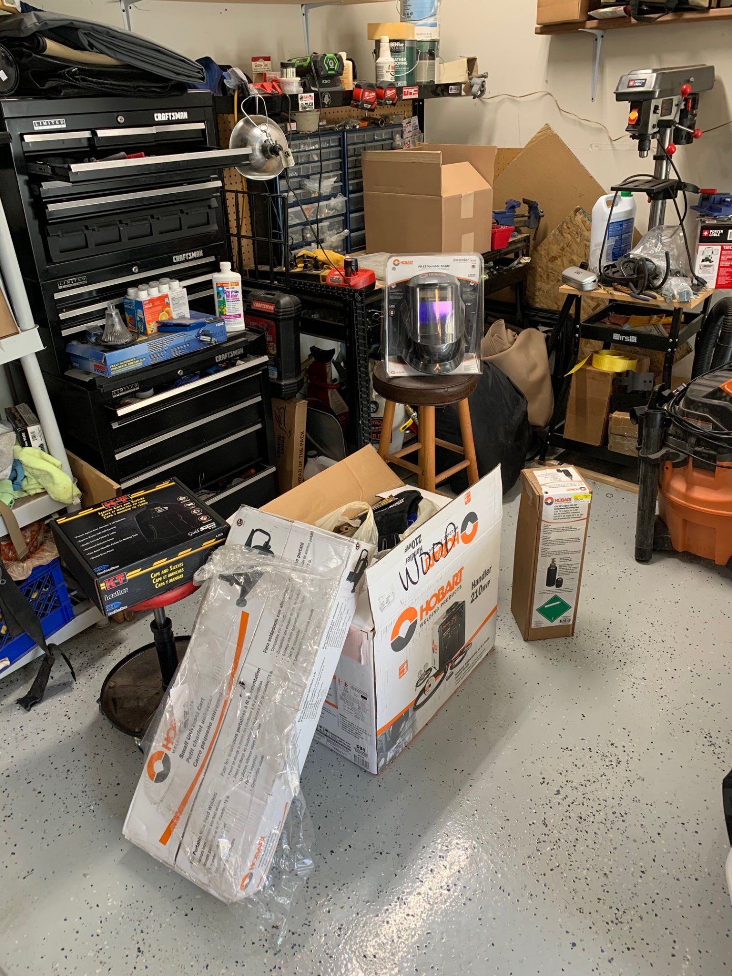

I went to Murdocks as they had pretty much the same price as anyone else for the Hobart 210 MV. There are a few that were $70 cheaper, but signing up for their new free sale membership program is what 10% off the entire purchase. So I got the whole shebang of what I needed including a small canister of Gas. Since I dont expect to be welding much for the near term, more after retirement, that should last me. Got the Hobart auto helmet, Hobart Cart, Pliers, Gloves, welding Jacket, extra wire, tips gel, brush and polishing attachment for my die grinder. It all came out to less than the Miller would have.

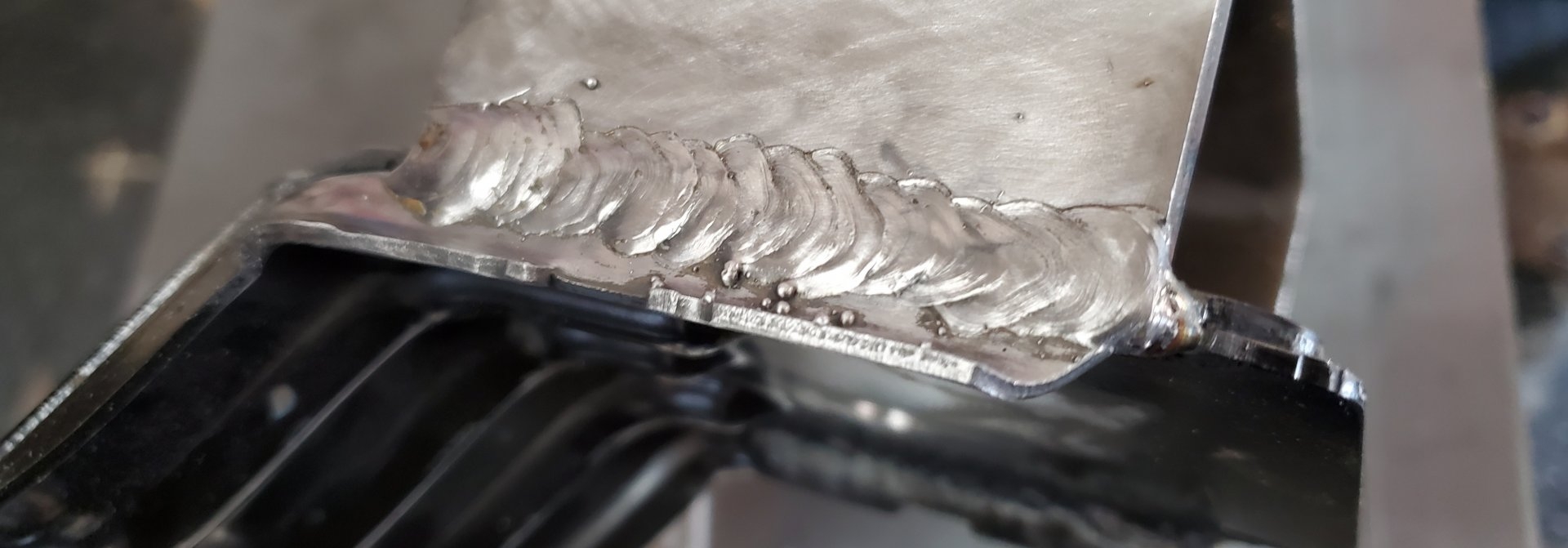

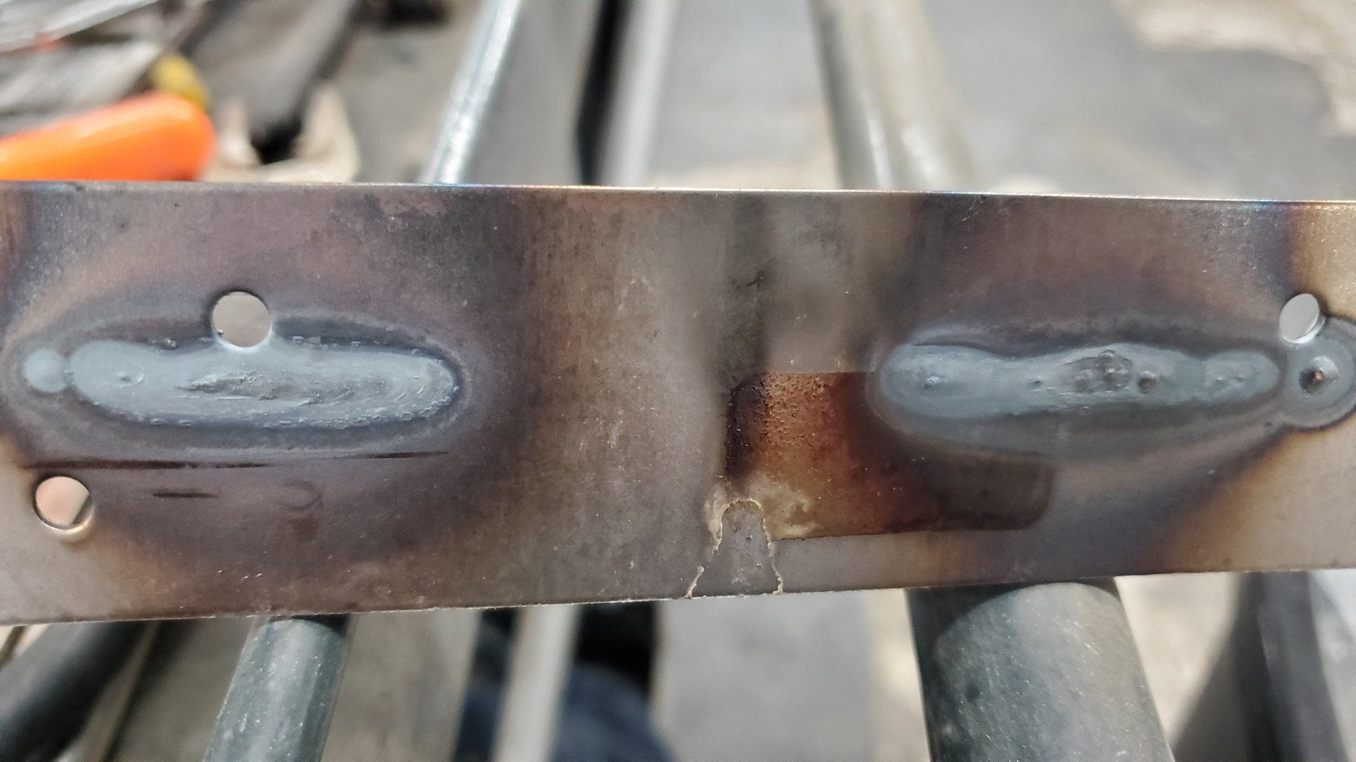

Couple of 1st time small projects:
Modified GM EVAP canister bracket:
2.5gal air tank slider mount for the 80:
Practice weld:
On the tray:

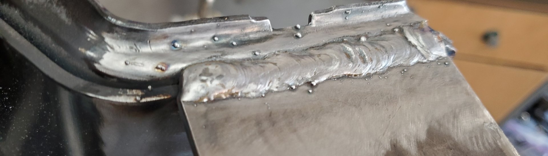

^^^ Maybe I need a wider weld to help fill the gap, or a second pass? Also run it a bit hotter? Staring at it, I think I would like more penetration...
My only knowledge comes from a few youtube videos.

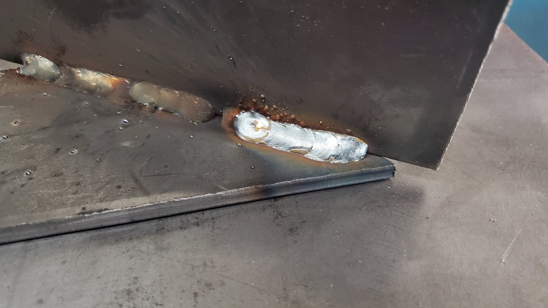

I turned up the heat best I could and sometimes tripping breakers. But, looks like better penetration and heat pattern for the 1/4" plate on 110v?

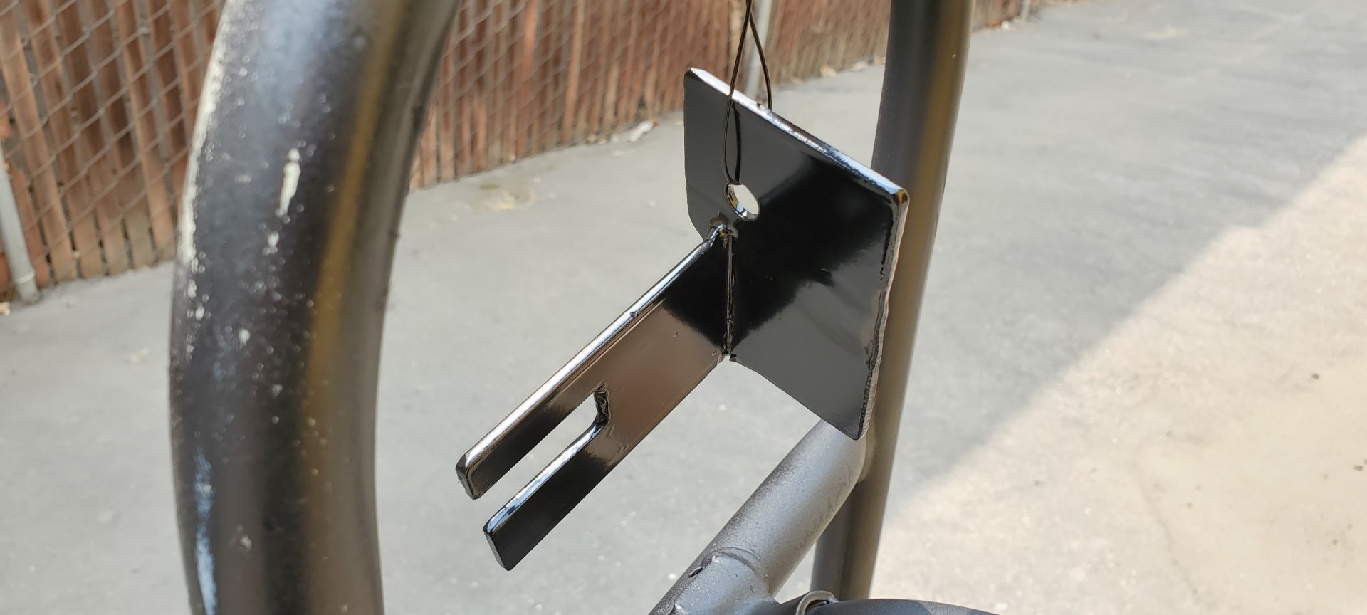

Making a support bracket for the EVAP mount.
lots of BBs up there. I thought at first that was fluxcore.
You may be pushing it with 1/4" on 110V with C25 MIG if single pass. Those welds don't look like they penetrated very well. You could try pure CO2 or flux core. (But I'm no pro welder TBH.)
Yup, looks like a power issue. Look at my 1/8" material in the last pic I just did today....
The last weld does look alot better than the earier ones - Dad has a pair of 211’s (one’s dedicated AL) - but .030 solid wire doesn’t generally spatter like that IME.
It does when you’re MIG’ing SS, but not mild steel.
Dad’s steel 211 only variable he runs 80/20 gas - but he also runs the machine 220v.
I’ll doublecheck what .030 wire he runs, LYK.
With some massage, we should get you to a hot 1/4” material weld w/o the excessive spatter.
I am thinking voltage. My machine even flashes at me telling me not to do 1/4" because of 110v lol. It is what I had to work with for this particular time though..
Bracket finished:
