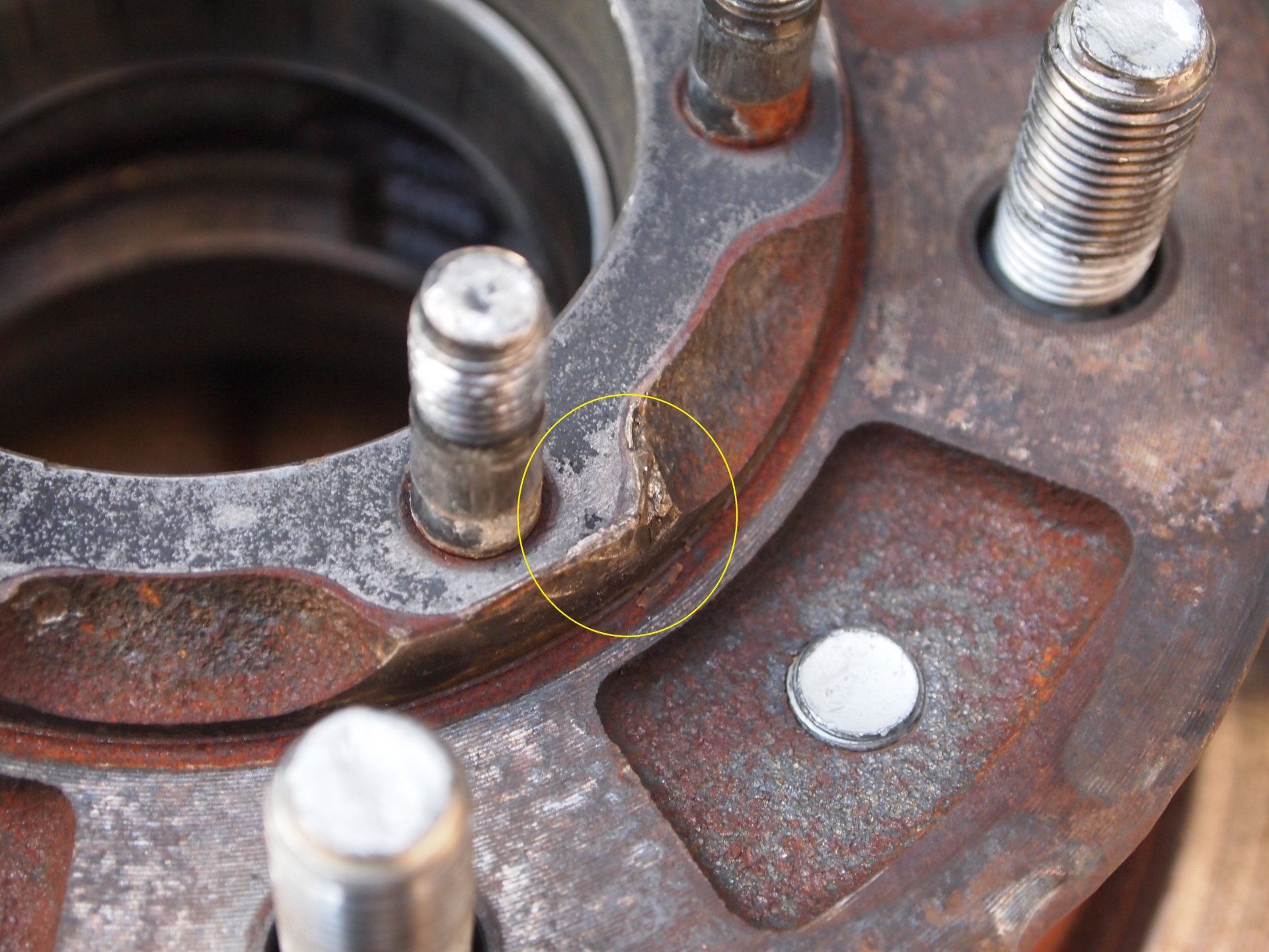

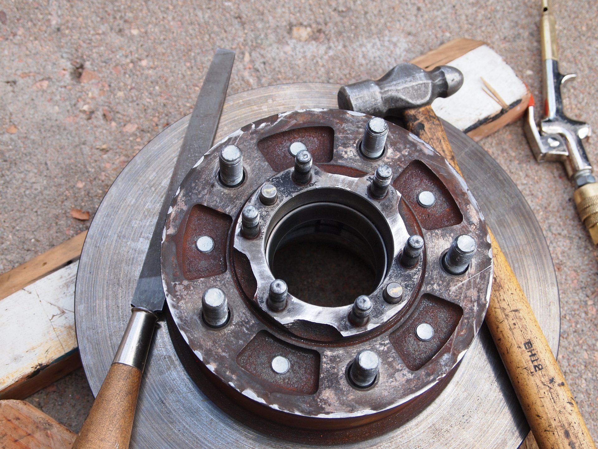

You do not want to pounding on hub flange or wheel hub, Doing so can warp them. Then hub flange may not seal well to wheel hub (water entry issues) and or not center axle well. Also if hit at cone wash seat, it warps the centering hole (seat) for cone washer.
I spent the time needed taking down high spot to correct/flatten these wheel hubs that have been pounded on (warped).
