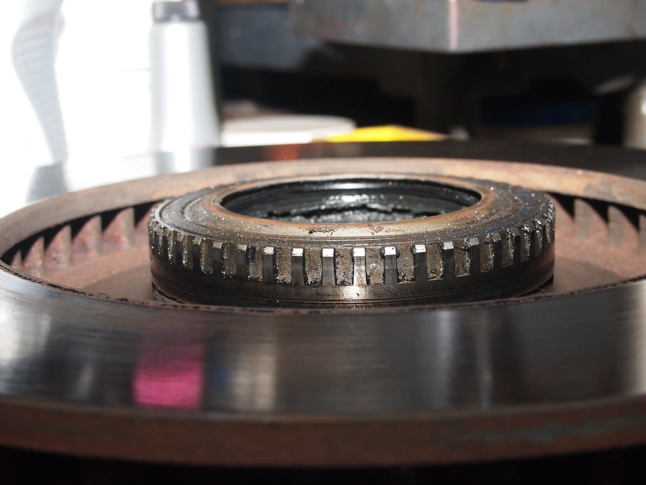

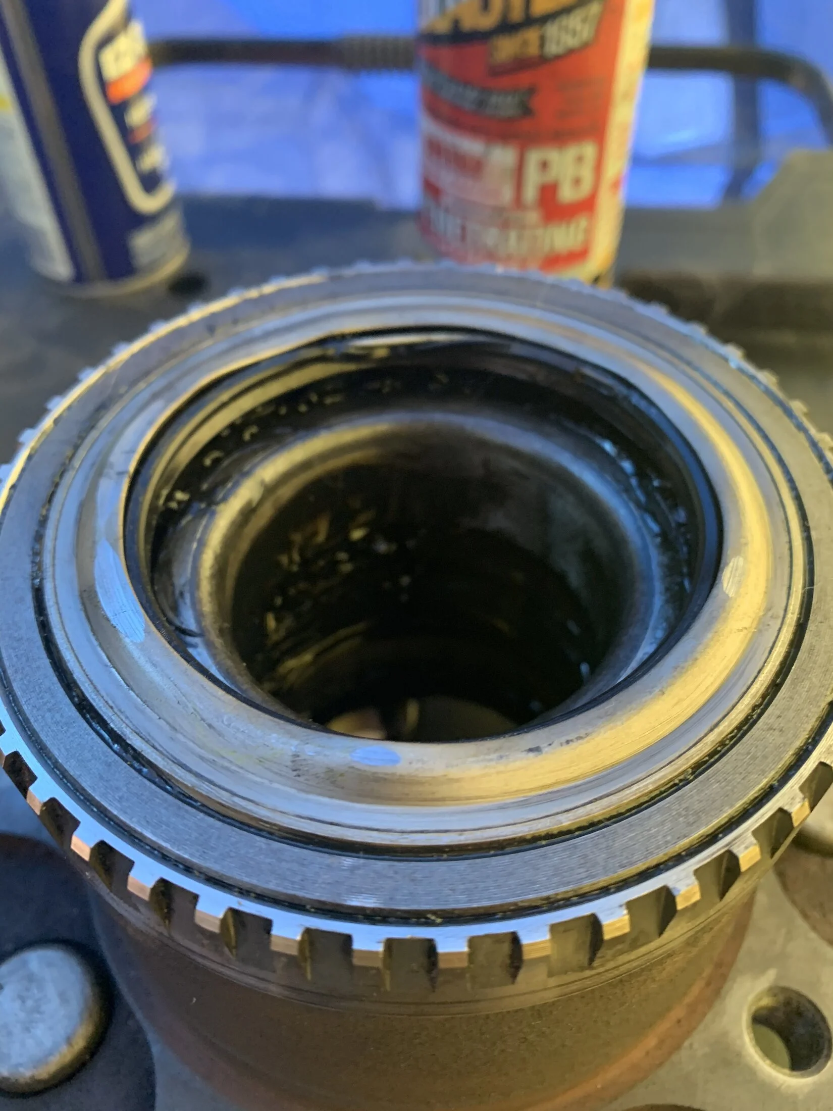

Hub seal in backwards

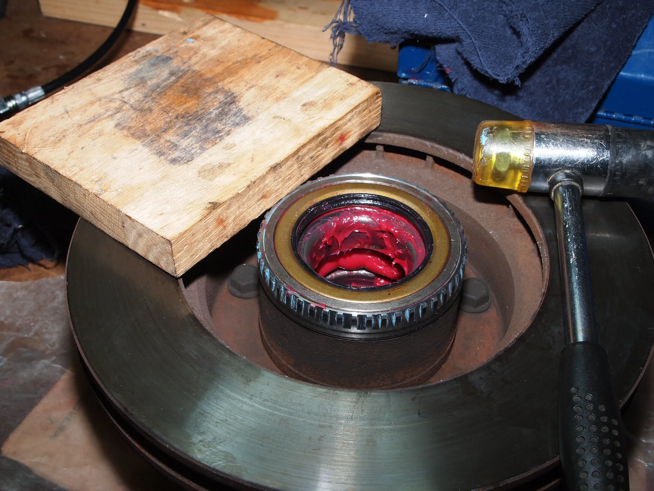

Correct is flat side out, set flush with hub. BTW: Never pound on any point of wheel hub, with steel. Plastic, wood, lead is best brass only on hub flange studs.
