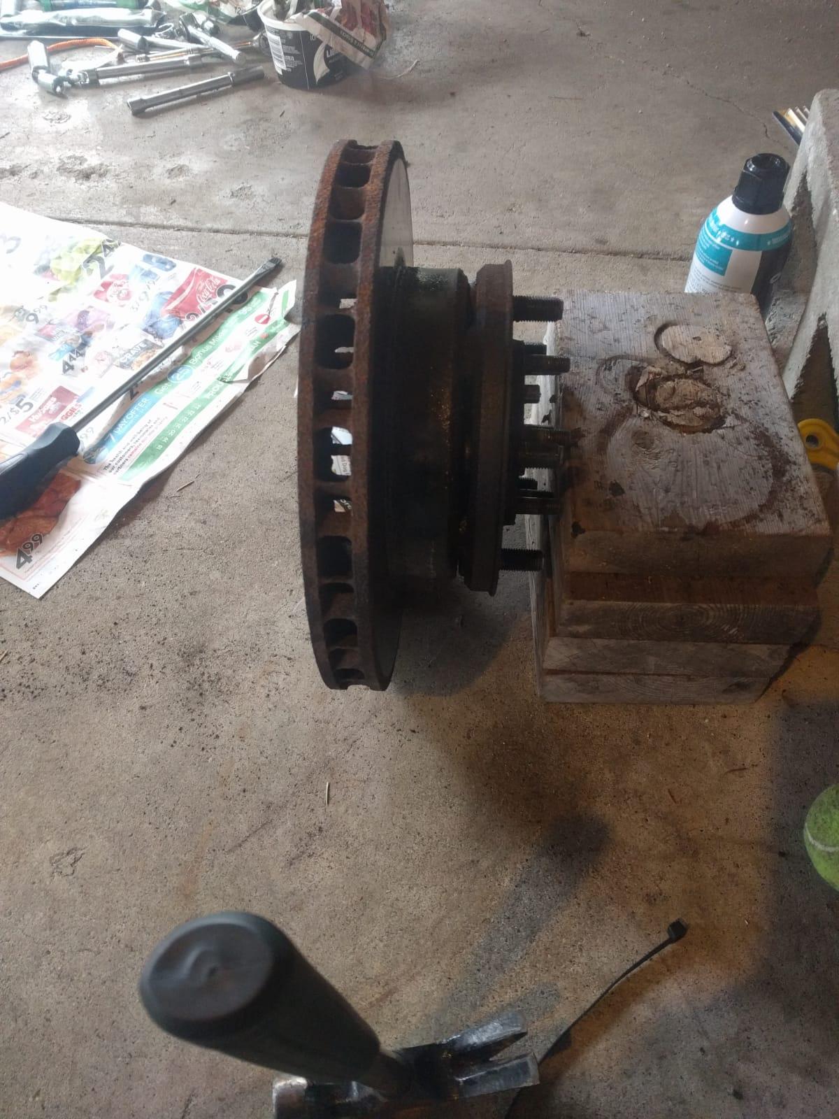

this is how far I get after 3 hrs LOL
Now I need a trick to separate the rotors from the hub? I don't want to hammer the wrong part and busted the hub?
any youtube trick recommendation? thank you
Victory 💪 on separating disc to the hub

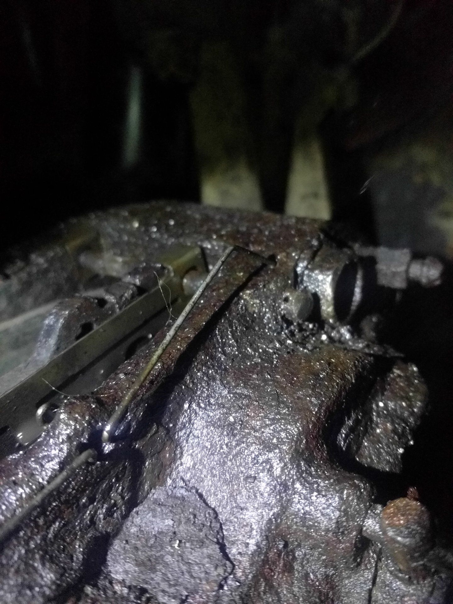

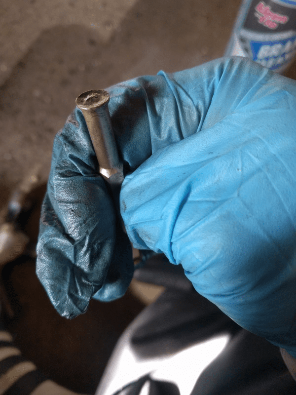

Only defeated by stuck brake pads pin 😢
Maybe time for new caliper? My truck is super rusty
You can drift those pins out with a punch....but yes, I'd be considering some re-manufactured calipers if all of them look like that one. I rebuilt mine....but I started with something not quite so degraded.
