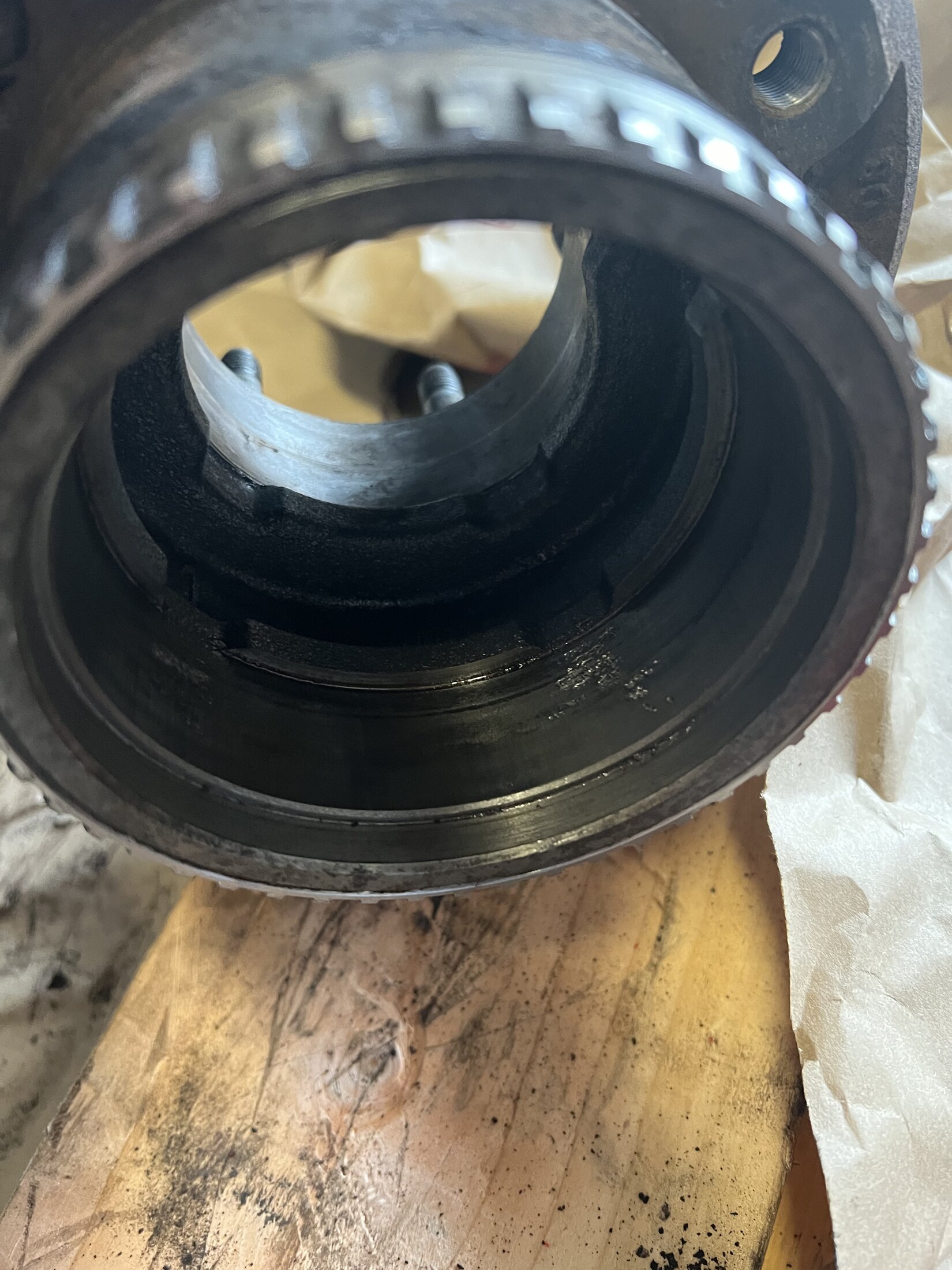

working on this job in my garage following a video, I ended up scratching the inside of my hub trying to take the bearing races out. Are these scratches going to cause me trouble?
I'm not a pro, but I'd sand them flat to not have any bumps and proceed.

working on this job in my garage following a video, I ended up scratching the inside of my hub trying to take the bearing races out. Are these scratches going to cause me trouble?View attachment 3717222
I deburr with a dremel, so new race doesn't get hung up as you press in.

Ok I’ve got another noob question on this job
I’m struggling with getting the new inner race back in the hub. I’ve tried using the older race
with a slit cut through it, as well as a driver kit. It just doesn’t get past the point where it’s flush. I got the outer race in pretty easily but this one is real pain. Any tips? Left in the freezer tonight and gonna try again in the morning . Every damn video I’ve seen they just give it a few taps on some wood on top and it goes right in
Toyota for stock, or DBA if a heavy taking on steep passes.
Oh shoot is that what you meant by getting hung up? I tried to smooth out the scratches but maybe I’m not doing a good enough job
If issue is one race as driving tool, not getting depth needed. Try using two races stacked, as driving tool.
