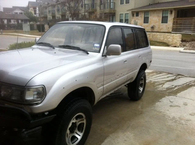

Here is one i parted out about 4 years ago.
This was a 1991 fj80.
Came from the factory with no fender flares, no running boards.
No power windows or lock. No power mirrors. The only power it had was the sunroof.
Any way this is what it looks like factory without those options.
