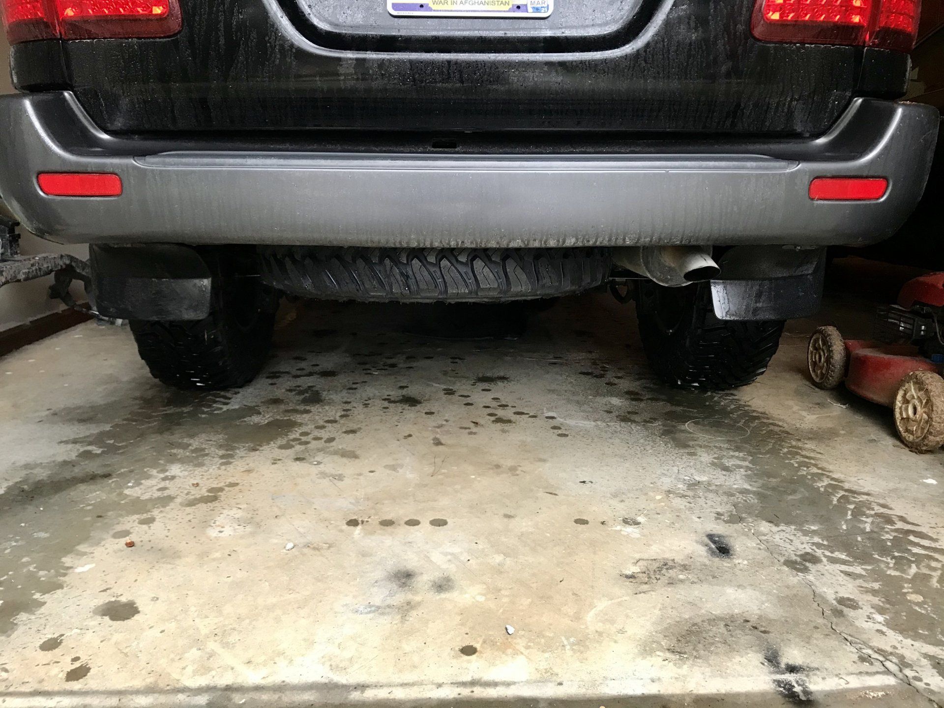

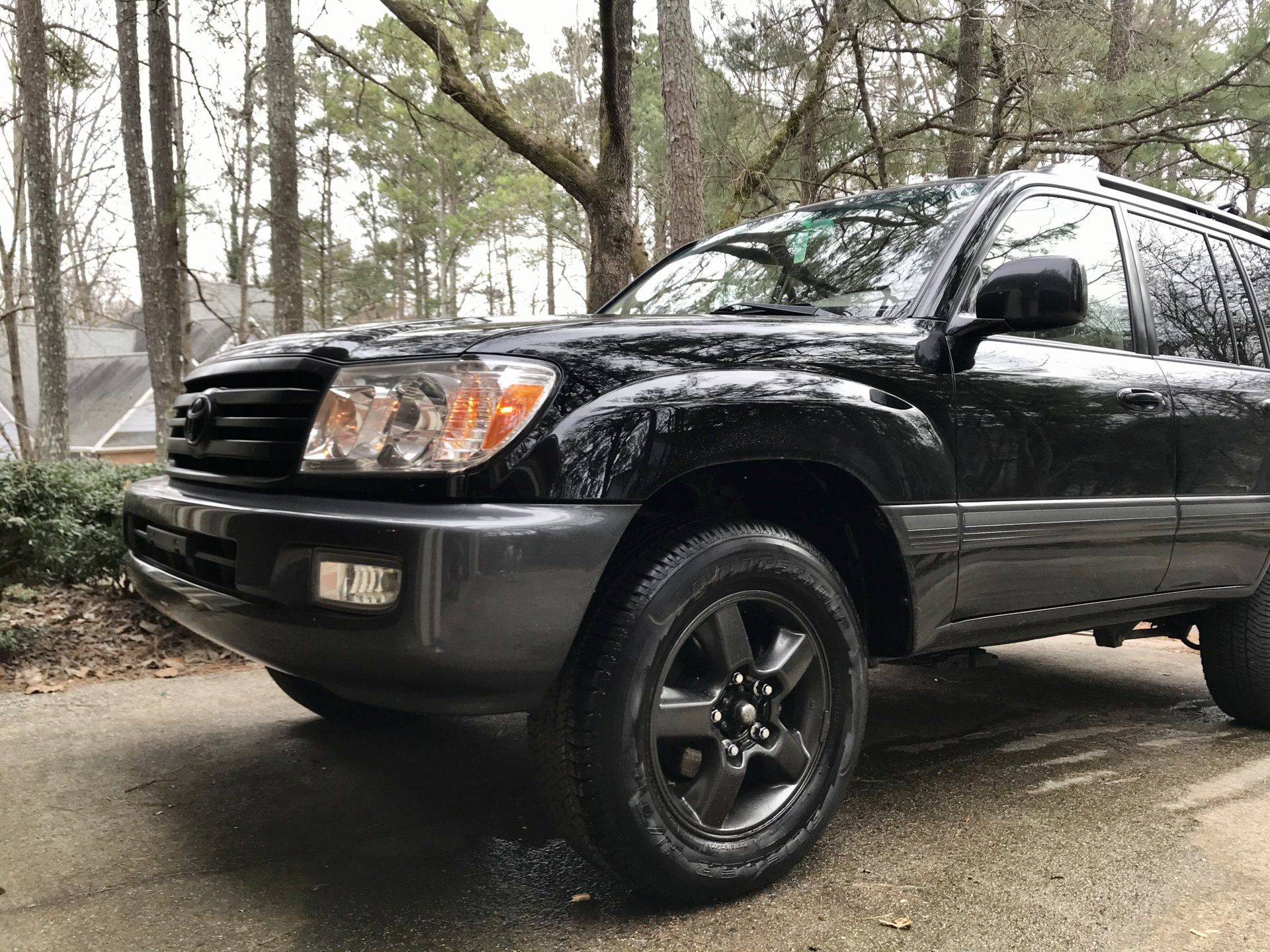

Pic from today, weather sucks so I apologize for the bad quality, but I got a set of Toyo Open Country MT put on today, 285/70R18
Of note in previous pic, I have been learning/ reading on here about the AHC system since my 80 obviously didn't have it. I can appreciate the purpose and convenience of it, but bottom line is it's 14 years old and will be removed. For now the truck is sitting in Neutral position, measuring 21" hub-fender and about an inch or so higher in high.
A couple of questions were answered for me regarding the tires as well. I don't need to elaborate on the sheer number of posts regarding lifts and no lifts and tires and such, basically I took the same approach as I did with the 80 - don't add one thing just to make another worse. Having said that I thought I'd be banging on pinch welds and carving my bumper but not so, it appears not by a long shot.

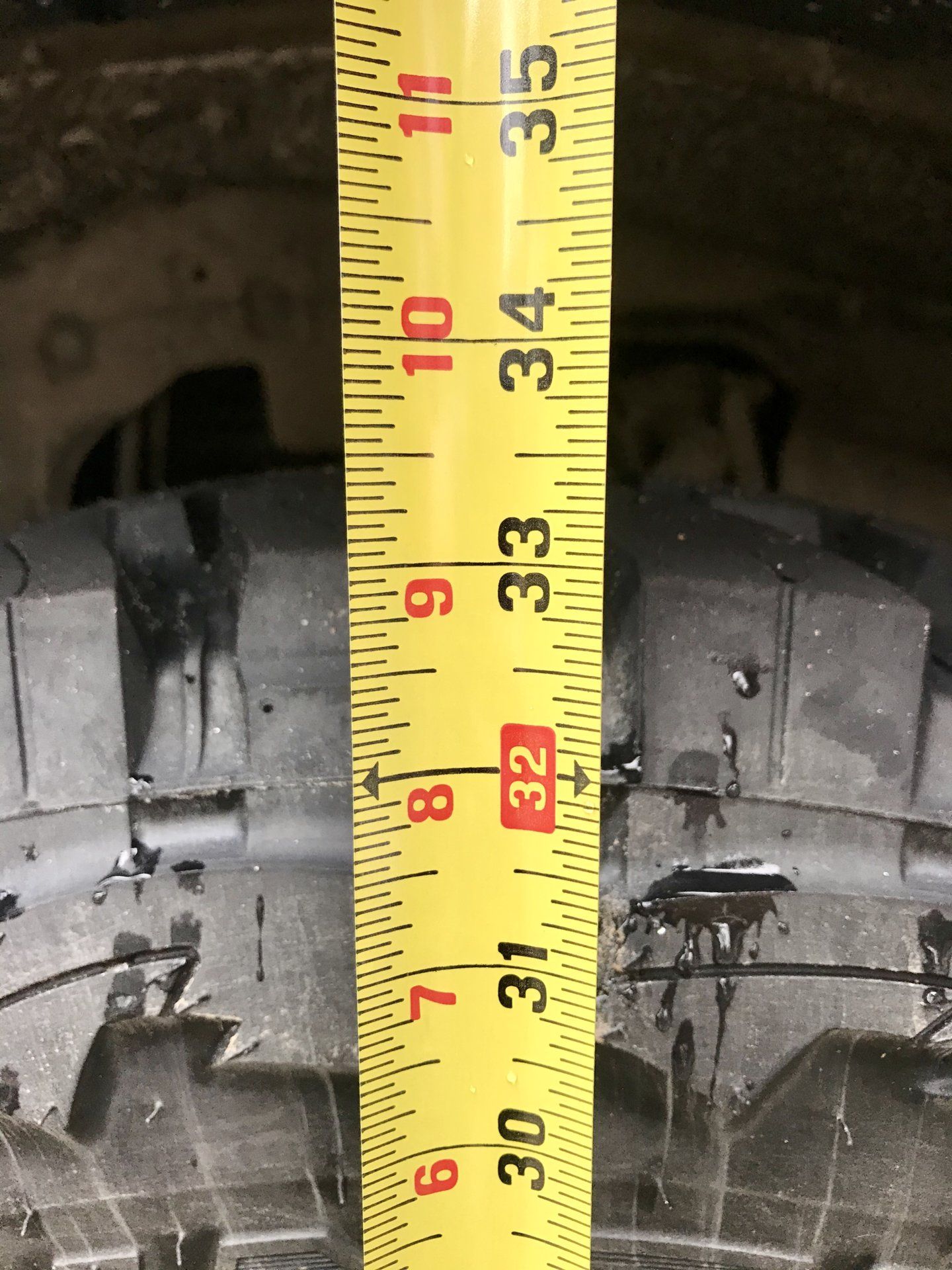

Toyo website measures the tires at 34.1", my measurement on the truck is a hair over 33.5" which i was nervous about since my last set of Toyo's were true-to-size.

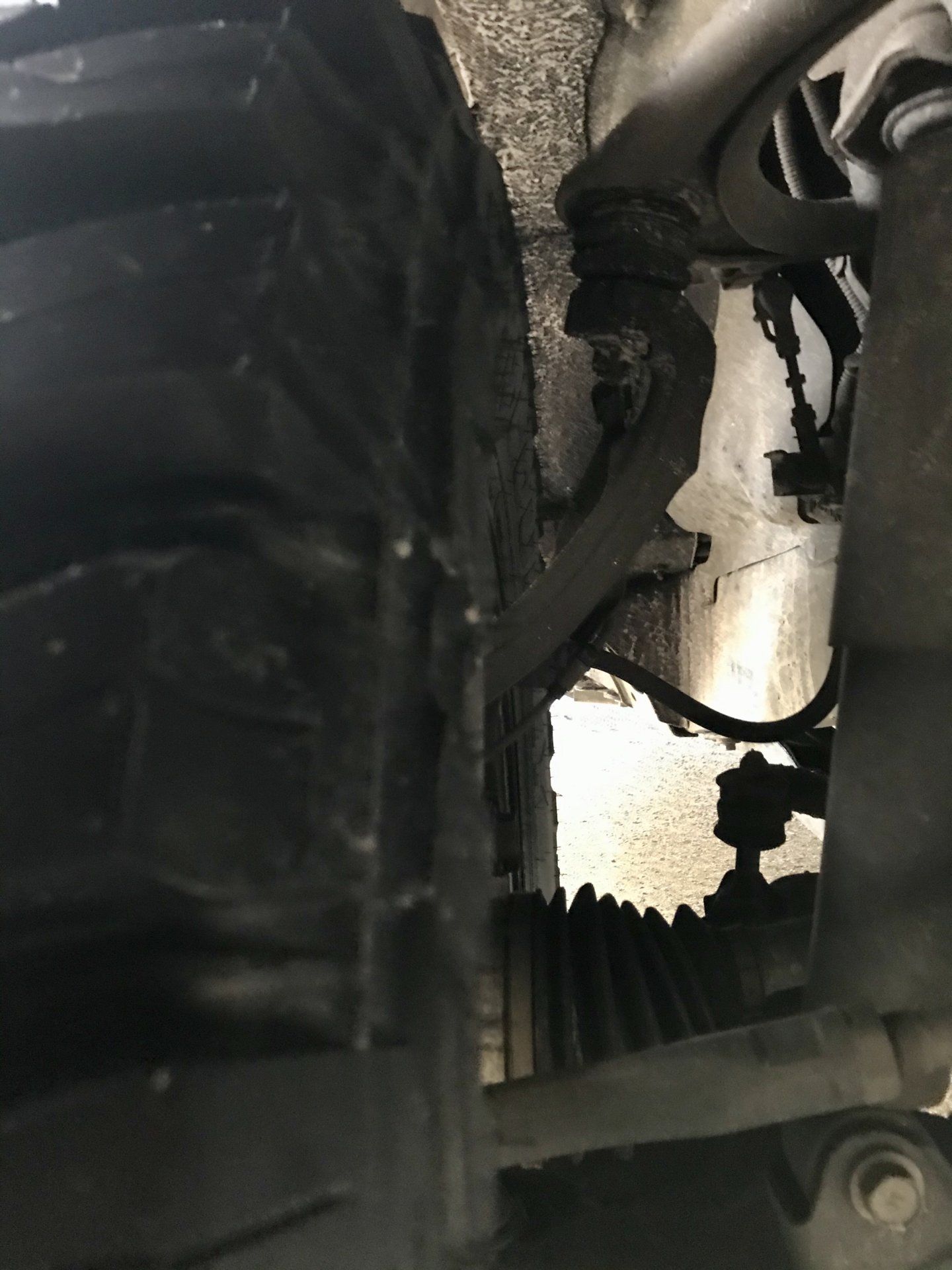

I have plenty of clearance for the UCA, and no rubbing anywhere when I exercised the suspension today.
I forgot to take pics of it today but another thing that had me going back and forth about tire size was whether or not the spare would fit under the truck, and I can reference several threads that made me think it wouldn't, but THE SPARE FITS. HA.
Having said that it WILL NOT fit with my hitch receiver, which I had to remove. It JUST clears the rear sway bar by about an inch.

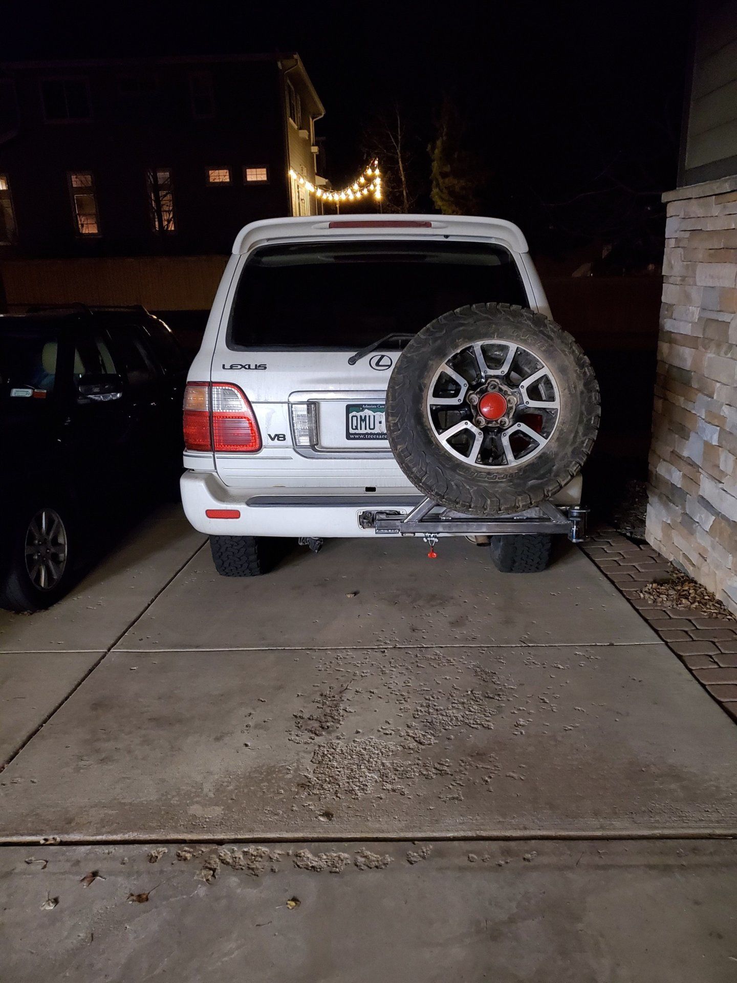

I've been looking at this, which I have seen posted on here, but from what I gather I'll have to take a cutting wheel to the rear cross member. The only issue I have with that is I don't want it to be janky, meaning the tolerances for my own sake would have to be pretty tight. Has anyone done this recently that could offer up some wisdom?
I honestly don't mind having the tire under the truck, have never run into a situation where it's truly unbearable having the tire there, and I think it's a much worse alternative than throwing it up on top which makes me chuckle every time I see someone driving around like that. I assume they haven't had to retrieve the tire very often.
In any case, I am not going to throw out $3K in my near future on a swing out bumper as slick as they are, but I see that Wilco sells what looks like a pretty decent alternative. Still $1200, but that's savings for elsewhere. Anybody running one of these that can comment on daily experience?

So in prepping for tire replacement, I had been considering replacing the wheels as I'm honestly not a huge fan of the OEM 18's:
- Tires in the relevant size are very expensive compared with 16's and even 17's
- I like having more sidewall between me and the rocks
- A lot of it is just pure aesthetics as well
After a researching the usual wheel options from aftermarket to OEM I just decided and agreed with the opinions that it's hard to be the quality of an OEM wheel.
All this said, my build is moving more towards a darker monochromatic look, not murdered out by any means, but I didn't like how bright the OEM wheels were.
To tone it down I just rattle-canned the wheels with 1 coat of primer immediately followed by 2 coats of Rustoleum midnight black which is basically black with a metallic fleck in it. Overall I'm satisfied. They'll be easy to touch up when need be. I didn't do a clear because I wanted to keep it more subdued.
Anyways, a lot to say about an inglorious job. This is obviously pre-tire swap.

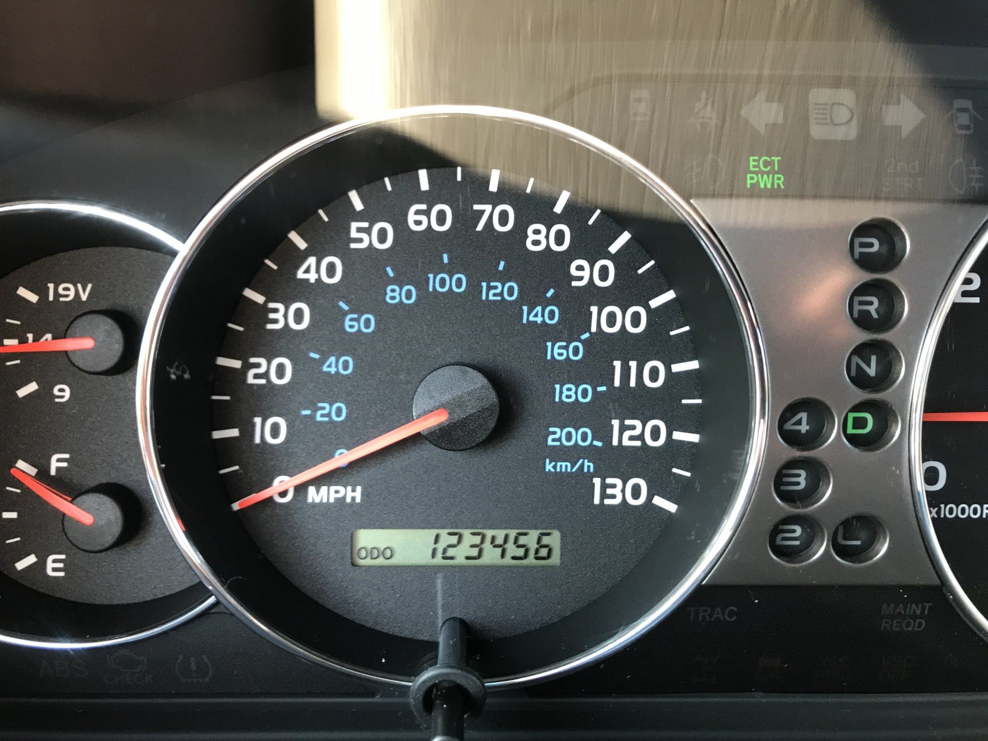

While I'm on a roll, also captured this milestone... she's still young.
Damn! I wish mine was that low still. Just about to turn over 195k, purchased at 191,664 and that was less that 3 months ago!

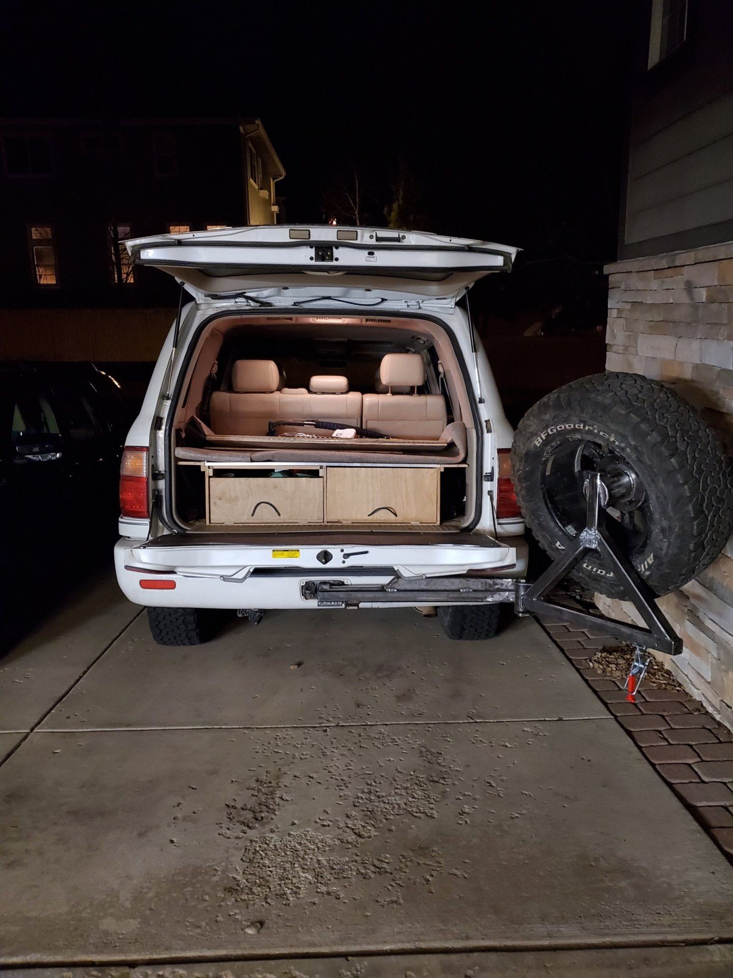

Given the cost of an aftermarket rear bumper, or even the Wilco carrier' you might consider doing what I did (or having a local fabricator do it for you). I purchased a double shear hinge and latch for about $150 and made my own swing out tire carrier. It’s really a pretty simple concept, and alllows you to carry the full sized spare without having it hang below the truck or block your handy tailgate. Obviously, the cost of metal stock must be considered, and finishing materials (I rattle canned mine) but it leaves you with a more flexible option than a $2400 bumper.
