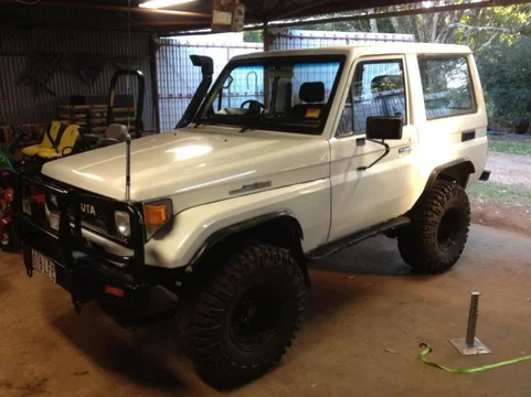

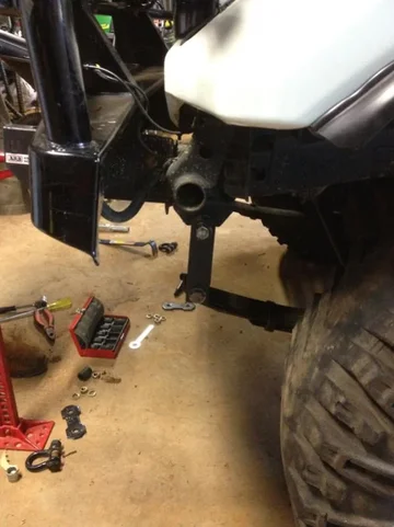

I managed to achieve the look I was going for and fit 35's under with just some big shackles. Unfortunately it now tracks crazily and unpredictably as I have been told the offset on the 15x10s is wrong? This makes sense cos u guys say fitting 35's under is a mission (with the right offset wheels). My question now is can I use spacers with rims with the right offset to achieve the same look? I'll post a pic of the shackles and the tyres on the truck so u know what I'm looking for.

I'm also new to 4x4 and have recently developed a new found love for cruisers! I've always been a Toyota guy but after moving to the mountains ive outgrown my lowlux with her 20" billets. I have also recently purchased a BJ70 as my new daily. I understand the look you're going for cos im after the same! I looked into SOA also but unless you're a metal fabricator it's seriously not worth it! From what I've seen u can get plenty of height and flex out of the leafs!

I had a HJ47 that had home-made shackles installed and tracked like a dog. So much so I got duped into test-driving the car in a paddock 'cause it wasn't insured and he didn't want to run the risk of me writing his truck off'. Wasn't til he kindly delivered it that I discovered the issue. It had to go to suspension specialist to have caster wedges installed and even then it didn't fully correct it.
So in your case I'd say it's less about the tyres and more about the suspension mods that are making it track badly. Get them sorted and you should be abel to run a 35" safely. Unless the boys think differently??

Thanks for the reply cult45! Only problem with ur suggestion is now that I have put the original wheels back on it drives fine!? The shackles I put on have been on the car before, they only took them off to get a roadworthy certificate for the sale. It actually drives better now, there was vibration in the tailshaft at certain speed/revs/load but that's now gone with the shackles installed?
There could be something wrong with the wheels/tyres tho, I did get them off eBay pretty cheap?
you can get the tires dismounted off the rims and run the rims up on the balance machine. this will allow you to see if the rims are true or if they are the culprit.
if they are true then remount the tires and get them balanced again.
that would eliminate that possibility.
