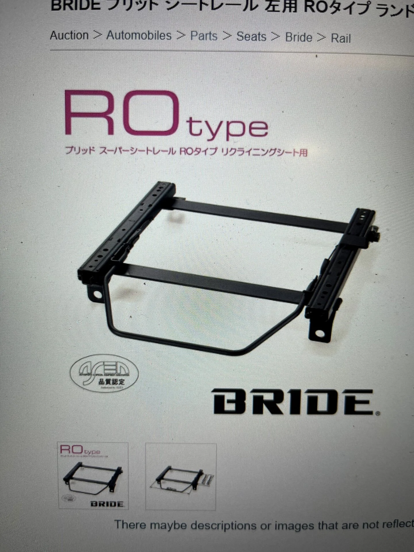

I am using suspension bases with scheel-mann seats using bride brackets/rails. Bride makes brackets that fit right onto the suspension bases but you have to buy them out of Japan using a proxy service. They are not sold in the US. Getting the scheel-mann to fit onto the bride bracket requires very little modification.

Makes sense completely. I would have bought my brackets from planted had they had these available for suspension bases back then but I am happy with the Bride bracket set up and it hasn't given me any problems.

In Japan, there are the same type of brackets sold for the Recaro and Bride seats and they state that all heavy duty 7X cruisers use the same dimensions. I used the ones made by Bride and they work great with some slight modification for scheel-mann seats. This was before someone managed to get planted to make some. Unsure about Prado or light duty set up though.
