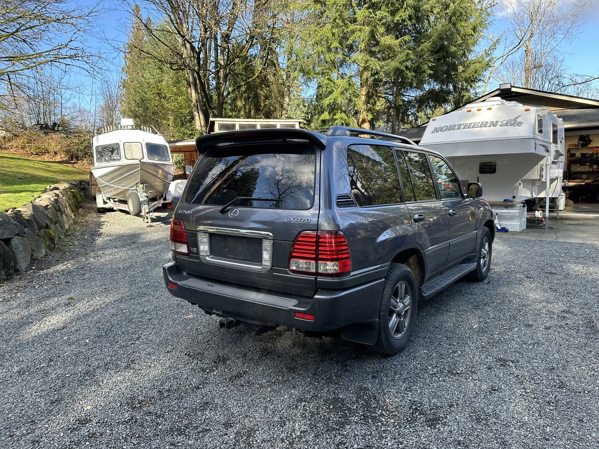

2007 LX470. Dealer maintained religiously since 07 when it was purchased by a family member. 177k miles.
Just replaced all fluids, flushed AHC (before deciding I was going suspension route). Getting near timing belt so will be tackling that soon.
