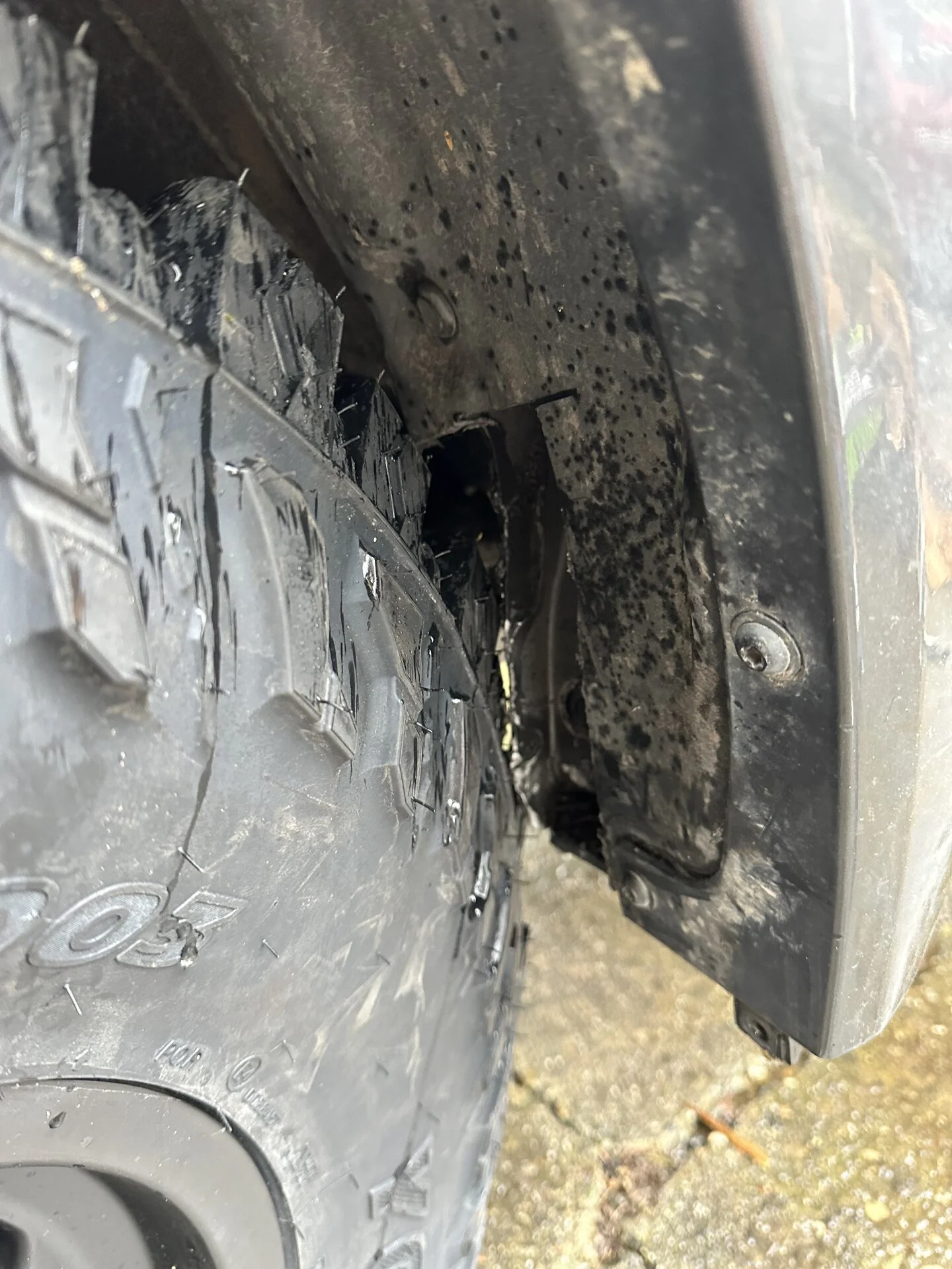

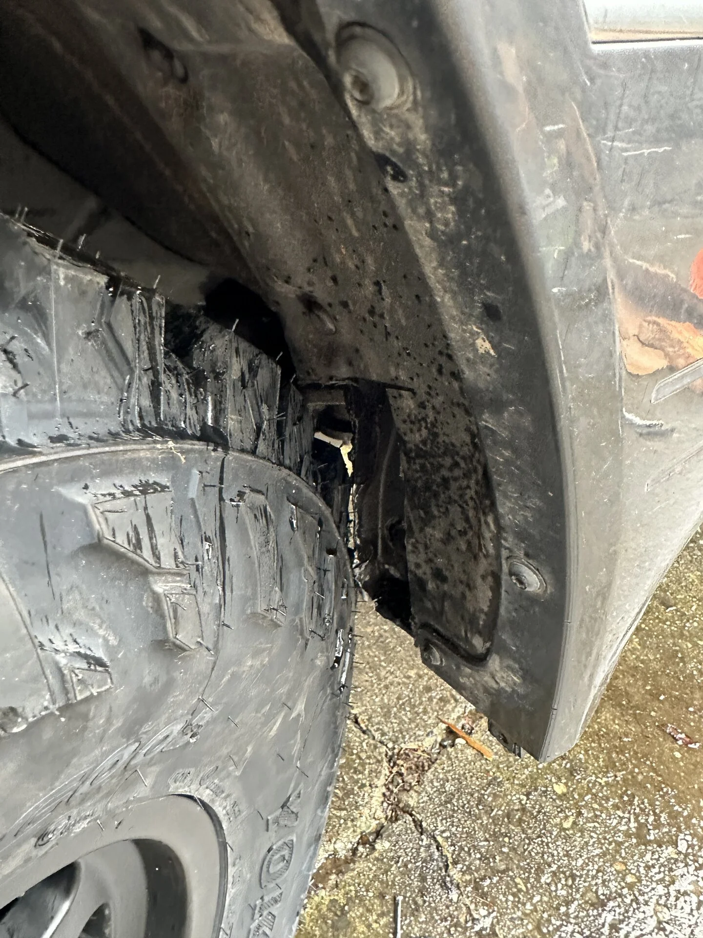

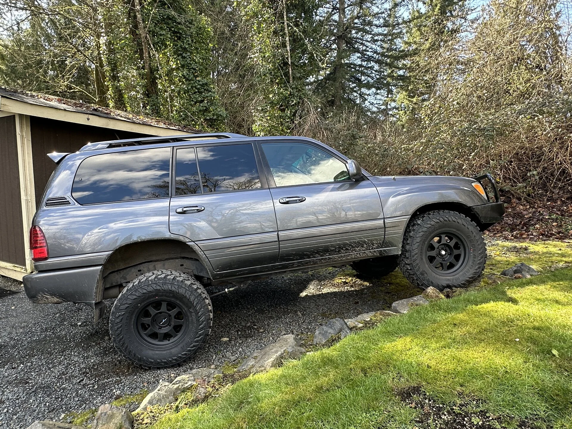

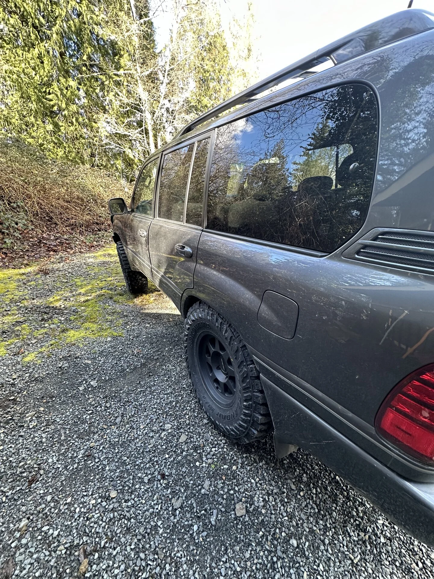

-Trimmed out the front fender liners and pounded the pinch welds back a bit. Once I get alignment squared away I’ll be able to fine tune things a bit, but got it close enough that I didn’t rub on the maiden drive around the block. (Pictures before more hammer work and about 1” of torsion lift adjustment)
-Cranked up the front torsion bars a bit and currently sitting 21.25” center hub to fender up front and about 23.5 in back. Ideally would have 1” rake, but need to play around a bit more and make sure I’ve got enough droop up front if I go higher.

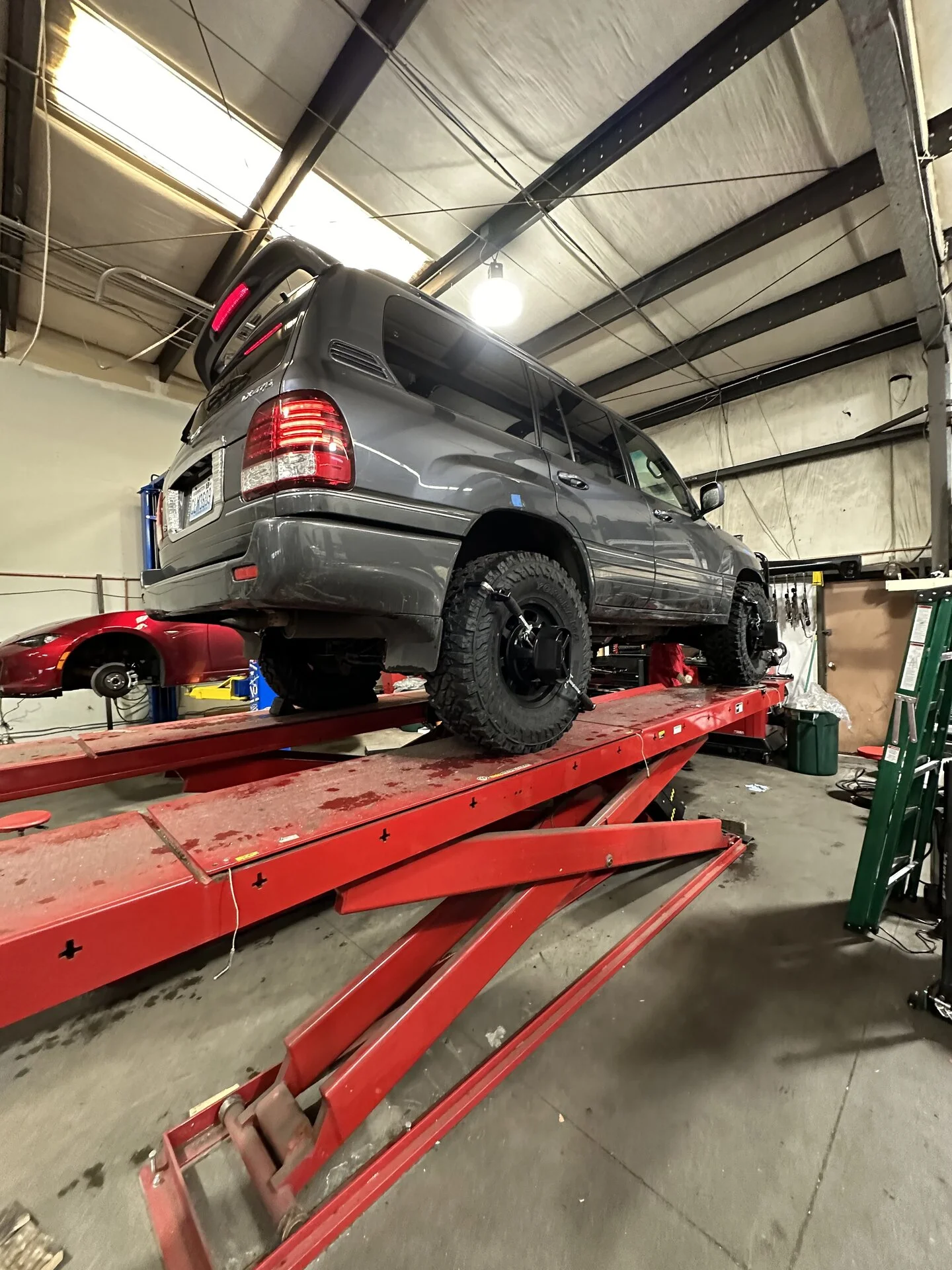

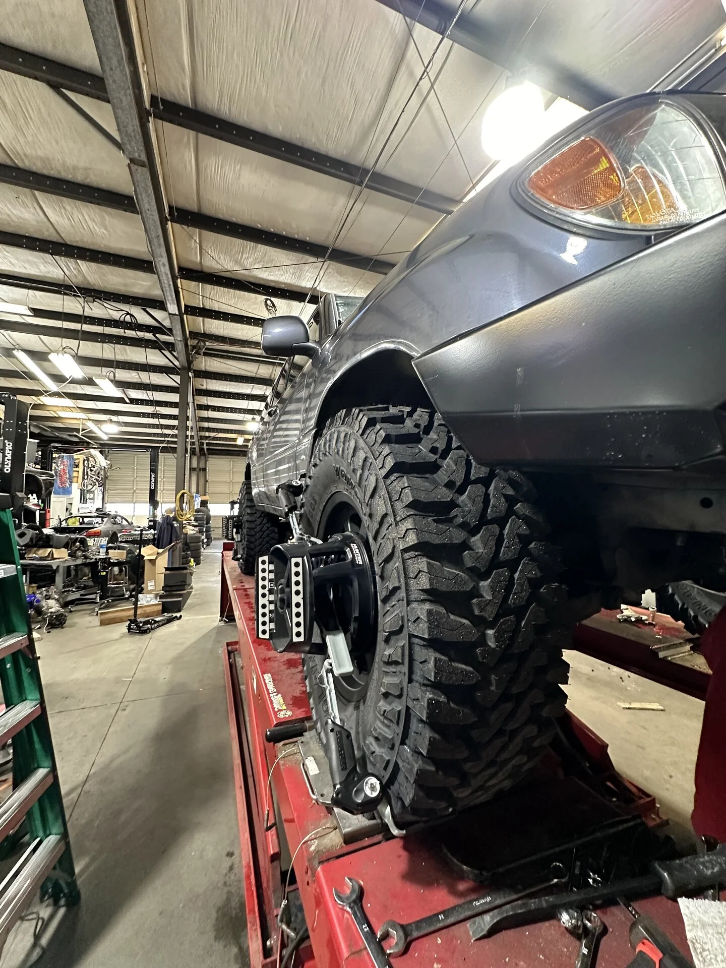

Anyone do their complete alignment at home? Been watching lots of YouTube and it seems feasible, but guessing easier to just pay a shop.

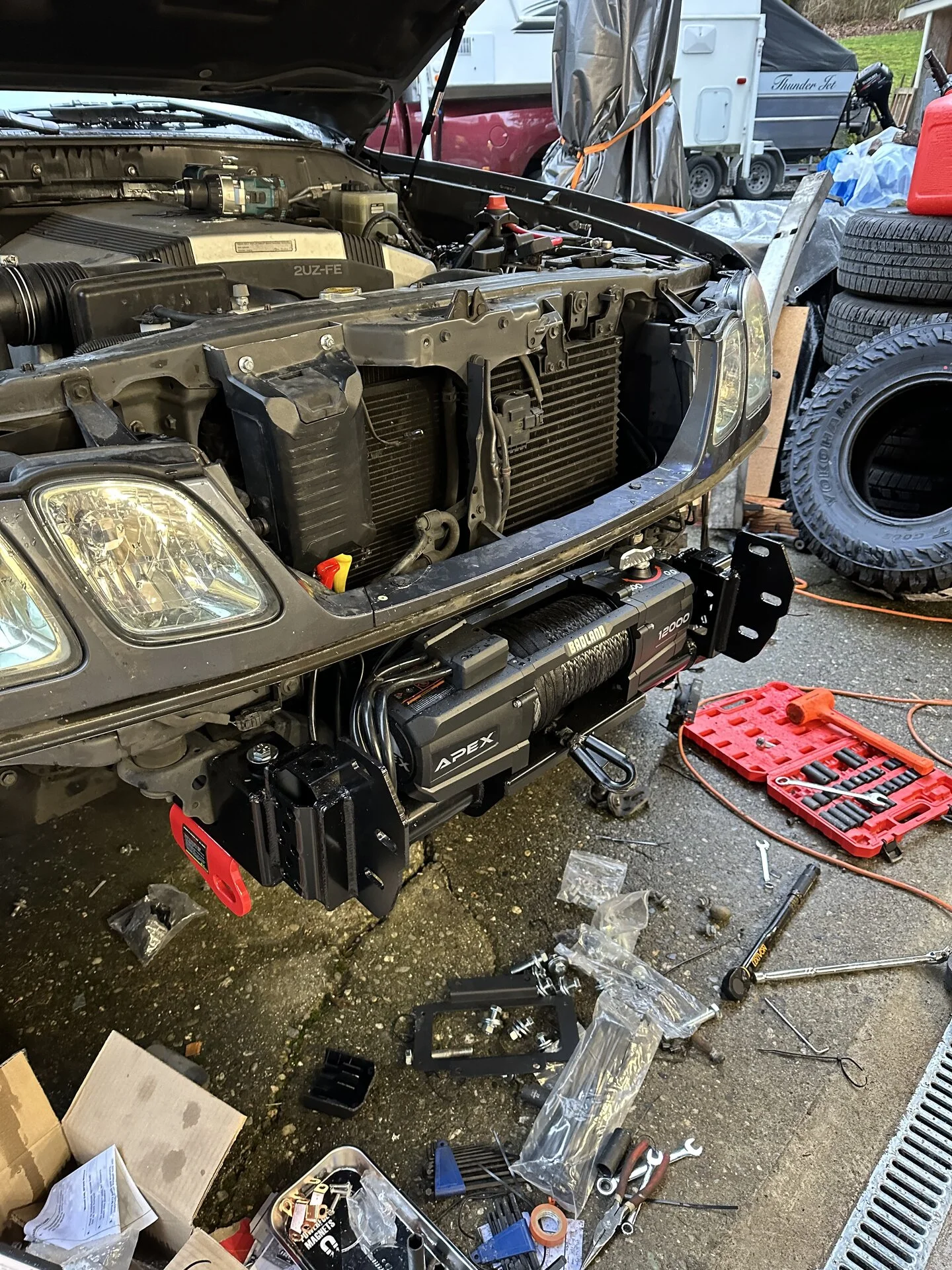

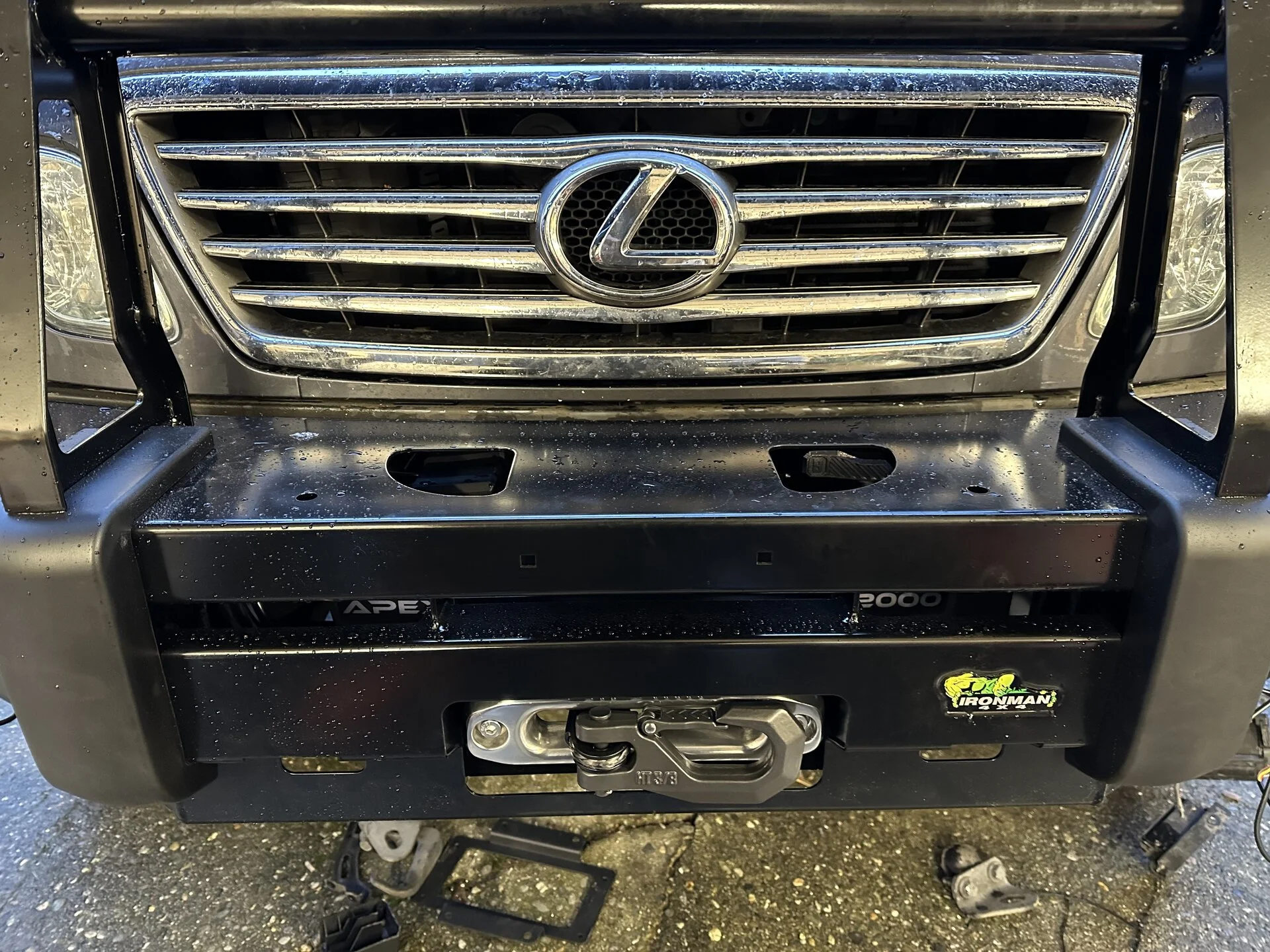

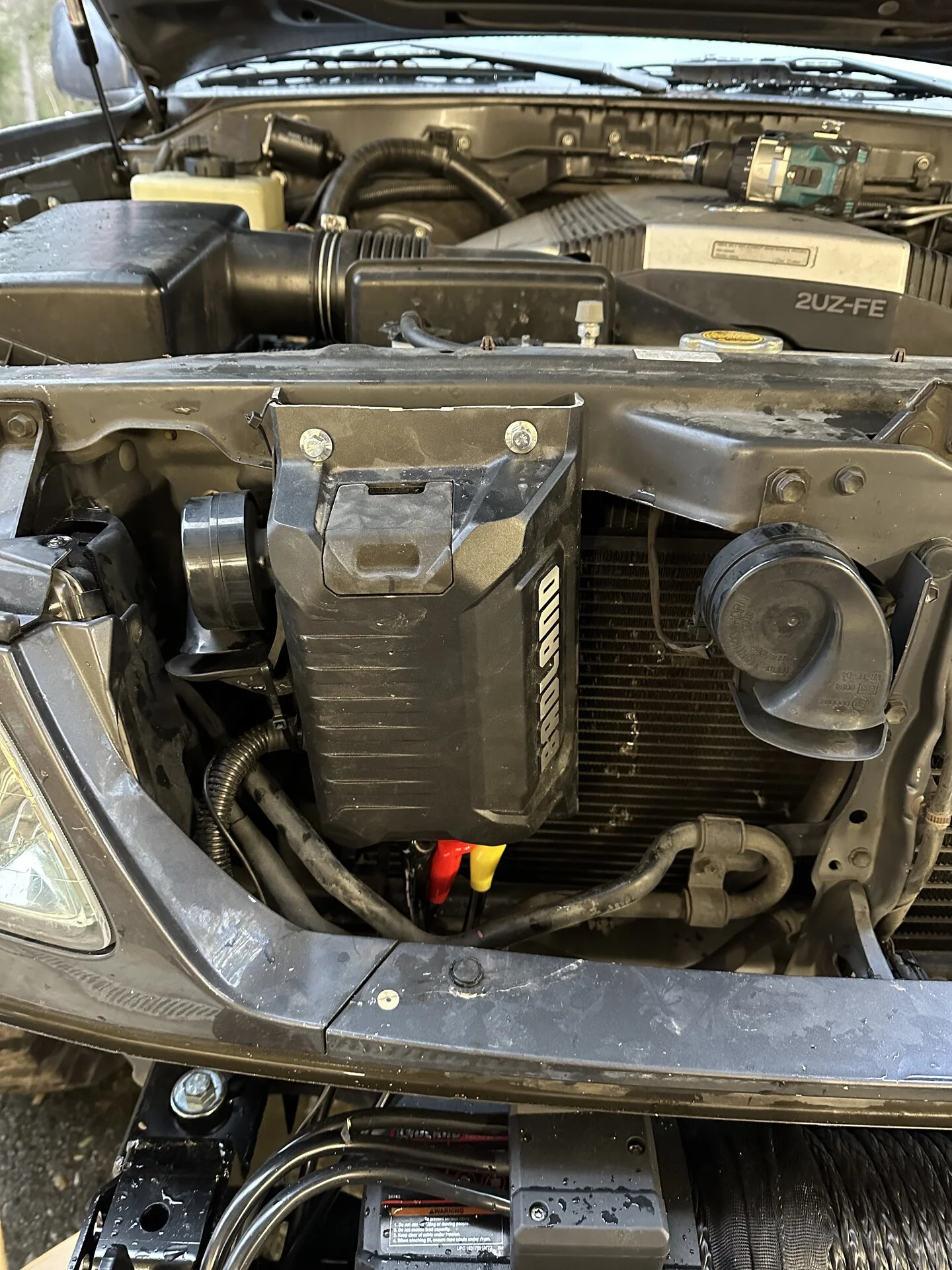

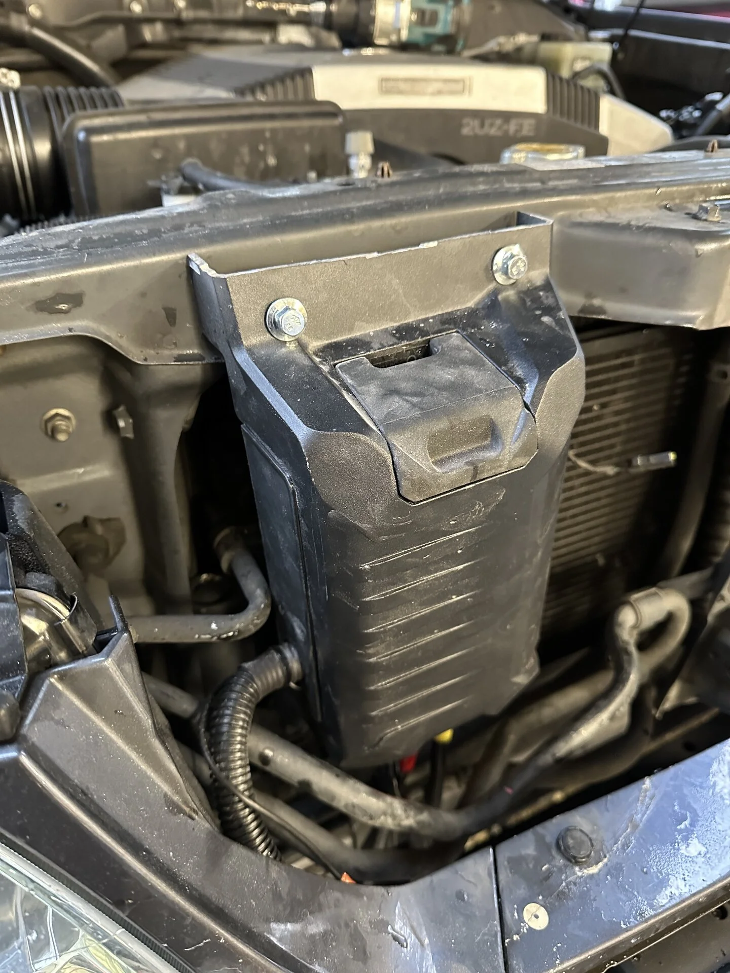

-Got the Apex 12k winch on sale today and got her installed. Had to cut control box and was able to mount under grill. Afterwards found out it rubs on the grill mount so will need to fab a new bracket for that. Does anyone run additional inline fuse on the winch?
-Installed Ironman recovery points. Frustrating that the driver side calls for 80mm bolts but they didn’t come with enough? Quick trip to hardware store solved that and they seem solid. Torqued to 90 ft/lb

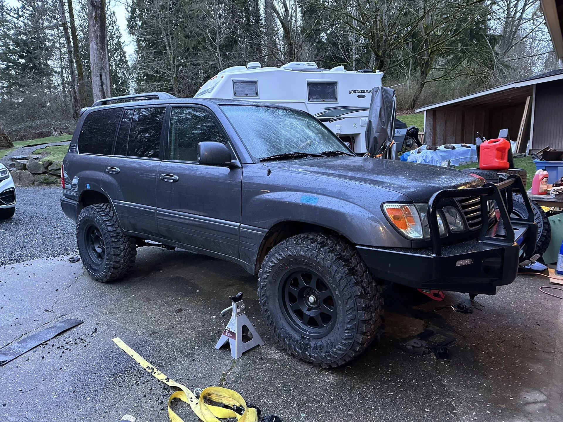

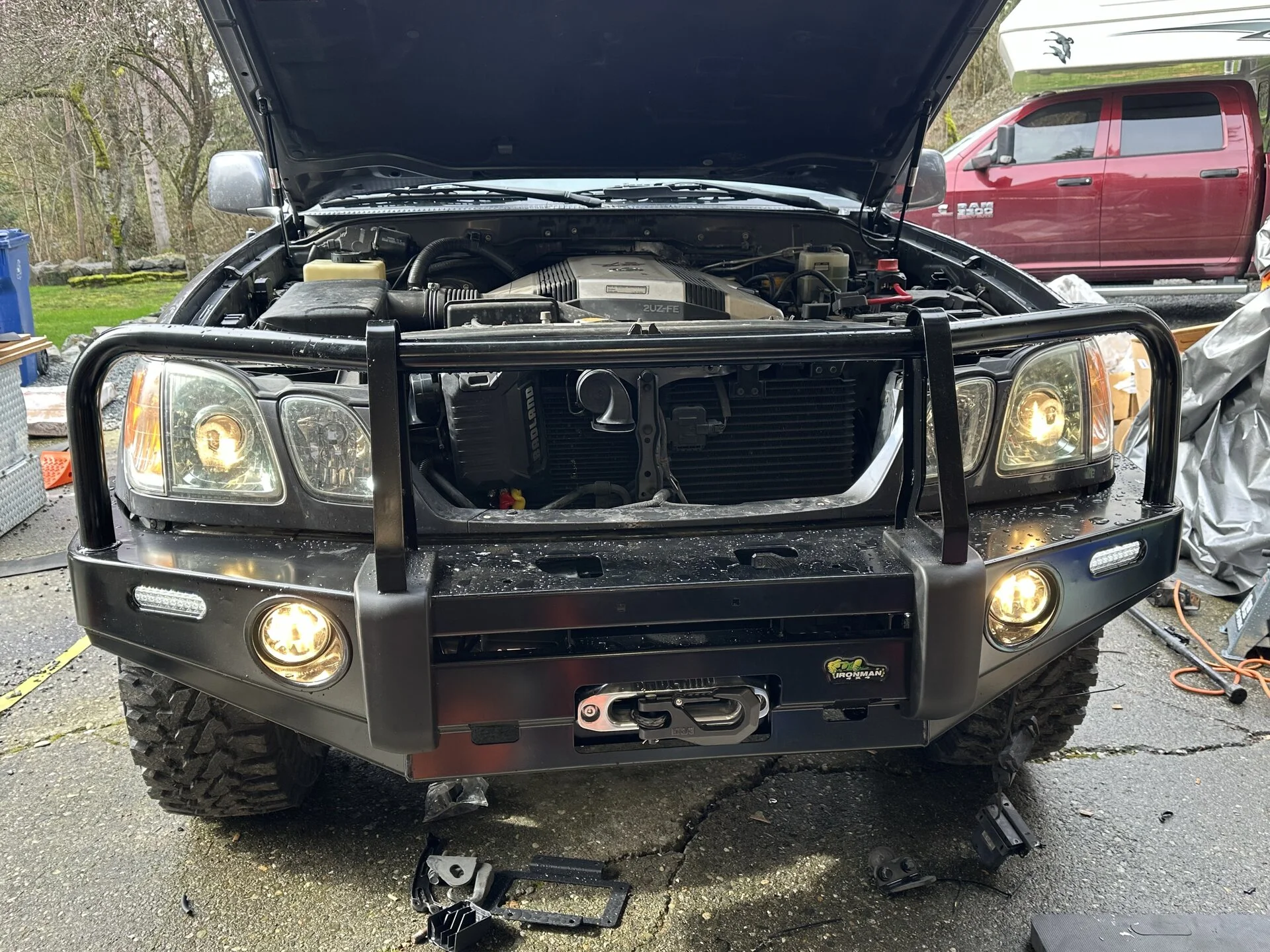

-Mounted front bumper. Needs some final adjustments and wiring of lights in AM.
Just got lights/blinkers wired up. Took off wiring harness from old bumper and used that. Super easy.

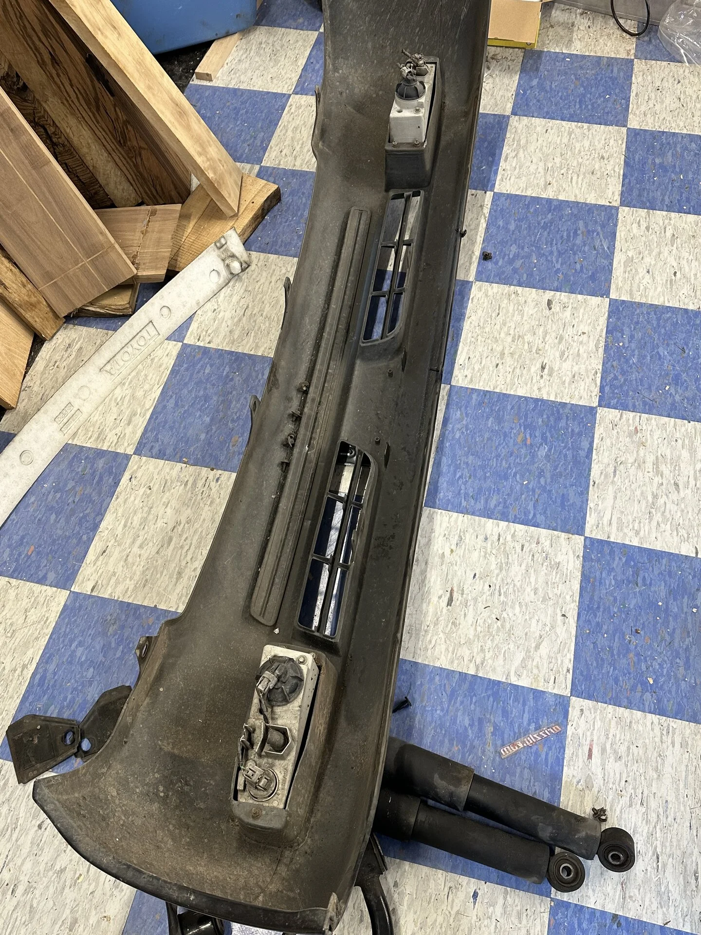

Any plans for your old OEM bumper?

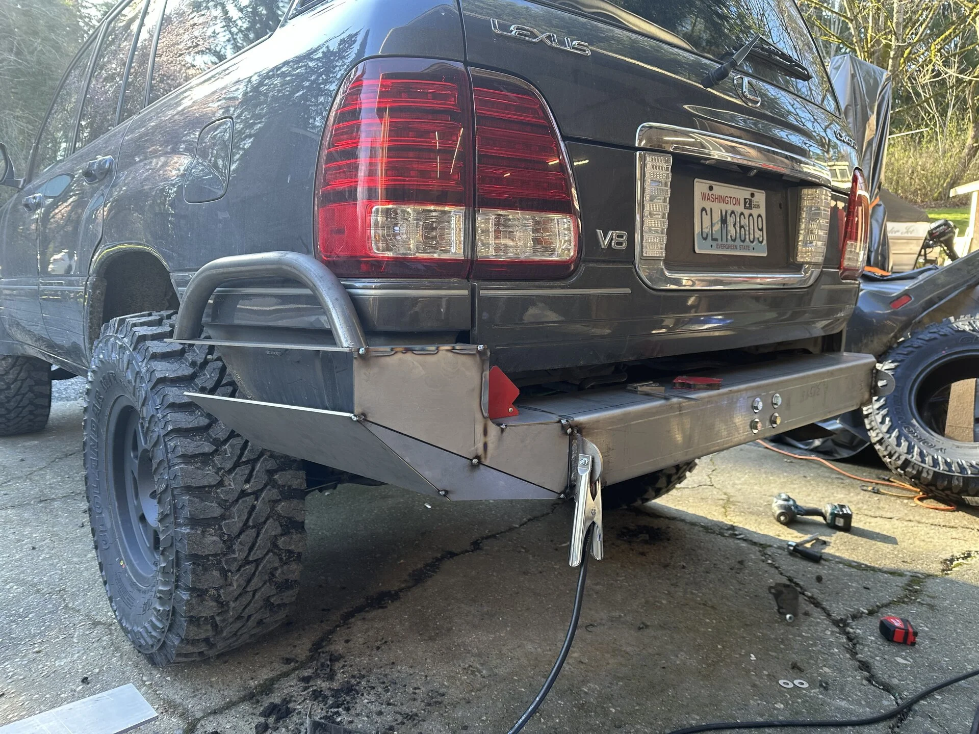

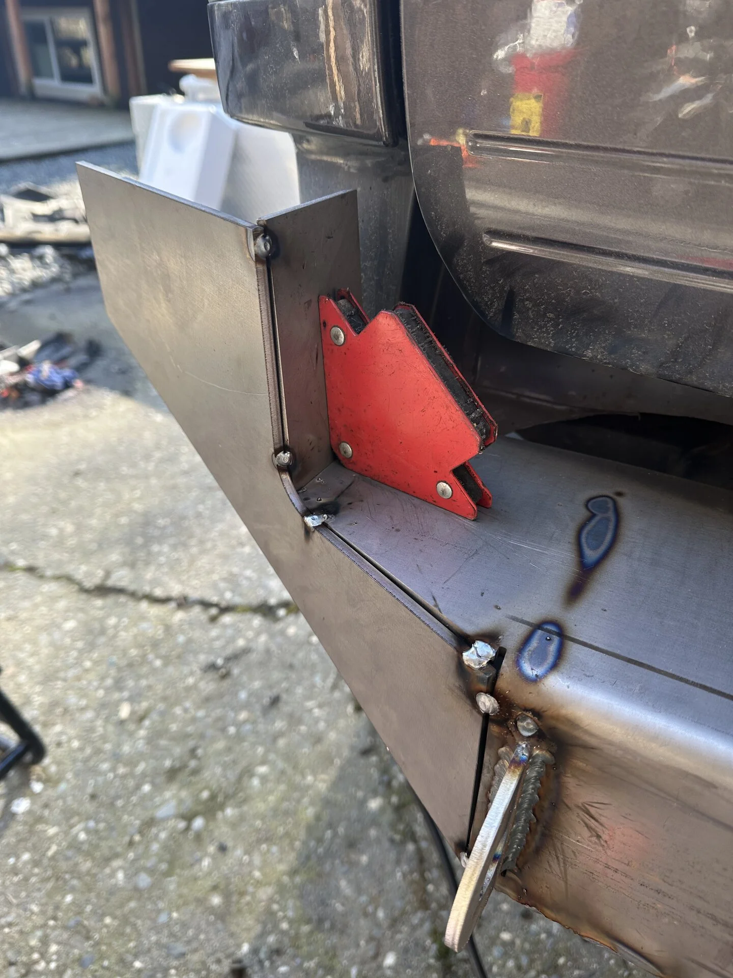

Hopefully get the ASFIR skid plates on tomorrow. And then remember how to weld so I can get going on the coastal off road bumper!

saw where the spare wheel was damaged and wondered what the plans were for transporting a 35 spare - great choice on the coastal for cost and esthetics plus bonus for diy

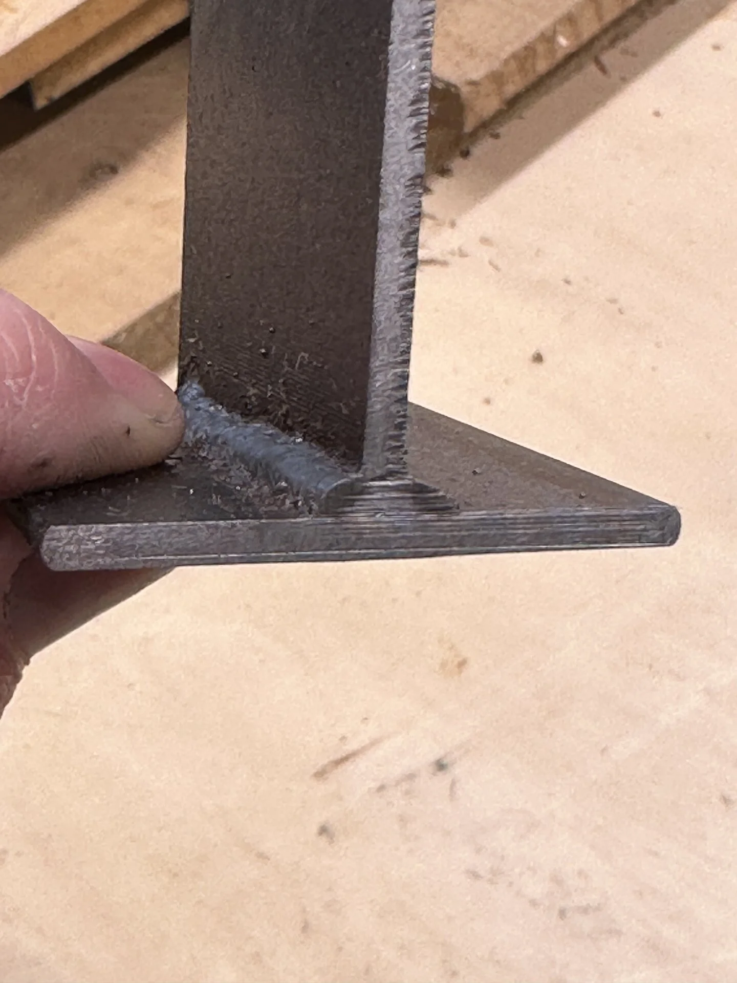

Not your first rodeo with a welder I see
And how are you making such quick work of this build?

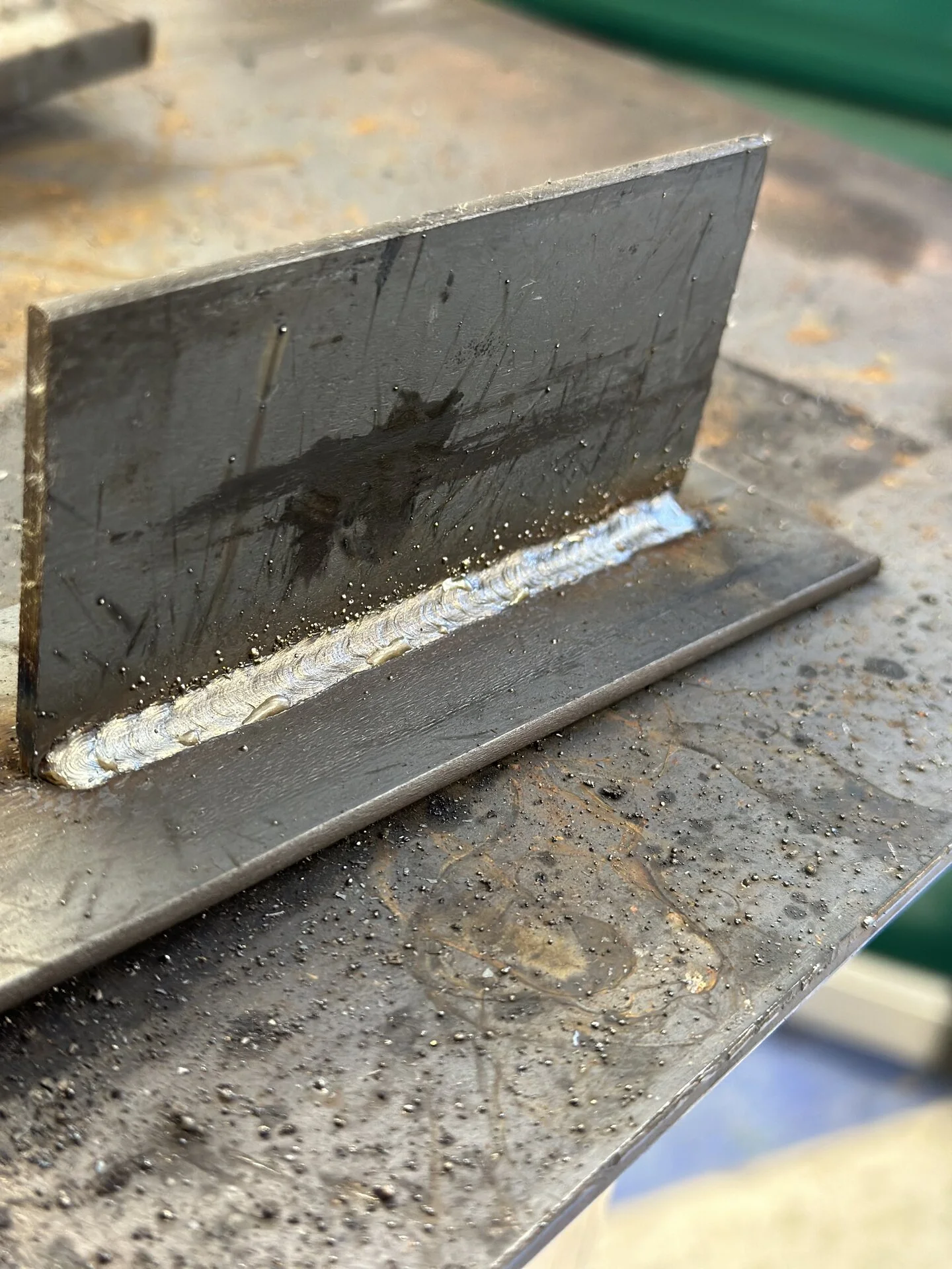

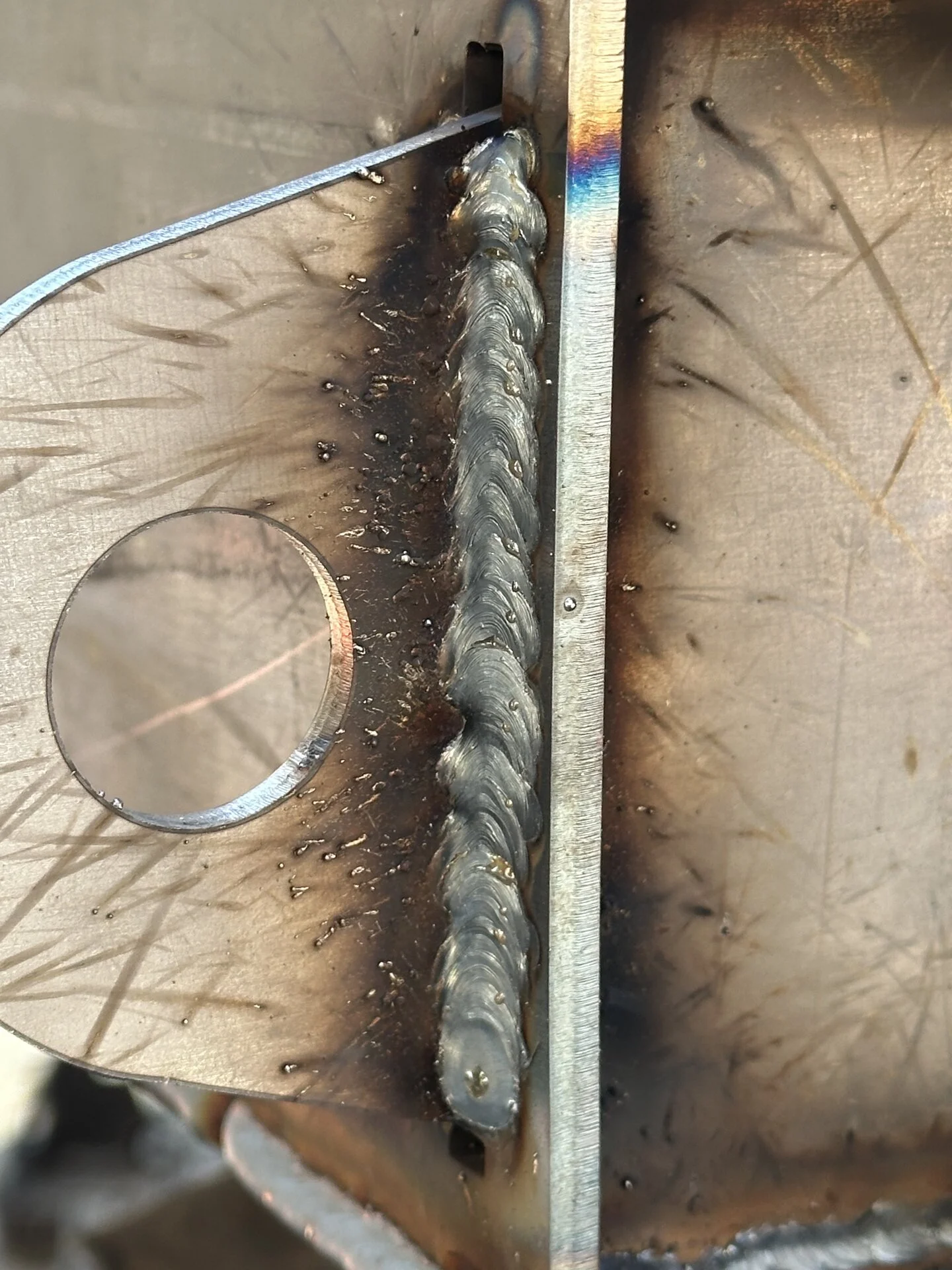

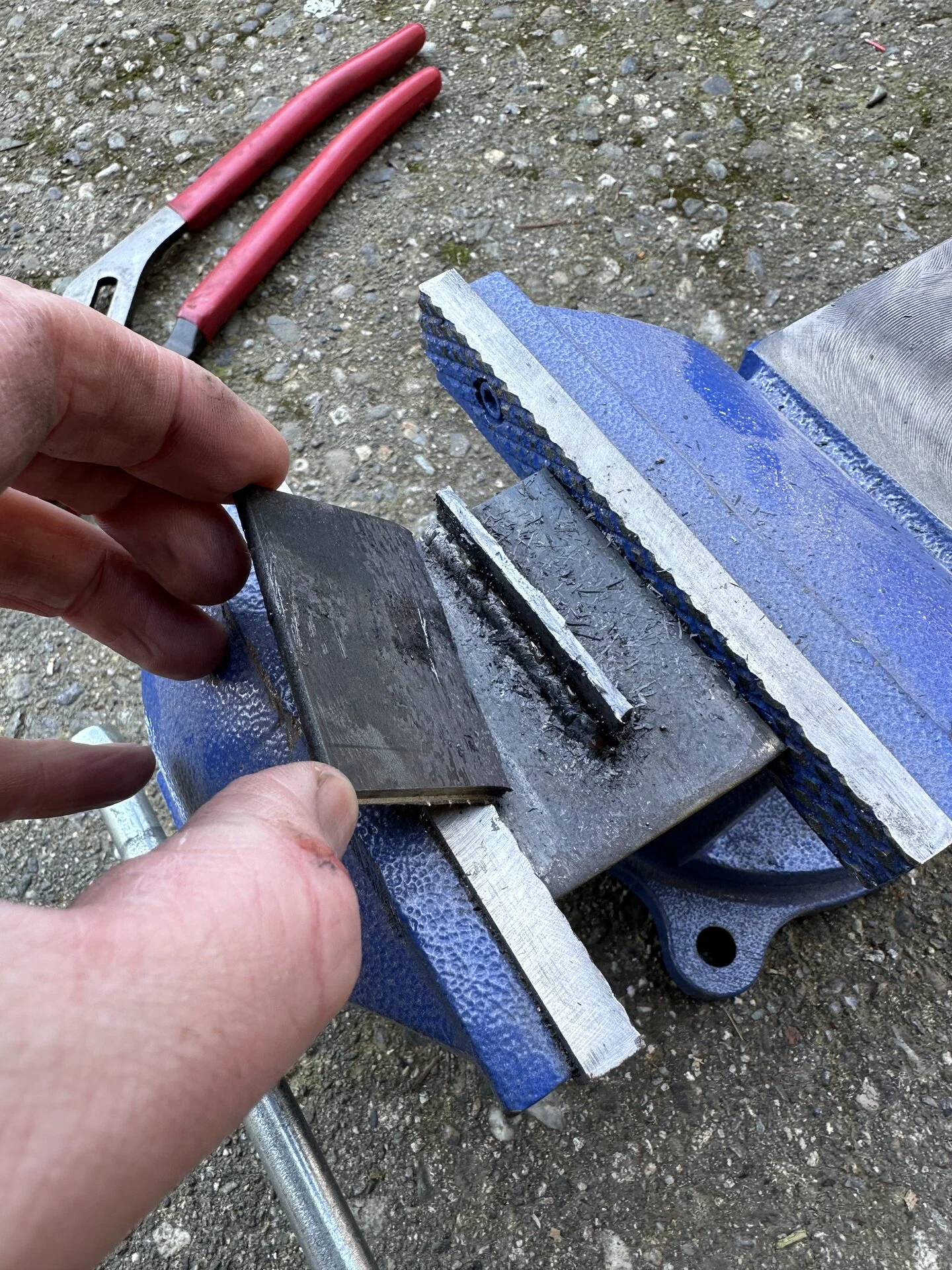

Believe it or not. First time welding. Picked up a Yeswelder mig 250 pro. Got setup yesterday. Ran some beads with flux core. Said **** that. Got a bottle of gas this AM…tried a few beads and went after it. My crutch is I watch a lot of YouTube and try to soak as much in before I get going with a new skill so that helps.
As for quick work. I purchased everything at once so when I started it was all in shop. Most of my free time has been dedicated to this or at least learning and researching. Also…no kids helps.
