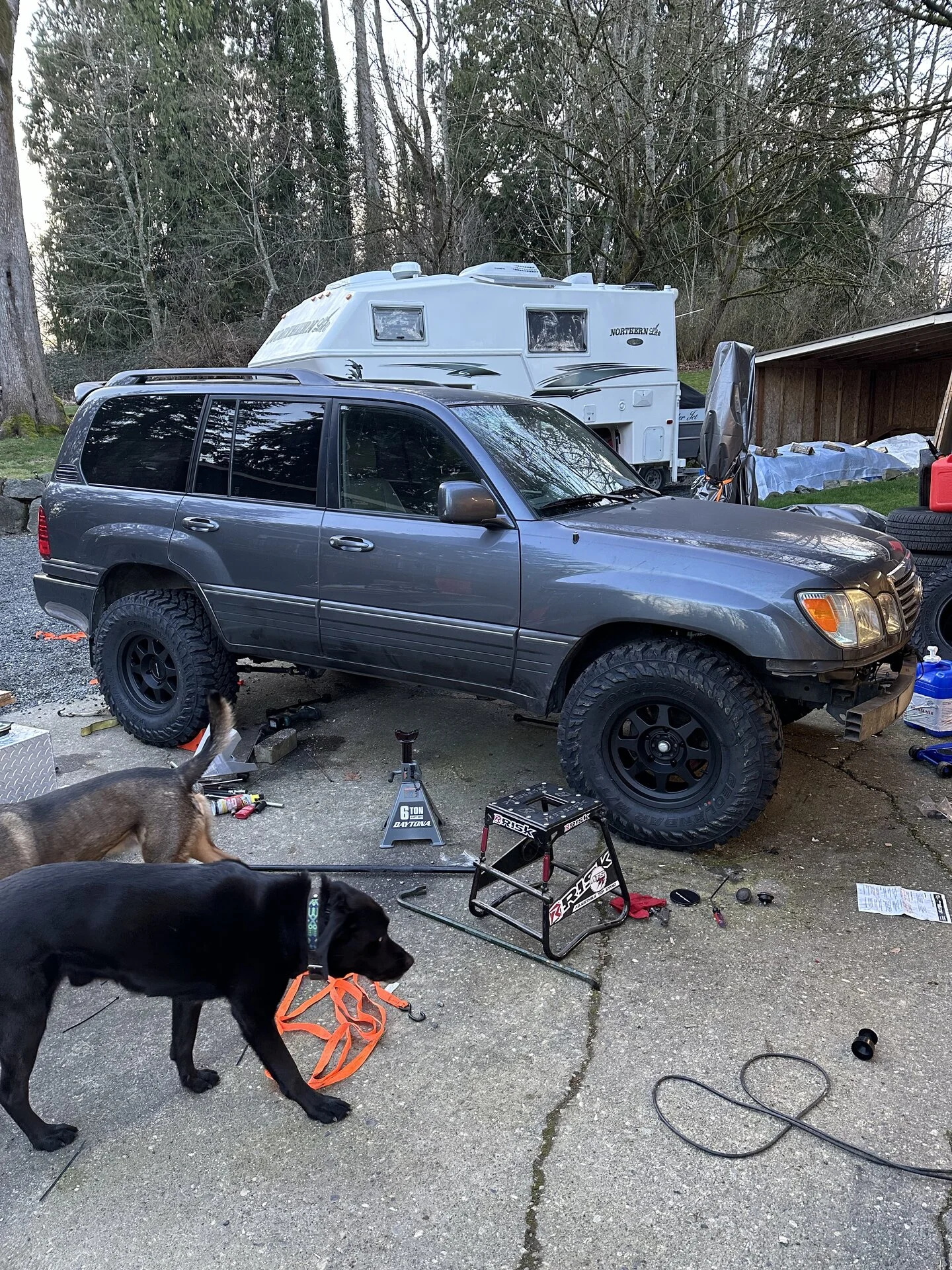

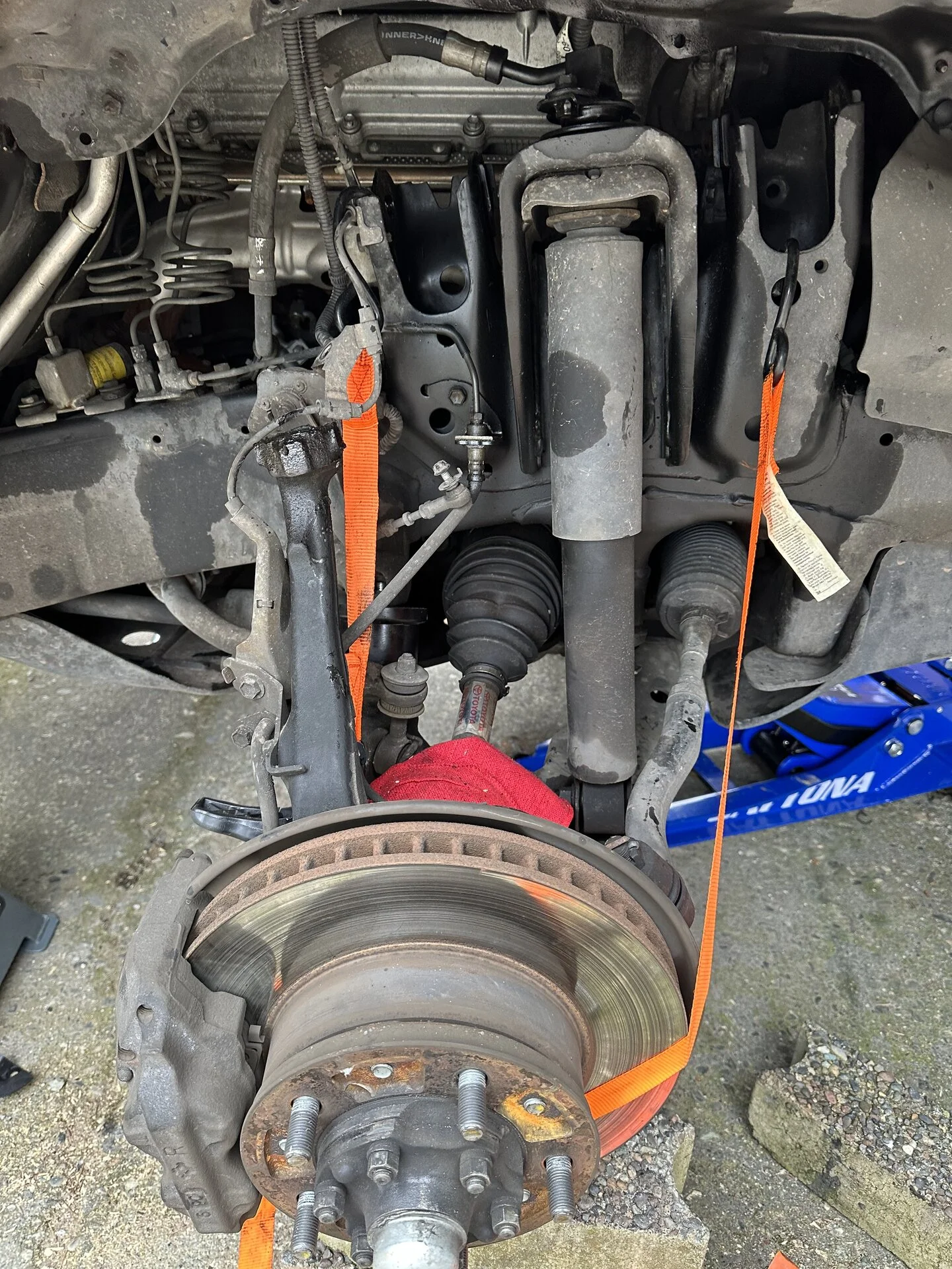

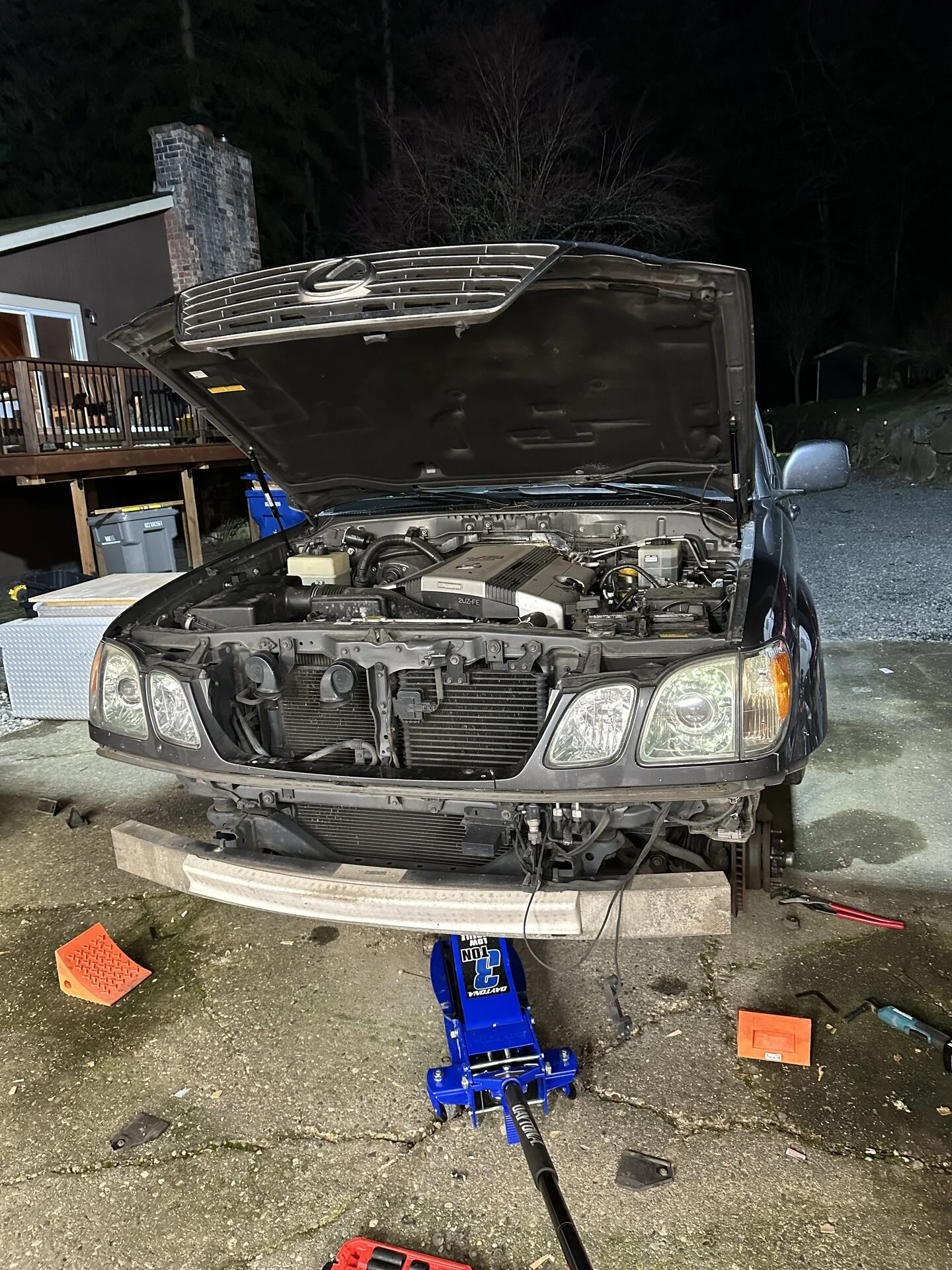

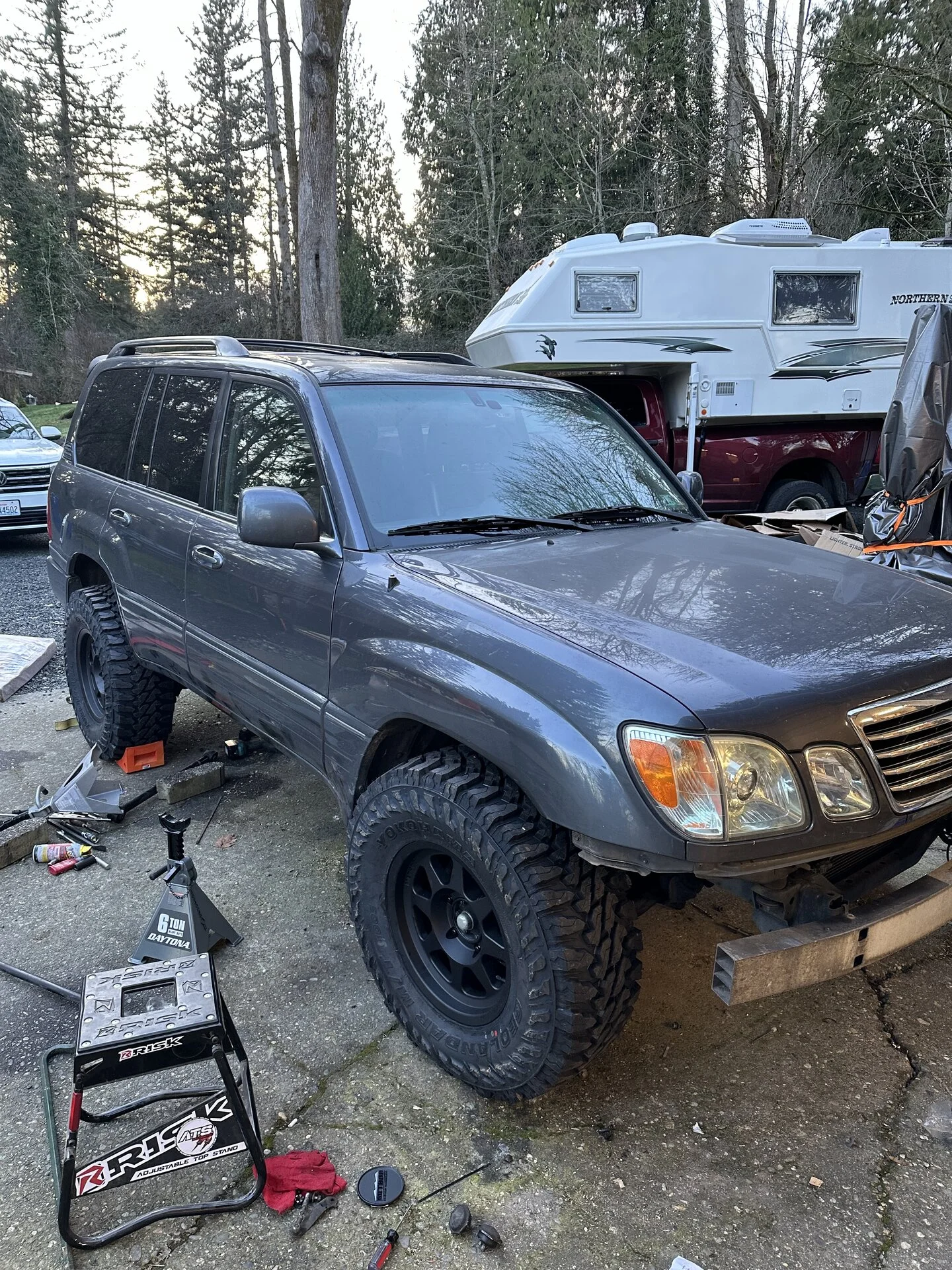

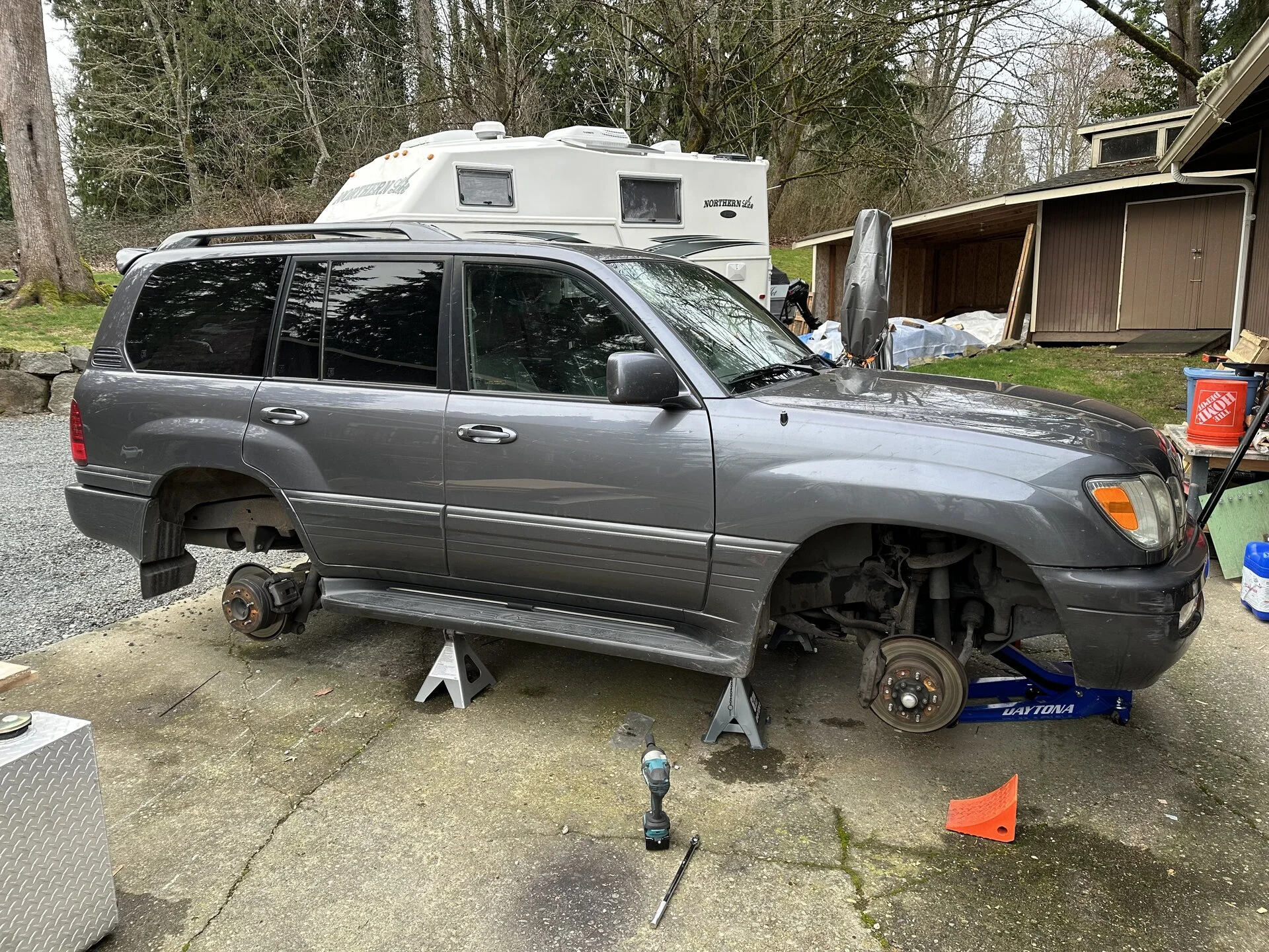

Progress for this morning:
-Front bumper removed -> Ironman front arriving today
-Side steps removed

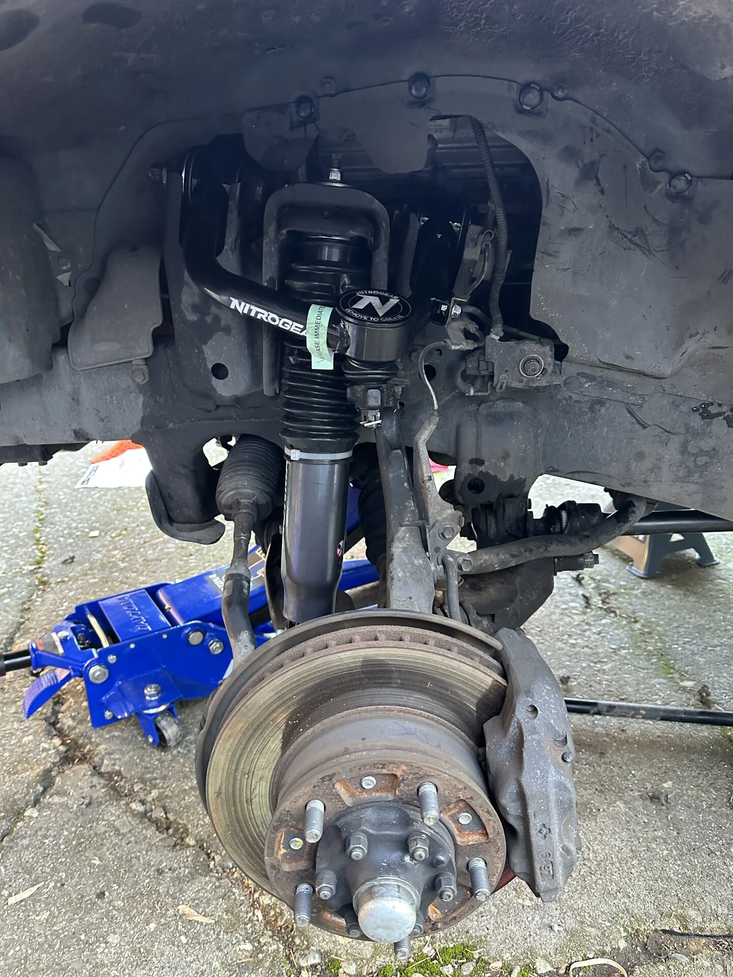

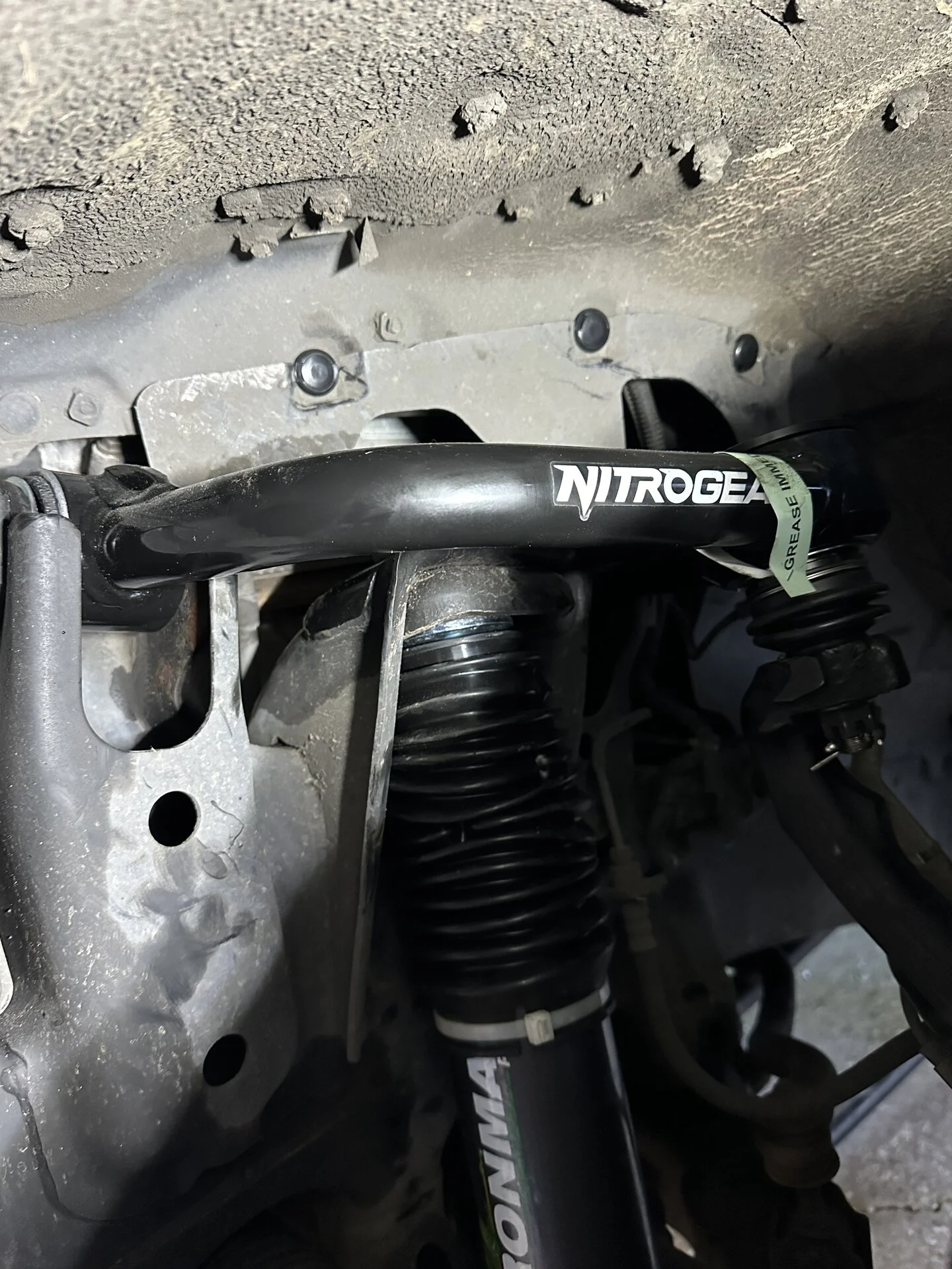

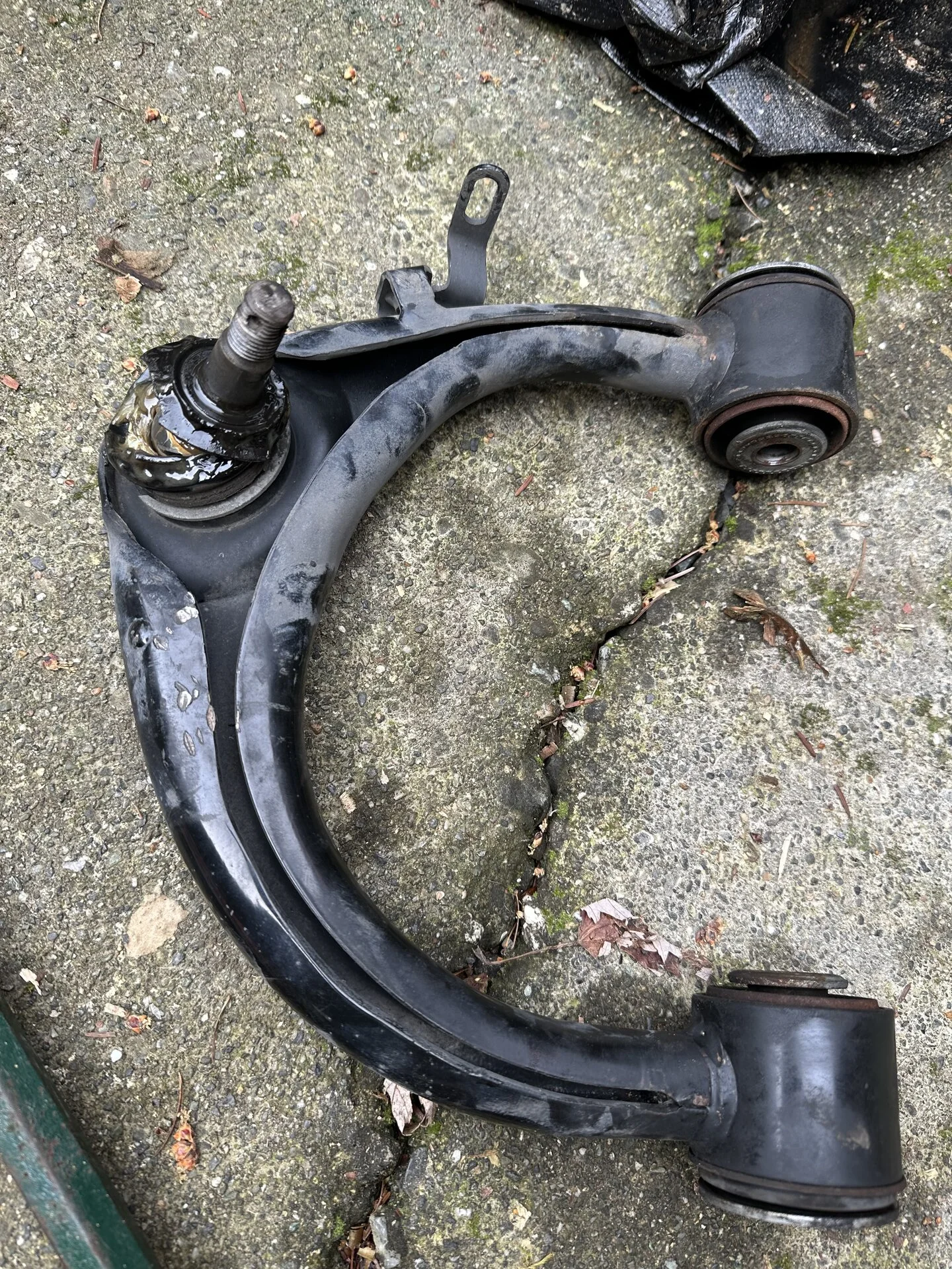

-UCA’s removed (took a bit of torch work and hammering) -> Nitro UCA’s on next

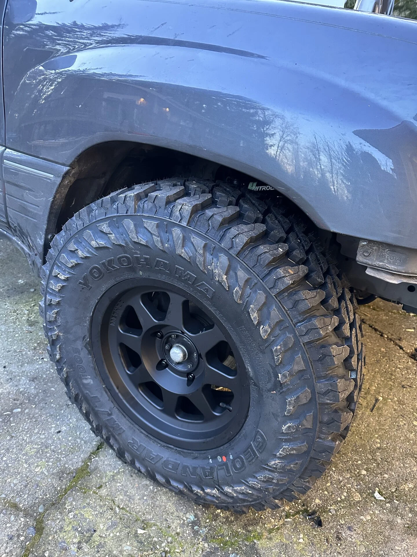

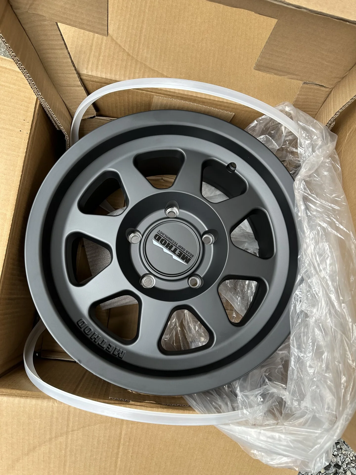

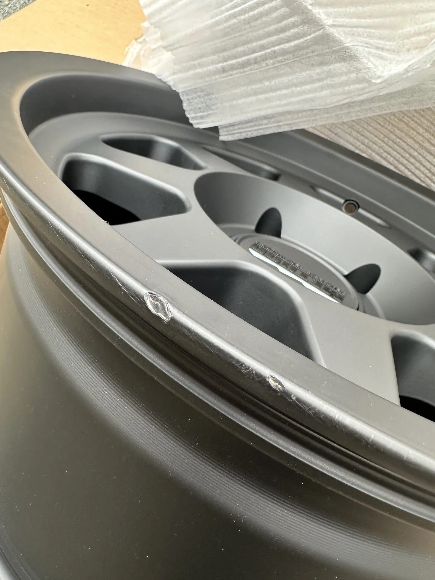

-35/12.5/17 G003’s getting mounted today on Method 701’s. One of the five wheels arrived damaged so will need to wait to get the spare mounted.

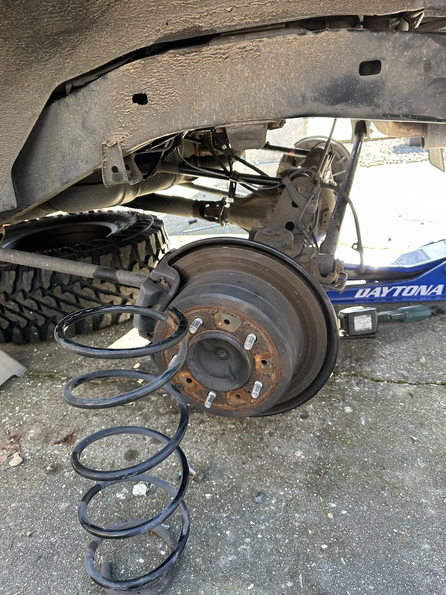

Update:

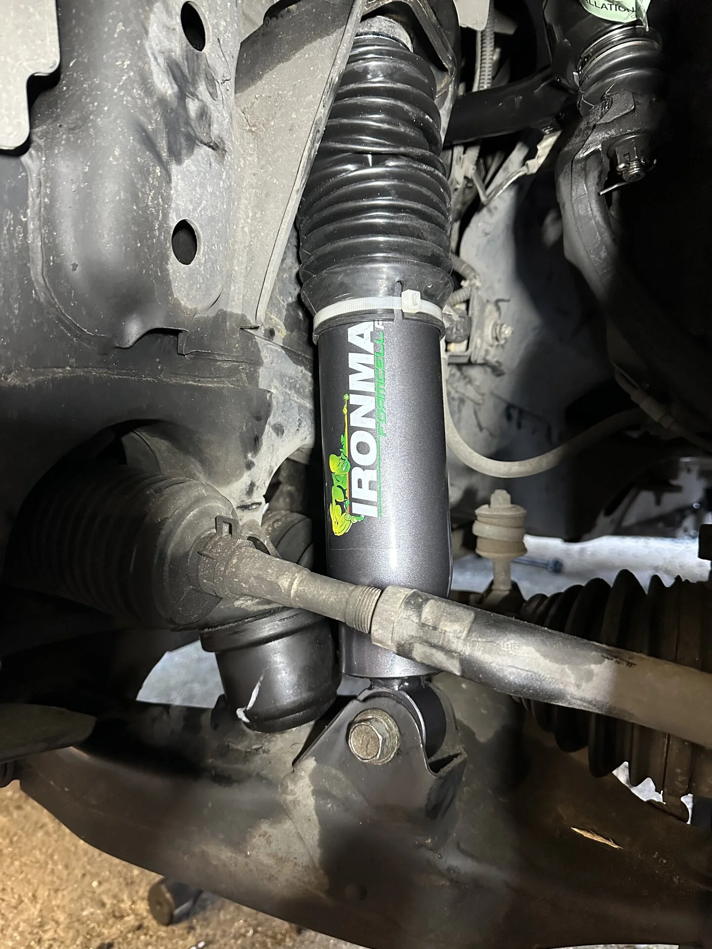

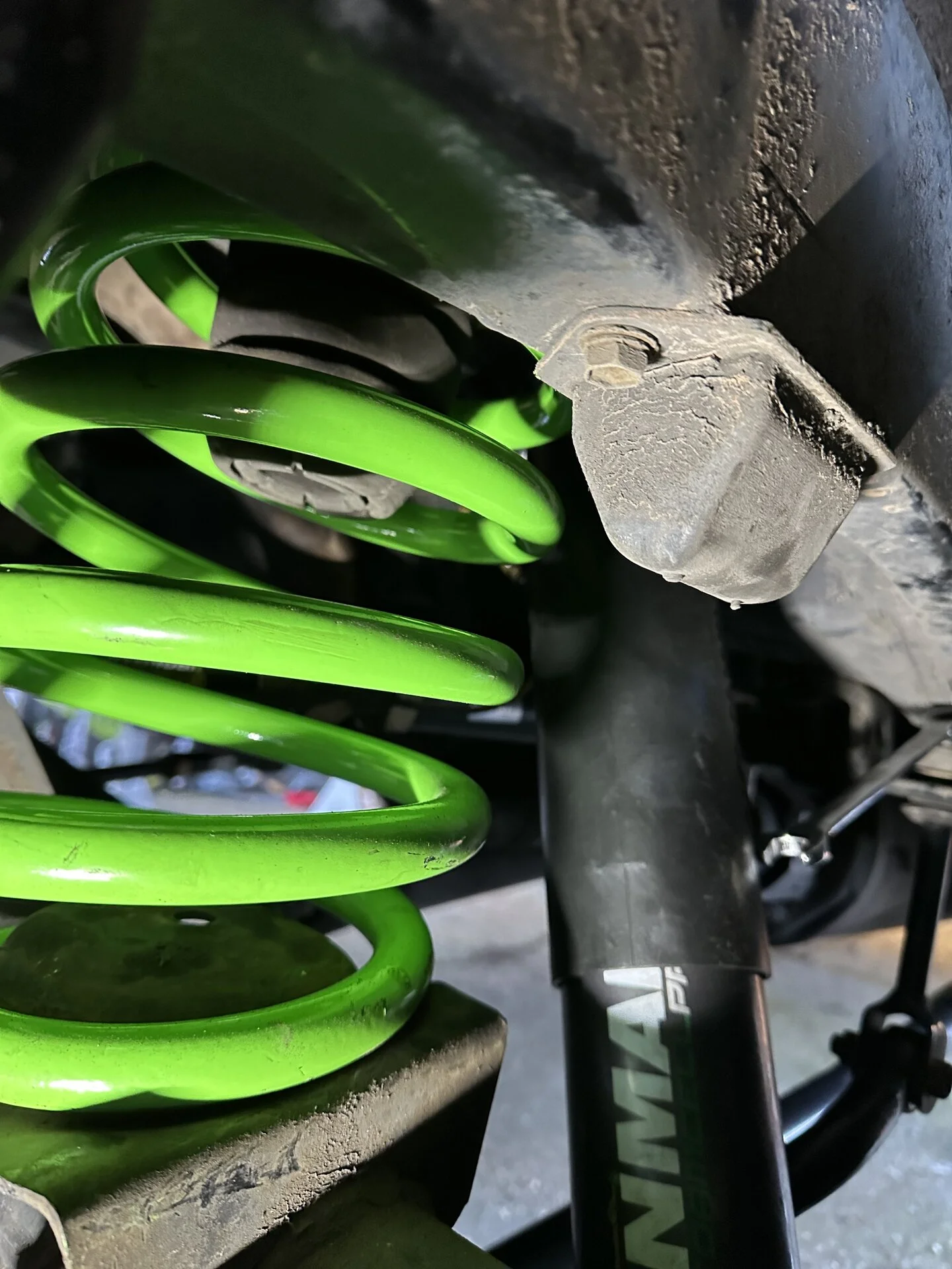

Got the Ironman foam cell pro lift installed. A few hiccups were had, but glad it’s mostly finished. I hope to never remove AHC rear shocks again. Those back 12mm bolts are a bit**. Also had some issues getting the rear upper/lower trailing arms removed and lined back up, but eventually was successful. After finishing up for the day realized I left the plastic cover off one of the rear shocks, 🤦‍♂️…I guess that will need to be pulled again.
Still lots of work to be done. Haven’t made any adjustments yet…just got everything bolted on and wanted to get a rough idea with the new tires/wheels.
Next will be getting alignment and everything better adjusted and then onto front bumper/winch, ASFIR full skids, and welding up the coastal off road rear bumper.
